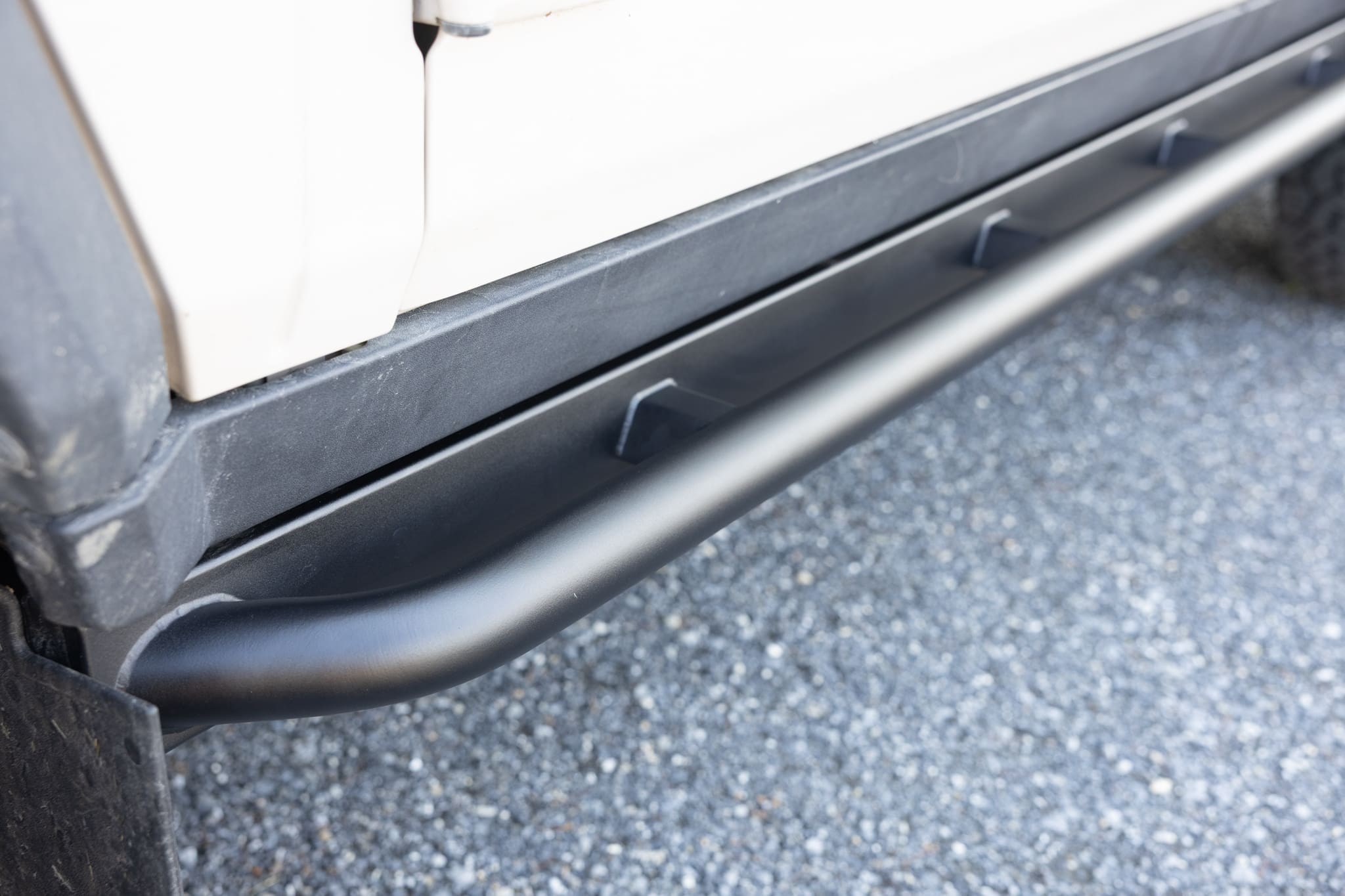

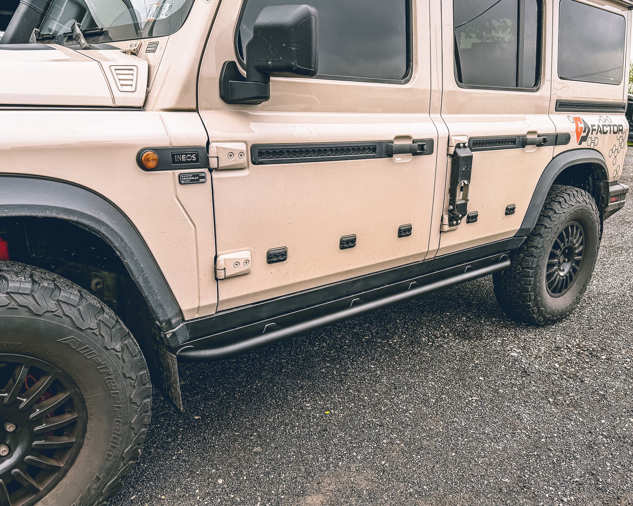

GP Factor took the time to get these right, and it shows. The sliders feature a classic tubular welded-to-rectangular design that complements the Grenadier’s utilitarian aesthetic. The round tubing protrudes enough to offer genuine rocker panel protection while also providing a useful utility step, which is a practical consideration for accessing a roof rack. During my Africa crossing, I ran a 3/4-length Front Runner rack to preserve use of the factory safari windows, and a solid step like this makes loading and unloading the roof, accessing MaxTrax, or auxiliary fuel, easier.
It is a fully dedicated rock slider and utility step without being an oversized running board that hangs too low, compromising ground clearance. The outer tube of the slider sits 3.6 inches from the side of the vehicle, which is close enough to stay protected but far enough to absorb a hit, like those pesky shopping carts, errant door dings, or inattentive motorcyclists.

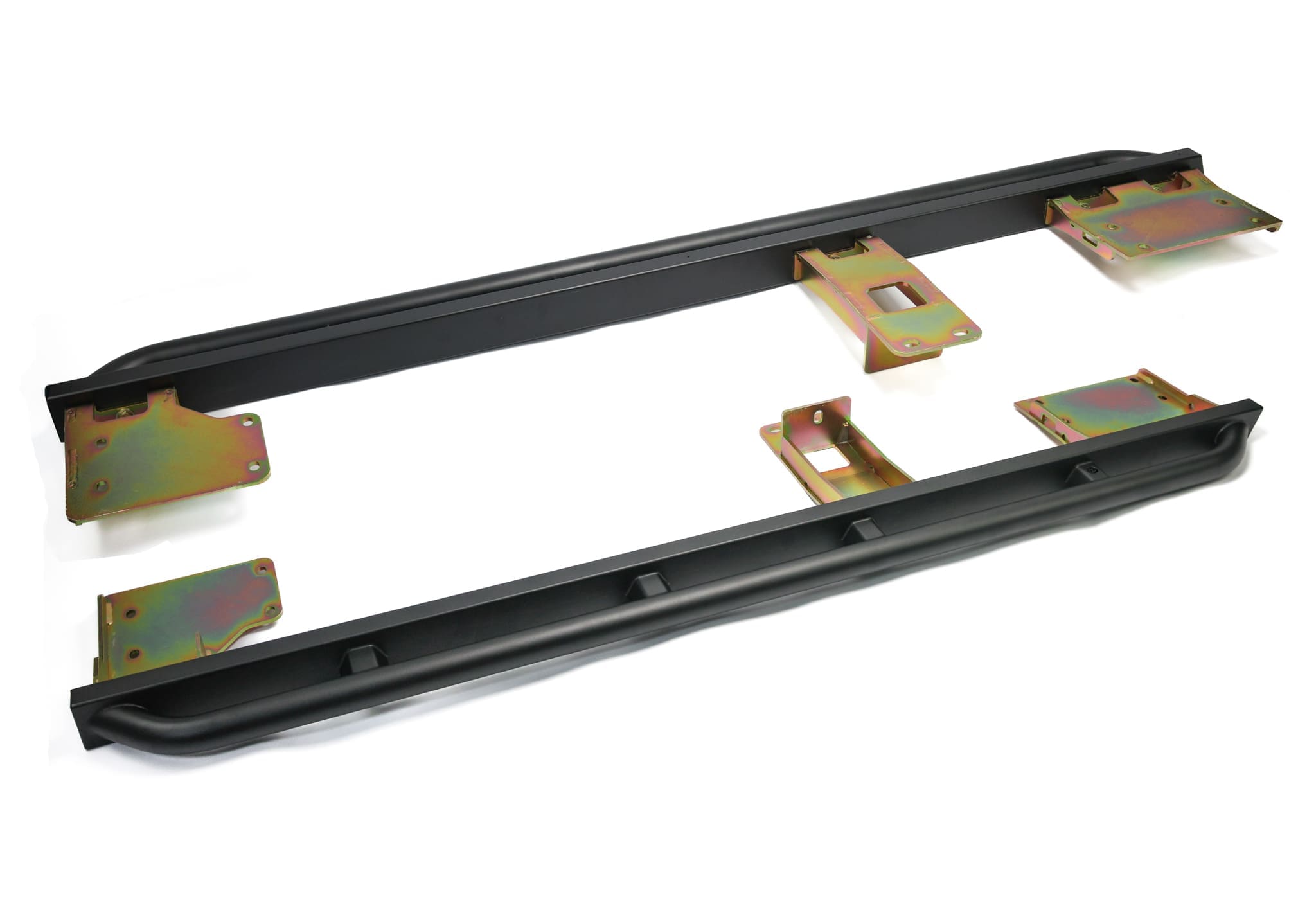

This is where GP Factor’s engineering makes a difference. The main body of the slider is constructed from A36 A1011 HRPO Steel ERW tube, measuring 1.9 inches OD with a .120 wall thickness – the same tube used on GP Factor’s popular Grenadier Bull Bar, ensuring a consistent look across the platform. That round tube is welded to A36 A1011 HRPO Steel ERW rectangular tube measuring 3 inches by 1.5 inches with a .120 wall. Each end is welded and reinforced with four support brackets per side for added durability.

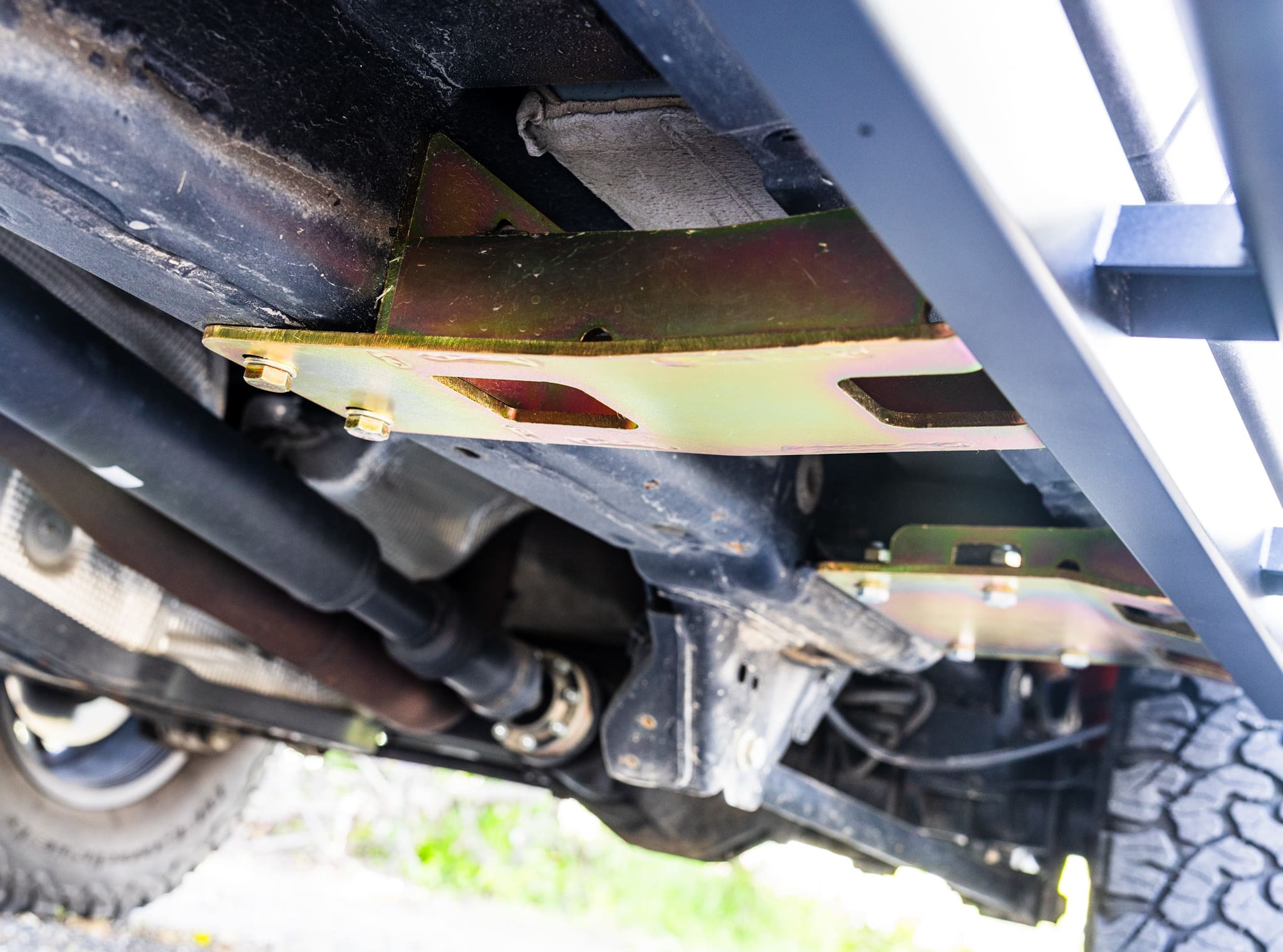

The mounting system is both strong and consumer install-friendly. The sliders are made up of three separate chassis-mounted pieces, all bolting directly to the Grenadier frame. By separating the mounts, GP Factor was able to use thicker material where it matters most. All three mounts are constructed from 1/4-inch HRPO A36 prime steel with corrosion protection (think rock chips). The threaded mounting points use CNC M12 threaded sleeves that are chamfered front and rear, then welded on both sides of the rectangular tubing. Welding a threaded sleeve or bung completely through the tube is widely considered one of the strongest and most reliable methods for adding threads, particularly in high-load and safety-critical applications. It is the kind of detail that separates serious fabrication from general consumer products.
