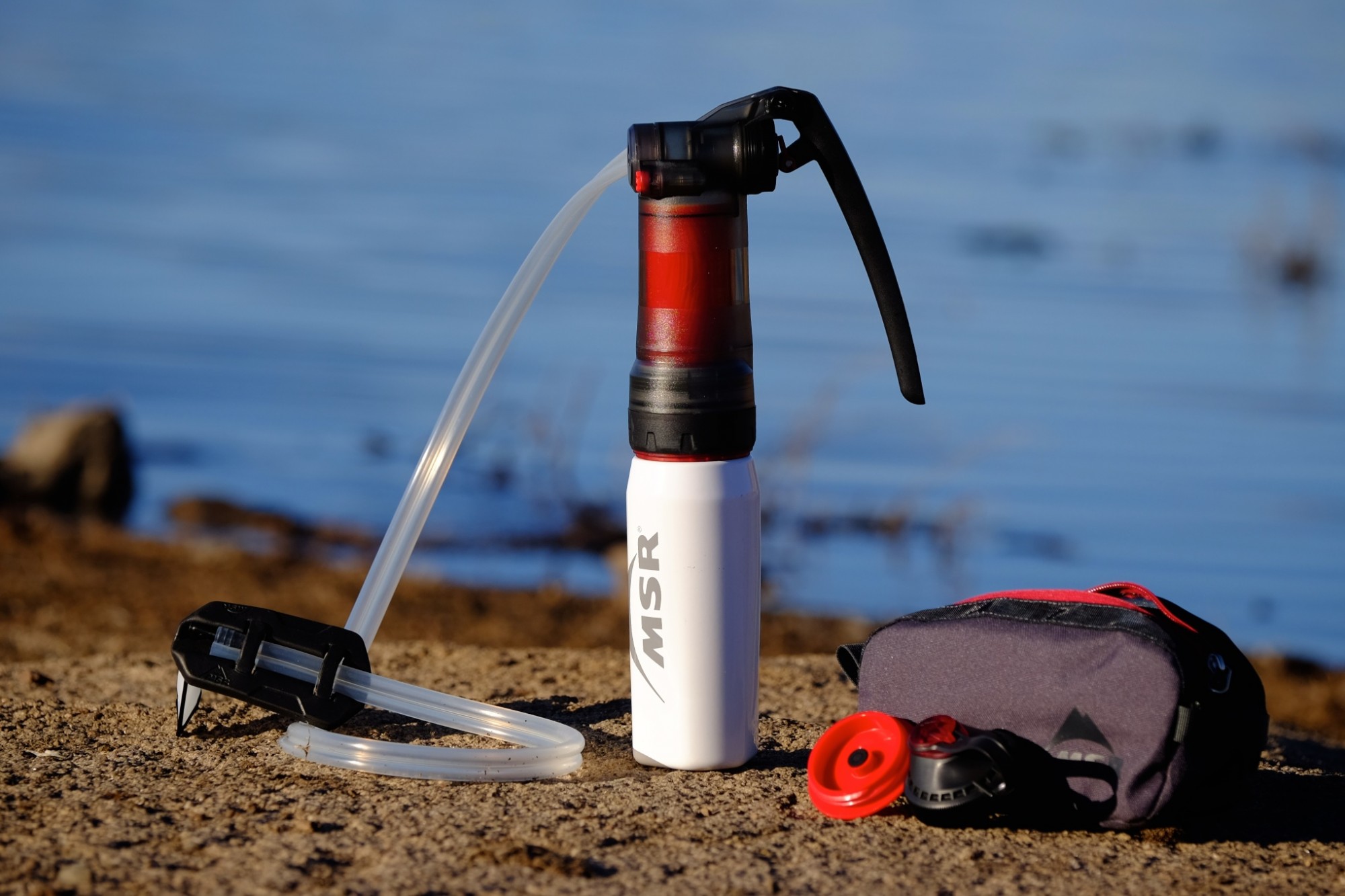

I am not predisposed to hyperbole and I don’t spend my superlatives carelessly. So, when I say the new MSR Guardian water filter is the most advanced piece of outdoor technology I have seen in the last decade, I commit to that statement with confidence. Just the backstory of its development is impressive. Commissioned by the U.S. government to develop a water purification solution for use by military persons throughout the globe, the MSR engineering team spent more than six years designing the Guardian. The end result is a water treatment system with performance and features which far exceed that of any previous product. They have in one fell swoop redefined what a portable water purification system can achieve. And it’s now available to the consumer.
DSCF5051
The entire unit is not small, but it is compact and easy to manage. The quality of the entire kit is superb and in keeping with the elevated level of perfection MSR is known for.

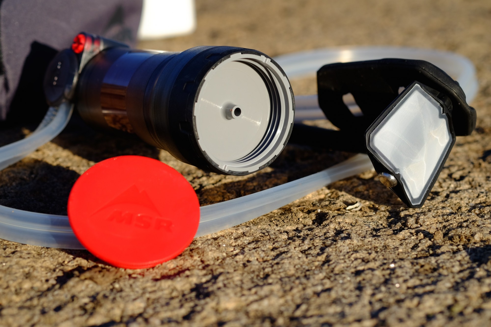

The Guardian threads onto most standard water bottles and MSR’s own Dromedary bags eliminating the need for an “out” hose, which invariably gets contaminated during the pumping process.

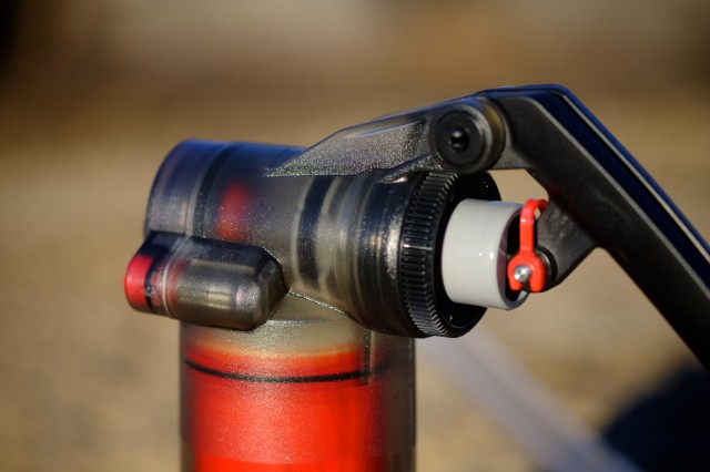

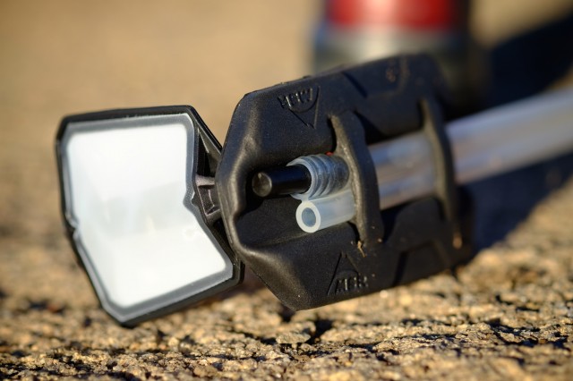

The pump employs a mechanical lever to reduce pump force. When treating water for large groups, that has a big payoff after processing several gallons in one sitting. The white mesh pre-filter is easy to clean and very effective. The unique dual hose configuration is terminated at a foam float which keeps the hoses from contacting the bottom of a water source where sediment and debris are most likely to enter the intake.

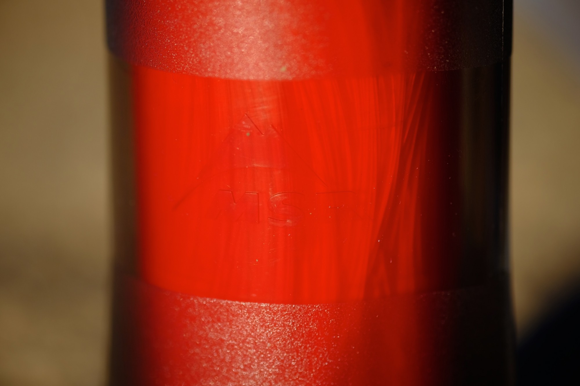

 The unique filaments in the filtration element are visible through the body of the pump.

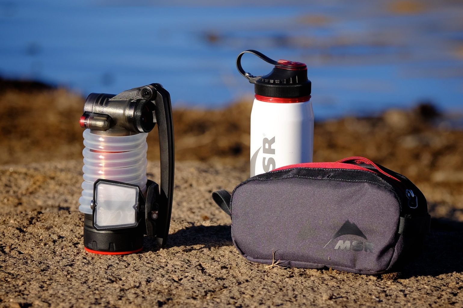

MSR pumps have always been very user friendly and thankfully, they chose to build the Guardian around the familiar format of the MSR Waterworks, which has been around for nearly two decades. With no “out” hose to contaminate, and a base that threads onto most bottle and container solutions, the Guardian is easy to use with two hands, not the three required by many systems. The pump action is light, easy, and the overall ergonomics are well designed.
Size and weight
No filter will ever be light enough, or small enough, to meet everyone’s lofty expectations. I have “pocket” filters, and they perform as well as can be expected given their displacement in my pack. There is a weight and size penalty for the Guardian’s elevated level of performance, but most people will find that offset worth their while. I might not be so inclined to use it as a soloist system for use where water quality is better than average, but for even paired travel, or extended travel in places were water quality is dubious, it’s a perfect tool.
