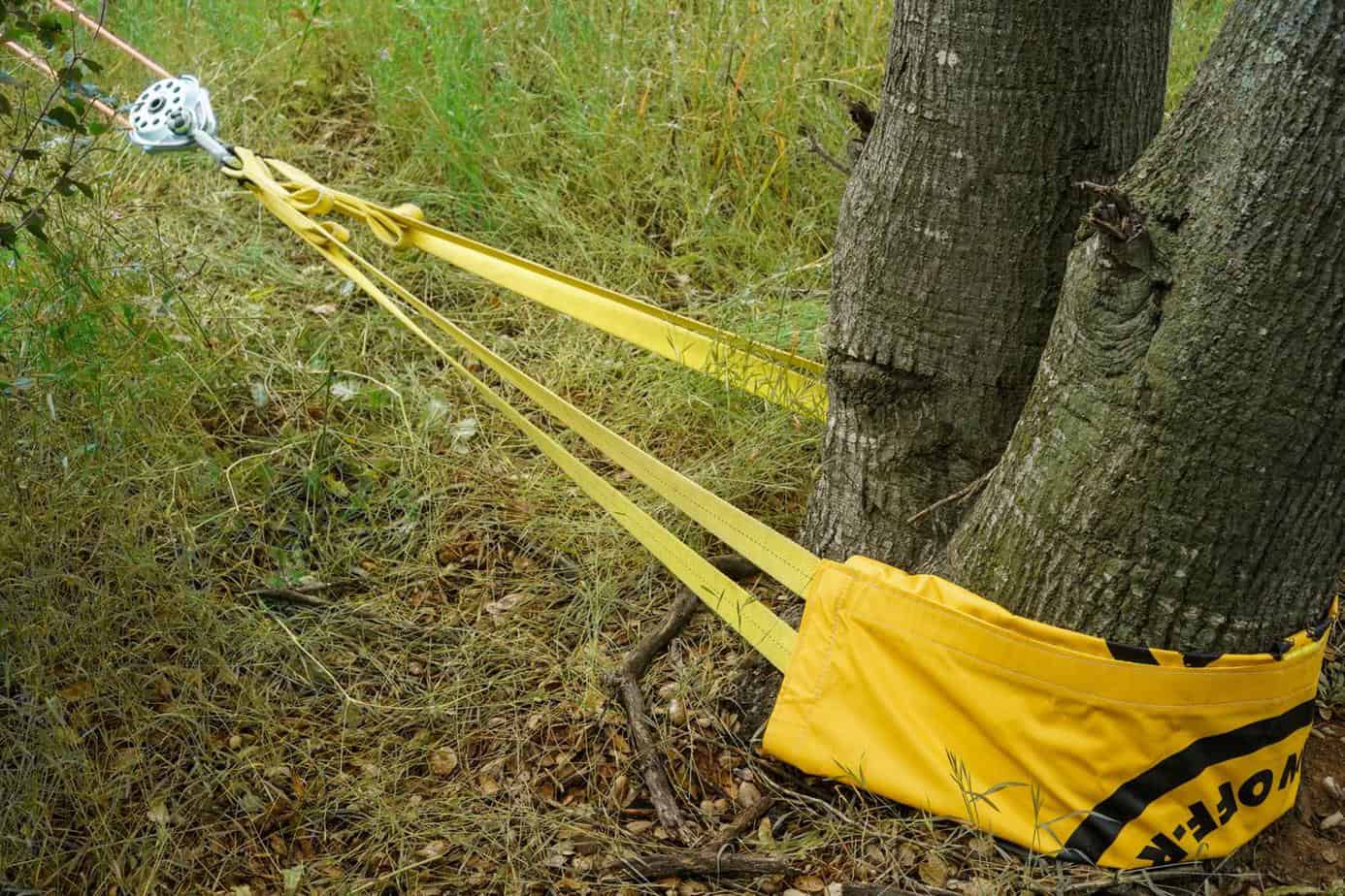

One of the best parts of attending Overland Expo each year is seeing all of the cool ideas from fellow enthusiasts. Expo West 2017 was certainly no exception, and showcased everything from massive campers to ingenious pocket tools, but one of our favorite products came from a NASA engineer named Bryant. It’s called the Deadman, and it is a ground anchor, tree strap, rock anchor, and work mat, all rolled into one piece of kit.

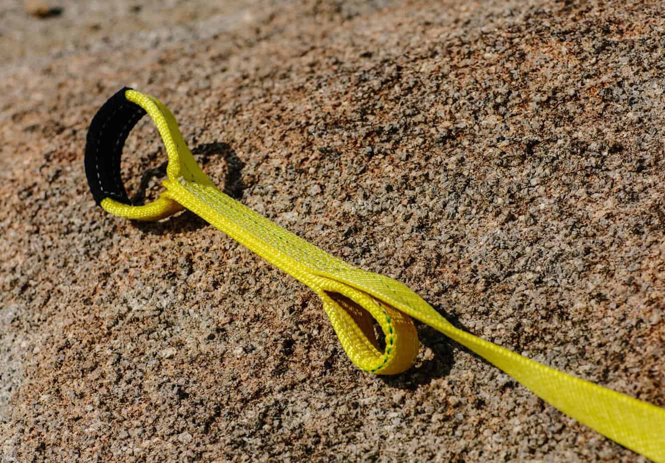

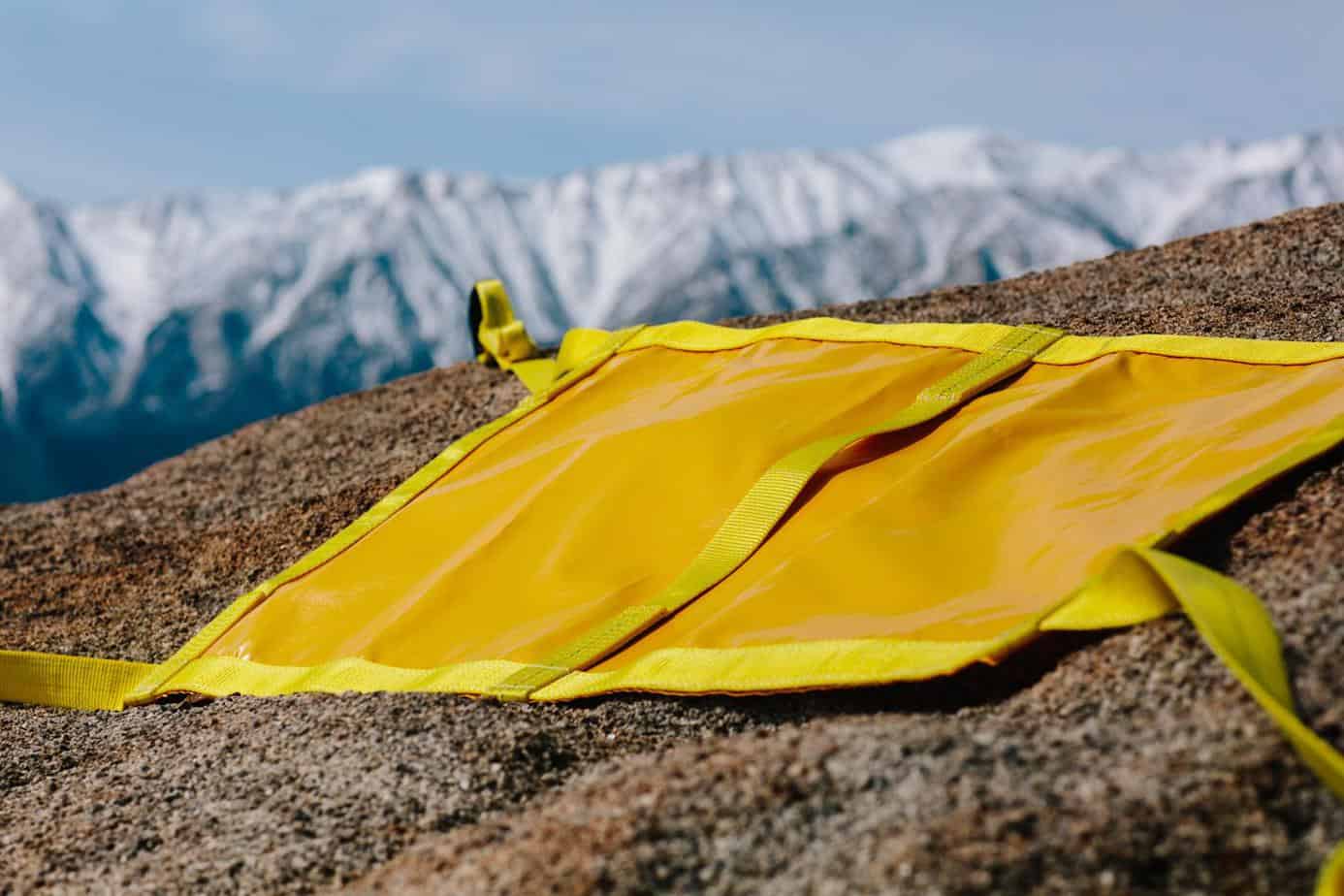

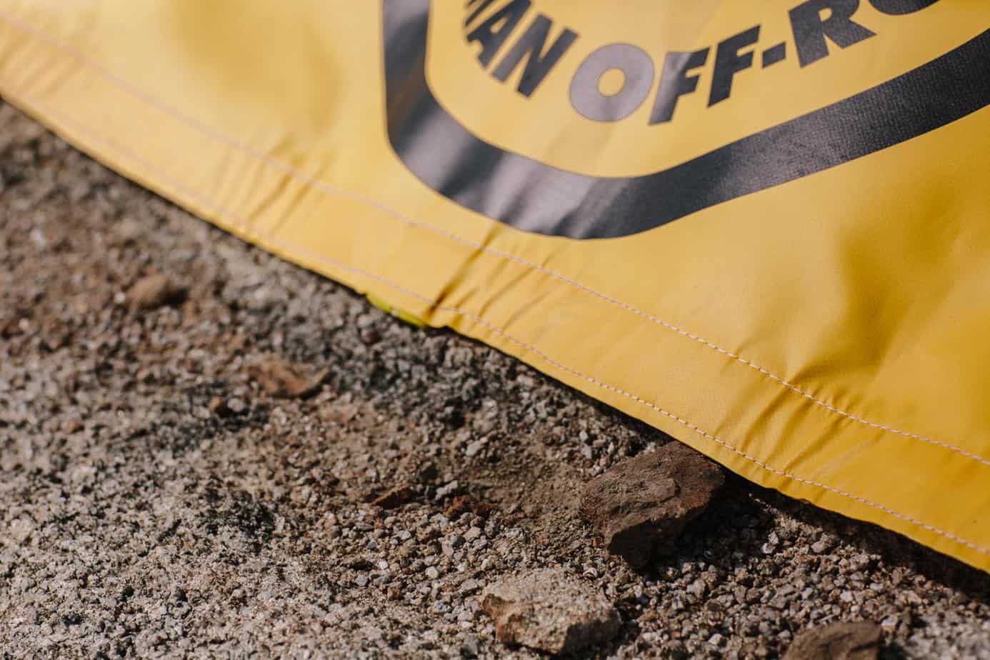

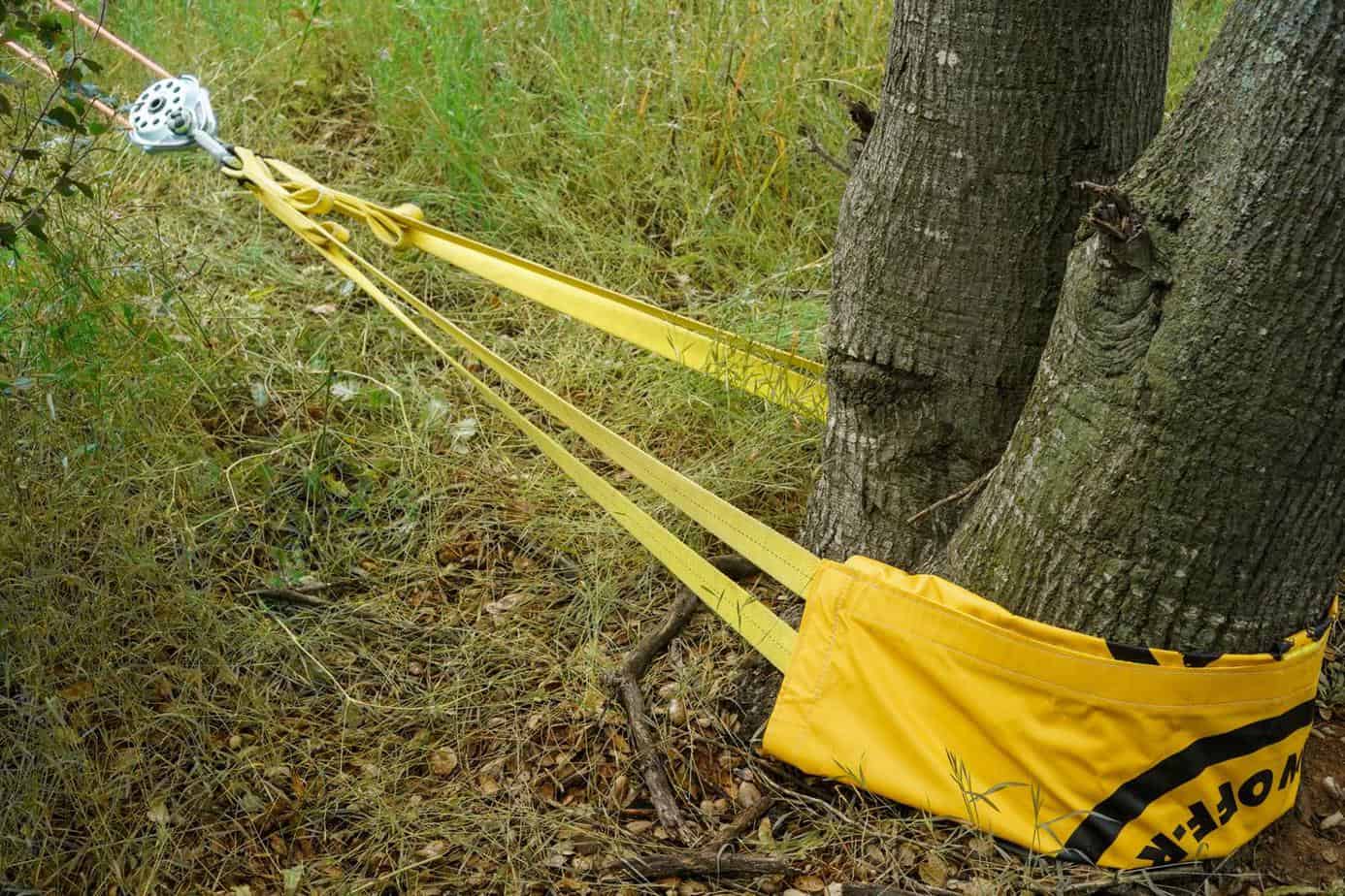

This versatile recovery tool weighs just 5 pounds and is compact enough to fit under a seat, but it’s far from delicate. It’s made in the U.S. from Class VII, industrial-grade 2-inch polyester sling webbing, with a minimum breaking strength of 19,600 pounds per line. There are two 15-inch lines in the Deadman, doubling that minimum breaking strength to almost 40,000 pounds in a straight pull, and twice that in a basket. The center area is an 18- ounce industrial vinyl tarp with a polyester scrim.
“It’s extremely durable, and stretches well when used around oddly shaped or jagged rocks. Our primary test unit has been wrapped around rocks, buried, and drug out from underground many, many times, and it’s still fine. Even the screen printing on the face is still intact.”

All right, so it’s a good ground anchor and tree saver, but what else can it be used for? Thus far, their team has seen it put to use as a mat for working under the vehicle, a radiator screen for deep water crossings, an abrasion guard for winching, a fluid catch, a hammock, and a number of other things.
