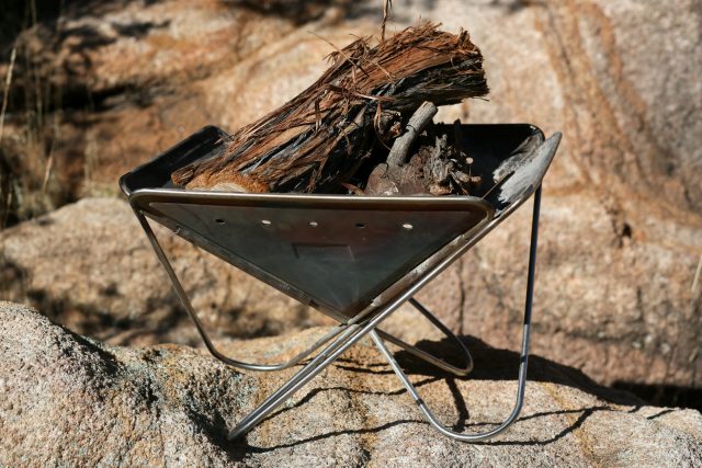

SNOW PEAK
PACK AND CARRY FIREPLACE
PROS
Fastest setup
Lightweight
Wide range of accessories, including an oven
CONS
Expensive, dependent upon accessories purchased
Accessories rattle when stored in canvas case
Needs more airflow at base
The Snow Peak fireplace has been around for over a decade and our team has used it consistently throughout that period. The most abused unit shows years of blackening and staining, yet it still folds easily and retains the clean exterior finish of the 1.5-millimeter stainless steel. The Pack and Carry weighs just over 10 pounds and is hinged at all four corners. Setup is fast and intuitive; one movement deploys the legs and firepit at the same time. I have rarely found the optional ash tray to be needed since the aeration vents are high on the sides and only the smallest amount of ash tends to leak past the hinges. The firepit alone packs pretty flat, just over 1.5 inches thick when stored in the included nylon case. There is an optional thick canvas bag which is a more durable option.
Accessories are plentiful but expensive, and when combined in the canvas case, the various pieces do rattle while driving. Options include an ash tray, a cast-iron charcoal tray, fireplace grill bridge, a grill, and even a field oven (yes, for pizza!). There is also a tripod to hang cast-iron cookware and a matching bamboo toolset available, resulting in the ultimate Iron Chef firepit. Limited lifetime warranty, made in Japan.
$150/MEDIUM | SNOWPEAK.COM
