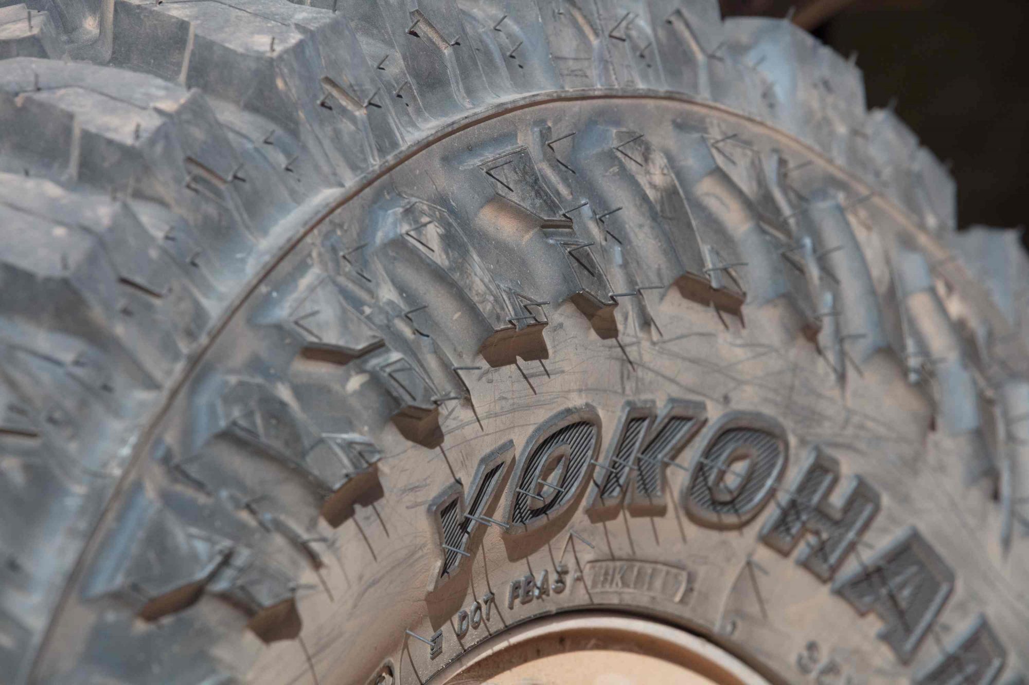

The new Geolandar’s block is wider and flatter, producing a larger footprint than the previous iteration. Voids between the inner block and shoulder are broad and triangulated, and siping is 80 percent of the total tread depth. Within the voids are small ribs that assist in expelling debris. Moving outward, the shoulder is staggered and features a squared-off edge. The sidewall tread, which Yokohama refers to as armor, is quite deep and aggressively angled like the blades of a propeller. Construction consists of two steel belts and a full nylon cap under the tread block, while three polyester plies protect the sidewall (C-rated models will have a two-ply sidewall).

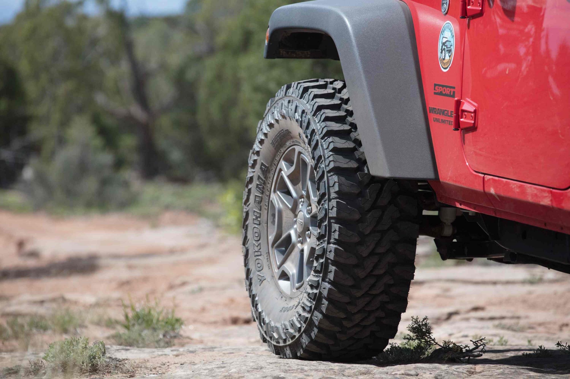

Whether a tire’s design is dedicated to the street or dirt, much can be ascertained from how it handles on the pavement. I found the G003 to be fairly predictable, providing good lateral grip on constant-radius turns and lacking the typical wandering experienced with some mud-terrains. I thought the square shoulder design would result in howling during hard cornering, but it was reasonable for a mud-terrain. In emergency braking scenarios, they felt very direct and were surprisingly grippy.
