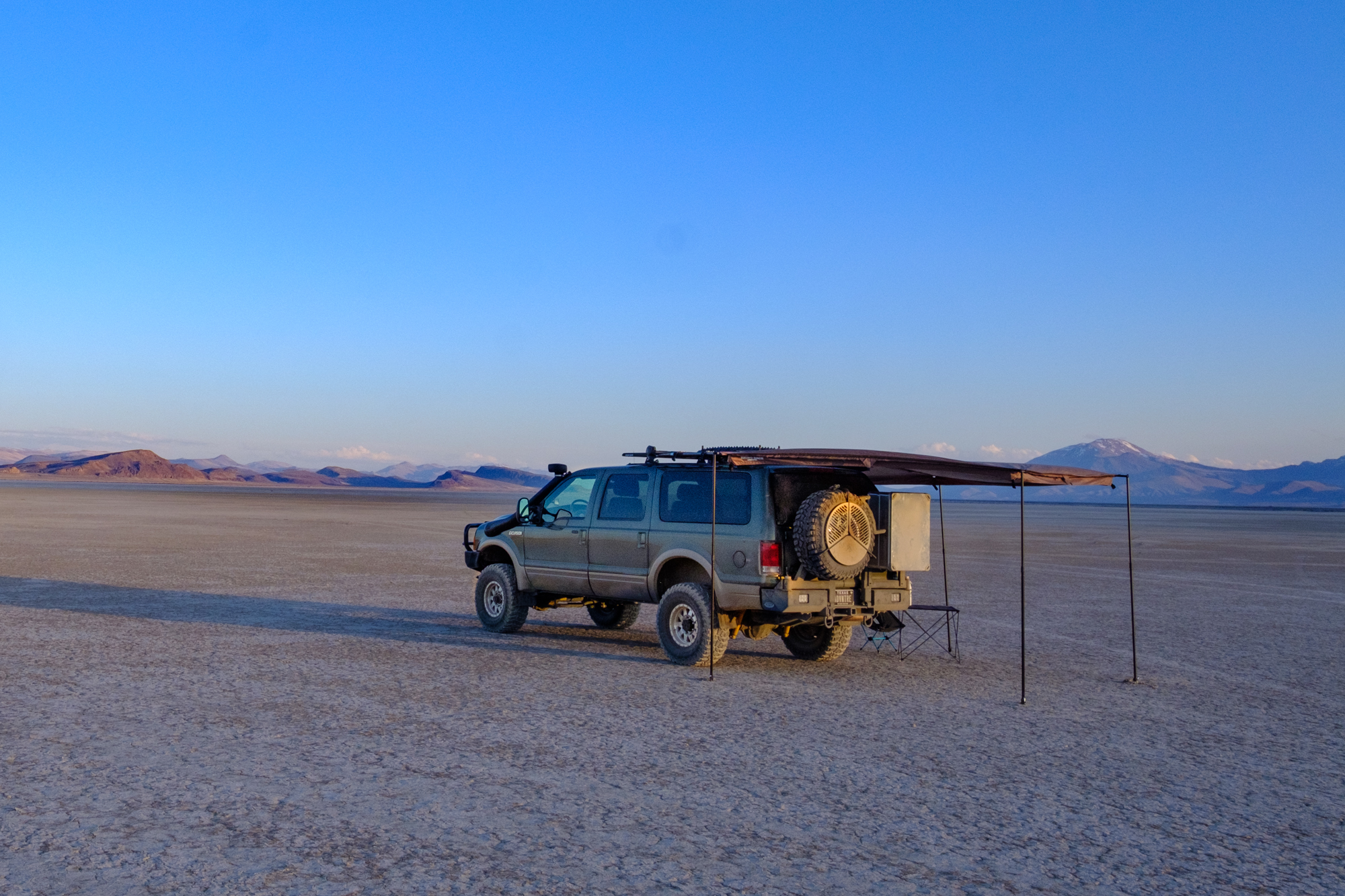

Setup is an absolute breeze. You simply unzip the bag, walk the awning around the back of the vehicle, and attach the tensioning buckle to your roof rack. Then, drop the legs, and you are done. The entire process takes less than a minute if stakes aren’t required.
If conditions are less than favorable, you can use the stakes without being forced to use guylines. The feet on the poles have slots for you to cross stakes through, securing them to the ground without adding the troublesome cables for you to run into at night. Of course, Rhino-Rack still includes a full array of hi-vis orange lines for times when things get crazy, but we haven’t found them to be necessary.

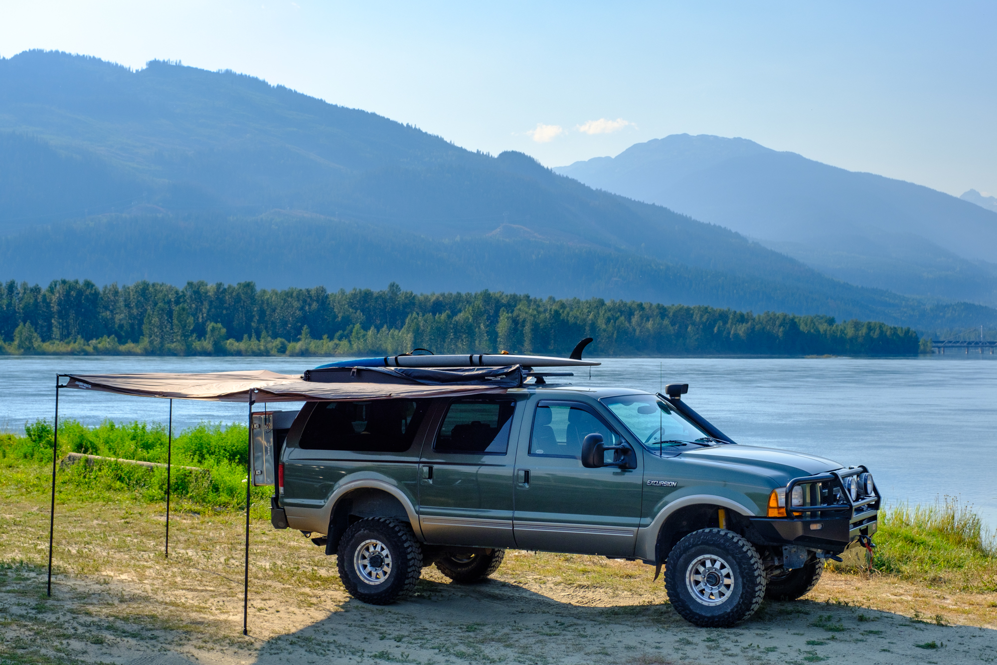

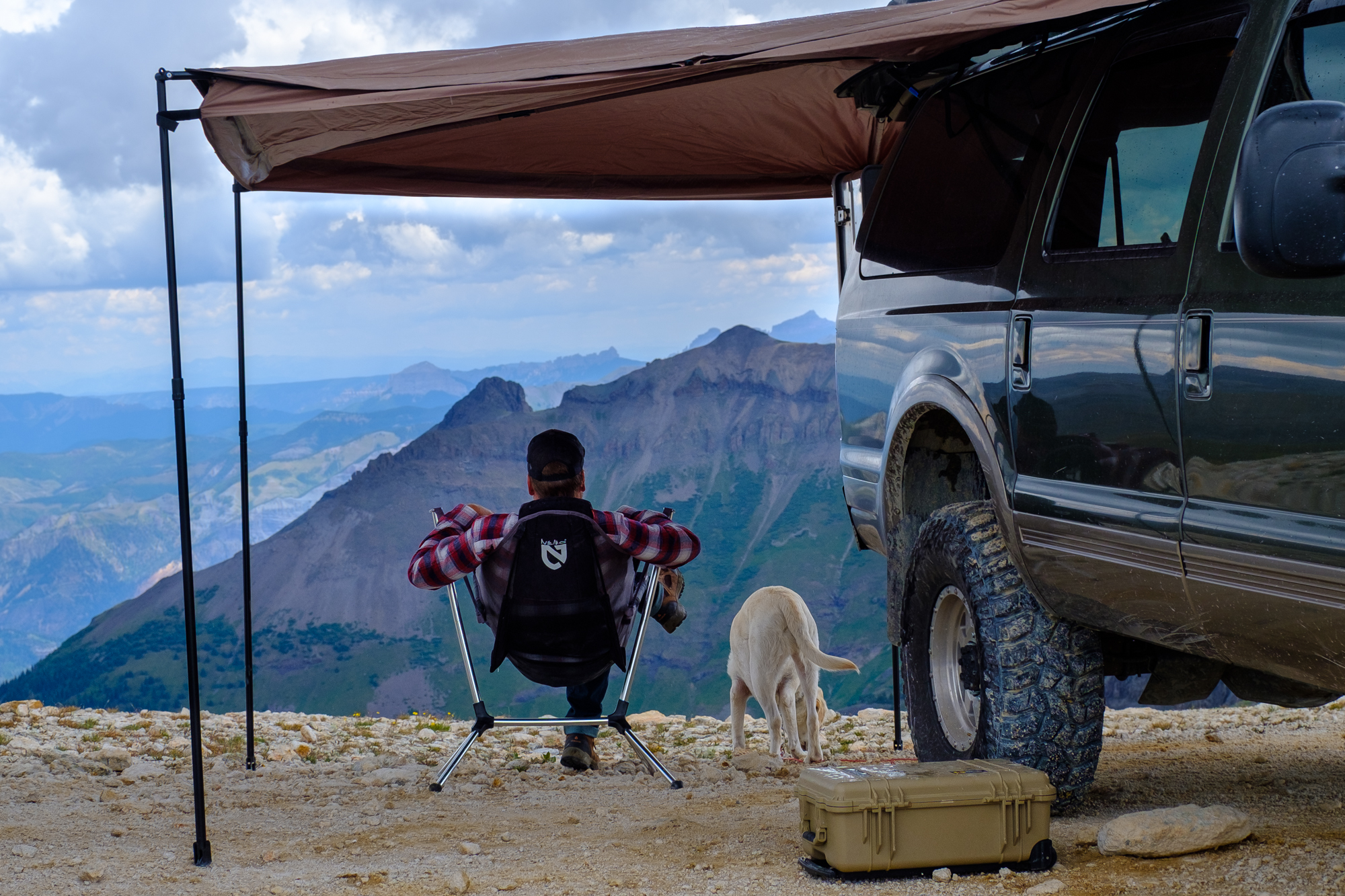

Once the awning was fully deployed, there were even more changes we loved. For example, the switch from dark green fabric, which tended to absorb and radiate heat, to a lighter tan alternative. This small alteration made a big difference in keeping us cool, and the 210D ripstop fabric carries an independently evaluated UV50+ rating, so you can feel confident that you’re getting real protection from the sun. It is also water and mold resistant, which is a huge deal when you use the awning to escape rain as much as we do. In the photo above, we were hit by a surprise sleet storm, and shortly after were inundated by other people taking cover without an awning. We then stored it away wet for three weeks in hot conditions without opening it to dry. During the course of these 21 days, temperatures often reached the mid-1990s, but upon rolling the awning out, there wasn’t a spot of mold.

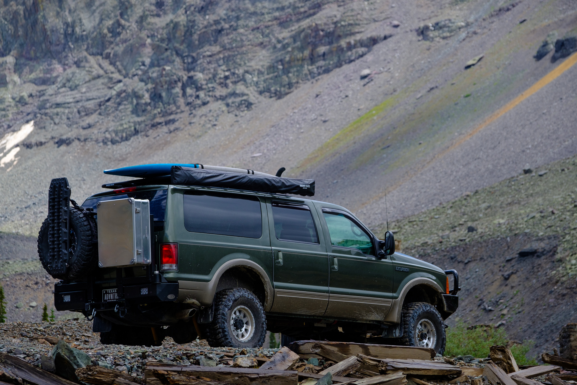

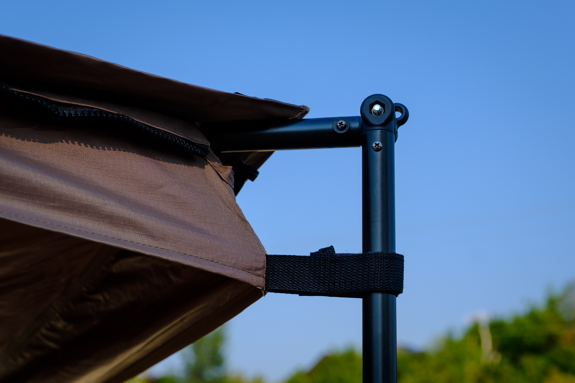

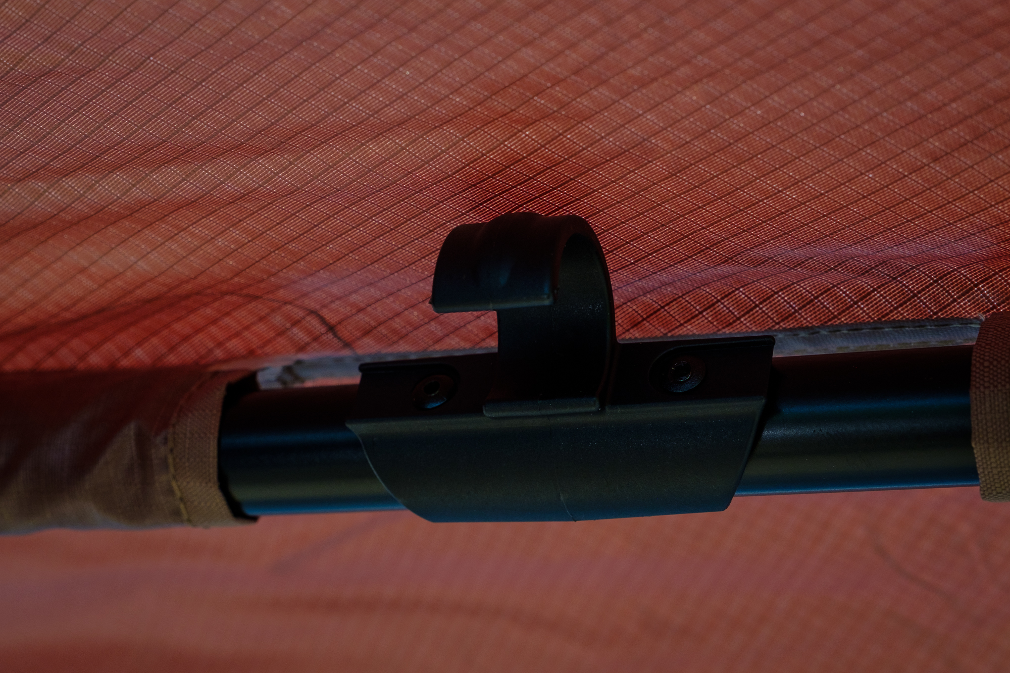

Storing the Batwing was as easy as deploying it thanks to legs which can be adjusted and stowed in a single motion, and a cover that fits loosely enough to allow for some slop. We also loved that they secured the ends of the poles with magnets instead of plastic clips, eliminating the problem of mounts that become brittle and snap in the cold.
