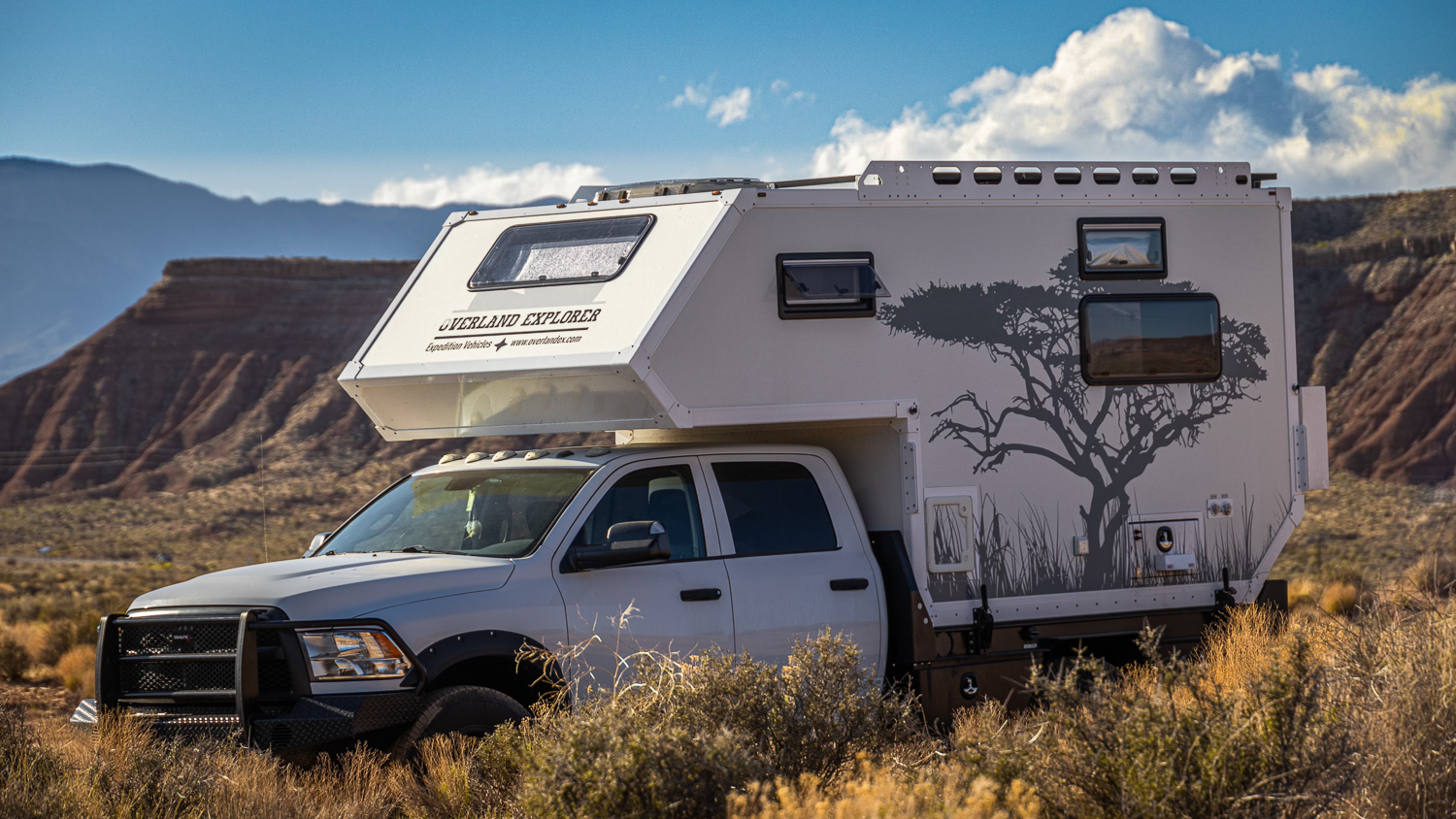

Additional leaf springs, Timbren bump stops, and a Dana 60 rear axle were added by Kevin prior to Lindsey’s ownership of the 2014 Ram 3500. She swapped in a set of LT295/70R18 Yokohama Geolandar AT tires and took the truck to a suspension shop in Buffalo (Buffalo Spring) to assess the weight. “They looked everything over and said they wouldn’t change anything,” Lindsey says. “It doesn’t sag at all. I’ve towed a motorcycle and motorcycle trailer with it. I’m not flying up any hills, but that’s fine.” She also re-did the front grille, using Plasti Dip spray to create a matte black effect, and added a TrailFX bumper guard and front fender flares.

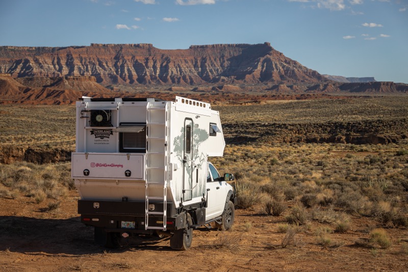

When Lindsey picked up the truck and camper in Salt Lake City, there were only 19,000 miles on the odometer, and although the camper felt brand-new, it was an early version that required a few adjustments to complement her lifestyle. “I love this camper. I don’t know if there’s another camper out there that suits my needs, but because it was a bare-bones prototype, there wasn’t an easy way to get in and out of the camper, and it had these massive fold-out stairs that sat 45 inches off the ground.”

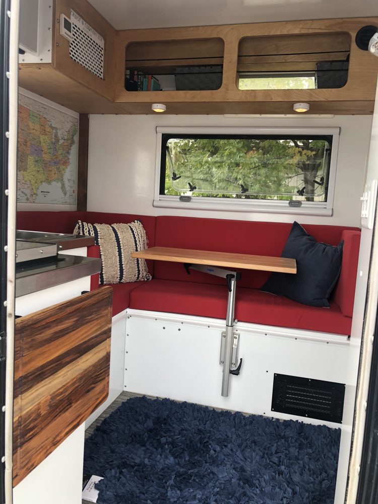

Kszos and her father worked together to engineer a new folding step and ski box, and added a hot water system, solar, new batteries, an air conditioner, installed two large windows, and a table that converts to a standing desk.

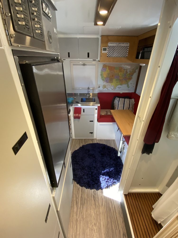

She chose a Van Life Tech hot water system for the build. “With my Airstream, I had to wait 30 minutes for the water to heat up if I wanted to do dishes or take a shower. [In the X10] you actually step up into the shower because it’s not gravity-drained. I can take as long of a hot shower as I have water supply. I have a 42-gallon freshwater tank, and it’s a recirculating water pump, so it’s constantly hot, which, if you’re in a town where there isn’t a Planet Fitness, it’s nice, especially after skiing.”

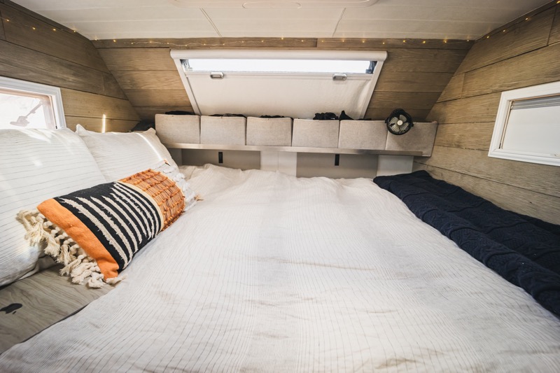

Ample living space was important to Kszos for several reasons. The height of the camper is around six-foot-eight, and at five-foot-ten with a propensity for claustrophobia, Lindsey feels comfortable working and living inside. Two large Tern Overland windows, one located on the front of the camper, and one on the side wall, allow plenty of natural light inside.
The camper is equipped with three 330-watt solar panels, four Lion Energy 100-amp-hour lithium batteries, and a Victron solar charger. “I went oversize with my battery bank and solar,” Lindsey says. “I have never had to plug this rig in, and it’s my third winter [living in the camper].” To keep her laptop, tablet, and Verizon hotspot charged, several 110-volt outlets were added. Sufficient power is also required to charge her ski boots and gloves, which are all lithium-battery heated. “Skiing is a big passion of mine. I try to get out on the mountain 50 days a year, which, while working full-time, is harder to do than it sounds. So that is a big component.”
The custom-made standing desk adds a much-needed ergonomic benefit to Lindsey’s lifestyle. “The biggest physical change for me is all the driving. I’m on a pretty regiment stretching routine now, but that’s after having lower back and hip problems. I’m more active in a sense of being outside, like I’ll take a 30-minute work break during the day and go for a walk or hike, but I’m also more sedentary at the same time.”
