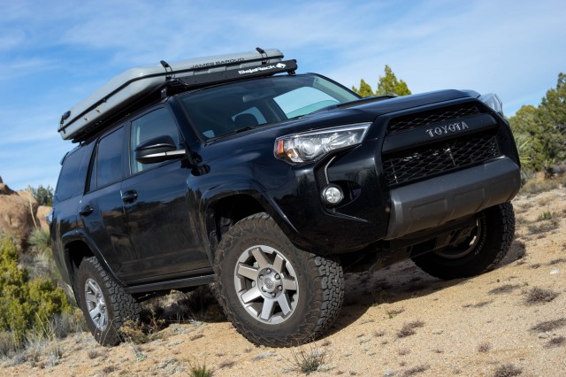

A level stance can be expected with the Bilstein system when paired with Sway-A-Way’s rear springs.
Bilstein has done a great job mixing OEM-engineering with suspension performance to give the overlander nearly everything they need, with long-term reliability to boot. Developed in conjunction with Toyota’s TRD Pro program, the Bilstein 6112, 5160 combination provides significantly increased fluid capacity and dampening performance, without the pitfalls of most other performance suspension systems. It is essentially the same system you can buy from Toyota TRD as a factory part, with the added benefit of adjustable front ride-height perches.
