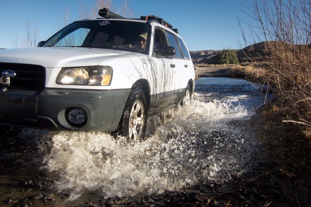

I have a confession to make: when I accepted this assignment I had serious doubts. Before this project I had never thought of a Subaru as anything more than gravel-flinging fun. I found the idea of a mere Forester attacking moderate trails laughable, and I pushed forward expecting to gain little more than a rally-inspired softroader. During a recent trip over the Mojave Road the little Foz shattered all doubts with it’s nimble capability. In the sand and washboard it was the speed demon we expected, cruising along comfortably at around 50mph. On the rocky hill climb after Fort Piute, a trail which rates nearly a 3 after recent storms, it was shockingly unstoppable. We managed to run the entire 140-mile trail in under 24 hours (sight-seeing and camping included) without a single issue.

Out on the Mojave we had the opportunity to thoroughly hammer our shiny new skid plates over the rocky moderate sections of the trail. We also tested the integrity of the skids against a few unexpected impacts at speeds in excess of 65mph*. At one point we pulled to a stop certain we would find something broken, but a quick inspection revealed little more than a scratch on the surface of the wide front skid plate. Needless to say, we were quite impressed. (*performed by a professional driver under controlled conditions, do not attempt, yada-yada…)
