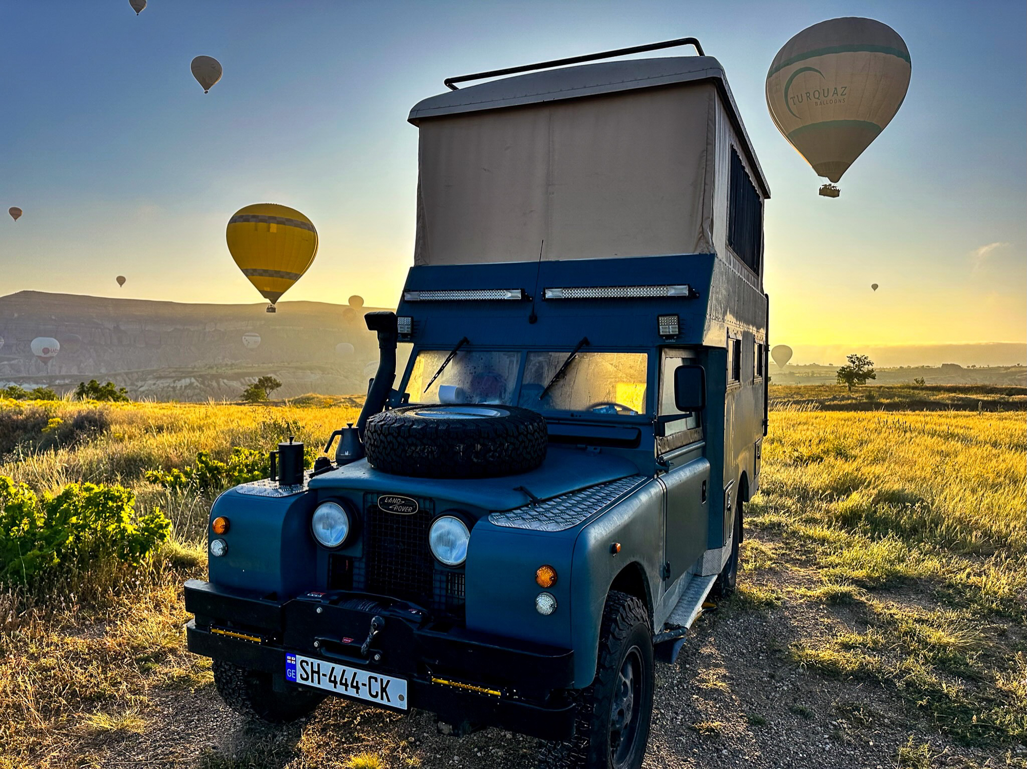

Sean Walker became Sir Shackleton’s faithful first mate. Rather than restoring Shack to 1966 specs, Sean envisioned using the vehicle as a live-in camper. Viktor had already stripped Shack down to the frame, so it was the right time to start fresh. Shack’s paint layers indicated his storied history, working down to his white and red Red Cross markings, then farther down to the original Land Rover bronze green. The ambitious restoration, which took place in Georgia, required a full crew. In addition to Viktor, Sean’s friends Dima, Soso, Shota, and Otari were essential to the project.
Sean used his mechanical engineering background and extensive travel experience to outfit Shack for overland travel. He already owned a 2010 Defender 110, which he purchased new while living in Germany. Not only was it his daily driver until he began traveling in Shack, but he also used the 110 to travel extensively throughout nearly every country in Europe and Baja California, Mexico. From all that experience, Sean and his partner, Alicia, knew what they needed for long-term overland travel.
Sean admires the look of the early Series 2a, including the inset headlights, doors, and capping. So as much as was practical, he sought to retain the 1966 Series aesthetic on the outside of the vehicle, down to the limestone roof and another legendary Land Rover color, marine blue.
Exterior appearances aside, the emphasis is on comfort and functionality—not classic specs. Due to exorbitant shipping costs into Georgia, Sean bought a donor vehicle for parts. The 1995 Land Rover Discovery 1 supplied Shack with a 2.5-liter turbo-diesel engine, front and rear axles, a transfer case, a wiring harness, an instrument cluster, a power and steering pump, aluminum wheels, and more. Some Disco parts were customized to fit Shack, like the front sway bar engineered to work as a rear sway bar.
land rover front seats and steering wheel
land rover interior camper
According to Sean, “It is incredibly comfortable, even luxurious, to live in Shack because we [designed] it to our exact needs and wants.” A cursory glance at the long list of camper modifications makes this clear. A filling water pump loads an 80-liter custom water tank, passing through a 10-micron filter. A separate distribution pump directs the water through another round of filtration, this time a 5-micron charcoal drinking water filter with an integrated UV treatment. The water can be used from the outdoor pressurized shower or gooseneck faucet sink inside.
The couple can cook indoors on a two-burner propane stovetop, but instead, they find themselves using the Partner Steel Cook Partner two-burner stove secured on one of their rear doors. It connects to a propane tank mounted on the exterior side. A fold-down prep table occupies the opposite door, making it convenient to prepare meals outdoors. A spacious 90-liter National Luna dual-compartment fridge/freezer holds perishable food until mealtimes.
For all of Sean’s previous travels, this is the first vehicle he’s owned with a bed; he says it’s a game-changer. A pop-top roof uses four 12-volt electric actuators to vertically extend the entire roof. Surrounded by the resulting Seams So Fine custom canvas material, there is a Nectar queen-size memory foam bed. Inside their wheeled home, the couple can be comfortable in the tropics thanks to a Dometic RTX 1000 24-volt air-conditioning unit. Two roof-mounted Maxxair Maxxfans supply even more circulation.
These devices are powered by a 160-amp-hour lithium-ion phosphate battery bank with a Victron charging system, feeding into a 3,000-watt inverter. There are three USB-C high-power device charging points throughout the camper, as well as LED puck lighting with dimmer switches on separate circuits for upstairs and downstairs. If only Shack’s 1966 military cadre could see him now.

As the couple set out from Georgia, Sean admits parts of Shack were breaking constantly. “I often joke that I took this time off work to learn how to really travel, but instead, I have learned to become a mechanic, a plumber, an electrician, and a carpenter.” By the time they reached Africa, most of the gremlins had been ousted.
Driving Shack is a remarkable adventure of its own. “Visibility out the back is terrible,” Sean confesses. “His top ‘comfortable’ highway speed is about 90 km/hr. Suspension is improved from the original but still quite stiff without much travel. He is also top-heavy and just heavy in general. He is quite capable off-road, but you also need to drive super slow. In all, driving a vehicle like Shack forces you to slow down the entire trip and encourages you to get off the highway and take the side roads.”
