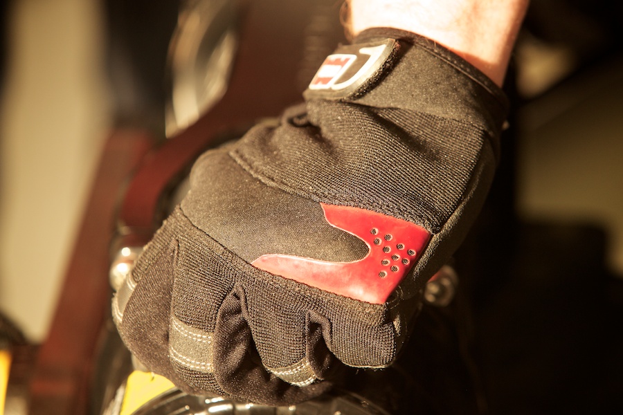

A close-up of a hand wearing striped White Mule work gloves, gripping a dark object, possibly machinery, with warm lighting highlighting the glove. Avoid loose fitting gloves like these – the extra material and loss of dexterity just result in the pinching hazard they are attempting to protect against.
A brief review of other commercial and recreational environments where rigging, connections, pinch hazards, etc. exist, they all specify and use a form fitting glove. This is true of aircraft loadmasters as much as it is for technical climbing.  A review of the attributes consistent with ice climbing gloves, mountaineering gloves, etc., all where maximum protection and dexterity is required demonstrates the importance of fit. Climbers and load masters all deal with ropes, cables, pulleys and connection points. Leave those loose fitting gloves to your grandma’s garden. . .

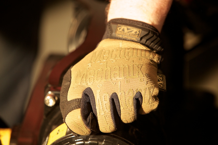

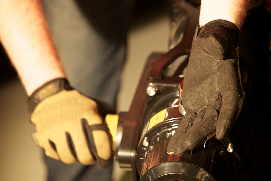

Mechanix Original: $24 (Made in Vietnam)
Close-up of two winch gloves gripping and adjusting a piece of machinery, with one hand on a handle and the other fine-tuning a metallic control. Warm, focused lighting highlights the gloves and equipment in action.
The Original Mechanix Wear gloves provide minimal protection, but maximum dexterity and sensitivity. In nearly all recovery scenarios, these gloves are barely acceptable, principally if abrasion or cutting hazards exist. The glove is made from simulated leather comprising nylon and polyurethane (Palm) and knitted fabric comprising 99% nylon and 1% spandex (back). These gloves can serve as light work gloves and driving gloves, but little else.
mechanix.com/tactical/the-original-coyote-glove A close-up of a person wearing tan and black Mechanix Wear work gloves, gripping a piece of equipment. The glove branding is visible, and the lighting highlights the hand and part of the machinery.
Pros: Maximum dexterity and sensitivity Excellent repair/driving gloves Good in warm weather
Cons: Thin material Limited protection Not suitable for most recovery operations

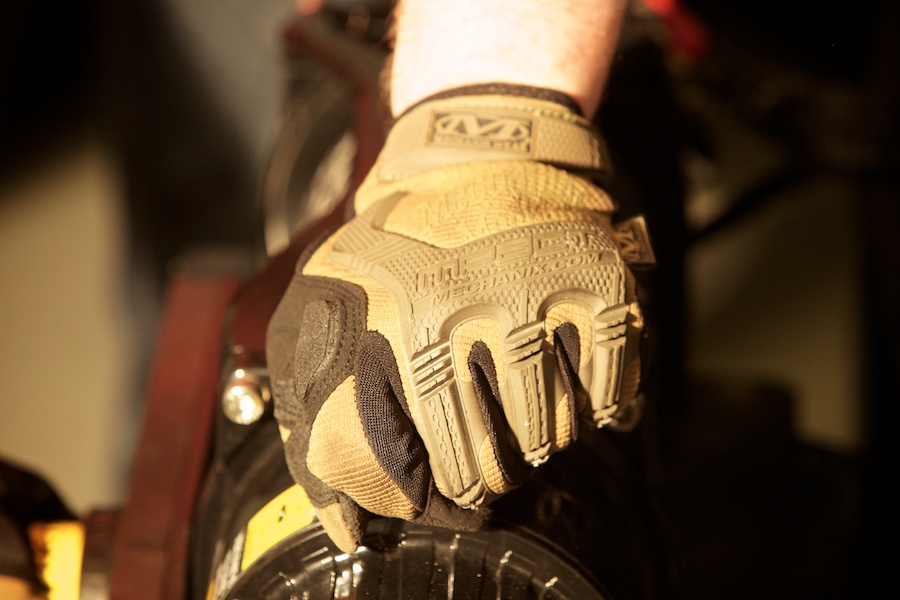

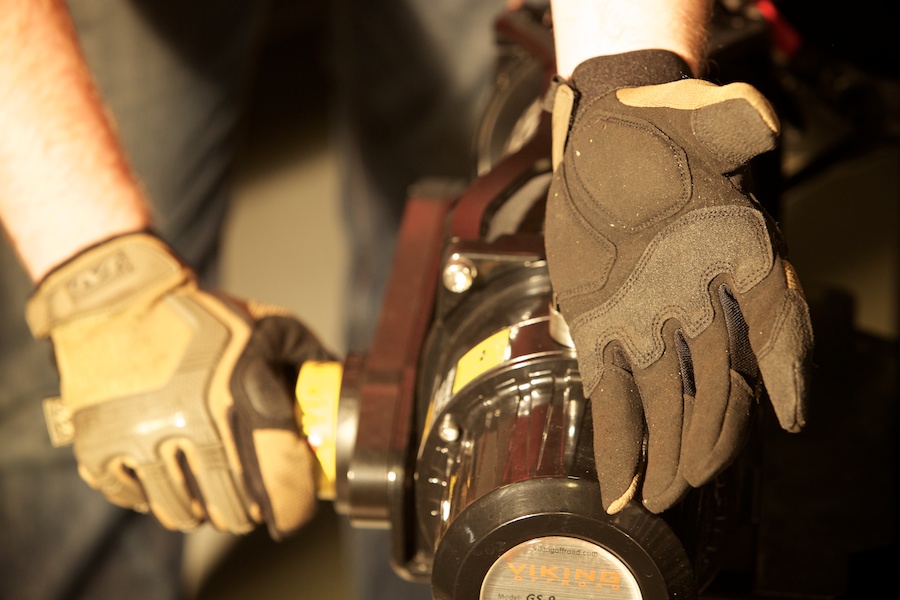

Mechanix M-PACT: $34 (Made in Vietnam)
Close-up of a person wearing work gloves, operating a large mechanical device or piece of industrial equipment, with their hands gripping a yellow and black component.
These gloves are quite popular, particularly with military units, and for good reason: High breathability and effective impact protection.  They are adequate for recovery operations and general trail work, but will ultimately lack the durability and heat/fire protection for long-term use on extended trips.
mechanix.com/tactical/m-pact-coyote-glove
 A close-up of a person's hand wearing rugged, tan and black winch gloves gripping a metal object, with soft lighting highlighting the glove's textured surface.
Pros: The perfect desert glove Good dexterity and sensitivity Good impact protection
Cons: Finger tips lack durability Light abrasion protection Synthetic material limits heat protection

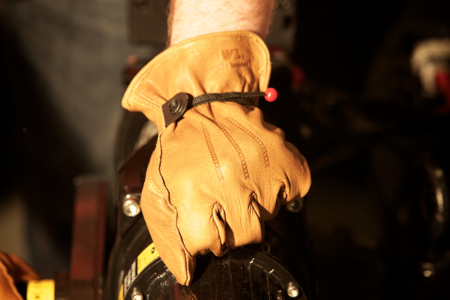

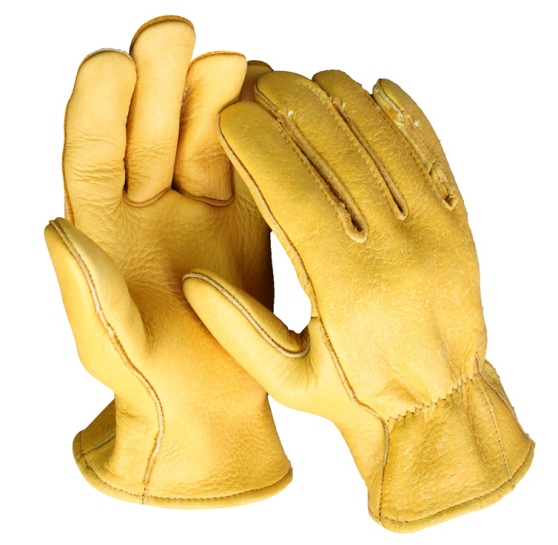

Cowhide Work Glove: Available and made nearly everywhere ($12-$60)
A person wearing tan winch gloves is operating a machine labeled Viking using both hands. The scene is brightly lit, with a focus on the gloves and machinery components.

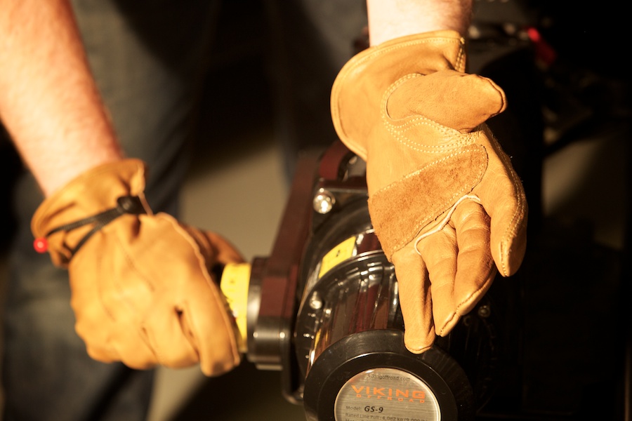

We bought this pair from True Value, a local hardware store, but gloves like this are available just about everywhere.  So this is not a review of a particular brand (these are Wells Lamont), but an overview of the important characteristics.  For material, cowhide, elkhide and bisonhide all have advantages, but a thicker, stronger hide is a good place to start. Stitching comes next, with an inspection of the seams, particularly at the fingertips.  Look for double-stitching where appropriate and an additional wear panel at the palm for abrasion resistance. The cuff should also have a means of closing around the wrist to help prevent dirt/mud/snow from coming into the glove.  Don’t underestimate the standard leather work glove as a good, value option.
alt
Pros: Readily available Low cost Good abrasion and heat protection
Cons: Mixed quality, so research a good brand Can be warm in hot climates Moderate dexterity and sensitivity

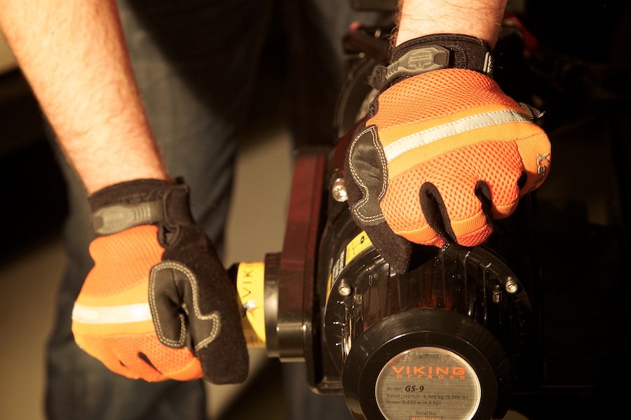

Ergodyne ProFlex Insulated: $25 (Made in Indonesia)

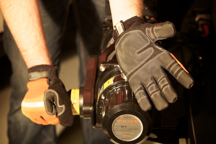

We often travel in cold environments, so a proper recovery glove with insulation needs to be part of the lineup. This Ergodyne glove is the best example we have used, with high visibility, Thinsulate 40-gram insulation, reinforced palms and effective dexterity/sensitivity. These are the gloves we use for all conditions ranging from 0-60F and sometimes below zero. We crossed the largest glacier in all of Europe using Land Cruisers on 44” tires and these were the gloves of choice. They are effective for driving and all recovery operations.  They are high visibility with a bright orange back panel and reflective tape. They have limited heat protection, given the all-synthetic construction. At $25, they are a bargain.
vikingoffroad.com/ergodyne-hi-vis-proflex-gloves-l-872
A person wearing orange and black winch gloves adjusts or inspects a black Viking-branded industrial machine part, with hands positioned on either side of the device.
Pros: Perfect cold weather recovery glove Great value High visibility Good protection
Cons: Limited heat protection (fire, etc) Limited impact protection

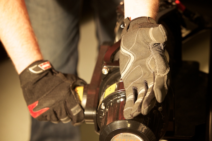

Warn Recovery Gloves: $25 (Made in Pakistan)
A person wearing black work gloves operates a large, heavy-duty machine with both hands, turning a yellow-handled lever and gripping a metal component under bright lighting—ideal for those seeking durable winch gloves.
Warn knows recovery, and their newest gloves reflects their experience.  This form fitting glove has a breathable back panel and a terry cloth thumb panel.  On the palm, the glove is all business with generous protection and a Kevlar reinforced wear panel. Padding is provided at impact points, while articulation channels allow for good dexterity and range of motion. These gloves are comfortable to wear, although I found the fingers to be a bit longer than others. Heat/fire protection is limited with the all-synthetic construction and the all-black color makes visibility a challenge with marshaling/spotting operations.
warn.com/truck/accessories/winching_gloves.shtml A close-up of a gloved hand gripping the handlebar of a motorcycle, featuring black and red winch gloves details, with sunlight highlighting the scene.
Pros: Good protection Quality materials Comfortable fit
Cons: Low visibility (all black) Long fingers Limited heat/fire protection

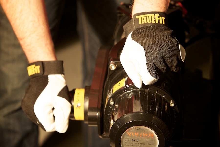

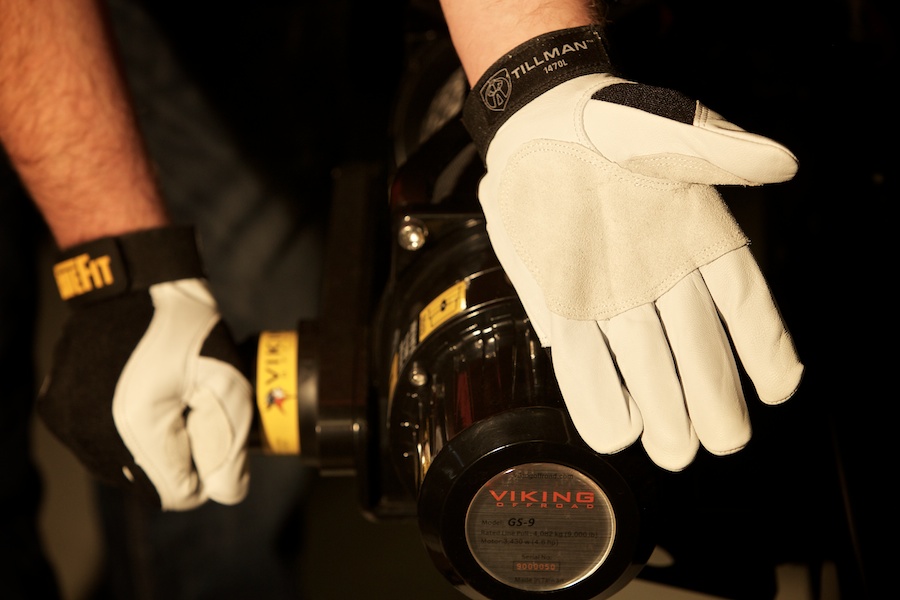

Tillman TrueFit: $15 (Made in China)
A person wearing black and white work gloves is gripping and adjusting a large metal valve labeled Viking 65-9 in a dimly lit setting. These durable recovery gloves ensure safety and control during demanding tasks.
The TrueFit is an ideal warm/moderate weather recovery glove, ticking all the important boxes for fit, materials, quality and visibility. Made from top grain goat skin, the palm also includes a suede panel for improved abrasion resistance and grip. The fit is snug, providing good dexterity and sensitivity, but the leather material still offers adequate protection.  The back panel is black spandex, but lined with cotton for comfort. With the white leather, visibility of the palm is excellent, but the black rear panel only shows visibility from the leather at the fingertips. This is a lightweight recovery glove that performs well in warm climates while still offering excellent abrasion, cutting and heat protection.  Impact protection is limited, but at only $15, this glove is the runaway value champion!
vikingoffroad.com/tillman-truefit-gloves-xl
Tillman Gloves
Pros: Quality materials Comfortable fit Good dexterity Good visibility on palm
Cons: Black rear panel limits visibility Limited impact protection
