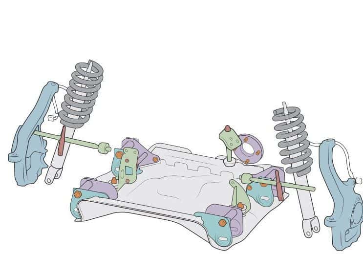

The biggest boost in price came from the suspension system. When lifting a solid axle vehicle like the 2500, most things are fairly straight forward. When you want to lift an independent front suspension 4″ however, the process is a lot more complex.  The first components used in the 1500 dual sport package are military grade A206 T4 cast aluminum steering knuckles, which reduce the un-sprung weight. These were an industry first, so AEV was forced to do a lot of testing and development.
A white RAM 2500 pickup truck drives quickly on a dirt road, kicking up dust—an ideal Overlander adventure, with bare trees and a cloudy sky in the background.
Then the real trickery began. Many of you may have noticed in other articles that a 4 mm thick stamped steel skid plate is used to protect the vitals of the vehicle and improve ground clearance. This was already an additional option that the prospector does not include, but this bash plate does more than just shield your oil pan. AEV removed the front axle center from the engine mounts and made it chassis mounted via bushings to the skid plate. “This avoids the inner CV plunge-limited travel restriction that is otherwise needed due to the torque-roll of the engine mounted front-axle. An effect that becomes much worse if  the axle is just spaced down from engine.”
Illustration of an overland car suspension system, showing springs, shock absorbers, brake calipers, and mounting points connected to a central chassis component.
They also moved the front hubs forward 8 mm for improved front tire clearance without fender trimming, and adjusted the rear OE suspension to preserve the pinion angle and geometry without drop brackets, which would have decreased clearance and reduce anti-squat. Despite all these changes, AEV managed to preserve the stock steering and and front suspension geometry, while compensating for the additional 4″ of lift.

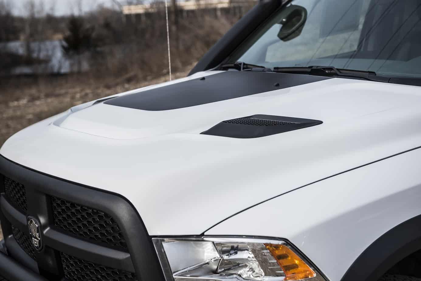

While the bulk of the price increase lay in the suspension and skid plate, there were a few additional factors to be accounted for. The base 2500 prospector package assumes the use of a Tradesman black grill, however the 1500 requires a grille and headlight filler panel replacement. This swap allows AEV to install their heat reduction hood, which completes the HD front end transformation.

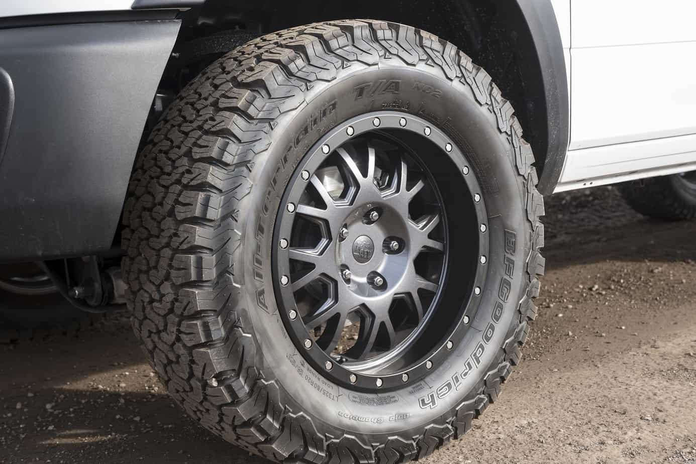

The four inches of lift on the IFS also necessitates the use of 20″ aluminum wheels. This alone is somewhat of a blow for the Recruit, but the larger wheels also cost more than the 17″ models used on the prospector, which is really hitting below the belt for buyers. Fortunately, we hear rumors from within of an 18″ wheel in the works, along with a modification package to allow for a safe and reliable fitment.
