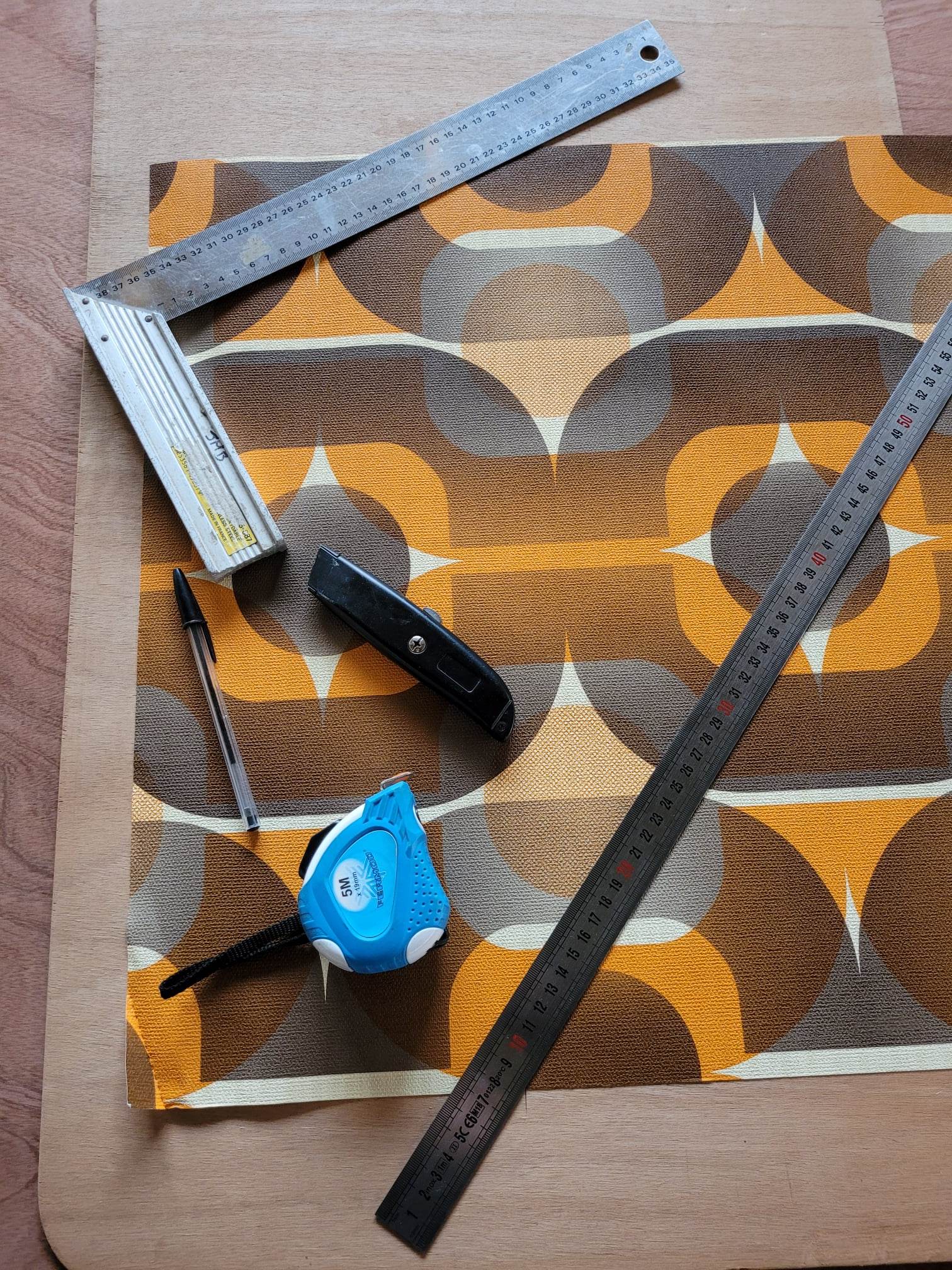

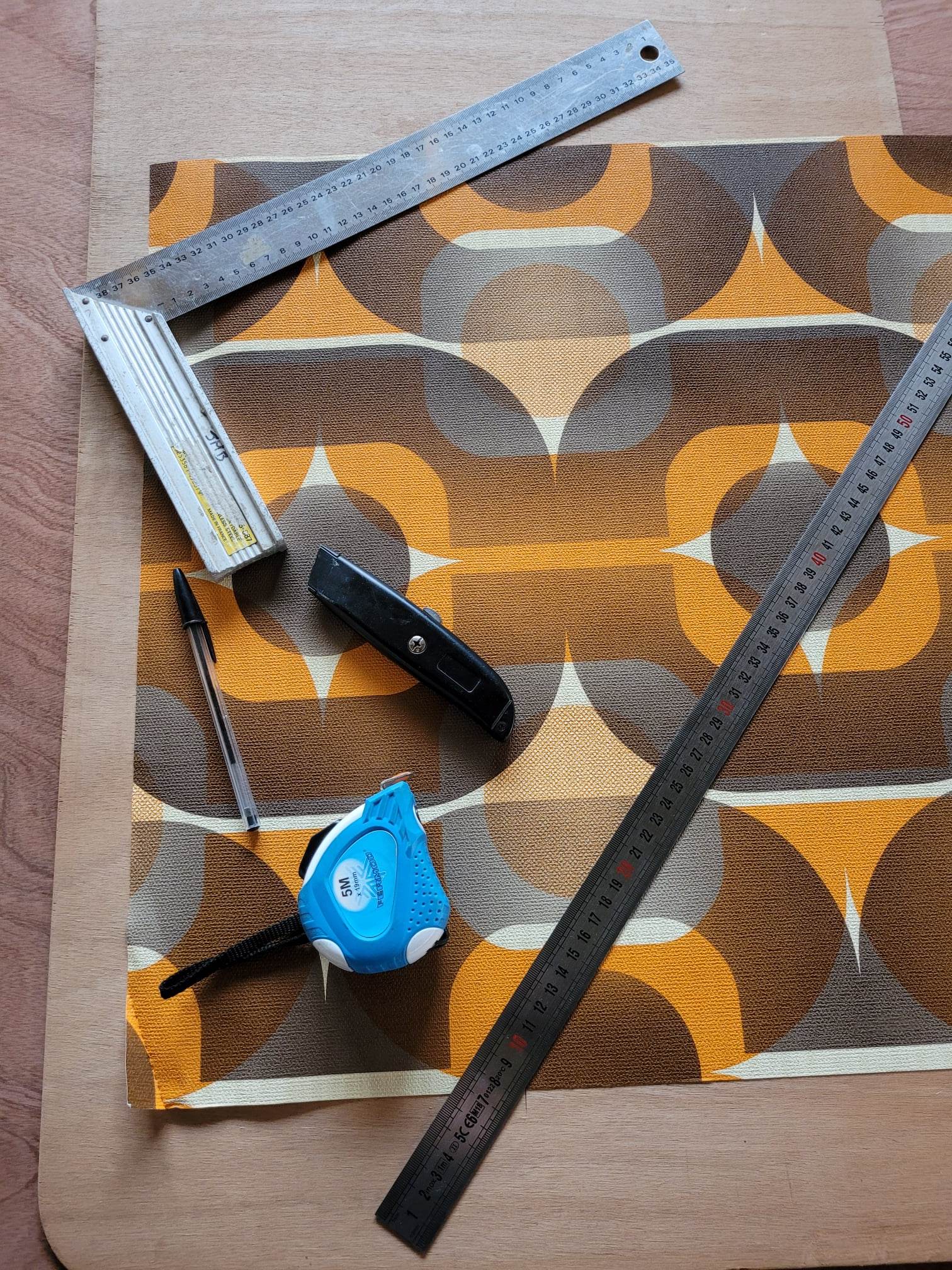

They carefully considered how the wallpaper would fit and then marked the measurements and lines on the wallpaper. To cater to the irregular joints in the corners, they drew reference points with a wooden pencil to ensure the wallpaper stayed straight and didn’t adhere to the joints. They also marked where to apply the glue to ensure everything was perfectly aligned.

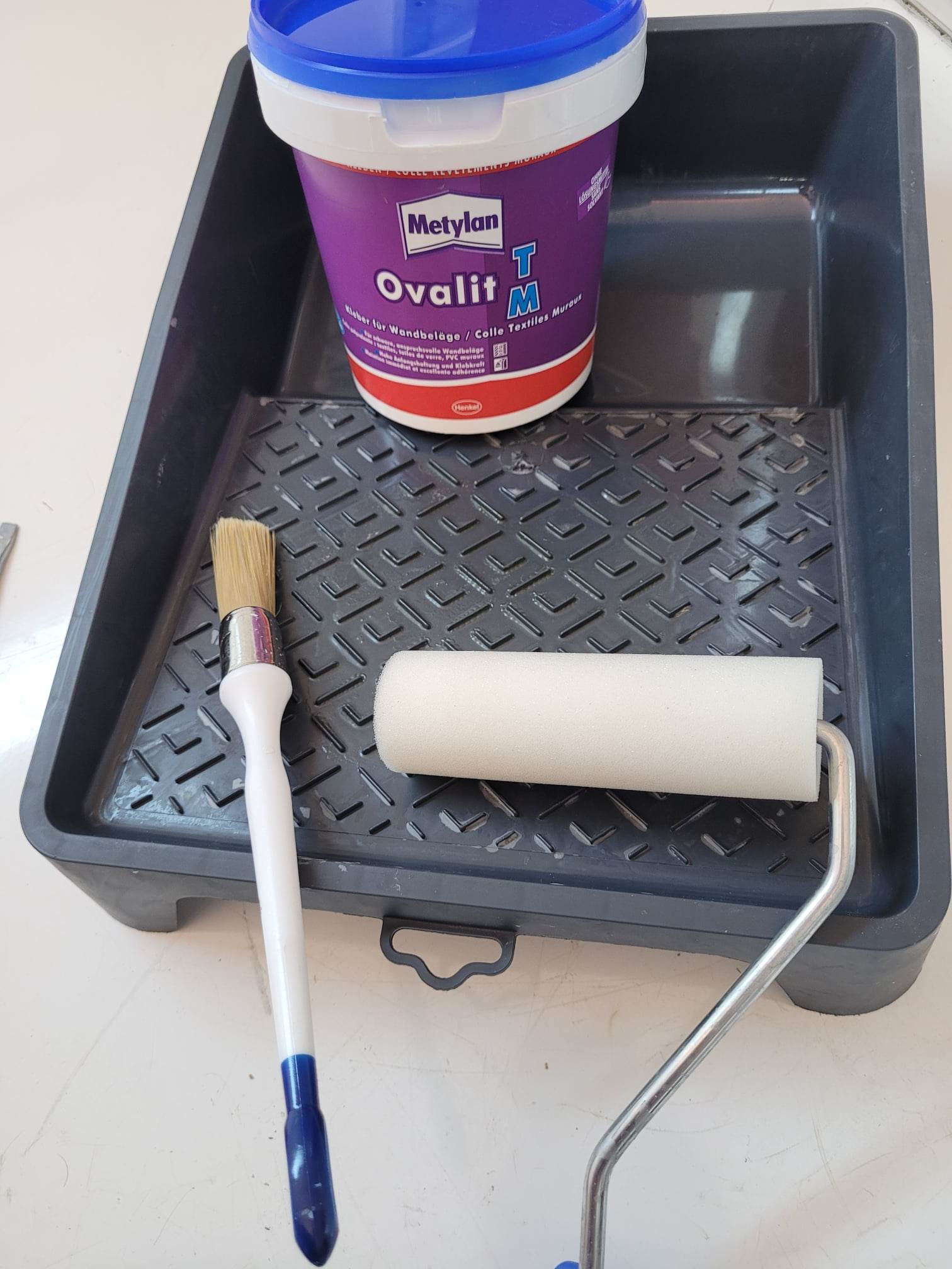

As the standard wallpapering roller proved unsuitable for the project, I suggested they use a narrower one made of foam, similar to a varnish roller. It turned out to be just right, as it didn’t soak up too much glue, allowing them to apply just the right amount to the wall.
The most challenging task for them was finding the right glue—an adhesive capable of working with their surface constraints and handling temperature changes. The recommendation was to use a glue called Metylan Ovalit TM, which is suitable for most types of non-woven wallpapers and free from strong odours, an essential quality for the confined spaces of a truck.
