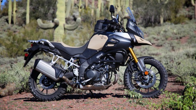

IMG_9384
The after image with the tires and guards in place gives the bike the visual attributes it sorely needed.
IMG_5229
Bone stock at $12,000 the V-Strom is a great bike, but nowhere near ready for off-road riding of any kind.

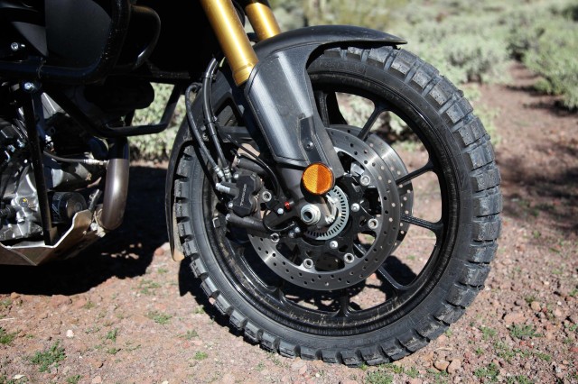

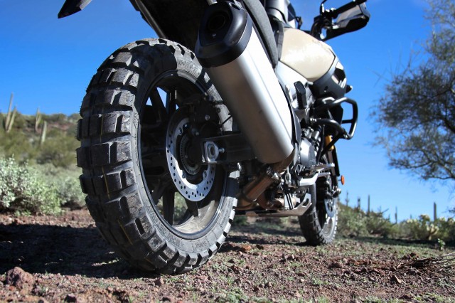

Mitas MC60 Tires Front and Rear
Although the stock road-biased tires made quick and fun work of our local mountain roads, they were by no means up to the task of tackling our preferred dirt tracks. Seeing another opportunity to test the latest offering from Mitas, we installed a pair of MC60s and the results have been remarkable. The Mitas tires gave the V-Strom sure footing in the ugliest terrain, and although the road manners are obviously altered, the MC60 does pair to the tarmac with good handling and feedback. I noticed they didn’t have the peculiar break-over that plagues some knobbies when coaxed hard into a lean. Stability at the upper reaches of the speedometer reveal modest fluidity but not nearly enough to cause concern. We acquired our Mitas tires through Twisted Throttle. twistedthrottle.com

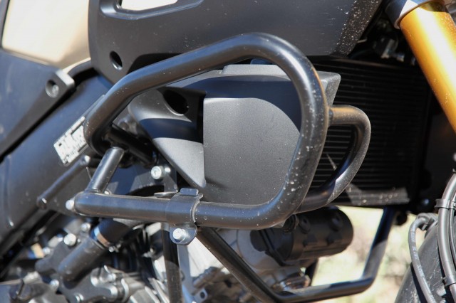

It’s safe to say a lot of factory crash bars seem to lack substance, but such cannot be said of Suzuki’s factory option. In fact, they might be a tad overdone, at least in sheer weight. They are heavy. If there’s anything to improve on other than the heft, it might be with the lack of coverage higher up on the tank where damage might prove to be most expensive. Early reports from within the industry’s press corp reported significant damage, even in modest tip-overs, and though not having done so ourselves, we can see how that could be very true.

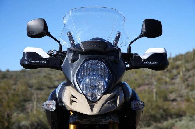

Even with the full coverage front fender, something that may have to be removed in the immediate future, we opted to install a small Touratech radiator guard to protect against stone damage. The only other protection we added was a pair of Touratech hand guards. It might be necessary to improve on the brawn of those guards with something more substantial.

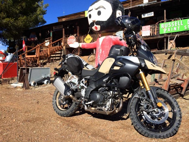

Other minor but important farkles included Touratech’s wider all-metal pegs and a locking GPS mount for our Garmin 660LM. Beyond that, we occasionally fit the bike with an Enduristan tank bag, as well as Kriega and Giant Loop soft luggage. If we add anything in the coming weeks, it might be a luggage rack for more gear fitment options and perhaps auxiliary lights for better visibility.
