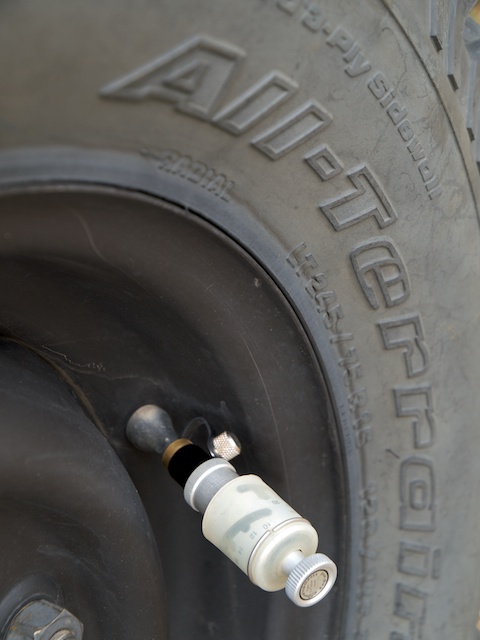

2.  Tires and Tire Pressure/Repair:
Match the tread to conditions and limit increase in tire diameter to +60mm. Install a high-volume, 100% duty-cycle compressor.
Tires are the most frequent failure-mode during overland travel.  Selecting the correct tires for the load and terrain is essential for reliability and traction.  It is recommended that the tire height not increase more than two-inches larger than the largest standard tire for that vehicle in stock configuration.  It is also recommended that the tire width increase be limited or if possible, kept at the same width as stock.  This will allow full compression travel and full turning radius. Select the tread design based on the environments you will likely be traveling in.  Match the load rating to GVWR and ensure that only LT (Light Truck) tires are used.
Along with a quality tire, a means of adjusting tire pressure and repairing punctures will be a frequent requirement. A good compressor should be fitted to the vehicle, along with an efficient means of deflation/adjustment (or else the tendency will be not to deflate them).  A comprehensive tire repair kit should be a permanent addition to the vehicle kit.

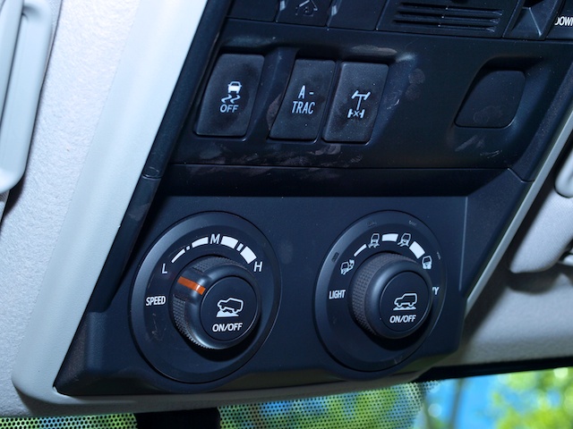

6.  Traction:
When conditions dictate, install or option driver-selectable locking differentials.
Many overland adventures include technical terrain or rapidly changing conditions (think rainy season coming three-weeks early to Guatemala).  Traction performance is achieved through tire design, suspension articulation and traction-aiding devices.  Traction-aiding devices vary from computer driven brake-traction-control to driver-selectable locking differentials.  Additional options include clutch-style limited slip units and mechanical/automatic differentials like the Detroit locker.  Mechanical differentials have the advantage of reliability and simplicity, but are not selectable, which can result in unwanted or unpredictable handling characteristics. Ultimately, factory-fitted selectable locking differentials are best, like those found in the Mercedes G-Class, some Toyotas and the Jeep Rubicon.

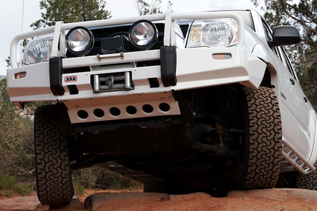

Think of the front bumper and underbody skid plates as an insurance policy.  Driving in the third world is the most dangerous thing we do as travelers and even the smallest accident can leave a vehicle inoperable – the vehicle is your lifeline, home and means of completing your adventure.  Install a solid, frame-mounted from bumper that protects the headlights and radiator from impact. Hitting an Impala at 120 KPH can total a vehicle and leave you stranded.  The front bumper should also serve as a mount for a winch and auxiliary lighting.
Secondarily, the steering, differentials and engine/transmission/transfer case should also be protected from damage if the road conditions dictate.  If your plans include driving off of improved surfaces, protect the soft bits that will get you home.
Tacoma ARB Bumper
