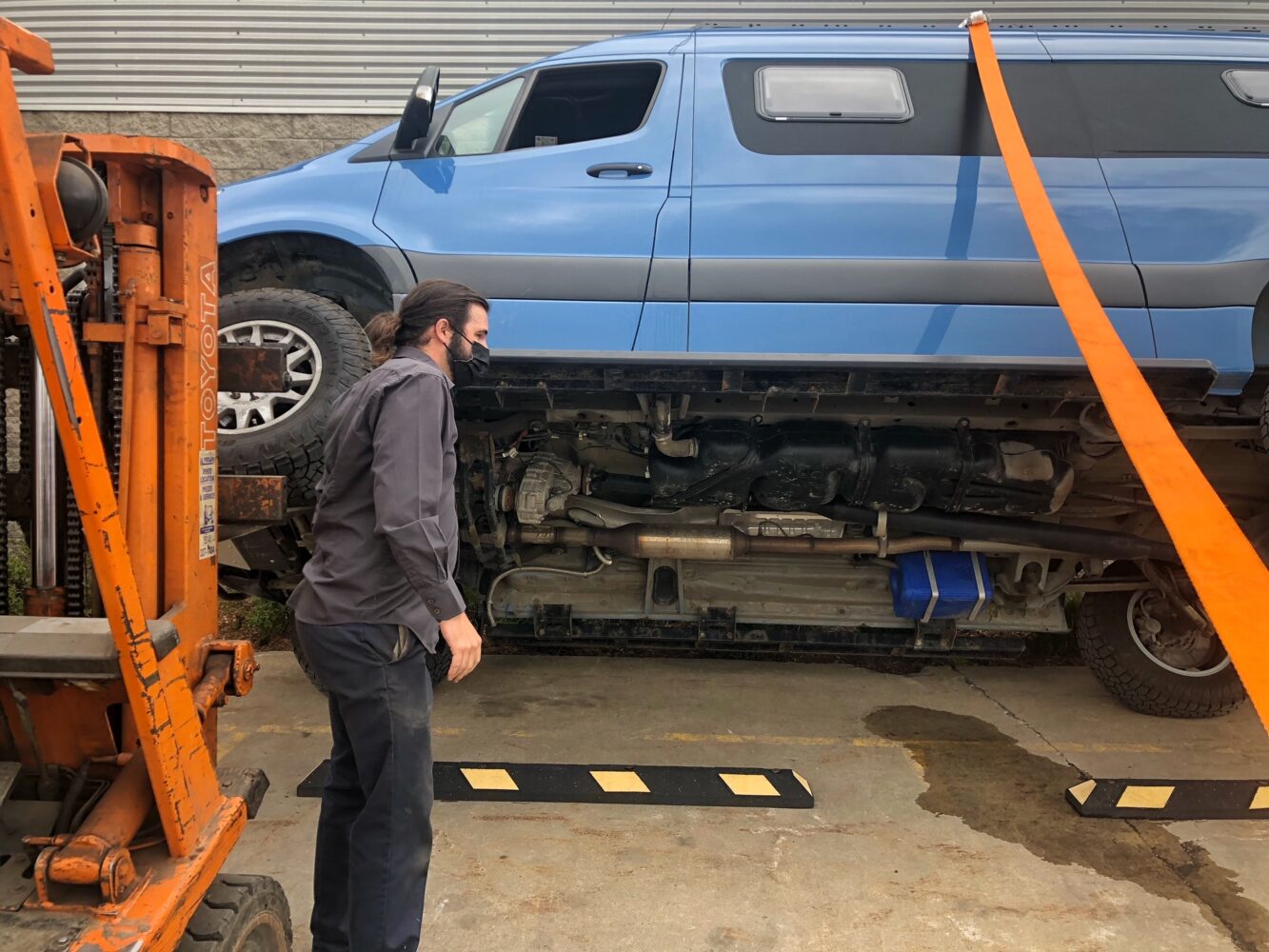

But how far could it go before tipping over? At which angle to set my inclinometer alarm? I had to know! I placed a quick call to my friend Olivier, an avid off-roader, who told me to drop by his shop at the end of the day and “we will find out.”

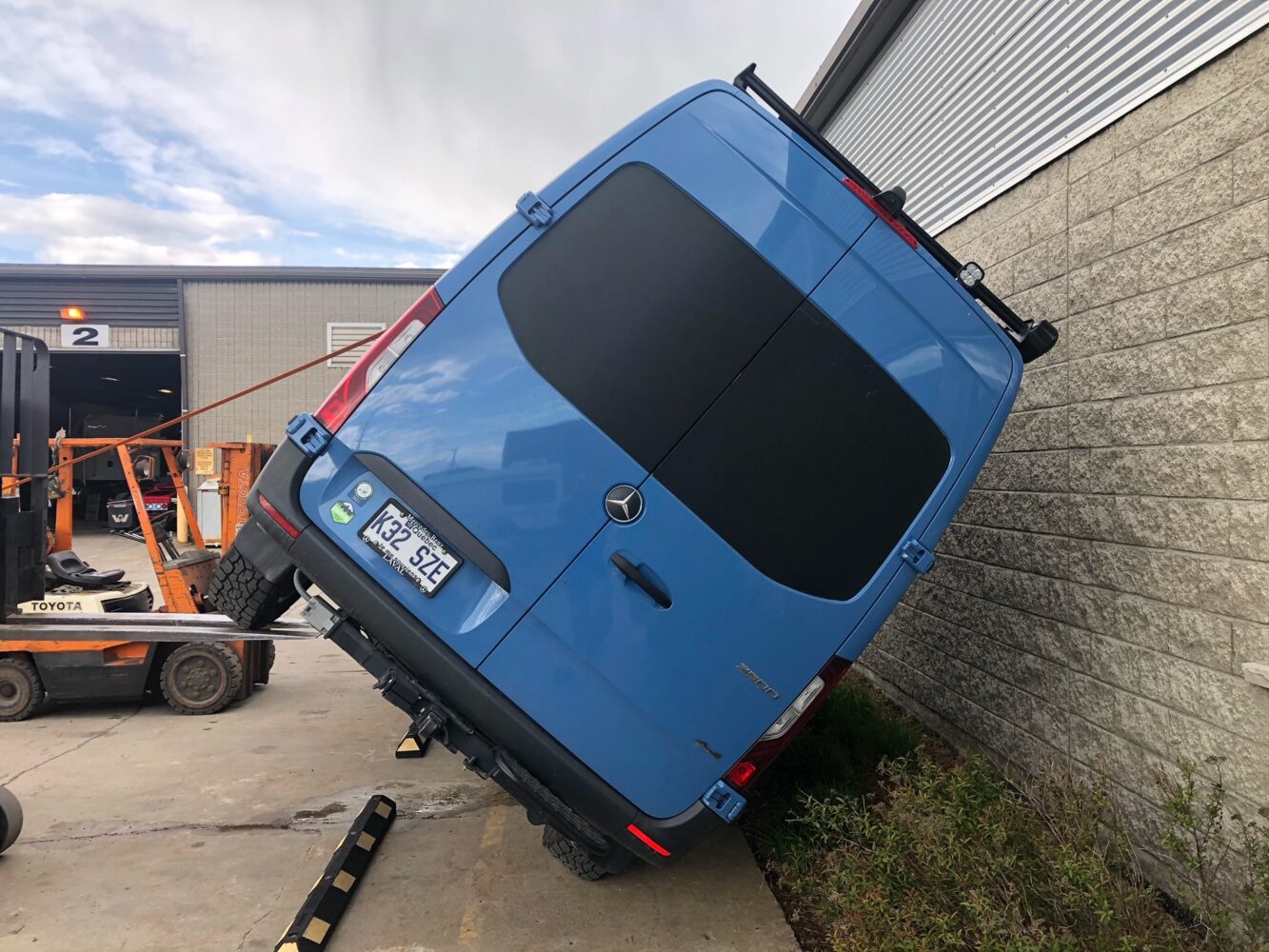

My resourceful friend had two lifts ready, one for each driver’s side wheel. We strapped the sturdy roof to his pickup truck and then parked the van close enough to a wall so that if everything went wrong, I might only have the awning to replace.
With both driver’s side wheels on the forks, we slowly lifted and lifted. At 30 degrees, we tried to lift the upper side by hand. It didn’t move, gave a little more, and then more and more. Even with the van fully packed from the last weekend’s road trip with an upper cabinet full of stuff, a 30-gallon water tank, a fridge, and a heavy electric awning on the side, we reached 43 degrees before it became light on the forks of the lift. At 45 degrees, I could move the van by hand on one side or the other.
We lowered the van a bit and took the shots. Needless to say, we were very impressed.
Disclaimer: The test was made on a solid, leveled surface with a static vehicle without people onboard. We performed this test to satisfy our curiosity, and I think we made a point that high-roof vans are not as tippy as some folks suggest.
