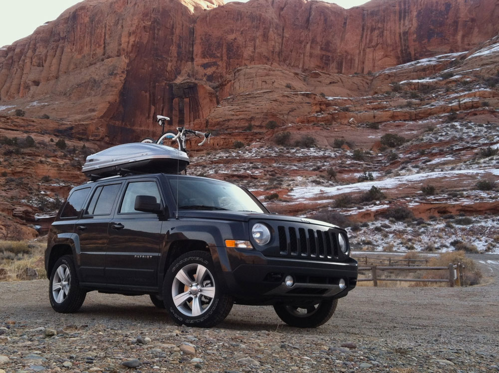

A black Jeep Overlander SUV with a rooftop cargo box is parked on a dirt road in front of red rock cliffs with patches of snow in a desert landscape.
Pictured above without the RRO lift. It really did greatly benefit from the modest 2.125″ lift.

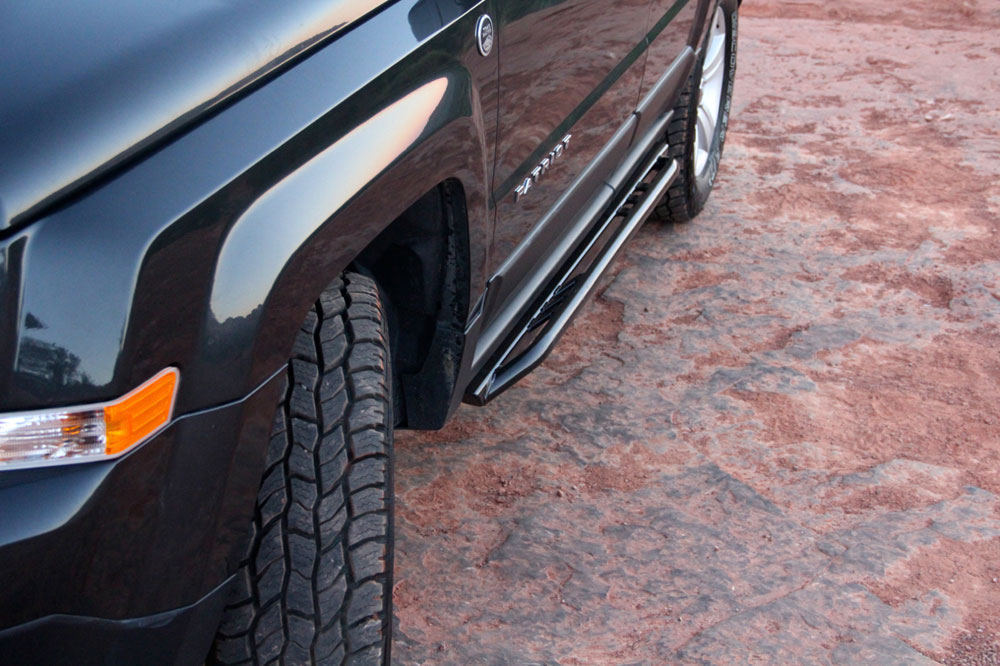

The approach and departure angles on the Patriot are actually quite impressive. This was the deal breaker for the newer Subarus we had contemplated, especially on the late model Outbacks with the long forward overhang. The one challenge with the Patriot is the long break-over. If any car needed sliders, this was it, so on went a very nice set of Rocky Road Outfitters Supersliders. Installation of the sliders was so strait forward and easy, I managed to do it myself in just a few hours with minimal fuss. I thought they were overkill until I started challenging the limits of the vehicle. I’ll cut to the chase, they’ve already been well used. Because the Trail Rated version of the Patriot is fitted with skid plates covering the vitals, we didn’t have to add any additional protection. There are still a couple exposed components under the Patriot that could use extra protection, but so far, so good.
Close-up of the front left side of a black Overlander SUV parked on reddish, textured ground, showing a rugged tire, side step, and part of the headlight and fender.
