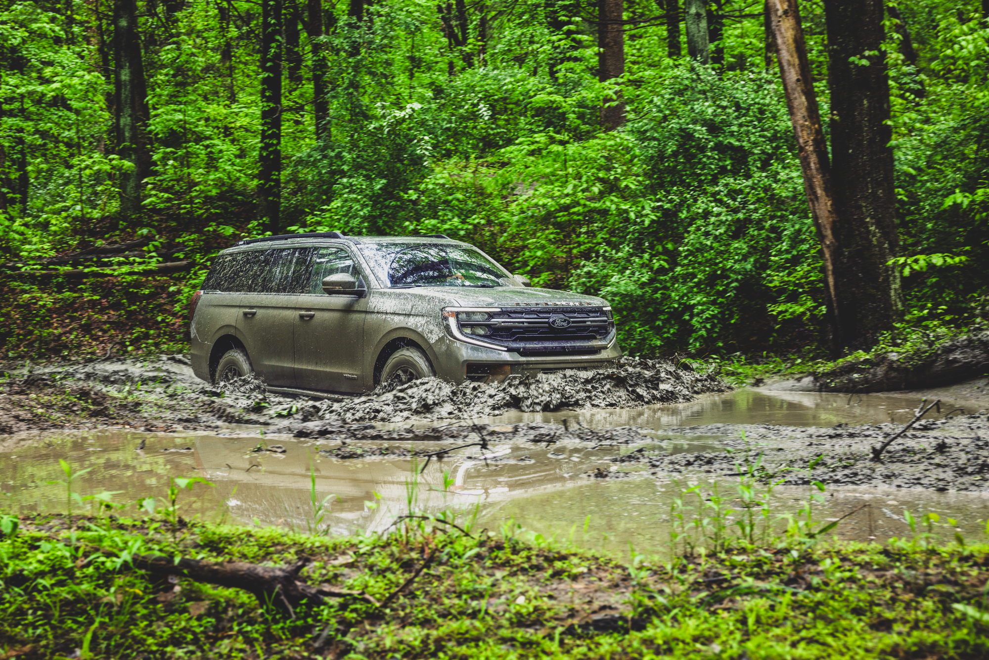

On the Trail
To be clear, the Expedition is a large SUV, with a 122-inch wheelbase and 80-inch body width. However, the capability belies its size due to the 33-inch tires, 10.6 inches of ground clearance, and a tight turning circle of 41 feet, identical to a Wrangler Unlimited. I suspected the Tremor would be adequate and that Ford would present us with the typical groomed course of manufactured climbs and dramatic wheel lifts. . . but they took a bold risk and tossed the Expedition and journalists with a wide range of 4WD skills onto a BFGoodrich Outstanding Trail, complete with steep climbs, deep mud holes, and tight forested shelf roads.
2025 Ford Expedition2025 Ford Expedition
Yes, the Expedition is big, but wow, does it make every use of the engineering and technology in the package. The tires are some of the best in class, and the rear locker helped them claw through the mud and up the rutted climbs. We even had some skid plate contact in the rocky sections, but later inspection showed no damage. Left foot braking and overall pedal modulation were excellent, with a smooth tip-in and long accelerator throw. The low-range combined with a 4.6:1 first gear and 3.73 axle ratio allowed for slow, smooth control in technical sections, and the 440 horsepower gave all the wheelspin you could dream of in the muddy spots. No, this is not a Bronco Raptor on 37s, but it is certainly the best full-size, seven-passenger SUV on the trail. The one real negative was the oval steering wheel in tight conditions, which felt awkward after 30 years of learned technique, shuffling a round wheel through my hands to maintain precise input control. It did start to feel more comfortable with some time, and the wheel was made that way to accommodate visibility of the gauge panel, but it still felt odd on the trail (I didn’t mind it on the road). I also noted that some other journalists had rear bumper contact on the trail, and the plastic covers had popped loose on their vehicles (showing gaps or distortion). The departure angle could be improved, along with the rear bumper integrity.
