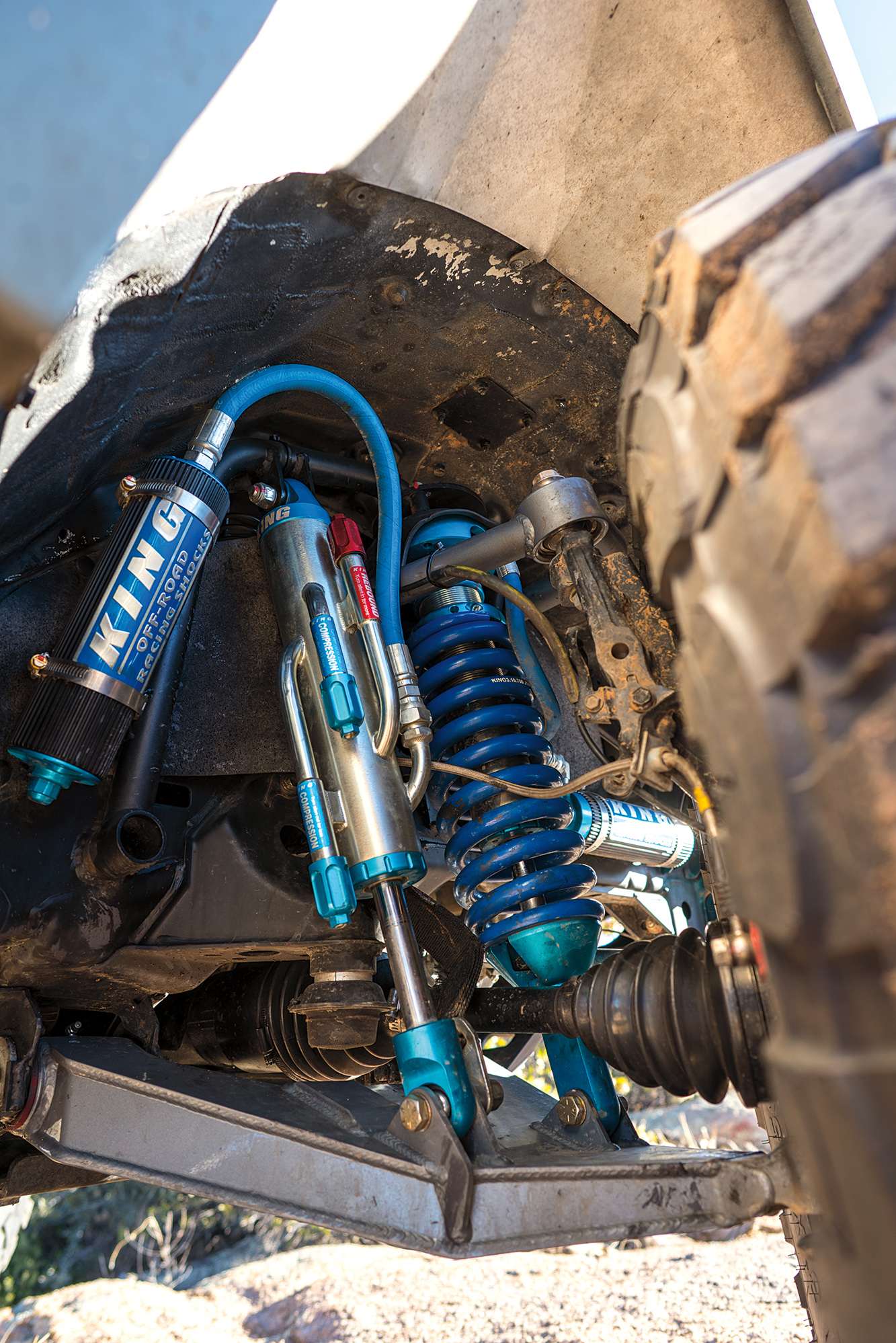

Every overland vehicle is only as good as the base vehicle it is built upon, and there are few North American platforms as respected as the Toyota Tacoma TRD, this particular unit being a Sport 4-door long-bed. The stock 4.0L V6 was augmented with a Magnuson supercharger, the results of which significantly increased horsepower and torque, and added that classic gear spooling whine. It is typically best to leave an engine stock, but Walt has found this unit to be reliable with long-term use. The results are impressive, and with the 5.29:1 axle gearing, I watched Walt drift this truck the length of a football field on private property outside of Tucson, Arizona. Acceleration is strong, and the boost helps mitigate loss at higher elevations. To accommodate the increased power and 37-inch tires, the TAV team specified a 69-inch Currie F9 rear axle. The wider track width helps to offset the higher center of gravity, and the stronger housing ensures the Tacoma can bear a full payload. To match the rear, a Total Chaos 3.5+ inch, long-travel front suspension was installed, along with longer RCV axle shafts.
The Tacoma as shown is slightly over factory GVWR, which Walt attempted to remedy by installing a stronger rear axle with a larger ring and pinion, better bearings, a more robust housing, more powerful SOS, and 4-piston billet calipers with slotted StopTech rotors. The independent front was also improved with Total Chaos (wider) arms, and King shocks with 700+ pound coils. The axle shafts were swapped to custom RCV units, along with 5.29:1 axle gears. The front brakes were also significantly improved with an SOS performance big brake kit, featuring StopTech 6-piston billet calipers. The frame was also strengthened with an Archive Garage Hammer rear shackle hanger cross brace. The rear suspension is a combination of custom, TAV-spec Alcan leaf springs with a 800+ pound rating, augmented by a Firestone floating airbag kit, a Total Chaos rear shock relocation kit, and King remote reservoir shocks, along with 2-inch air bumps.

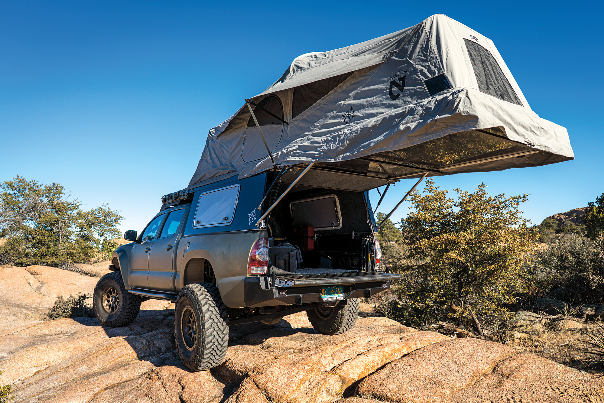

This Tacoma is not just a trail monster, but also an exploration platform. To support Walt’s overland excursions, he installed an Adventure Trailers Overland Habitat camper, and organized the interior with a series of Wolf Packs, a Yeti cooler, and a few Triple Aught Design duffels. Thoughtful details continue to the cab, with a Rammounted navigation iPad, sPod control panel to operate auxiliary lights, a simplex VHF radio, and a Sony head unit. This is easily a vehicle that can be lived out of for days or weeks at a time.

Total Chaos 3.5+ inch travel control arms
King coilers with 700-pound coil spring, cooling fins, and valve adjuster
King triple bypass secondary shock with bypass tube adjuster knobs and cooling fins
TAV-spec Alcan leaf springs, 800+ pounds over stock capacity
Firestone floating airbag kit, modified
King 12 x 2.5-inch smooth body shock with remote reservoir and valve adjuster
King 2 x 2.5-inch air bump
Total Chaos air bump mount
Archive Garage Hammer shackle and Hammer shackle hanger with crossbar

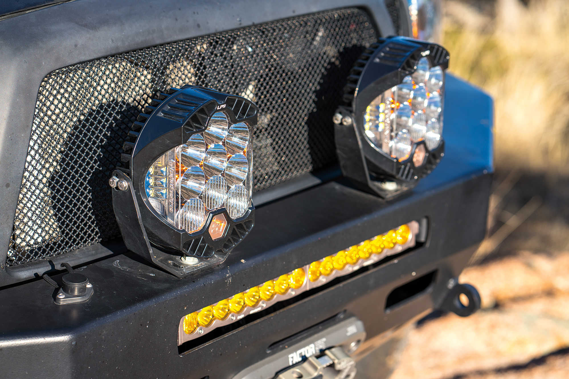

Baja Designs LP9, white squadron pro, and 20-inch S8 light bar, amber
ComeUp winch 9.5 RS
Factor 55 Ultra hook and 1-inch hawse fairlead

A/T Overland Habitat camper
