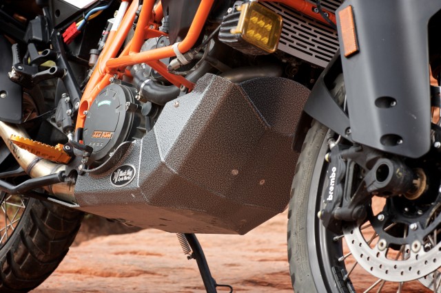

For protection, Black Dog Cycle Works (BDCW) started with their new extreme-duty skid plate that also integrates side stand relocation. Moving the side stand is critical to protecting the motor casting from damage. The skid plate is a serious piece of kit, and looks as suitable for taking a hit from an IED as it is a rock. Additional protection comes from the full-coverage radiator guard. Addressing ergonomics and control, wide BDCW platform pegs were fitted and significantly improve leverage in technical terrain and reduce pressure on the base of the foot. Standing comfort was also improved with a 40mm bar riser.
BDCW_1190_26A skid plate made to take serious abuse
