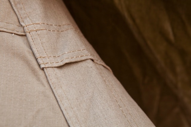

    Stitching only makes up a small portion of the tent, but it’s crucial to the tent structure. Poly-cotton thread has what is called in the trade “maximum sewability”; in other words it’s less likely to have a malfunction on the sewing machine, and it stands up to wear and tear over time. When we fit tents to trailers and vehicles, part of our inspection is to check every seam for integrity. Our experience over the years has been that all the tents that are made in-house show very few stitching errors; technically and esthetically the stitching is perfect. Where we see problems is with stitching done by third parties. We see on a consistent basis:
  • Seams that are not straight
  • Seams where two pieces of material join and one of the sections is not attached
  • Mosquito netting not completely sewn onto the adjoining fabric
  • Stitching that has started to unravel
  • Loose pieces of thread hanging from the fabric
  • Seams are stopped and re-started in the middle of what should be a single seam
  • Single stitching used where double stitching should have been used
  • Frayed material at seams that should have been hemmed under
  • Close-up of beige fabric with visible stitching and a flap, possibly part of a pocket or seam on rooftop tent fabrics, set against a blurred brown background.
