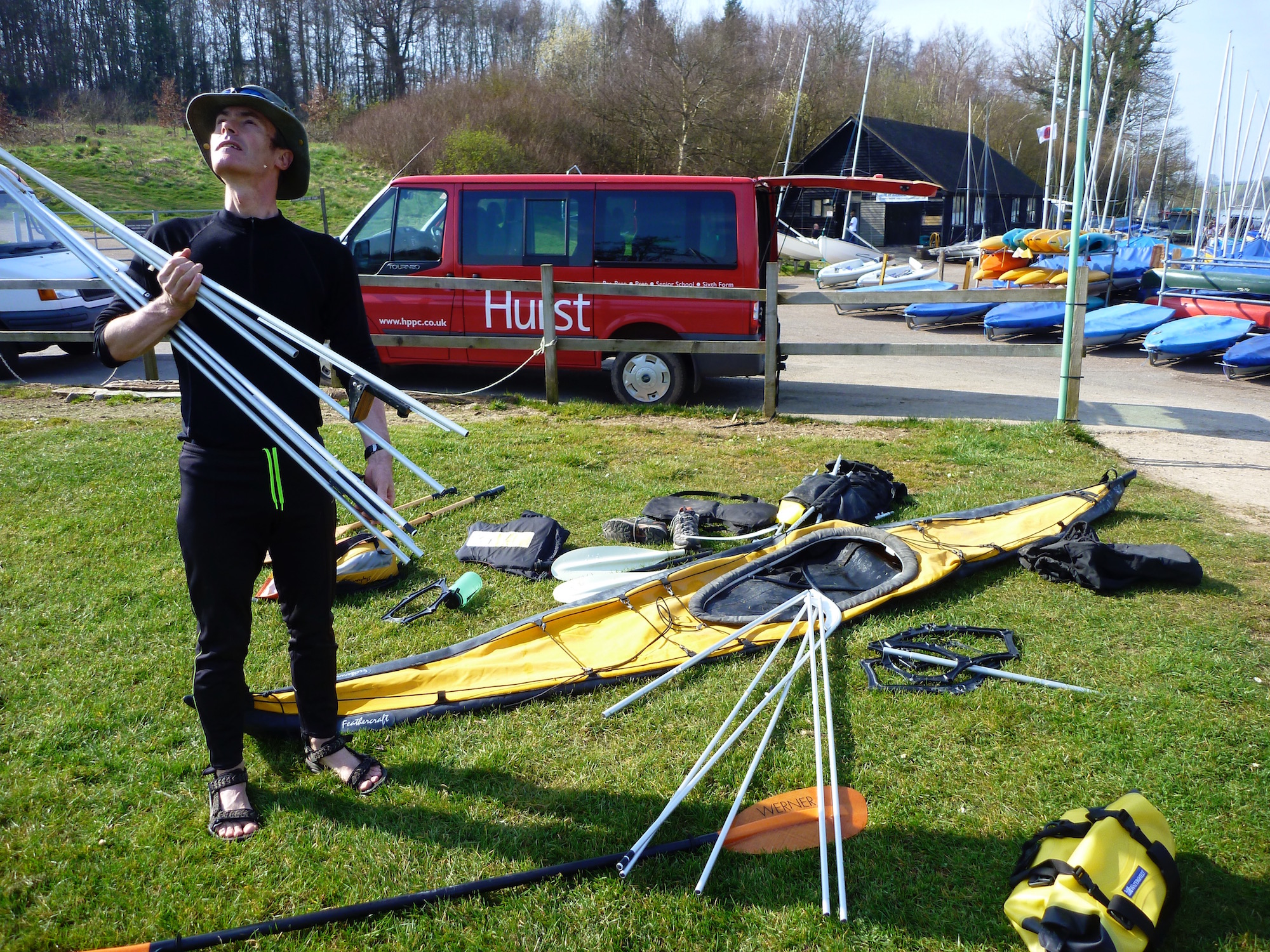

Packboats can be skin-on-frame “folding” kayaks, like the famous birch and canvas Kleppers as used by WW2 commandos. These days, alloy frames with PVC skins are the norm, such as Norway’s Ally Canoes, Pakboat in the US, and Canada’s recently defunct Feathercraft, who used synthetic rubber skins. (Because of PVC’s fall from grace and California Proposition 65, PVC packboat manufacturers go to great lengths to avoid using the P-word.)
Some designs incorporate inflatable tubes to help tension the structure, add buoyancy and ease assembly—Ally’s even come with a rubber “assembly” mallet. Kayak skins can be one-piece, incorporating a deck with a sealable hatch, making them suited to rough waters when combined with a spray skirt. Optional fitted decks are more versatile, but will never be as watertight. Realistically, for the sort of fair-weather paddling discussed here, paddling an open boat is far more agreeable.
A high-end folding kayak like a Feathercraft Kahuna has the elegant, low profile of a proper hardshell sea kayak, making them suited to multi-day journeys that will eventually encounter strong winds. But a vehicle-based overlander with a boat in the back will be more inclined to spontaneous short outings that coincide with an agreeable location and ideal weather. With a packboat, ease of portability, deployment, and use all override expeditionary levels of performance.
Drawbacks with folders include the relative complexity and duration of assembly, when all you want is an evening paddle. And compared to rugged, maintenance-free hard shells and IKs, alloy corrosion from seawater and the relative fragility of the frame and skin pressed against it are all issues I’ve encountered. (Small holes are easily fixed with tape.) Folders need to be assembled without distractions, handled carefully, then dried and cleaned properly. (Once you get into packboats, you’ll soon find what a nuisance curious onlookers can be.) All up folders are more suited to longer pauses during your travels than spur-of-the-moment paddles.

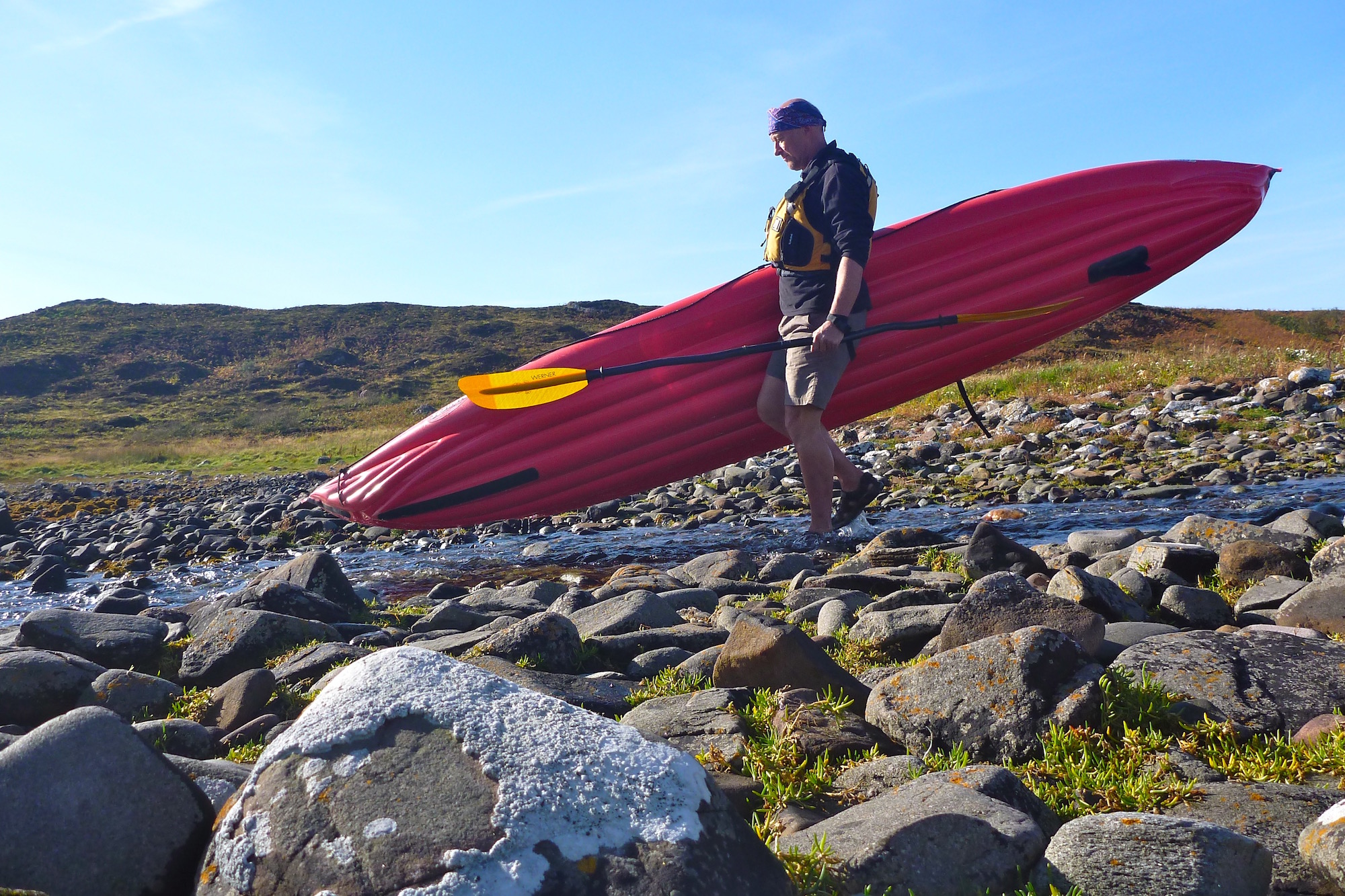

Lately, slim, flat panels of drop-stitch (DS) fabric are replacing IKs’ bulky, RIB-like tubes. With suitable pumps, DS panels can be inflated to much higher pressures, giving hardshell-like rigidity while being immune to overheating ruptures when an IK is inadvertently left in the sun. This rigidity is especially useful on longer boats which otherwise sag midway under a solo paddler’s weight. But because any kayak seeks to be more than a flat-floored, flat-sided barge, full DS IKs may be harder to handle on anything other than flat-water cruising. Thigh braces will help.

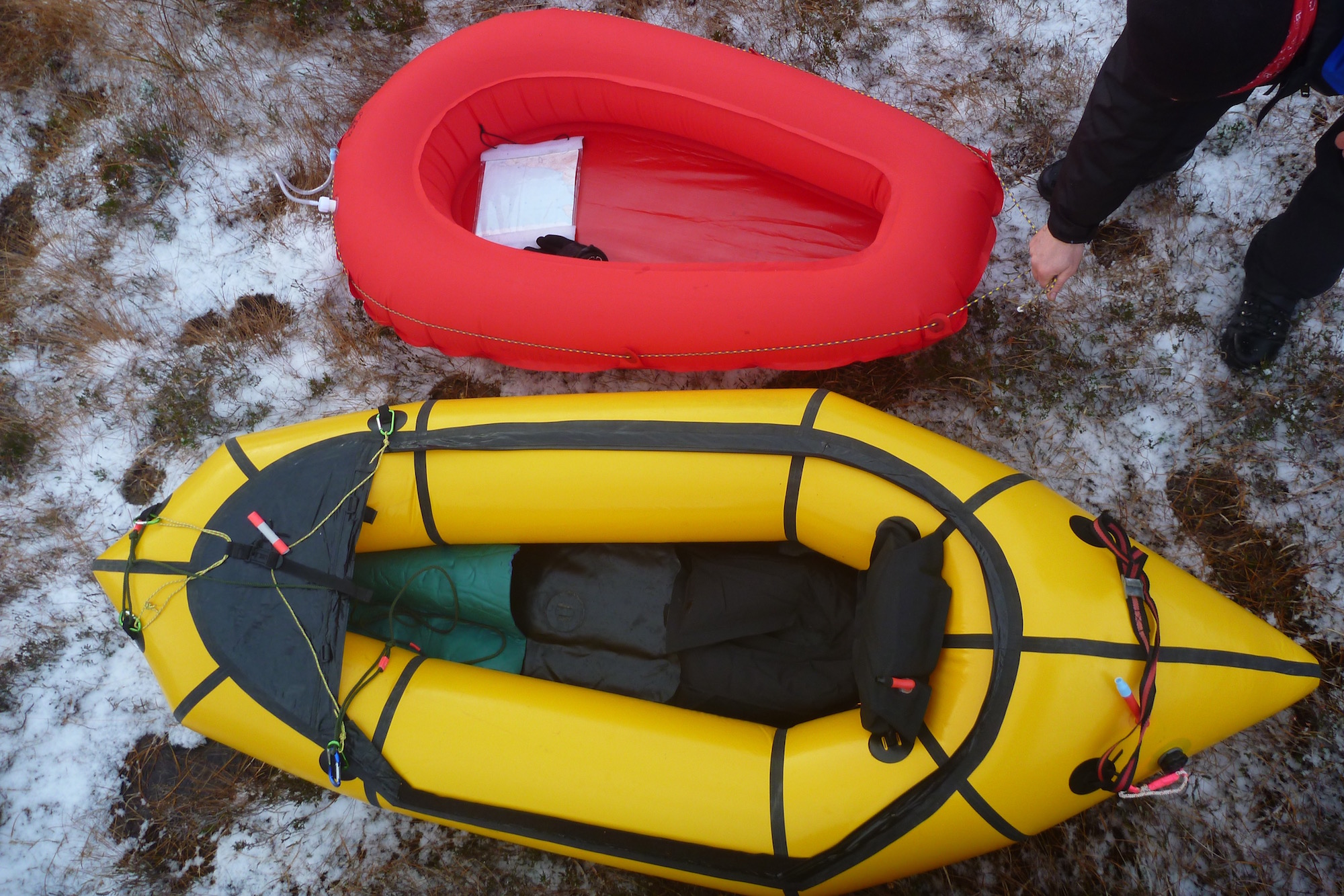

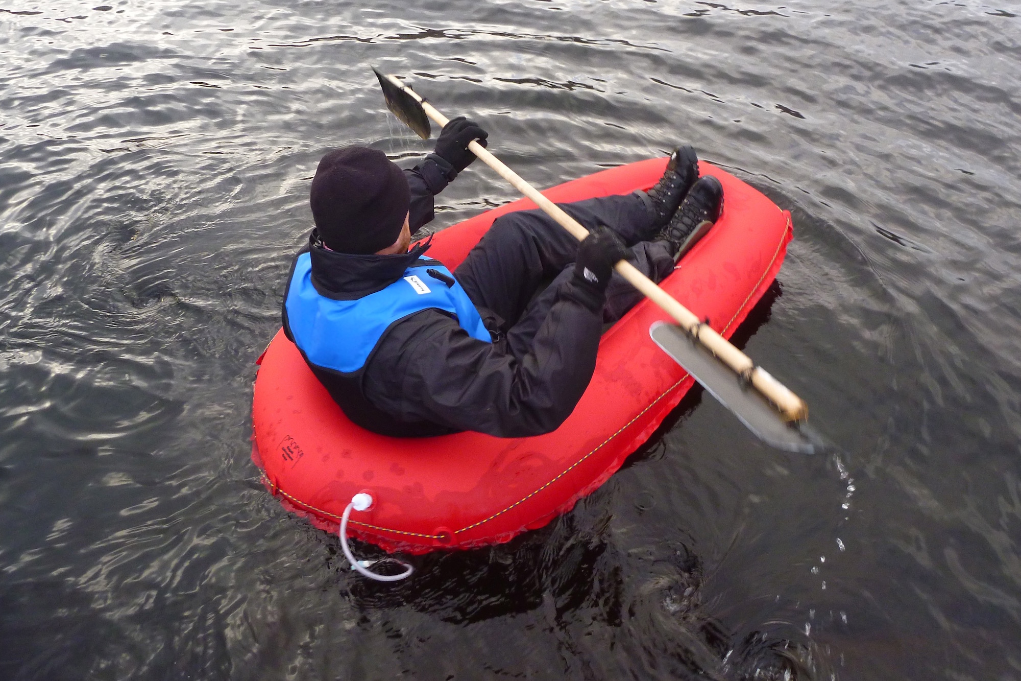

Conceived in Alaska and developed by Alpacka in Colorado, packrafts are one- or two-person rafts, compact and light enough to hike with and deploy on water bodies as needed. Like MTBs in the 1980s, they’ve revealed a whole new way of enjoying the outdoors. Inflated without pumps, the tubeless, single-chamber TPU construction delivers a tautness, durability, and responsiveness you’ll never get from vaguely similar $30 PVC pool toys stacked up to the roof in Walmart.
Now brands like MRS, Anfibio, Longshore, Kokopelli, and Nortik have entered the market with their own variants and that competition has helped prices fall. You can even buy a template and try heat-welding your own. Evolution has brought specialization, and there are now decked packrafts for the gnarliest white water, long tours, heavy payloads or two paddlers, as well as ultra-light, pocketable crossrafts from Supai or Anfibio. There are compromises to payload, durability, and agility, but a crossraft would suit a motorcyclist determined to get on the water once in a while.
More enjoyable to paddle in a current, stubby solo packrafts won’t glide or cruise on flat water like a slim, 15-foot kayak. As such, a double might be more suited to road trippers unless you can see yourself exploiting a packraft’s all-terrain portability on foot as well as water.
