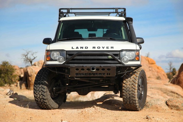

From across the parking lot the truck looked tough and rugged. With at least five inches of lift, a snorkel, big aggressive mud tires, tinted windows, roof rack, tube bumpers and even a stinger bar on the front it looked like it was all business. However, upon closer inspection with a peek under the hood and a drive around the block, it revealed the horrific truth behind this poor truck. It needed a comprehensive makeover just to be road worthy.

Tube bumpers front and rear. They are heavy, ugly, painted with bed-liner and they have been literally welded onto the frame. Best is the additional stinger bar on the front bumper; this comes in handy for whacking your elbow every time you walk around the front of the truck. Yes, welding up your own bumper in your garage may be a gratifying achievement but there are so many professionally designed and built aftermarket bumpers available for this truck that anything else is really just a bad idea. This DIY front bumper even eliminated the front crush cans and airbag activation components.
