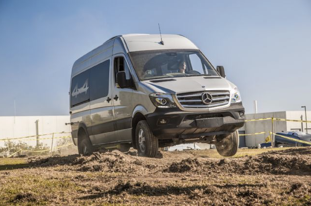

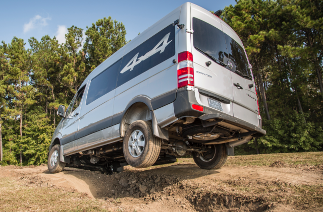

Also new for the 2015 North American market is a four-wheel drive option. That’s right, a four-wheel drive, diesel, Mercedes Benz van for North America. With two additional drive wheels (additional cost, $6500 USD) buyers now have the option of a push button, low-range transfer case (additional cost, $300 USD) providing a 42% crawl ratio reduction. OK, so, no doubt everyone is thinking: how capable can something like this be? In a word: very.

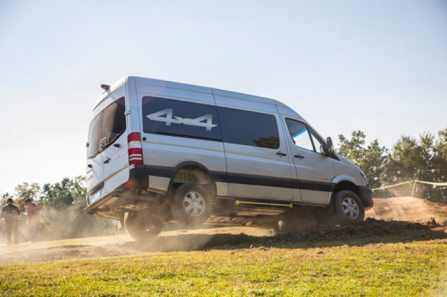

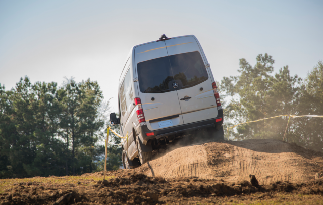

In the small town of Ladson, SC, where all of the Sprinter vans are produced for the North American market, lies a small off road test track. Peppered with strategically placed ruts, hills and off camber portions, drivers can test the computer controlled traction aids as well as the increased suspension ride height (+4.3” front, +3.1” rear). The large van does incredibly well maintaining forward progress even with one wheel lifted completely off of the ground –something that would leave two wheel drive versions in need of recovery.
