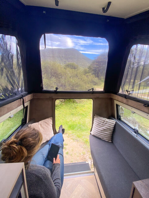

From the outset, the couple rejected most commercially available slide-in bodies, finding them either robust but cramped or comfortable but ill-suited to rough tracks. They drew inspiration from large expedition trucks produced by companies such as Bliss Mobil and SLRV and the do-everything versatility of the Volkswagen Transporter. The challenge was to distill the presence of a big truck into a module that would not compromise maneuverability or parking. In profile, the Pioneer’s flanks taper inward to reduce the chance of striking trees on a tilted trail, while inside, the walls remain nearly vertical to maintain seating comfort. The result is a compact silhouette that still allows four people to sit and eat indoors, a fixed lift bed that leaves the dinette usable at night, and generous storage for gear.

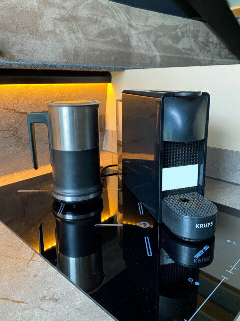

Inside the module, Anniek’s requirement for domestic comfort guided the finish. Upholstered walls, warm neutral colors, and a herringbone floor create a space that feels more like an apartment than a truck. Included are lithium batteries, solar input, and a custom control panel for power induction cooking, hot water, and climate controls. Eliminating bottled gas removes an international logistics headache and aligns with the pair’s preference for simple refueling.

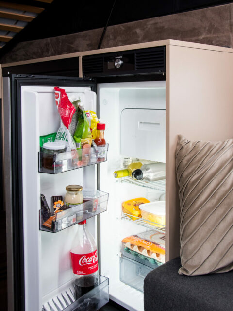

  • Fridge (90-liter)
