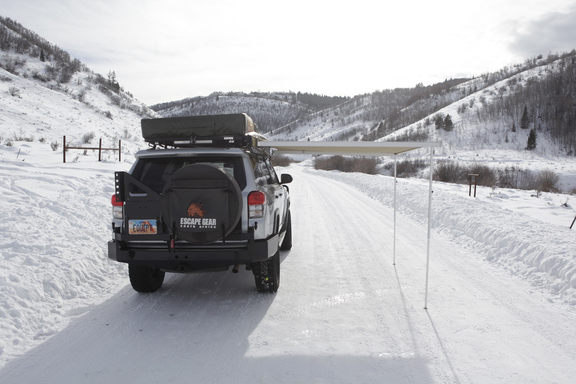

Since 2013 this truck has served as a rolling showcase for the company, sporting equipment from each of Equipt’s product lines. Don’t get the wrong idea though, it’s far from a “display only” vehicle. While Paul, the owner of Equipt, may be one of the most meticulous people you’ll ever meet, he is also a true four-wheel drive enthusiast and builds his vehicles to be comfortable, reliable, and capable. Front and rear bumpers, internal storage systems, dual batteries, a fridge/freezer, heavy-duty suspension, communication boosters, a roof top tent, undercarriage protection, and an upgraded lighting system are but a few of the many upgrades incorporated into his Toyota for overland travel.

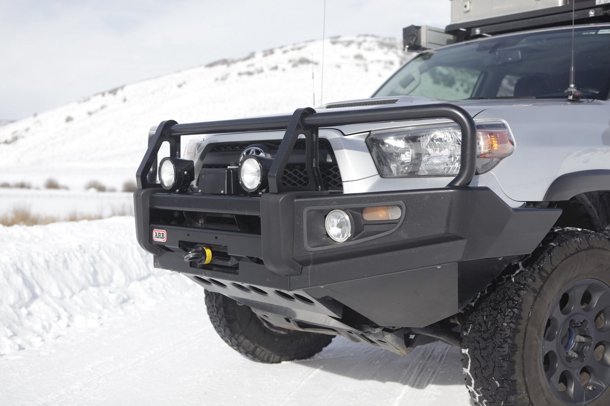

– ARB Front Commercial Bull Bar, with fog lights
– Warn 9.5 XP 9,000 lb winch with Viking synthetic line
– Baja Designs Fuego 4” HID lights

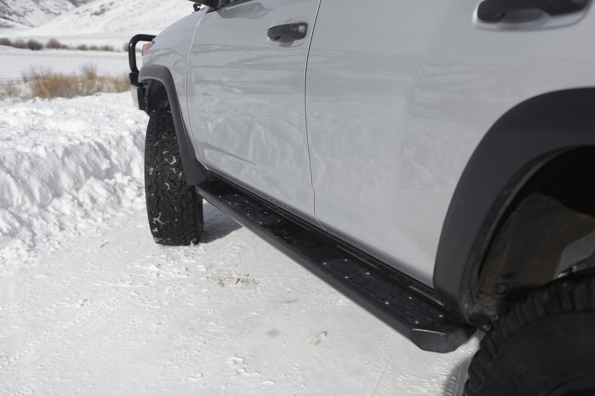

– Slee Off Road Steal Slider Steps (first set on a TE model)

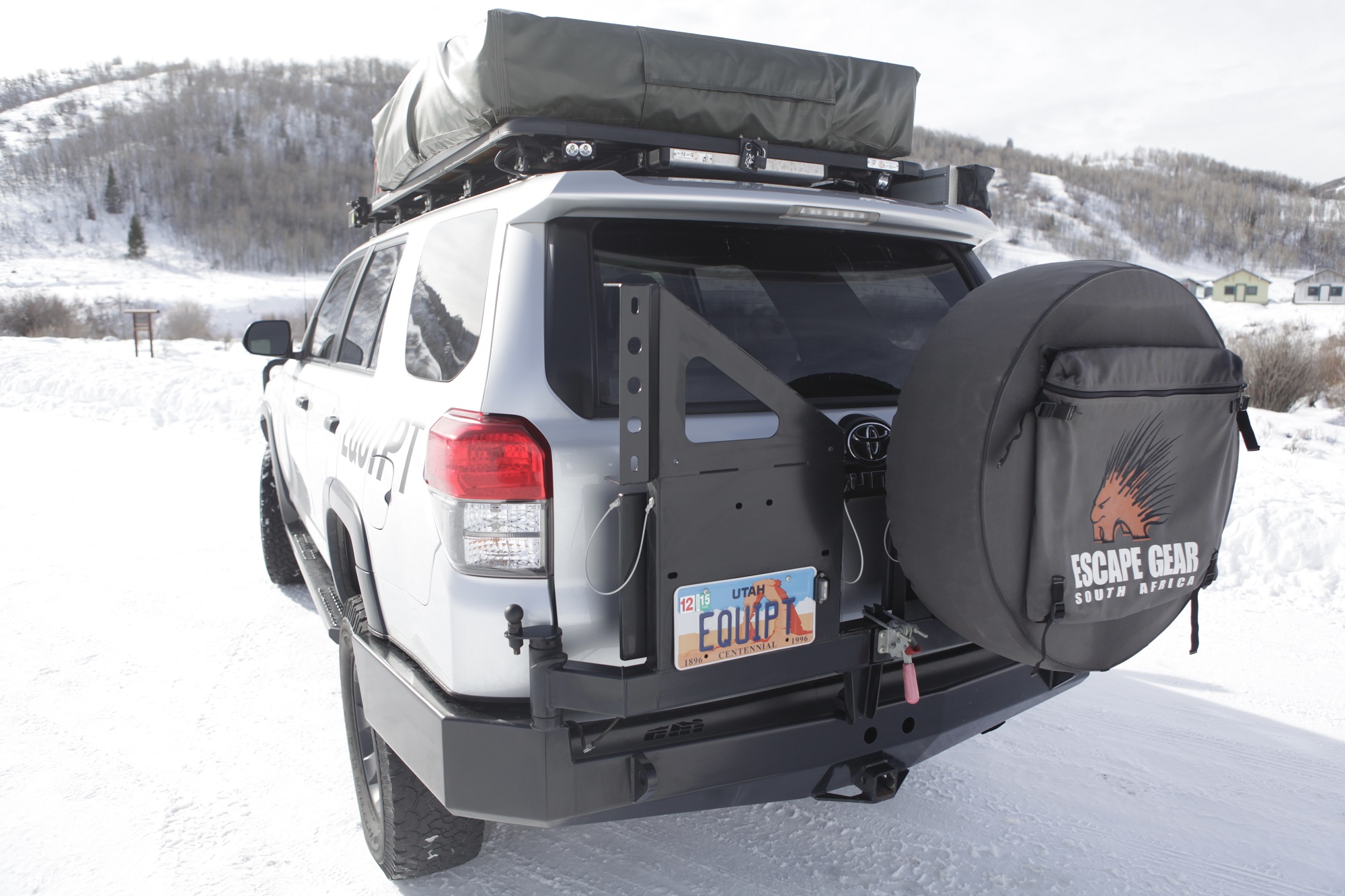

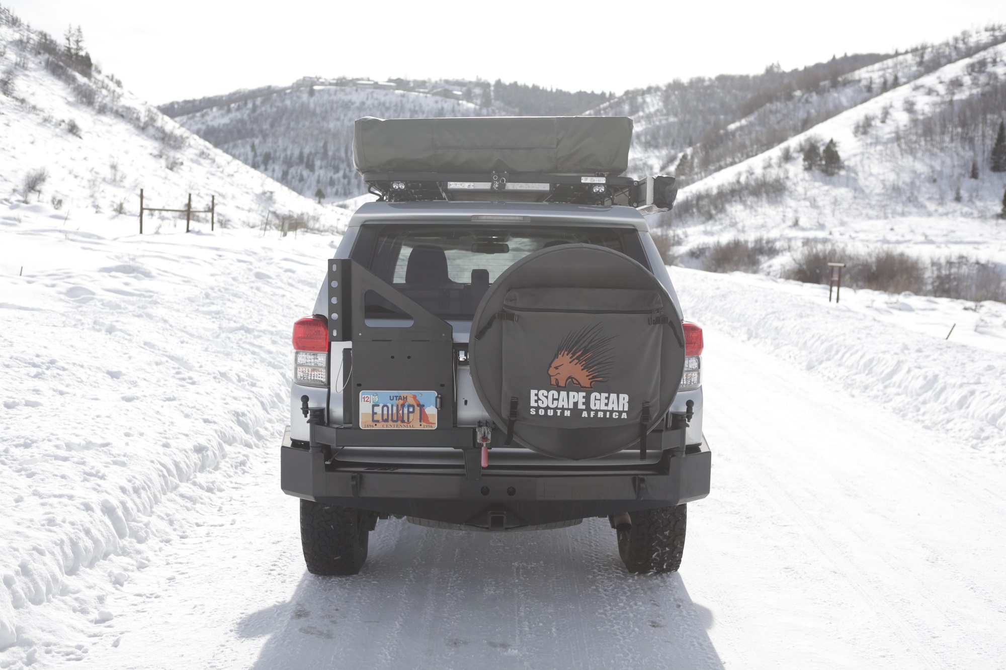

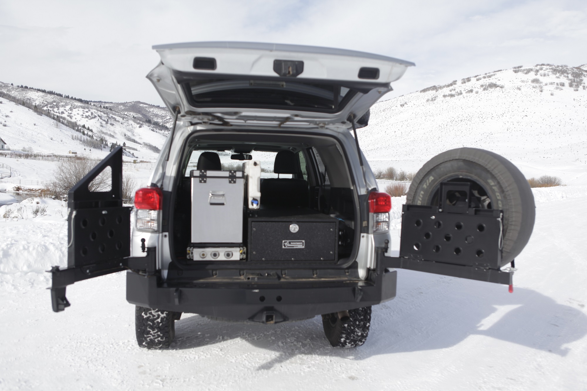

– CBI Offroad Rear Bumper with dual swing out carriers and fold down tables

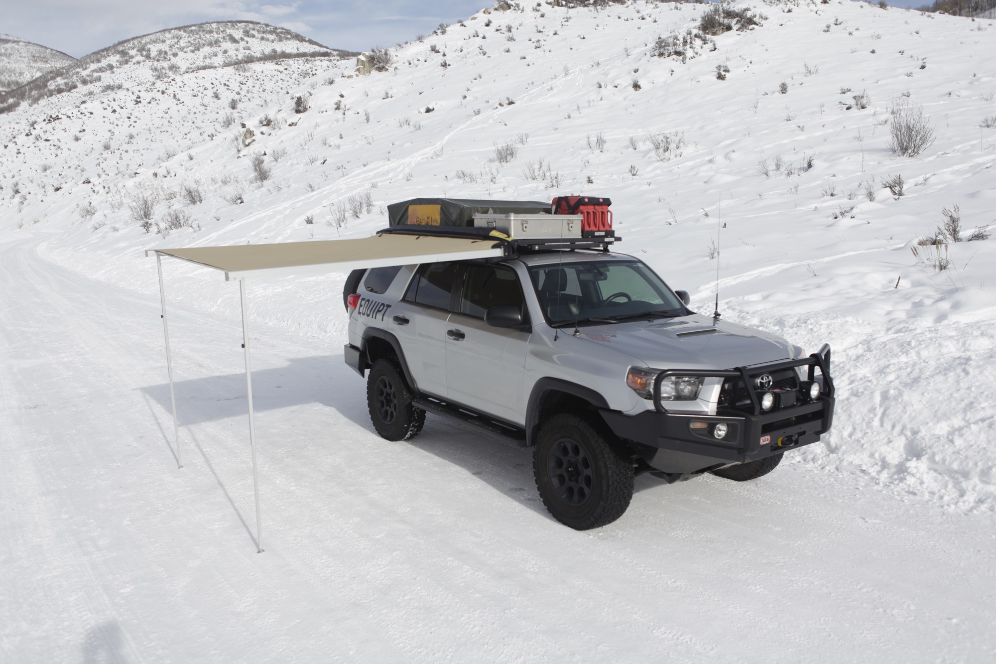

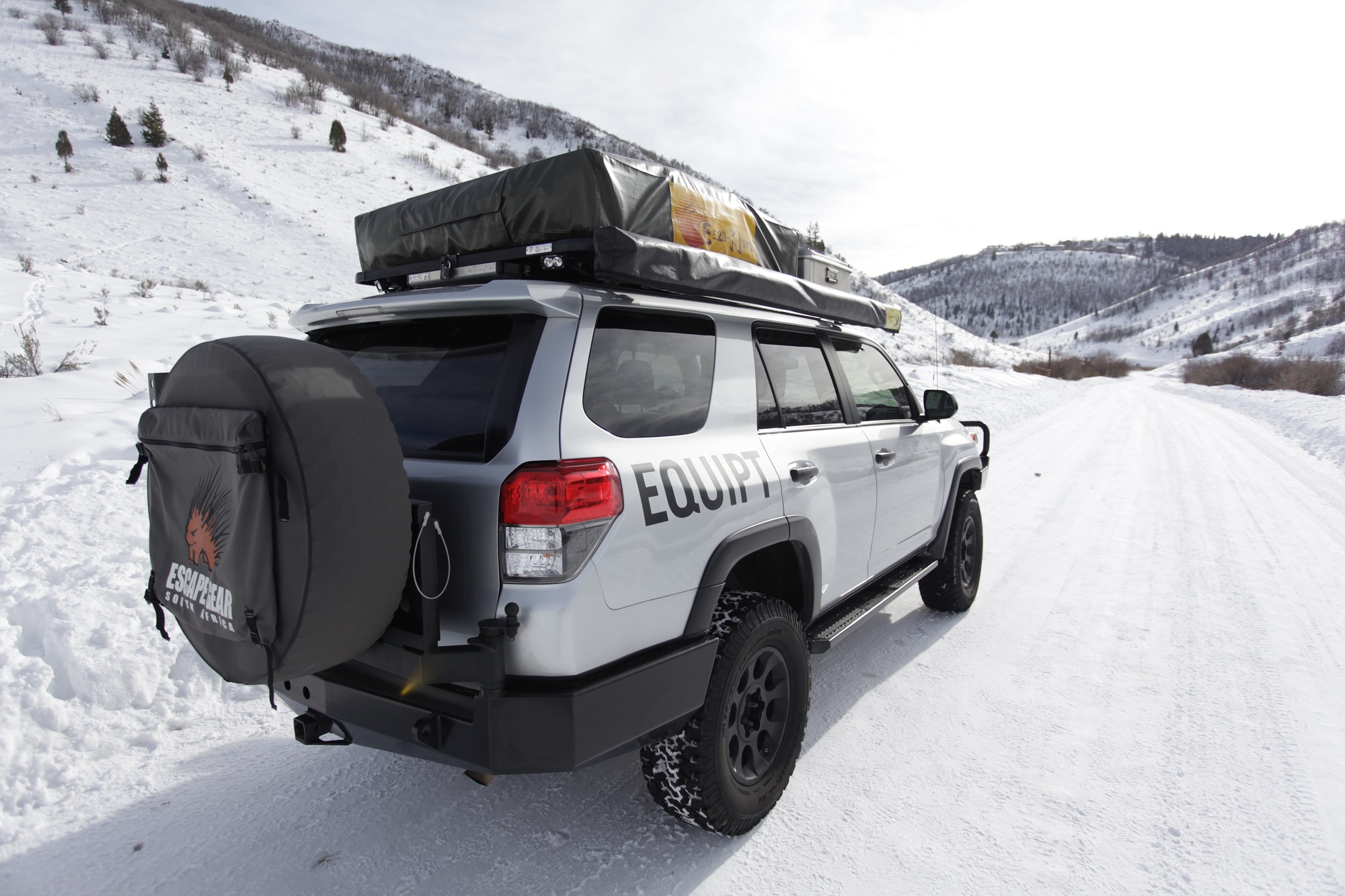

– Eezi-Awn K9 2.2M Roof Rack System
– Eezi-Awn Series 2 1400 Roof Top Tent
– Eezi-Awn K9 Stainless Steel Small Table and Table Mount
– Eezi-Awn Swift Awning
– Eezi-Awn K9 Shovel Mount
– Eezi-Awn Dual Jerry Can Holder
– Alu-Box ABS74 Aluminum Storage Case, bolted to roof rack
– Baja Designs LED Light bar, mounted under front rack edge
– (2) Baja Designs LED Lights, mounted under rear rack edge

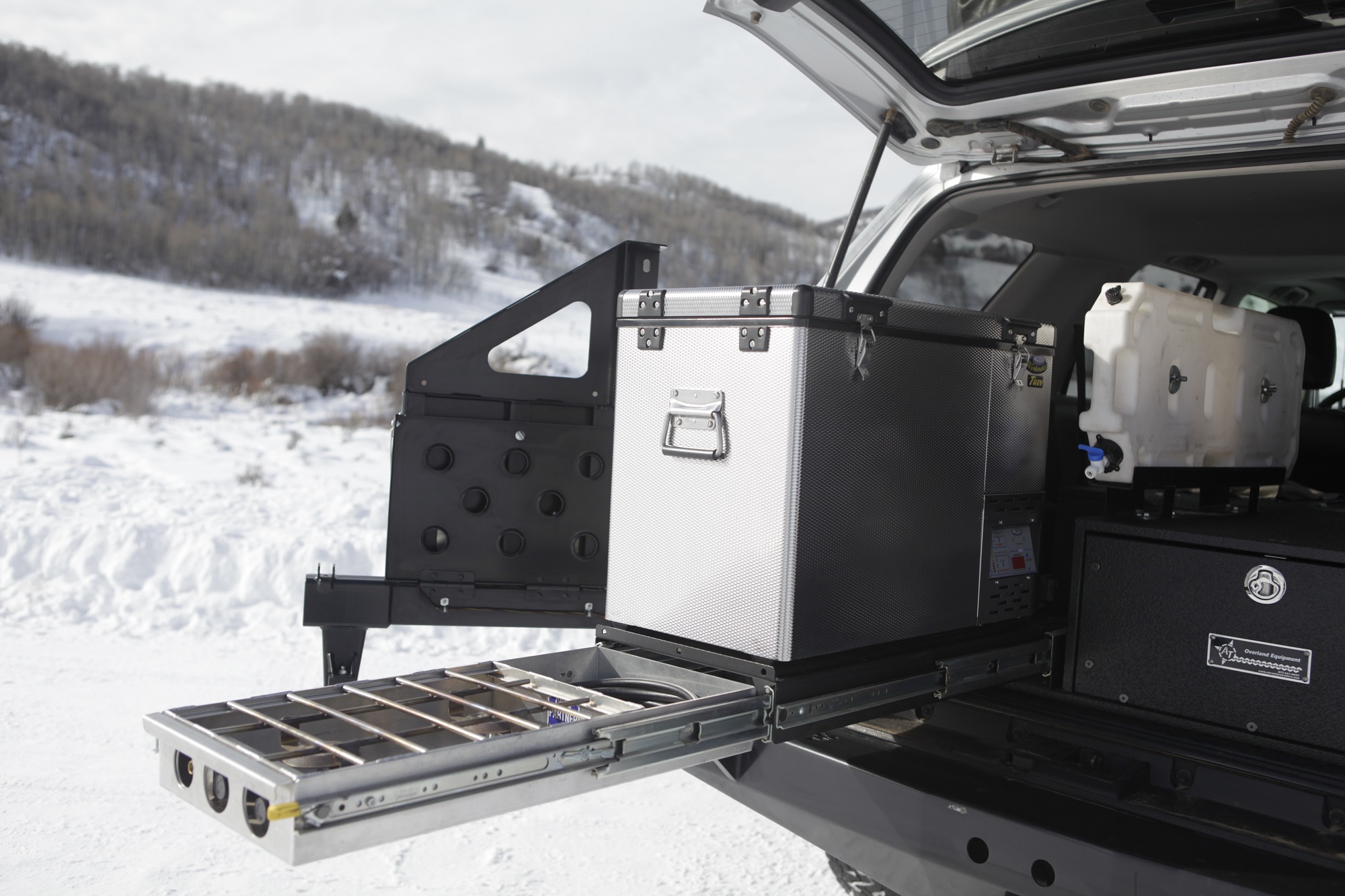

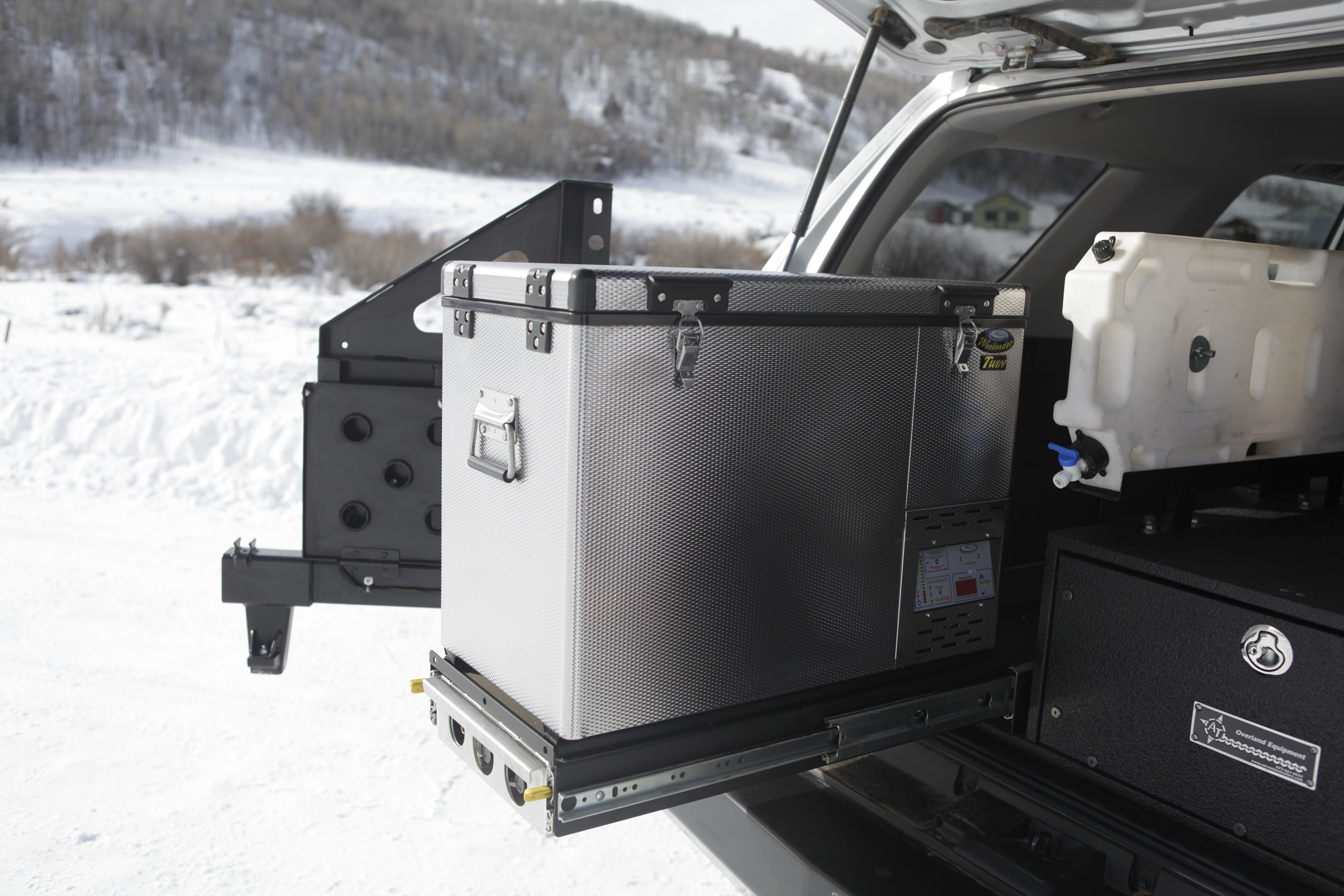

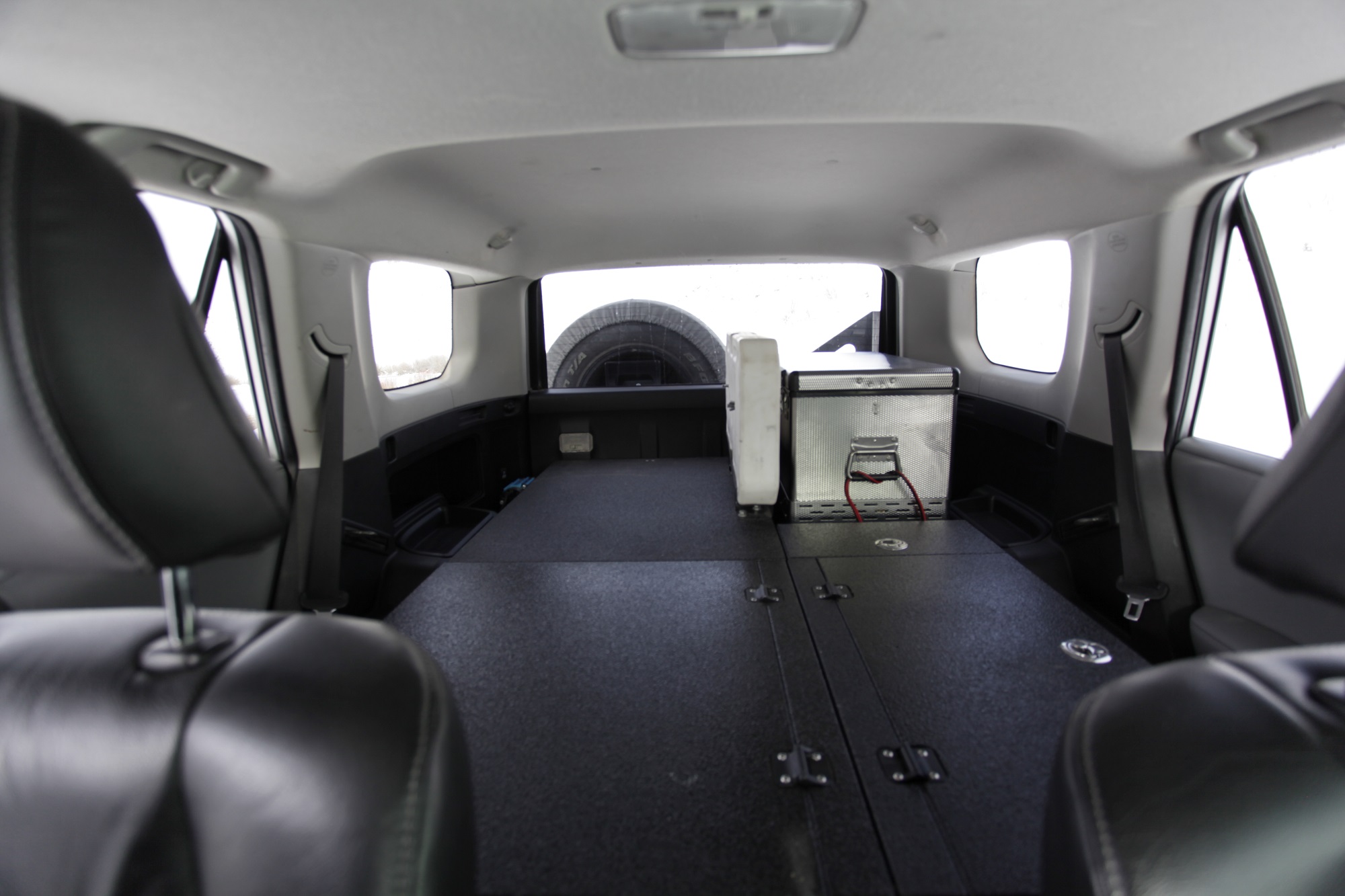

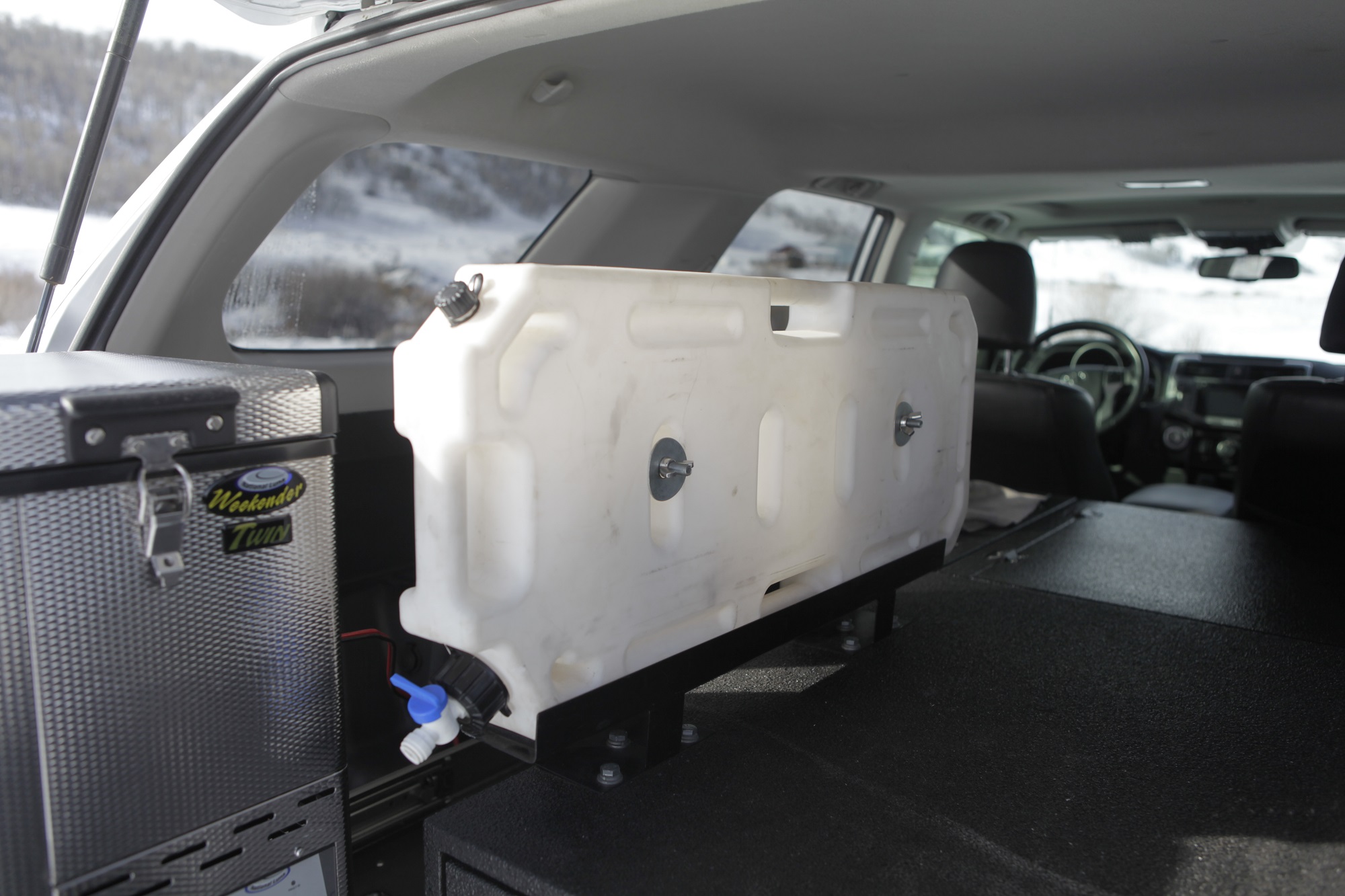

– AT Overland 3 Stage interior storage system, including rear drawer, left and right hand side clam shell storage boxes and small storage box in front of combo slide
– AT Overland Combination Fridge/Stove slide with Partner Steel 2 burner stove
– National Luna Weekender 50L Stainless Steel Fridge / Freezer
– ARB Twin Cylinder Compressor

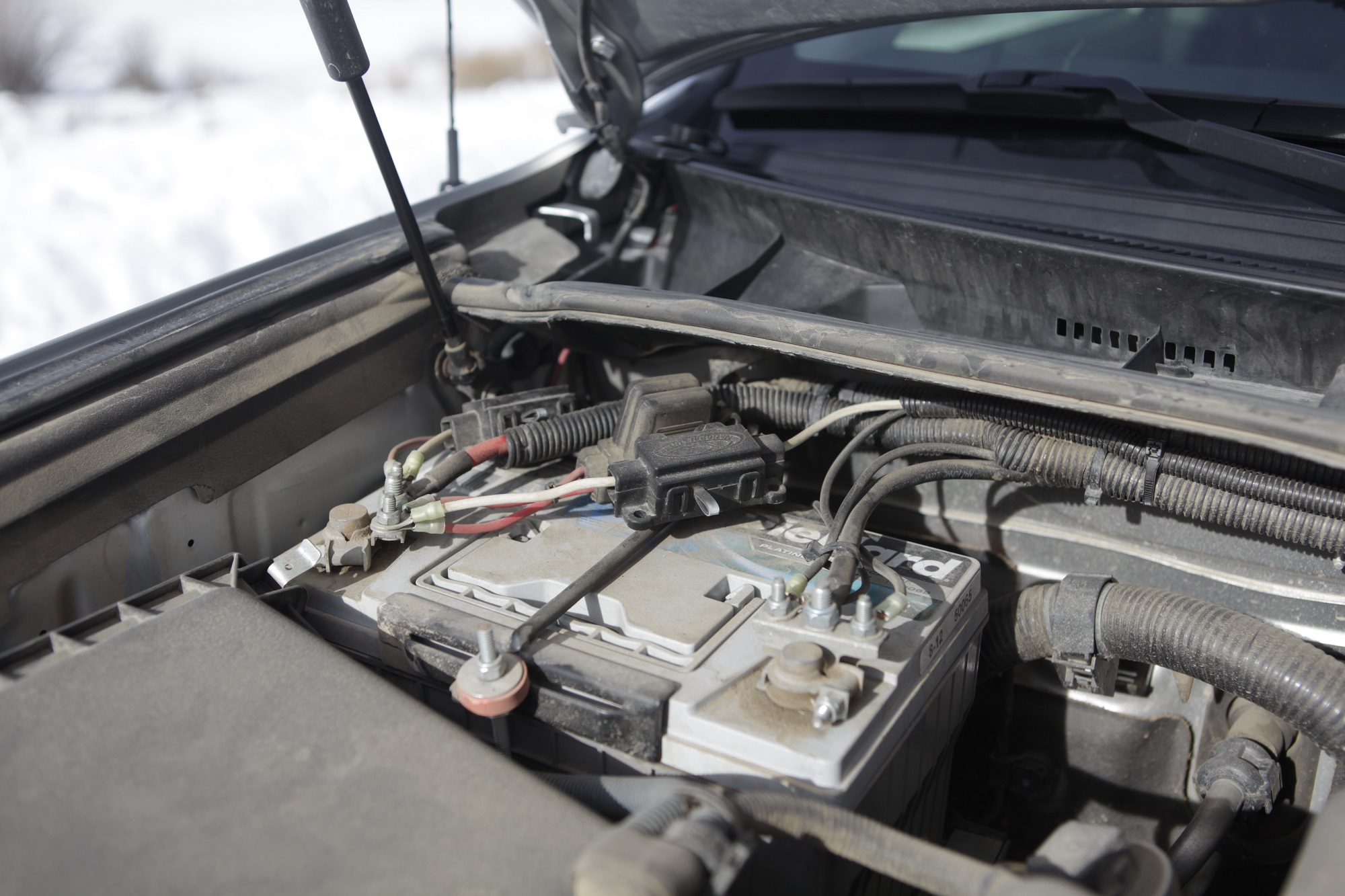

Electrical

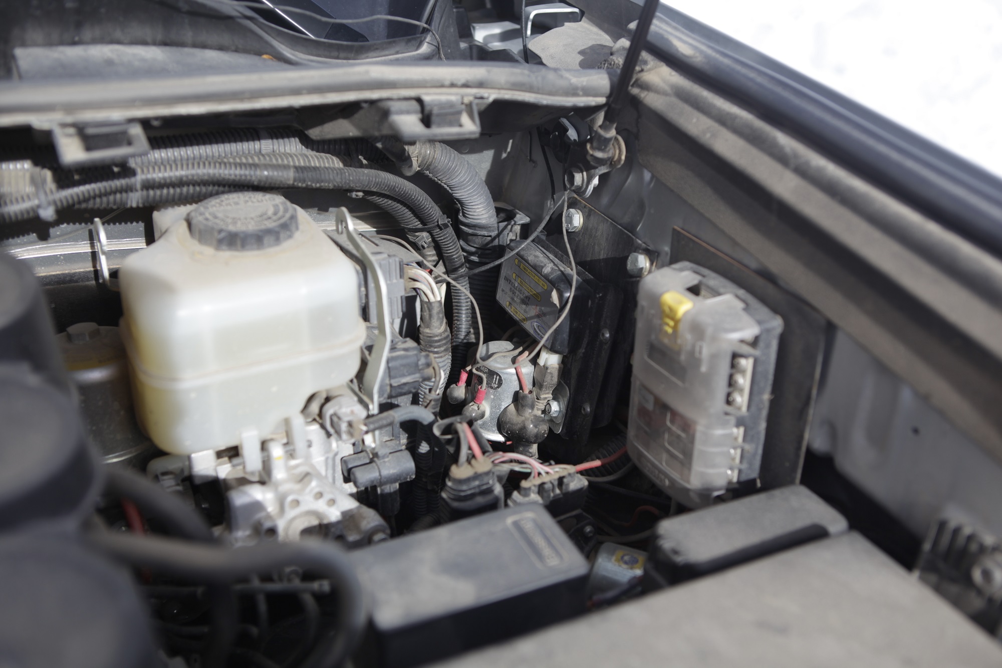

– National Luna Dual Battery System, including Intelligent Solenoid and Dual Battery Controller
– Customer built Auxiliary Battery Tray, by passengers side fire wall
– Blue Sea fuse block for live auxiliary power
– Bussman Fuse mini fuse/relay block and solenoid for switched auxiliary power
– Dedicated electrical Hella outlet for fridge, and spare cigar lighter outlet, live full time
– Dedicated electrical to roof of vehicle for roof top tent

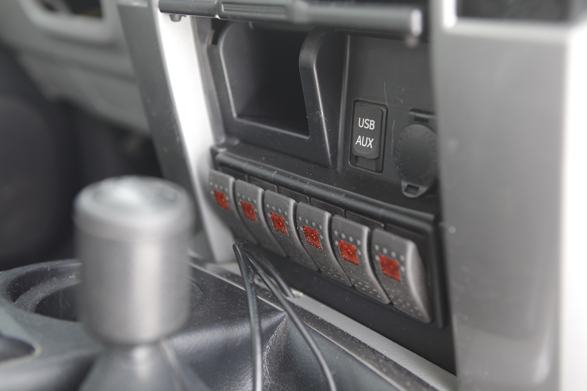

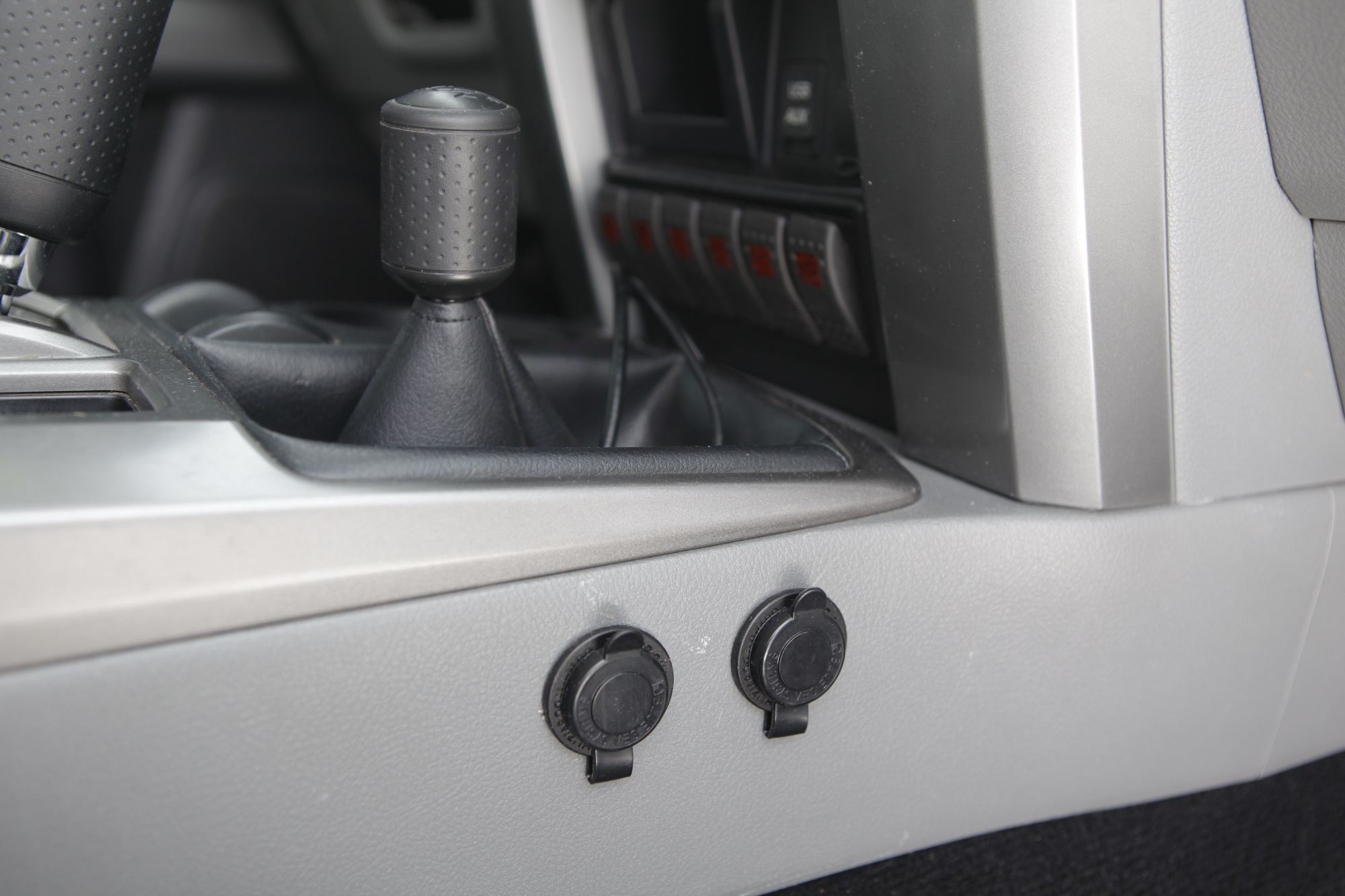

– (4) Live USB ports on passenger side of center console
– (6) Carling switches built into center console for lights and accessory control
– Solar panel connection integrated below wiper area

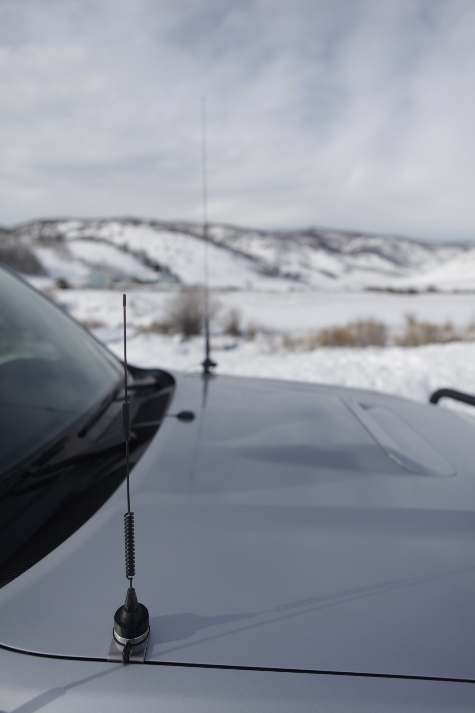

– Icon 2 Meter HAM radio mounted in center console with external speaker under dash
– Wilson Electronics Mobile / Data pancake amplifier in center console
– Antennas for both mounted on hood
– Relocation of satellite radio antenna to hood to allow table to be mounted under rack
