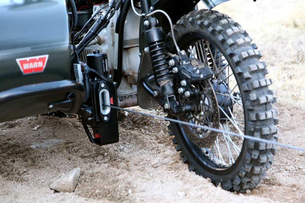

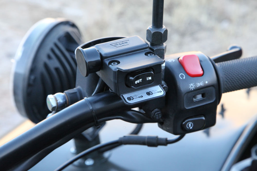

At the heart of the system is Warn’s ProVantage 2500-S winch fitted with 50 feet of synthetic line. Designed for ATV use, it is a compact winch with all the power required to extract the Gear Up from any potential recovery situation. Installation of the winch and its various components did require some creating thinking, but mounting options abound on a platform like the Gear Up. One of the more delicate components, the winch solenoid, was placed in a protected location beneath the seat giving easy access to the battery terminals just below. The handlebar switch was mounted by the right-hand controls providing easy access to the winch functions without compromising the ability to work the throttle and brake. The more complex issue to be resolved was how to route the winch wiring leads. Using large gauge Anderson plugs for maximum durability, the winch can be quickly disconnected for an easy transfer from one end of the motorcycle to the other. This also facilitates easy removal of the winch if it is not needed for a given ride.

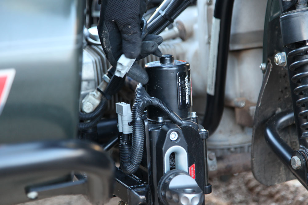

A gloved hand adjusts a component on a motorcycle, focusing on the wiring and mechanical parts near the engine and suspension—essential prep for any overlander passionate about overlanding adventures.
Connecting the Anderson plugs takes but a couple seconds.

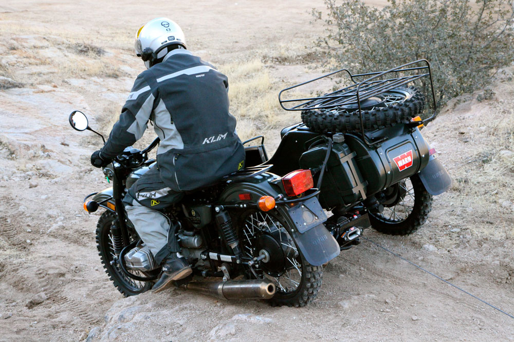

While the Gear Up can often conquer sizable ledges, the speed and forward energy required to do so is unnerving, if not wholly unsafe. Winching over these impediments considerably reduces the risks to rider and machine. What goes up, must frquently come down. While the Warn ProVantage 2500-S is not designed for lowering a vehicle, it would be possible to use the winch as a stabilizing element when dropping off these same steps and ledges. Since this type of operation is technically outside the design perimeters of the winch, extra care would need to be exercised as to not shock-load the system or destroy the inner mechanicals of the winch. It would perhaps be a procedure of last resort.An overlander wearing a helmet and motorcycle gear rides a black motorcycle with a sidecar over rocky, uneven terrain in a dry, desert-like area.
The Gear Up probably could have climbed this ledge under its own steam, but it would have not been without some risk to the bike––and rider. Winching up this ledge was an effortless task for the ProVantage. We tested the winch on considerably steeper ledges with equal success.

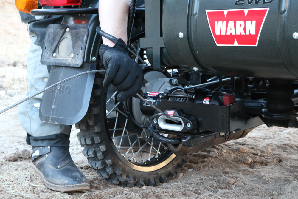

A person wearing gloves attaches a WARN winch cable to the rear of an overlanding vehicle, with focus on the tire, winch, and ground.
The first few tests revealed some happy accidents of design. With the line spooled out, it became apparent that a solo rider may have difficulties spooling that line by themselves. As it turns out, the control switch and winch fairlead are just barely within arm’s reach of each other.

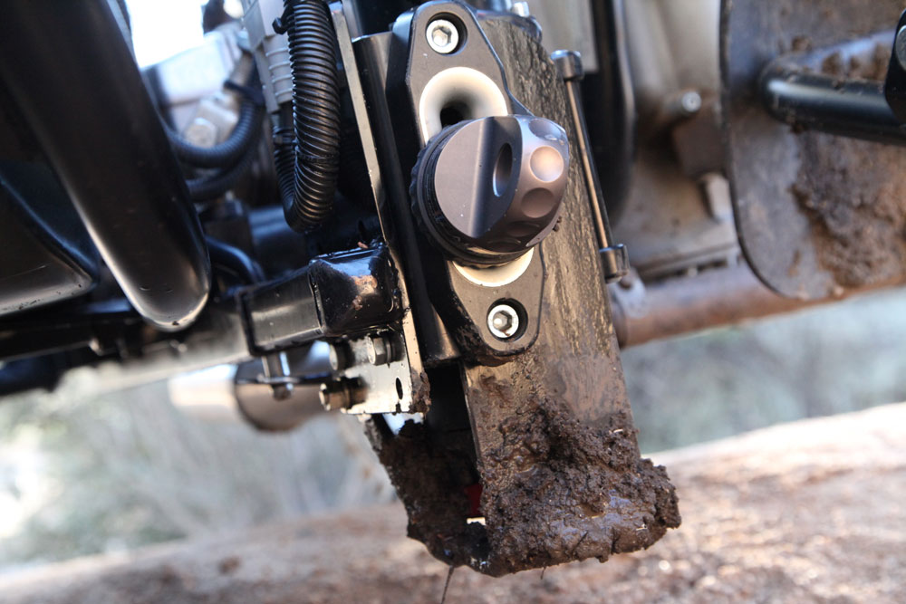

One of the primary concerns with the design of the mount was the protection afforded to the winch itself during aggressive riding situations. To that end the winch mount includes a small guard, which we immediately put to use proving it’s a very necessary feature. It has since been decided that the rear mount would be the ideal location for the winch for regular transport with the front location reserved for scenarios when the winch might be repeatedly put to use. Even in the more vulnerable spot up front, the steel guard should be ample protection for the winch.

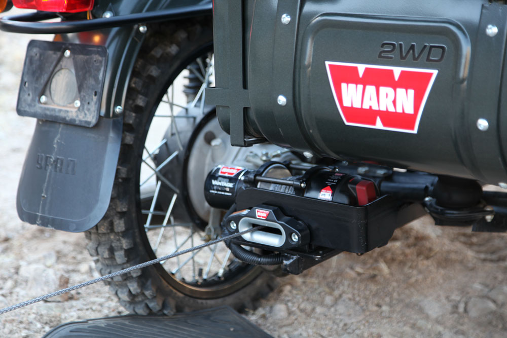

Close-up of a motorcycle’s rear wheel and side cargo box, both labeled with red WARN logos—perfect for any Overlander. A mounted WARN winch with a steel cable is attached to the bike, extending toward the ground.
The rear mount tucks the winch out of the way during regular riding when it is less likely to be needed. It remains high enough to not risk impact on aggressive trails.

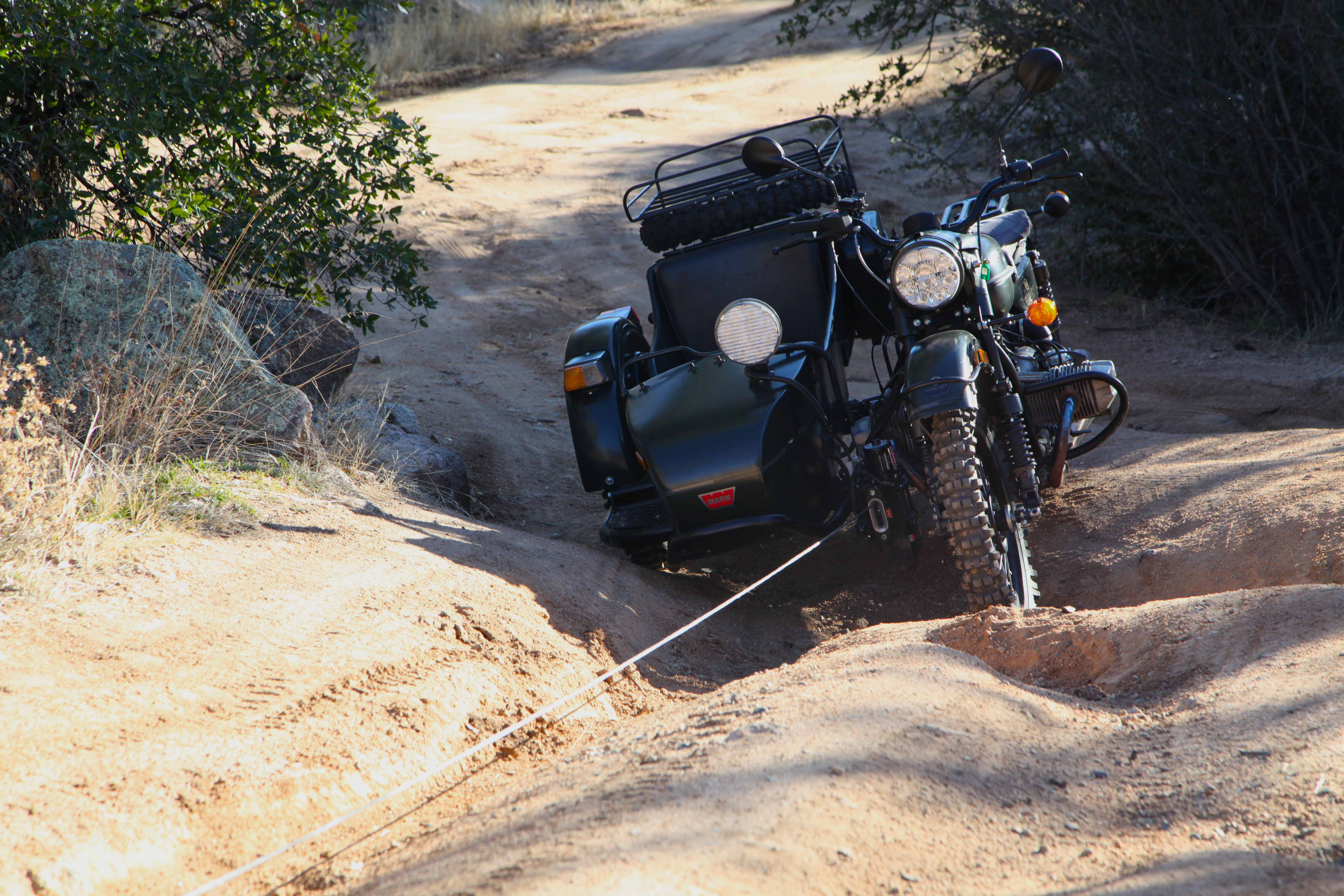

In testing, operating the winch and controlling the motorcycle at the same time didn’t prove to be overly complicated. The switch is easy to actuate and doesn’t conflict with the operation of the motorcycle itself. The Warn ProVantage pulls with a slow and deliberate pace and the central location of the winch on the motorcycle keeps everything balanced and doesn’t compete too much with steering inputs or suspension compression.
