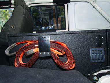

The J8 is much like the JK Rubicon, requiring very few modifications for serious use. In practice, the J8 requires even fewer modifications as the vehicle is delivered with a substantial payload rating, larger tires and more robust bumpers. We elected to make a few changes to satisfy our needs and satisfy my minimum requirements for an overland truck. The first adjustment we made was the installation of a 2M radio and a full recovery and tool kit. We tried out Viking OffRoad’s new gear bag and bought another Proxxon tool kit from T-Lo. Having a place to put all that gear securely (the Jeep still had a soft top) was solved quickly with a call to Adventure Trailers for a full-length drawer system. This was an innovation for them, and results in a wide, comfortable sleeping platform and full storage and lashing. The 40 percent portion of the split folding rear seat was retained.

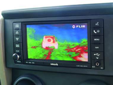

To further enhance backcountry performance and self-sufficiency, we installed the fast and reliable Warn 9.5 XP winch with 100 feet of Viking’s synthetic line. To address lighting while on the trail, we installed a pair of Lightforce 170 HIDs and their new Genesis 200 mm HID units on the front bumper. As a first for Overland Journal, we are testing the new FLIR color thermal night vision system. With an effective distance four times the headlights, we can see deer crossing the road at 400 yards. Imagine the added safety this unit will bring in third-world travel, if you can get it across the border.

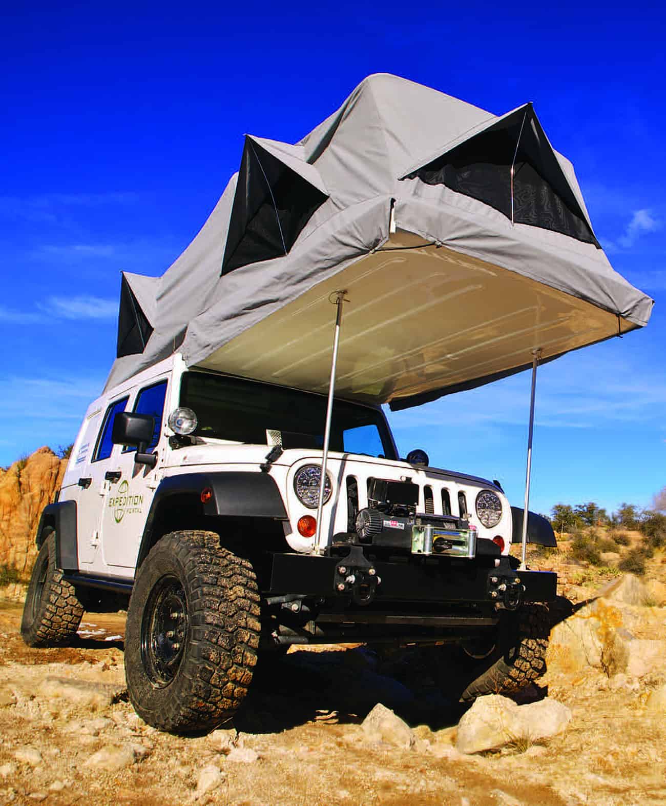

One product that we have been excited to test and feature is the new Adventure Trailers JK Habitat top. This unit replaces the factory soft or hard top and requires no permanent modification to the vehicle. It even looks (mostly) like a factory top and can retain all factory doors and window positions. It installs in just a few minutes which allows the Jeep to still be a Jeep, enjoying open air travel on those sunny days. The Habitat is constructed from automotive quality fiberglass with a gel coat finish. The top opens with the assistance of a torsion spring and crank handle, allowing setup to occur in less than a minute. Once deployed, the Habitat allows up to nine feet of headroom and sleeping for four. The forward half includes a three-inch mattress for a queen-size bed. The back half can be configured for storage, sleeping for two more occupants or even a few chairs.
Access to the Habitat is best through the rear passenger doors, stepping into the Jeep much like if sitting in the back. Two panels are moved out of the way and then it is possible to stand up in the space above the rear passenger area. The opening is more of a hatch than a huge portal. This is by design, allowing the original roll bar to be retained. The tent is constructed from breathable and water-wicking fabric. A skirt flips over the top sides and prevents pooling. Window sizes are conservative but should permit sufficient ventilation. The Habitat also presents a surprising value, especially when other options are considered. The cost of a factory hard top (as an option), a roof rack and quality roof tent would easily be more than the Habitat and likely weigh more as well.
Beyond the top, we worked with Adventure Trailers (AT) to add a few comfort systems to the Habitat. Along with the excellent drawer unit, a water storage bladder and hot water shower system was added. The hot water unit holds two gallons and mounts behind the passenger (driver in this case) seat. AT also installed their new model fridge slide which integrates a Partner Steel stove on a second slide. The entire unit double-slides allowing access to the fridge and both burners. It is one of the coolest products I have seen in years. On the Jeep tailgate, we installed one of Off Road Trail Tools flip-down tables.
