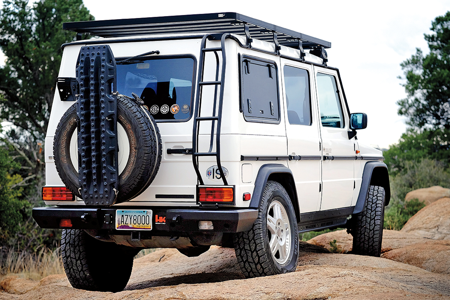

The G-Wagen comes from Graz, Austria, with impressive technical terrain hardware, including three locking differentials and generous approach and departure angles. However, I did want to improve body clearance and also provide for additional load capacity. A change in springs can vary payload ratings up to 2,000 pounds, so we installed factory Eibach purple springs, which are longer and have a firmer spring rate. This swap was complemented with new Bilstein shocks and suspension bushings all around. The 1.5-inch lift provided additional clearance, so we experimented with everything from 32.5-inch all-terrains to over-the-top aggressive 35.1-inch mud-terrains. While the big STT Pros looked great and performed well in mud and rock, they were too big for mixed use, so I selected a 275/65R18 Cooper AT3 on factory 18-inch alloy wheels. I do intend to source another set of wheels in a 16-inch size and install taller, narrower tires for more severe conditions, but for now this solution has not disappointed.

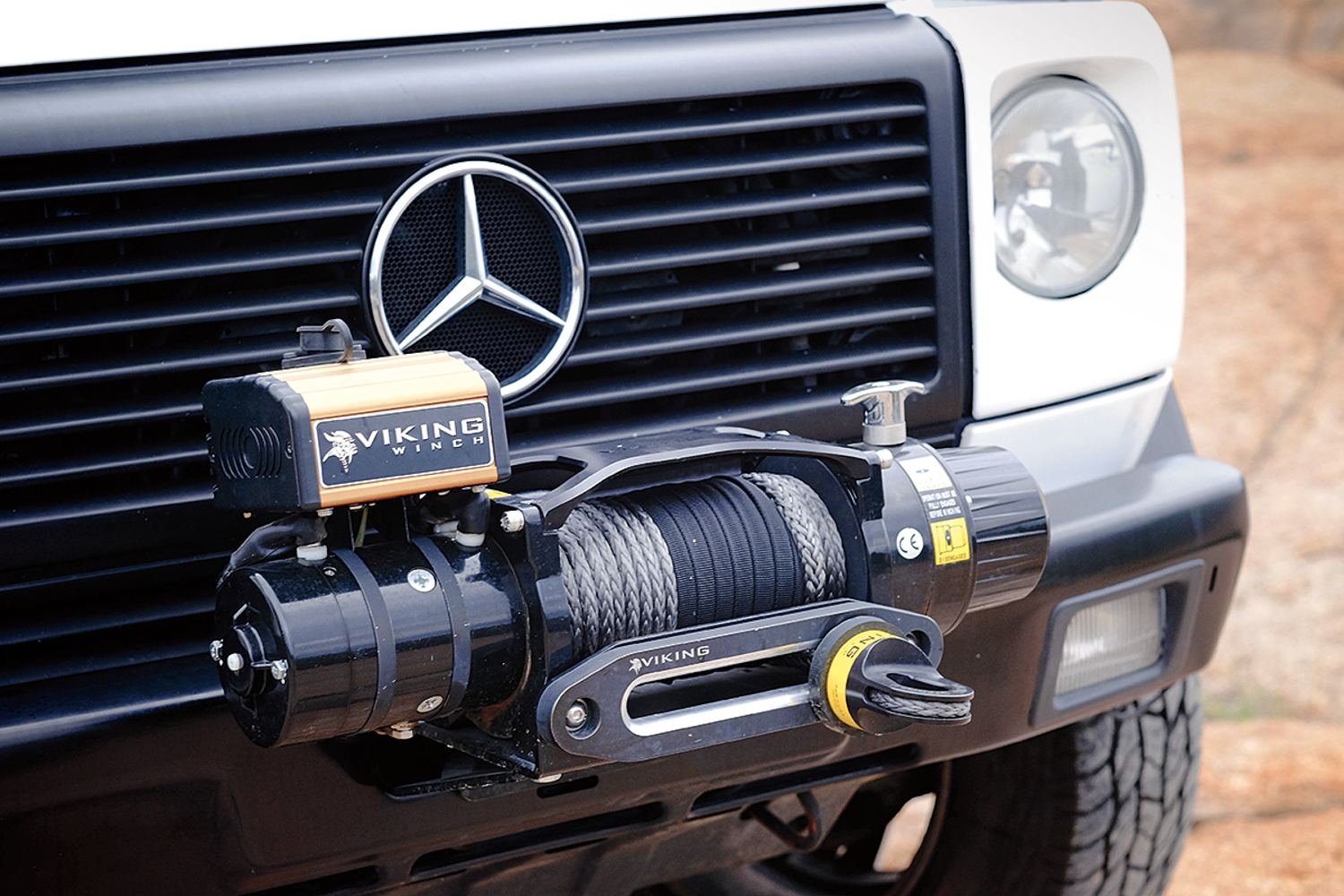

All G-Class are factory fitted with metal front bumpers, but it is possible to source a factory HD unit with an integrated tow pin. These bumpers are designed for the military 461 models, but easily install on the 463 variants as well. Bucking the trend, I did not fit a bull bar, but did purchase a removable winch tray from GWA that uses the reinforced pin and recess to secure the Viking 9,000-pound winch (manufactured by COMEUP) with Viking synthetic rope. Further back on the chassis, we mounted discrete rock rails (also from GWA) that protect the lower sill and exhaust. It does not protect from a horizontal impact, so I may fabricate round tube sliders to also function as a step and attach to the lower GWA units. Rear bumpers on the W463 are a weak link, the main structure being fiberglass and the end caps made of rubber. To resolve this, a GWA unit was selected, a product constructed from welded steel and designed to look relatively stock, even integrating factory lights and a receiver hitch. Beyond the excellent rock protection, the solution provides two 30-mm-thick recovery points welded to the face. So far, the trail modifications have enhanced the already competent stock performance; the rock protection provides additional confidence to push the platform a little further.
CAMP AND CAPACITY

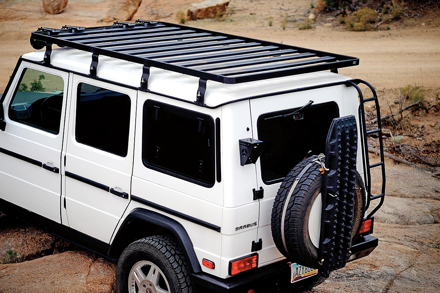

With the technical terrain requirements addressed, it was time to consider other modest modifications to improve comfort and convenience. One of the best ways to substantially increase reserve capacity is by installing a low-profile, lightweight roof rack. The goal is to have a means of carrying temporary loads and extremely light accessories. (For vehicles like this, I recommend roof loads of less than 150 pounds.) The roof rack also provides a flat surface for sleeping off the ground (yet under the stars) or as a photography platform. We selected a modular Front Runner aluminum rack which allows for a nearly unlimited combination of cross slat spacing. To access the rack, a GWA steel ladder was chosen and mounted securely to the rear body mount and drip rail. To the front of the rack are four Baja Designs HID lights, the outermost units serving a driving pattern and the innermost projecting a spot beam. A matte-black hood decal minimizes reflected light, and we wired the units to activate from factory switches. Even after years of use this rack is completely rattle free.

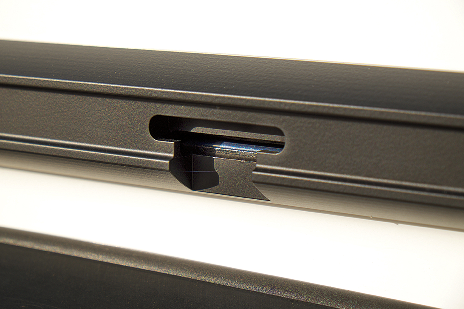

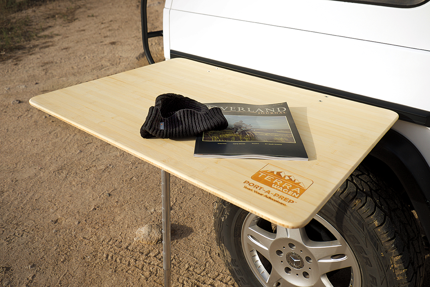

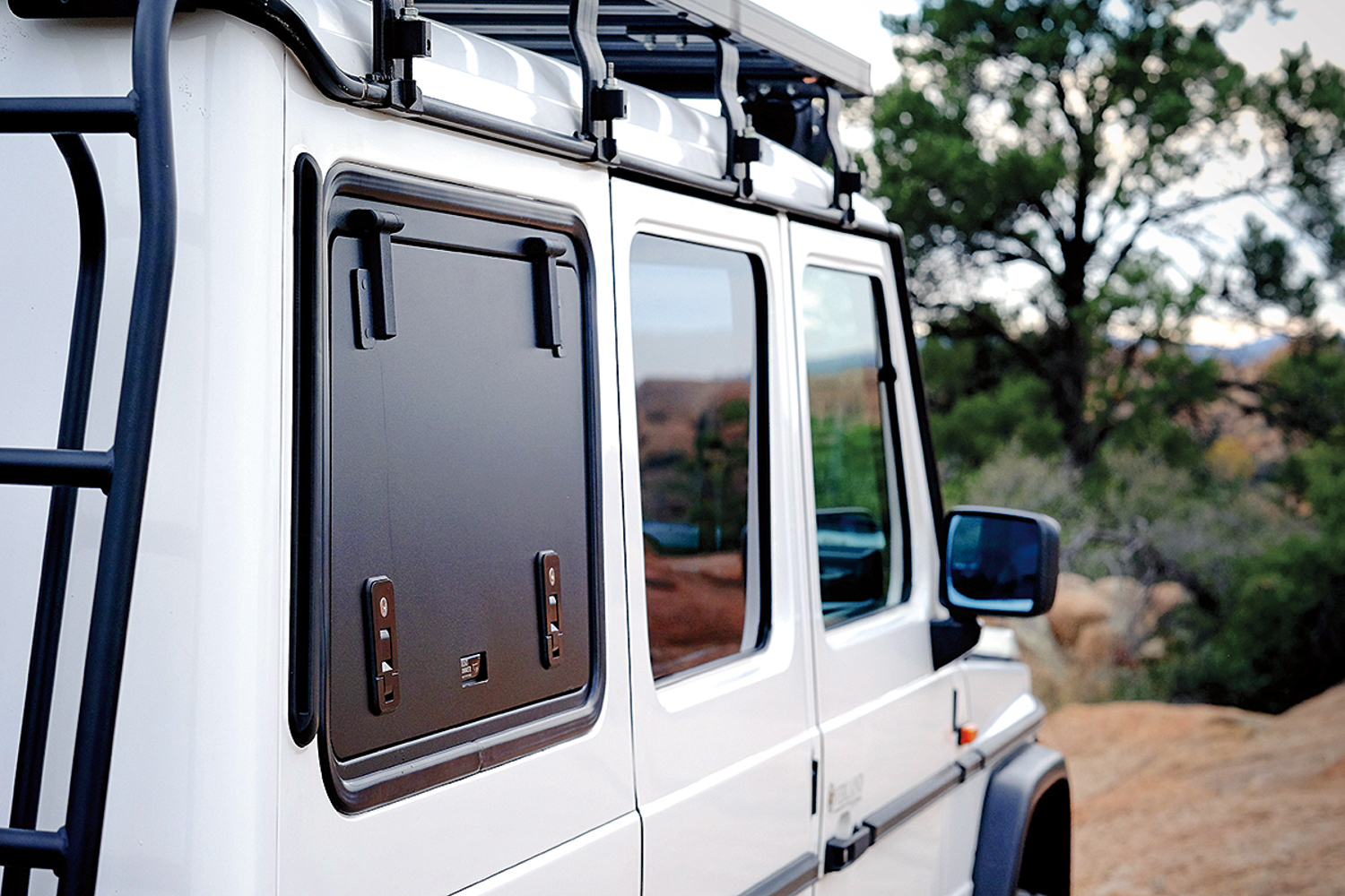

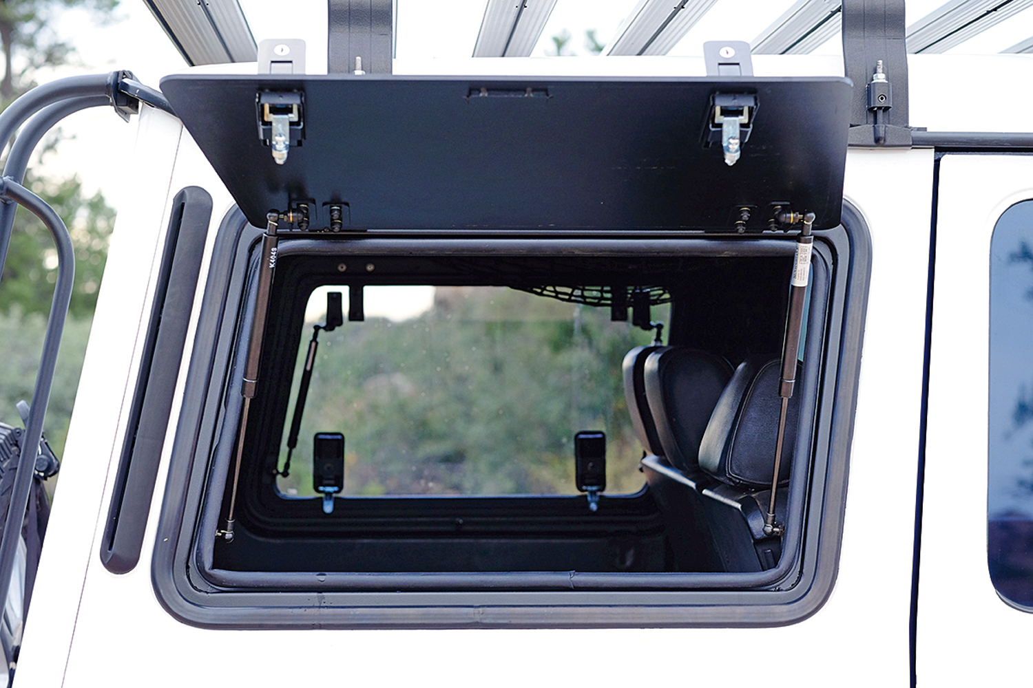

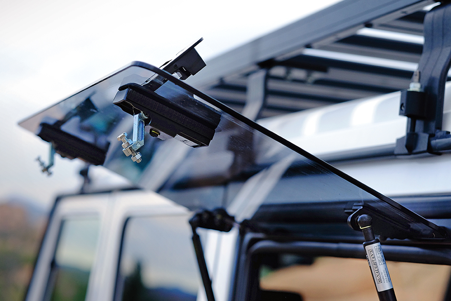

The final exterior modifications implement three innovative products. The first is a GWA storage panel that takes advantage of the void in the spare tire. This door finishes off the unsightly reversed wheel and allows me to store a recovery strap, several screw pin bow shackles, and a pair of gloves. The second, and one of the more interesting changes, was the fitment of the Front Runner gullwing windows, which are available with either solid aluminum panels (black powder-coated) or tinted glass. On the G-Class, these units are quite useful, easing access into the large storage area aft of the seats. With the aluminum plates installed, security is significantly improved, but at the cost of rearward visibility. Even so, I like the aesthetics of the product and after trying both options ultimately selected the solid metal solution. Each side has two locks and came key matched. The last accessory is a G-Wagen-specific table by Terra Wagen that is pure engineering art. It is rare to find a product that is so innovative and built to such quality and precision. Installation starts with a solid piece of machined aluminum that perfectly matches the profile of the factory body trim rails. In a few minutes, we had removed the OEM rail and installed the unit with the supplied high-strength, double-sided adhesive tape. This new structure provides the mounting for the back edge of the exquisite bamboo table. Two T-bars slip into the machined slots and then the front surface is supported by a single telescoping pole—absolutely brilliant.
