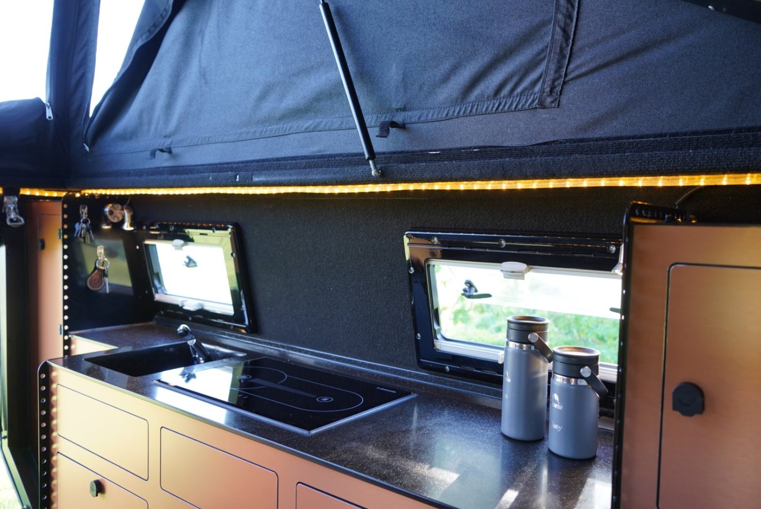

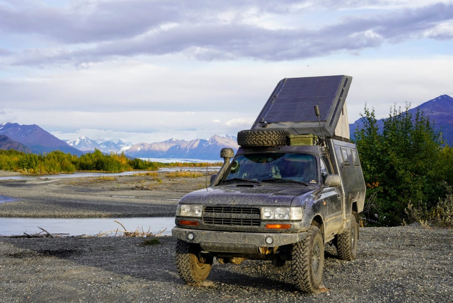

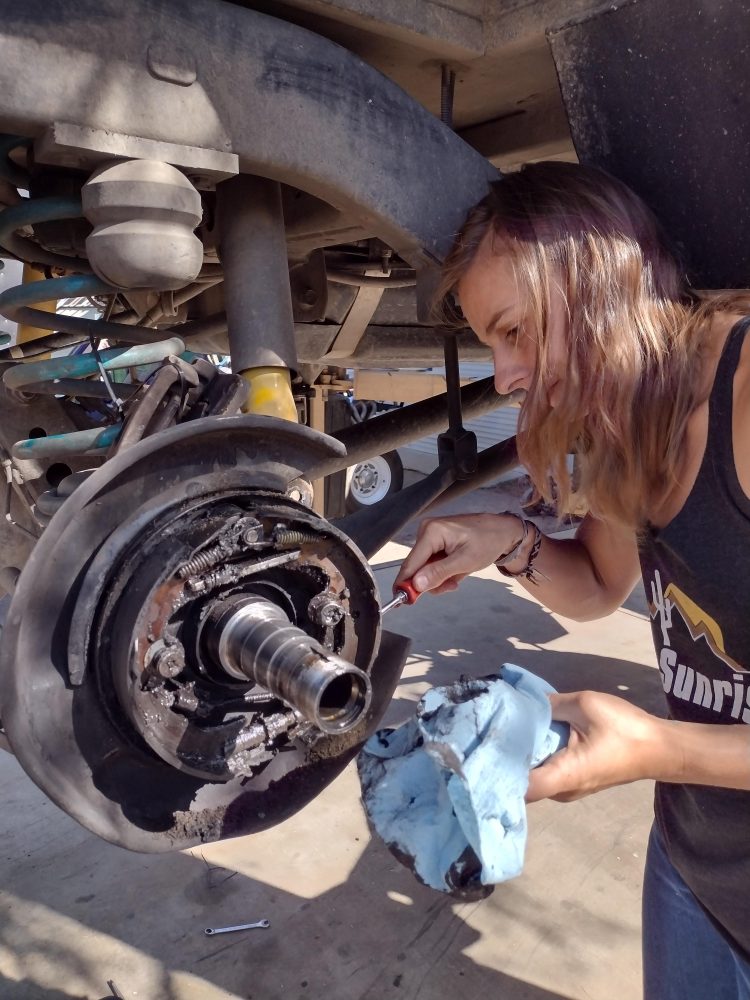

The 80-Series looked beautiful but was nearly a decade older than Goose, so Tim and Kelsey focused on reliability, replacing everything they could, from bushings to tie-rod ends, brake pads, calipers, and rebuilding the axles. They knew the truck would travel internationally, so they went full tilt, completing “20 years’ worth of maintenance” in a matter of months. Fortunately, the interior was like new. The previous owner preferred wheeling and never used the living space; the soft-close drawers were a bonus. The truck had an AGM battery but no solar, so the Hubers added 252-watt Sunflare Xplor solar panels, a Victron MPPT and DC to DC charger, and a Battle Born 100Ah lithium battery. They swapped out the water filtration system, designed more for the weekend camper than someone filling up from a Turkish roadside spring.

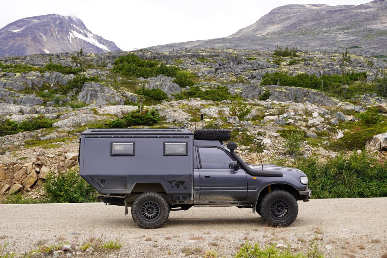

The Dobinsons suspension components worked like a charm, so the couple upgraded what already existed but added different spring rates. “We have 65 gallons of diesel, so we needed a little more height and a higher spring rate,” Tim says. The truck came with Braid Winrace wheels, sourced from Spain, which remained due to their lightweight strength. These are complemented by Toyo MT Open Country 255/86R16 tires, which the couple says perform well in the Pacific Northwest or Alaska (versus dunes or sandy tracks) due to their aggressive design. “We’ve stuck with the tall, skinny 33-inch tires,” says Tim. “When we wheeled or went to Baja, the 35s were cool. But when you’re overlanding, you’re lugging around these big tires and getting worse mileage.”
The truck wasn’t equipped with a winch, but the Hubers felt the addition was important as they travel solo, so Tim pulled the bumper apart and built a tray to house a Warn Zeon Platinum 10-S winch. “We didn’t want to cut and extend the chassis or any of that crazy stuff because it’s a pretty reliable 80 Series. Now that we’ve done all the maintenance, I didn’t want to mess with that.” The front axle mounts ripped off at one point (after some research, Tim discovered that this occasionally occurs in early 80-Series Cruisers), so the couple welded new mounts and castor correction plates to fix the issue.
Clearly, Tim and Kelsey aren’t afraid to grab the tools and make things happen. “My dad was a homebuilder, so I had the mentality of digging into it, figuring it out, building it, and doing it yourself,” Kelsey says. “We restored some cars, so I had a little bit of [vehicle] knowledge.” The couple would jump into projects together when they first met, working nights and weekends to get the job done. “We bought this Porsche 911 that we took on our honeymoon road trip on the Pacific Coast Highway up to Oregon,” Tim notes. “Every night, she would be there working on it with me. She’s not someone who’s just watching. She’s got rubber gloves on and is like, ‘I’m going to take this inside to the bucket of diesel and clean the birfields out.’ There’s nothing I’ve done on the trucks or cars that she hasn’t done some work on.”

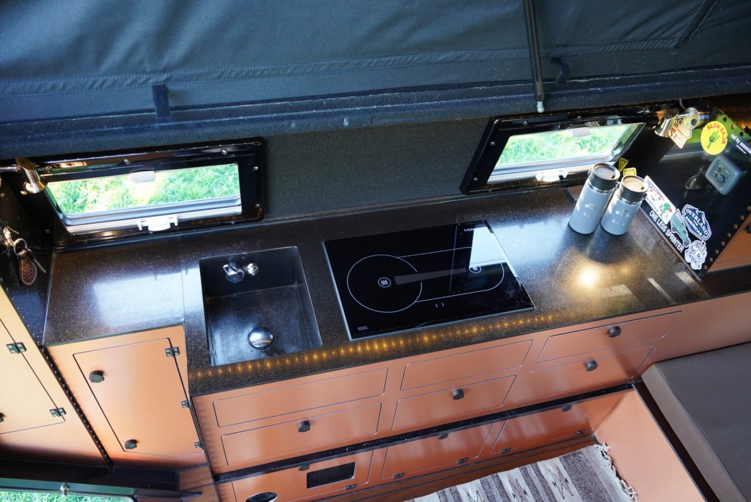

As with any build, there’s always room for little changes or improvements. Tim and Kelsey’s wants are few, but a bigger fridge with a freezer section is high on their wish list. They are running a Webasto diesel stove, which works fine for their electric kettle and coffee in the morning, but Tim is open to an upgrade. “If money were no object, we would add a second lithium battery and do an induction cooktop, because why not?” Although Tim admits he’s never coveted big rigs, in Europe, both he and Kelsey suddenly understood the appeal. “We went to a ski resort, and everyone was mountain biking and paddleboarding. If [Dusty] was a Harry Potter truck, we would have taken bikes. But where we’re at now, it’s about off-roading.”

1990 Toyota Land Cruiser HDJ80 with Maltec conversion

Sunflare Xplor solar panels, 252 watts
Victron MPPT and DC-DC charger
Webasto diesel cooktop
2,500-watt inverter
