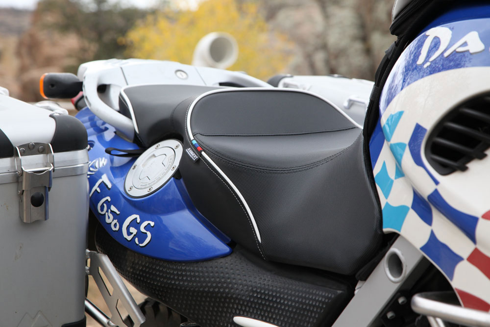

Continuing the refinements to the ergonomics, we sent off the OEM seat to the gurus at Sargent Cycle to have it rebuilt with their amazing Performance Plus conversion. The new seat not only features improved foam carved to a perfect shape, it is covered in fabrics designed just for adventure riding. The new seat transformed the bike into a long-haul machine, and greatly improved the overall aesthetics of the bike.

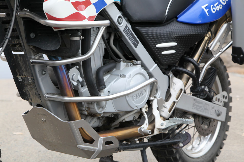

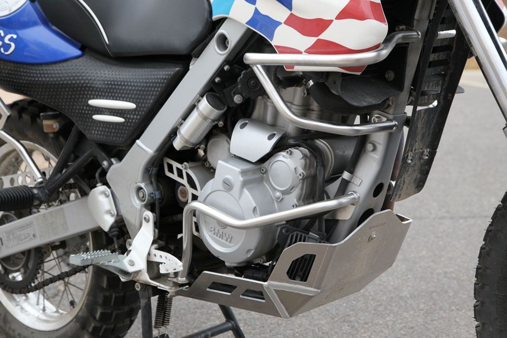

Any adventure bike worth its salt needs protection, so a full compliment of skid plates, engine, and tank guards were fitted. The factory skid plate didn’t seem hideous until we replaced it with the Touratech skid plate. Not only does it look better, it’s clearly a more substantial guard. The crash bars are elegantly simple, and don’t hang off the bike like a busted birdcage. All of the vitals now seem appropriately shielded from mishap. Additional praise for the crash bars can be attributed to the fact they don’t impede access to  essential components for regular maintenance. The “gas tank” panels can even be removed without pulling the upper crash bars off.

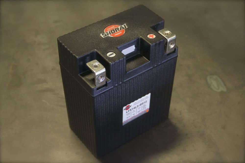

By now, the Dakar was starting to gain some weight, although not much. It was time to turn the scales back in a favorable direction and a quick way to shed four pounds was to replace the lead-acid battery with a Shorai Lithium battery. It also served to bolster the start-up performance, and while this bike seldom sits for long, it also reduced the need to always keep the bike on a battery tender. It is worth noting that start-up performance hasn’t been so great when the temps drop below freezing.

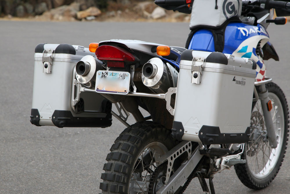

The last major addition to the Dakar was a set of Touratech Zega Pro anodized panniers. Not only are they a handsome addition, they’re incredibly well built and easy to use. Because the F650GS is a relatively small and nimble adventure bike, we opted to go with the smallest size panniers. At 31 liters, they’re slim and light, yet big enough for protracted adventure travel. Easy to remove without a need for tools, they’re a nice addition to a bike which will see a constant mix of true adventure riding paired to daily commuting duty.
