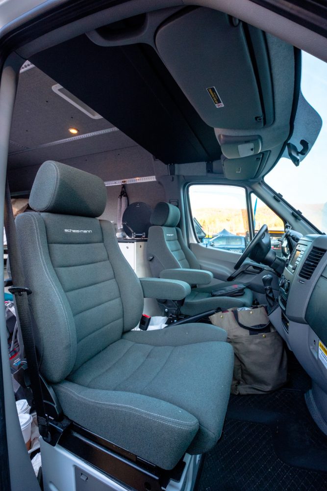

The driving and living comfort trade-off is without parallel. Large, several-ton trucks (think Unimog) have more comfortable living, but a rough driving experience. A new Land Cruiser has a similar driving experience to the Sprinter but with much less living comfort. The Scheel-Mann seats help immensely with ridding lower back pain on long driving days. Living and traveling in a vehicle that is standing height is a game changer for extended duration travel. Crawling into a rooftop tent may be okay for a long weekend, but not long-term. I am 6’ 2”. Someone who is 6’ 3” should have no problem standing inside.

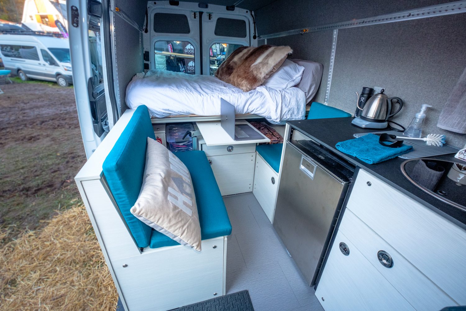

If you’re not in love with the furniture layout, the Goose Gear S-series furniture is reconfigurable by virtue of the airline track (L-track) mounting system embedded into the floor, ceiling, and walls. All it takes is unfastening four to six bolts per furniture piece to relocate. This also allows for dual-use as an overlanding or utility vehicle to haul 4×8 sheets of plywood.

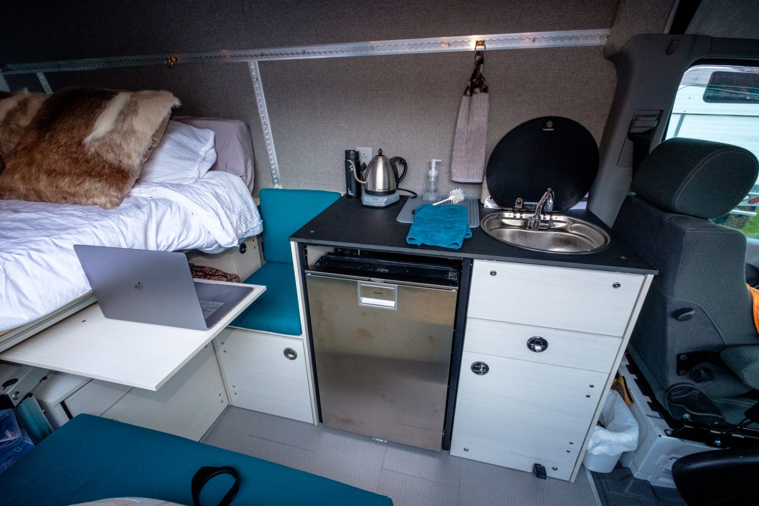

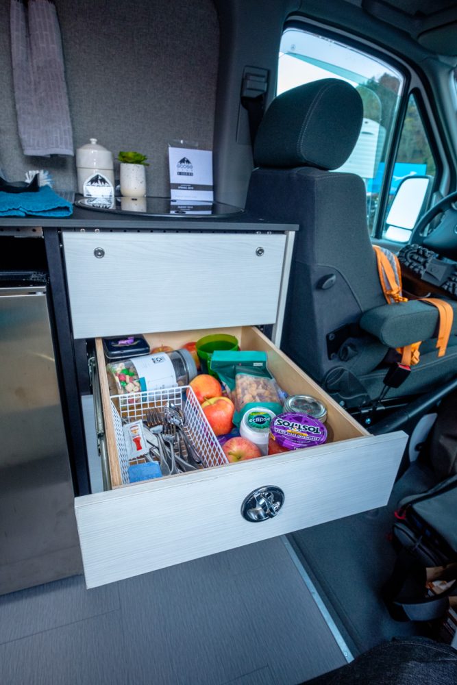

Furniture
  • Custom designed by Goose Gear
  • Construction:
    1. Lightweight, proprietary aluminum extrusion frames
    2. Lightweight, imported laminated marine plywood
    3. Drawer guides are rated at 350 pounds
    4. Compression latches are all-metal construction
    5. Blum high-use hinges with three-way adjustment
  • Galley:
    1. Dometic Coolmatic 140S fridge
    2. Dometic sink with hinged lid
    3. Whale foot pump
    4. 5-gallon Scepter cans for freshwater and gray water storage
    5. Galley is approximately 42 inches wide and 22 inches deep
  • Bench seat with 20-gallon water storage underneath (all water system components reside within the heated inside space—no freeze-ups)
  • Single seat with pantry underneath
  • Under-bed cabinet for toilet storage and supplies (could fit Thetford Porta Potti, Wrappon, Cleanwaste portable toilet, or similar toilets)
  • Cabinets above rear wheel arches
    1. Battery, inverter, solar charges, electronics (passenger side)
    2. 4-foot-long lockable storage (driver’s side)
  • Upper cabinets, approximately 5 feet long
  • Floor system:
    1. Airline track (L-track) for configurability and secure tie-down of gear
    2. High-wear vinyl tiles
    3. Fully insulated

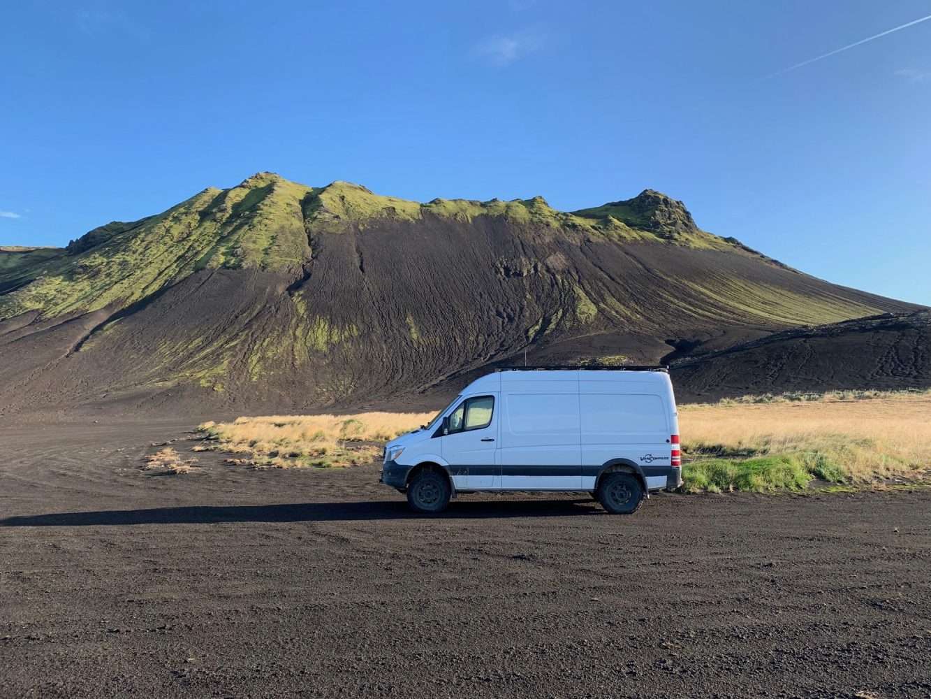

Rough Terrain Enhancements
  • Van Compass designed and installed
  • Stage 5 Striker 4×4 Sprinter lift kit with Fox shocks
    1. 2-inch lift maintains factory geometries of wheels, driveshafts, and transfer case
    2. Will accept up to 35-inch tires
    3. Heavy-duty rear springs allow for cargo capacity
    4. Front SUMO springs tame extra weight while maintaining driving comfort
    5. Fox shocks damp larger springs and additional load
  • Van Compass armor and skid plates
    1. Rock sliders protect lower rocker area
    2. Engine skid protects oil pan and front differential
    3. Belly plate protects transmission and transfer case
    4. Rear differential skid protects rear diff
    5. Fuel tank plate fully protects 25-gallon OEM fuel tank
  • Van Compass front winch bumper with an integrated 2-inch hitch receiver (allows for a winch to be fitted behind the OEM bomber cover (no winch is currently fitted. Hitch receiver is the front recovery point)
  • Rear OEM 2-inch hitch receiver (acts as rear recovery point)
  • Method Race Wheels, Trail Series 701, 17-inch w/integrated Bead Grip technology
  • BFG 34X10.5R17 A/T KO2 tires
  • Outback Extreme Magnum air compressor with exterior hook-ups
  • Van Compass sway bar disconnect (allows for better off-road suspension articulation)
  • Agile Off-Road 20-gallon auxiliary fuel tank (integrated skid plate)
  • ADF Sprinter modified spare tire bracket (keeps larger than OEM spare tucked-up under chassis)
  • Mercedes Sprinter Pedalbox (increases throttle response by removing delays in the accelerator, enhancing drivability)

  • Scheel-Mann Seats, Traveler R, heated
    1. Adjustable lumbar support
    2. Passenger swivels and heat available from lithium batteries (engine off)

  • Leveling bed and table platform (patent pending)
    1. Electric leveling control of bed platform to always sleep level even when the camping spot is not
    2. Table slides out from leveling platform, so it’s also leveled with the bed
    3. Table is counter-height for more food prep surface
