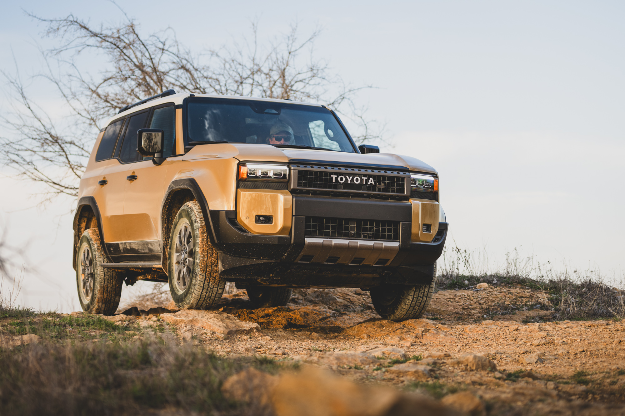

Just looking at the new Land Cruiser, it is clear that capability was at the top of the engineering team’s mind. From the center and rear locking differentials to the front Auto LSD (think A-Trac). To further improve traction, the KDSS of the 4Runner and GX has given way to a driver-selectable front swaybar disconnect. With the touch of a button, articulation improves by over 15%, with the added benefit of enhanced driver/rider comfort with less head toss.
With the First Edition (and other trail-oriented packages), the tire diameter is nearly 33 inches on an 18-inch wheel. There is speculation based on the brake disk diameter that a 17-inch wheel will still fit, as that would be a more effective choice for flotation, deformation, and mechanical keying of the tire in soft and/or technical terrain. For our design standards, a tire diameter should be twice (or more) the wheel diameter, which can be challenging to find. Regardless, 33-inch tires are a great start and better than many in the class. The 250 has a stated ground clearance of 8.7 inches, but I suspect it is closer to 9.3 inches in the models with larger tires.
New Land Cruiser 250 OverlandNew Land Cruiser 250 Overland rear
Additional considerations for capability include the body shape and clearance angles, which all compare well in the class. The approach angle is 32 degrees, which is notable, and the breakover of 23 degrees is competitive with other brands, but the departure of 22 degrees lags behind the competition. Again, these are early specs, and the models with larger tires will likely fare better.
