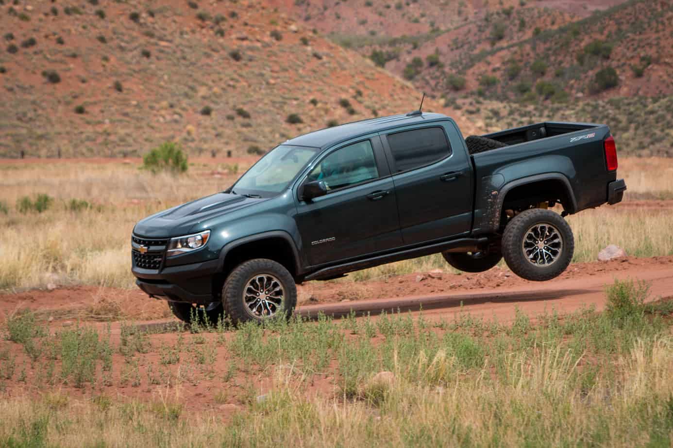

Sand soared off the tires in a wide arc as we rounded the first bend of the track. “Give it some more throttle,” the instructor urged as we entered a straight. The ZR2 flew over the heavy corrugations with ease as I hit the brakes hard before diving into the next left. As we slid out of the corner to the sound of a spooled 2.8L Duramax, I noticed a sharp rise in the track ahead. Once again the instructor urged me to “hit it with some speed.” So, I did. Houston we have liftoff. All four tires rocketed off the ground, and something between a four letter word and a laugh escaped my mouth. Manufacturers don’t usually allow you to jump their trucks. With a cloud of dust the tires reconnected with the dirt once more and I punched the accelerator to go do it again.

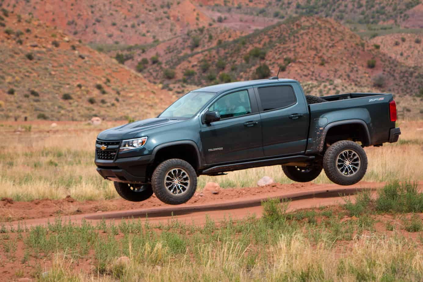

On heavy corrugations the truck was surprisingly smooth, with little interior vibration compared to the abuse being absorbed by the suspension. Cornering was excellent, and even when pushing the ZR2 to the point of losing traction, it felt composed and predictable. Despite hours of track use, aggressive driving, and no less than 18 jumps from each journalist, we experienced no perceptible heat fade in the shocks—a welcome side effect of using spool valves, which are largely unaffected by temperature.
In extreme compression situations (aka jumps), I was blown away by how effortlessly the ZR2 landed. Even when I accidentally hit the crest with too much speed, the return to earth was smooth with a quick return to a neutral position.

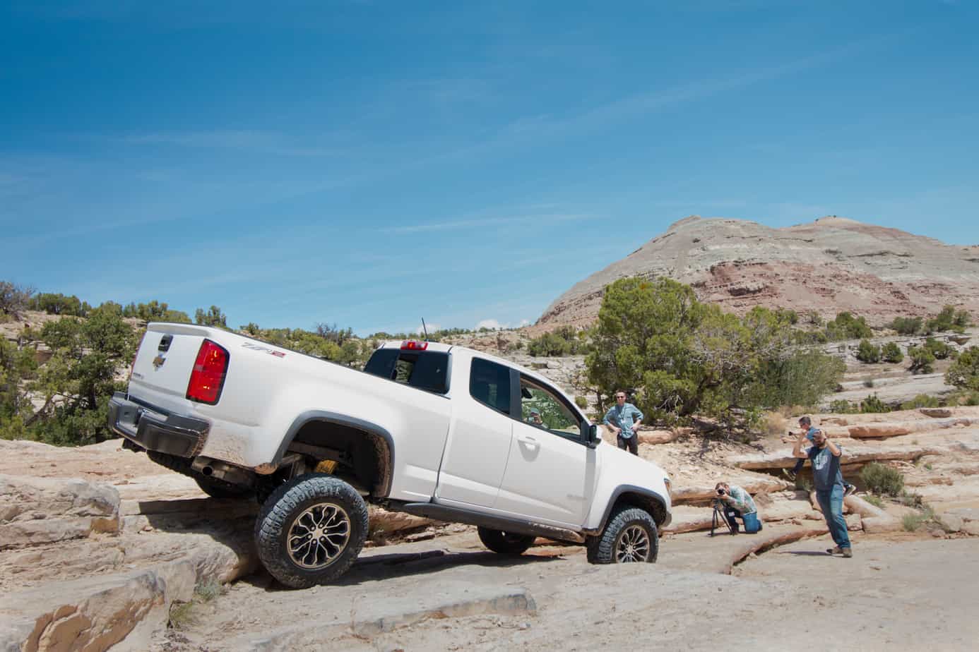

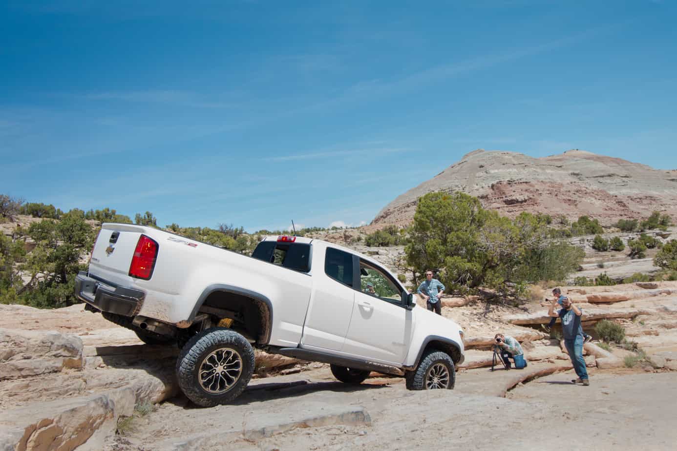

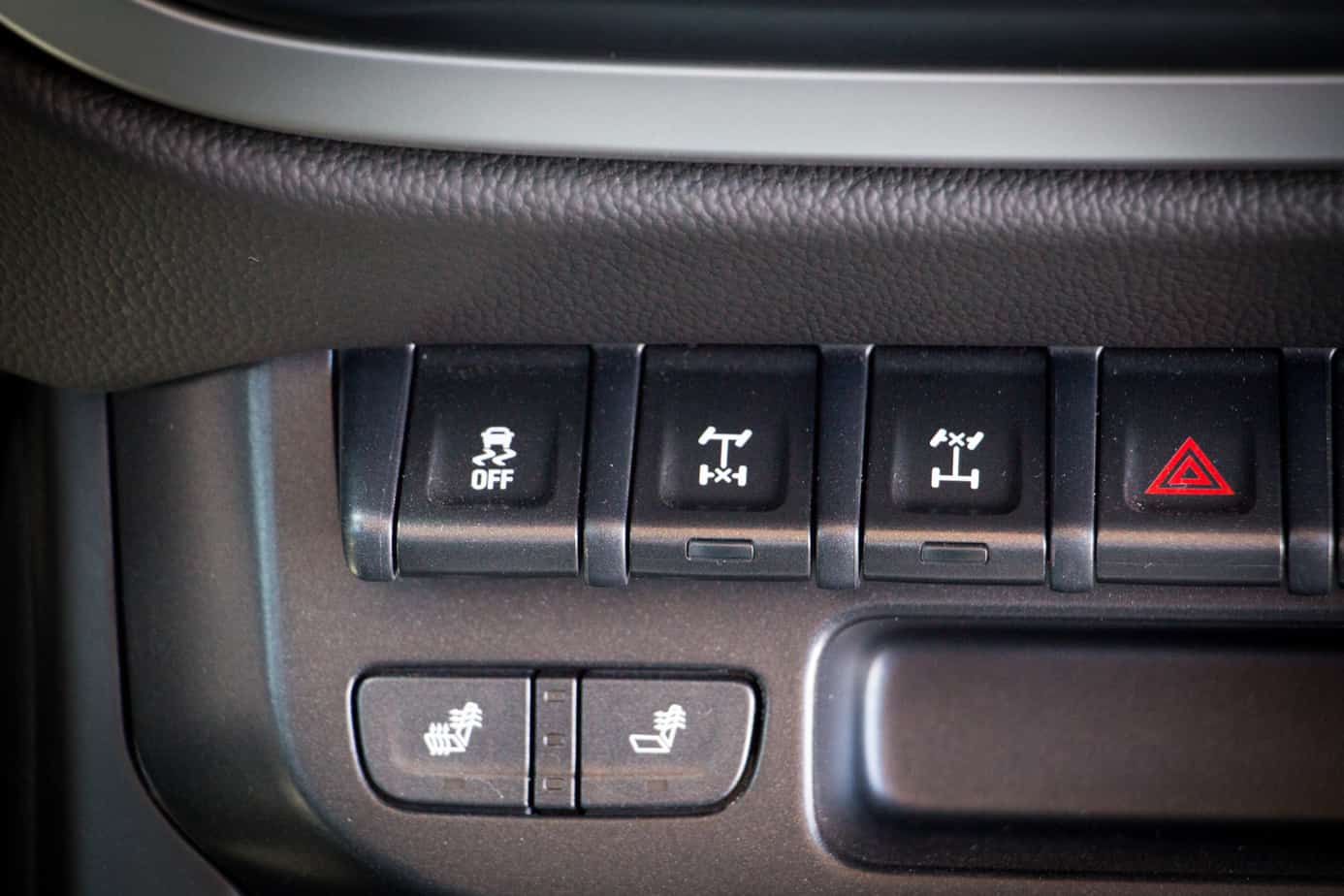

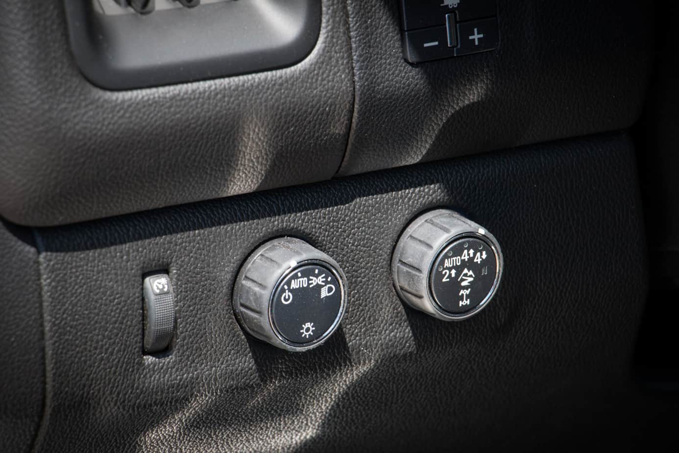

The other huge upgrade to the ZR2 is the addition of front and rear electronic lockers. We mentioned in our last article on the Z71 that the G80 auto-locker had difficulty engaging at low speeds, so we were thrilled to see they had remedied that situation with these manually engaged units. On the rocks they performed flawlessly, and made challenging ledges seem like a cakewalk. Engagement was smooth and straightforward, and several journalists who had never driven off-road were able to scale the obstacles without issue. You can even engage the rear locker in 2WD at any speed, so for those who liked the G80 for fast desert tracks, you won’t be disappointed.

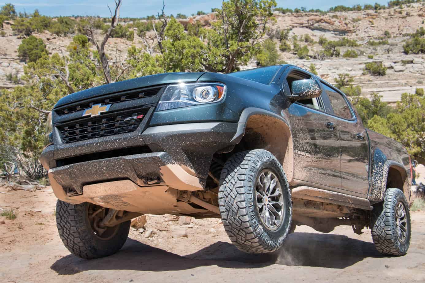

Two of the Z71’s bigger problems were the terrible approach angle and vulnerability of components to rocks, both of which have been addressed in the ZR2. In addition to the 50 millimeters (2 inches) of lift provided by Multimatic’s DSSV, the new Colorado has ditched the lower air dam for a high- clearance alternative, which brings the approach angle from 17.3 degrees to a respectable 30 degrees. Departure angle is up from 22.1 degrees to 23.5 degrees, and the breakover has increased from 19.8 degrees to 23.5 degrees, with a total of 8.9 inches of ground clearance at the lowest point (beneath the rear shocks).

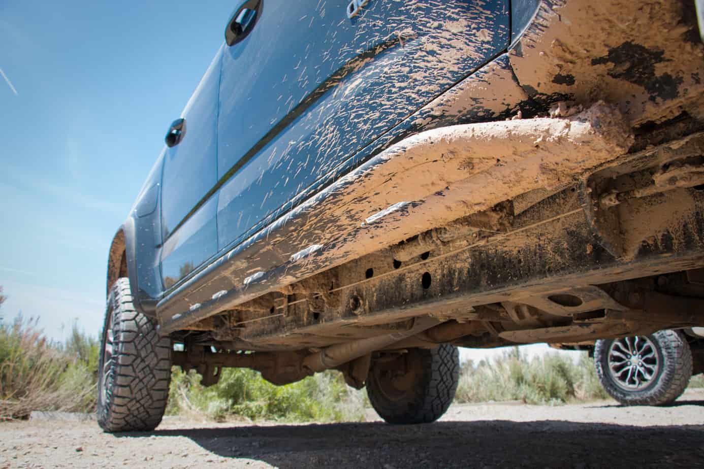

With this additional clearance we were far less concerned about trail damage, but accidents happen, so we’re glad to see that Chevrolet did a considerable upgrade to their protection package. In the front, a 4-millimeter aluminum skid plate was bolted into place to shield the radiator and engine oil pan, while a 3-millimeter aluminum skid was used to protect the transfer case further aft. There’s also a set of full-length sliders included as a standard feature, which is really going the extra mile. We only saw these put to use once during our evaluation, but they took the hit without flinching, and carried the ZR2 down the ledge while keeping the rocker panels safe.

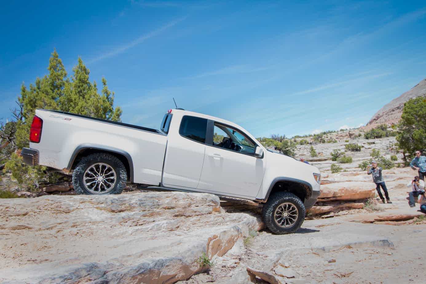

(A first time off-road driver taking the ledge with a bit too much speed)

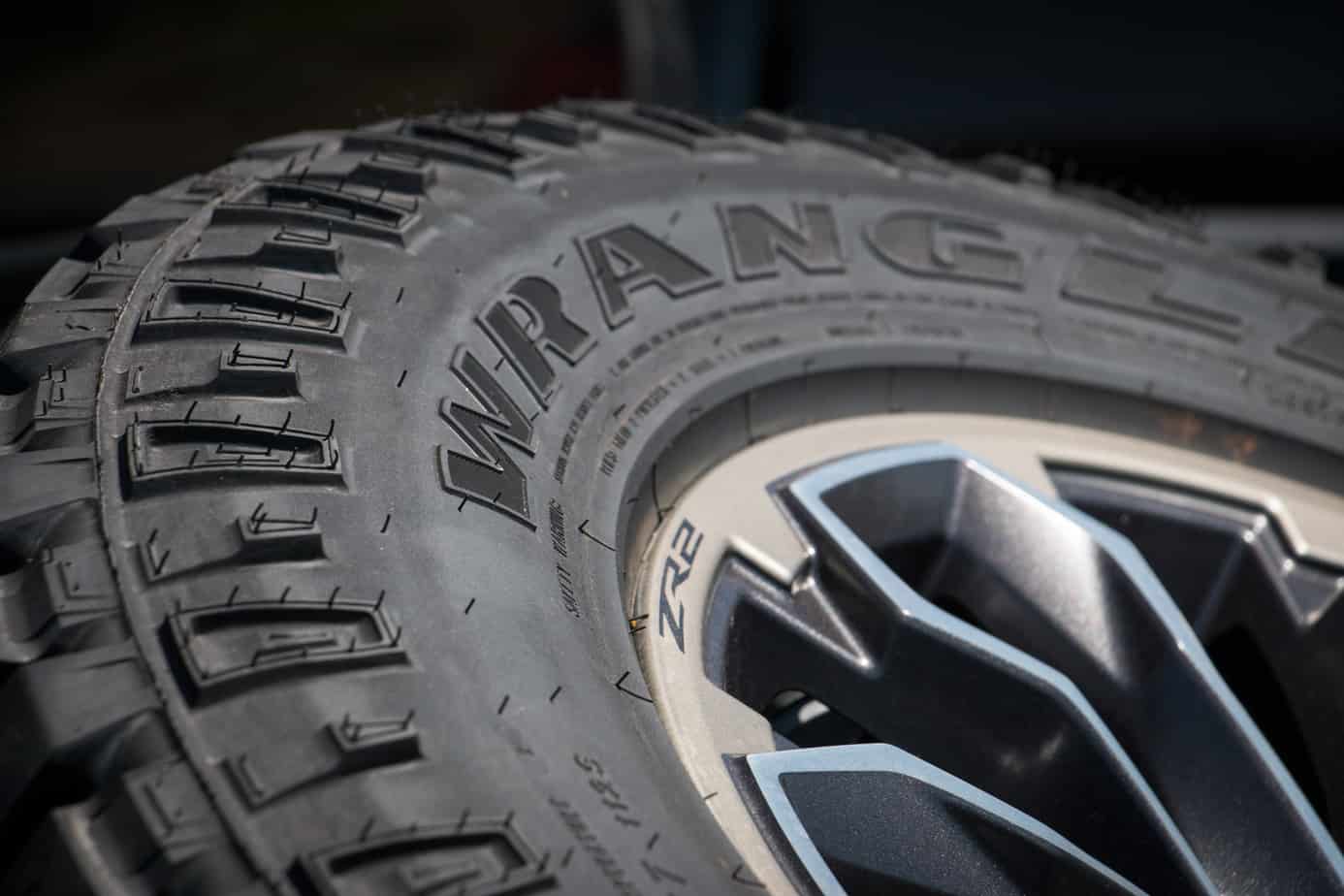

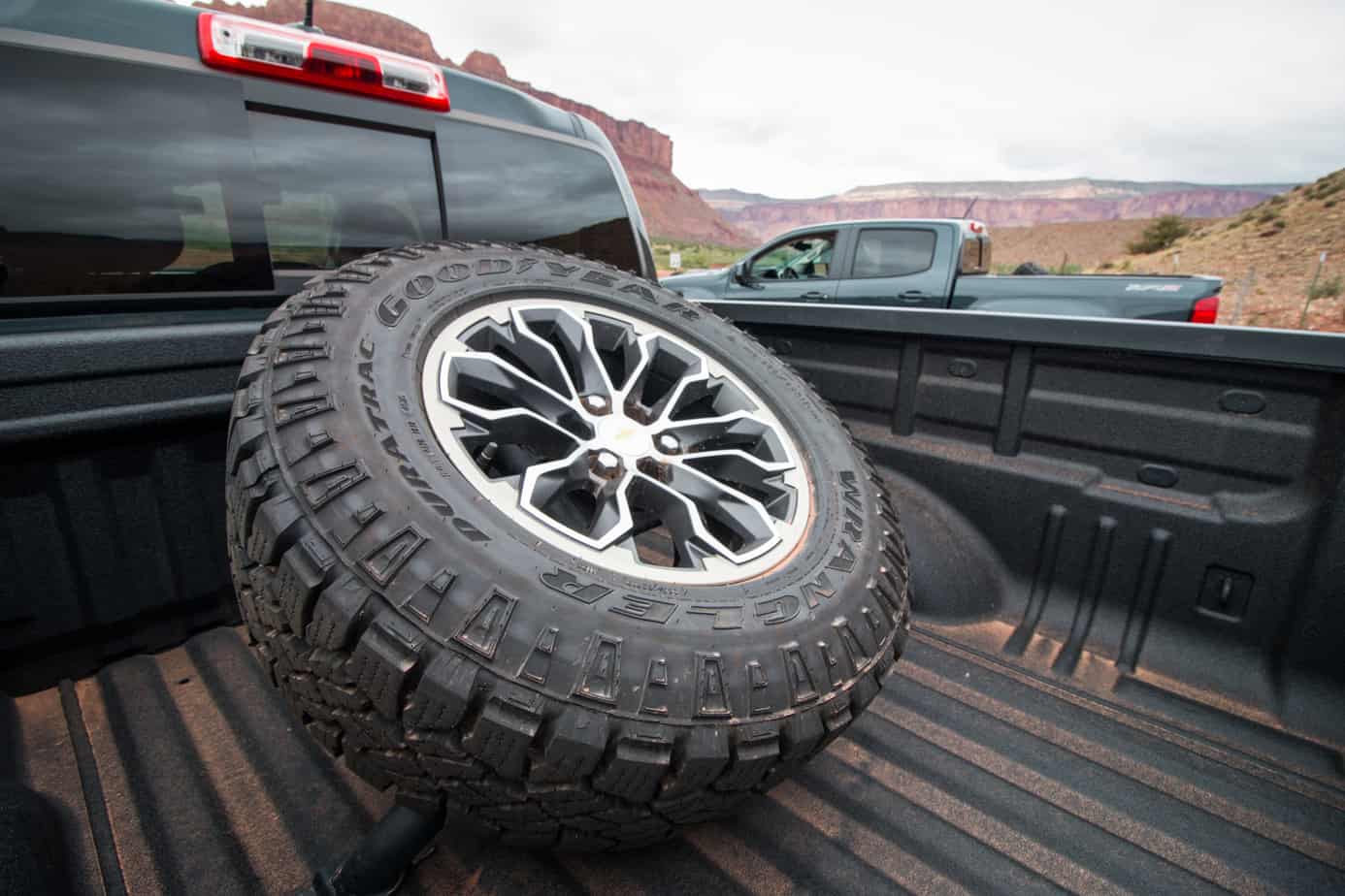

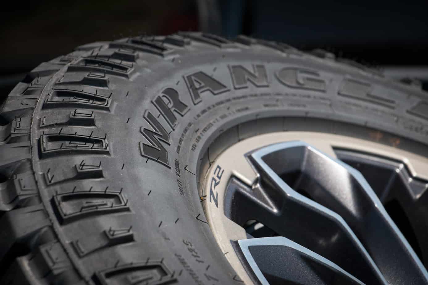

One of the first changes I usually make to a vehicle is a tire swap. I hate the smooth look of stock “all-terrains” and usually find their performance lacking. That being said, the ZR2 is an exception. Chevrolet upgraded to a larger 31-inch Goodyear Wrangler Duratrac, which gives the truck a little more clearance, a lot more traction, and a fitting aggressive look. They also wrapped these tires around a new 17-inch wheel exclusive to the ZR2, which finishes out the vehicle nicely.
