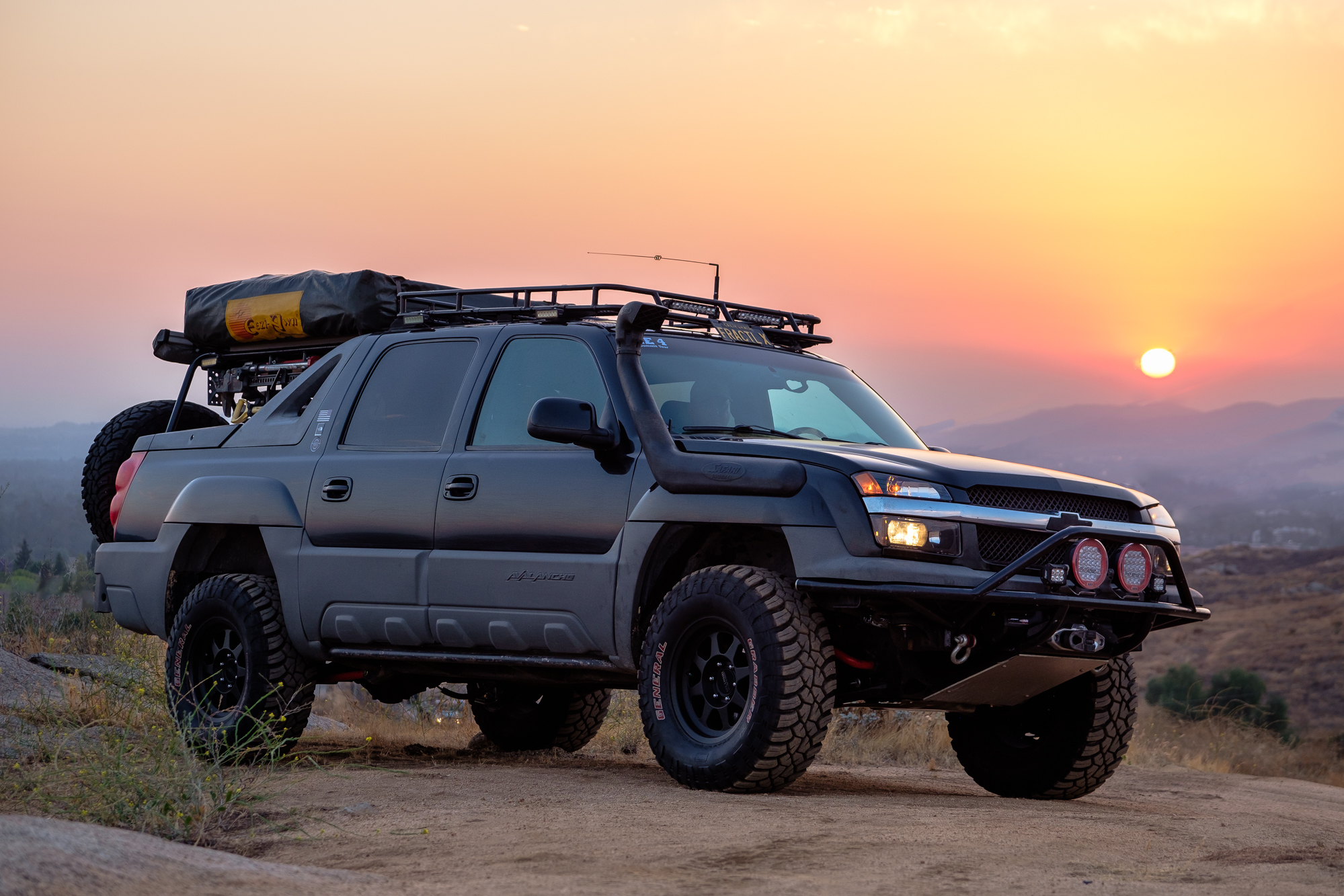

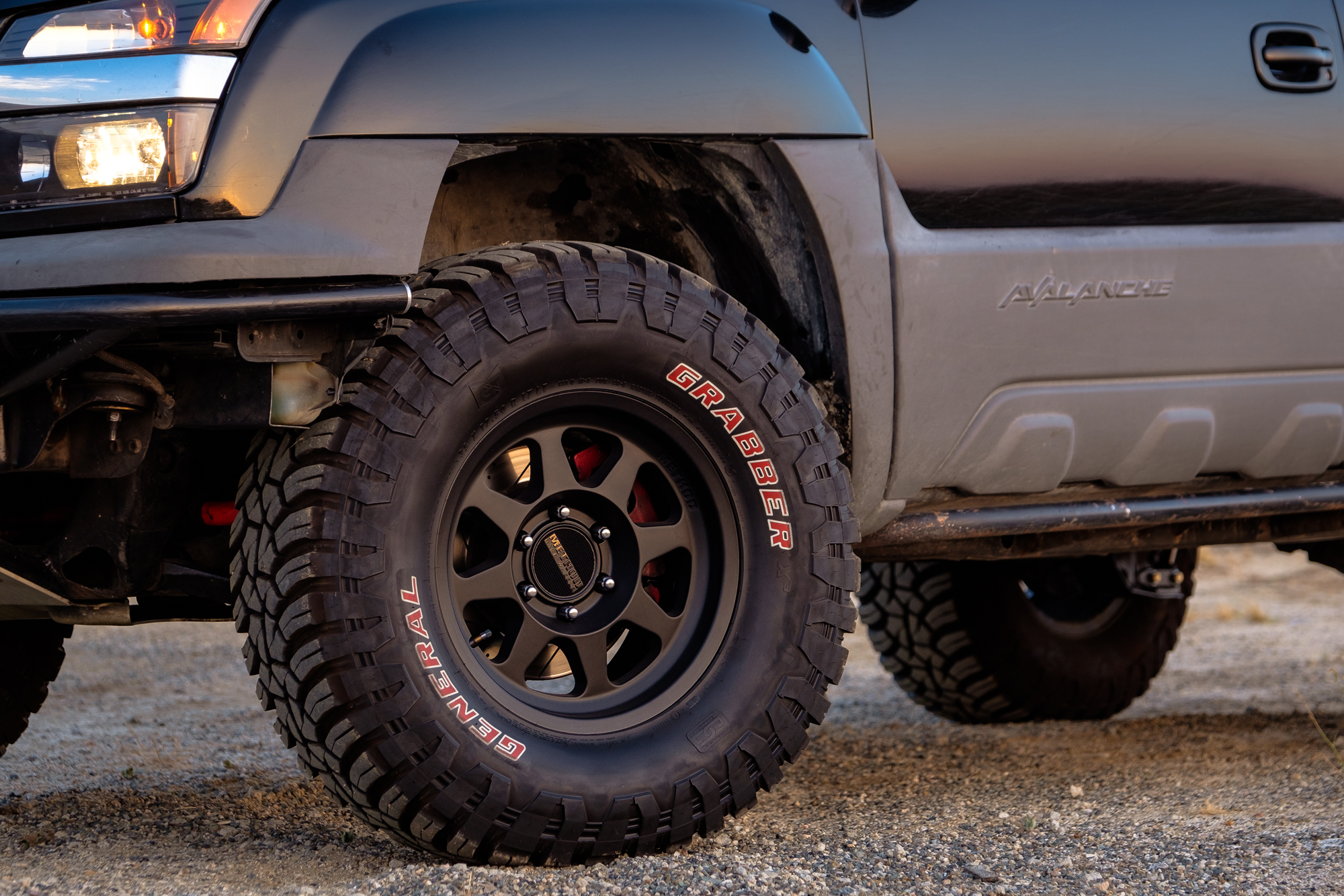

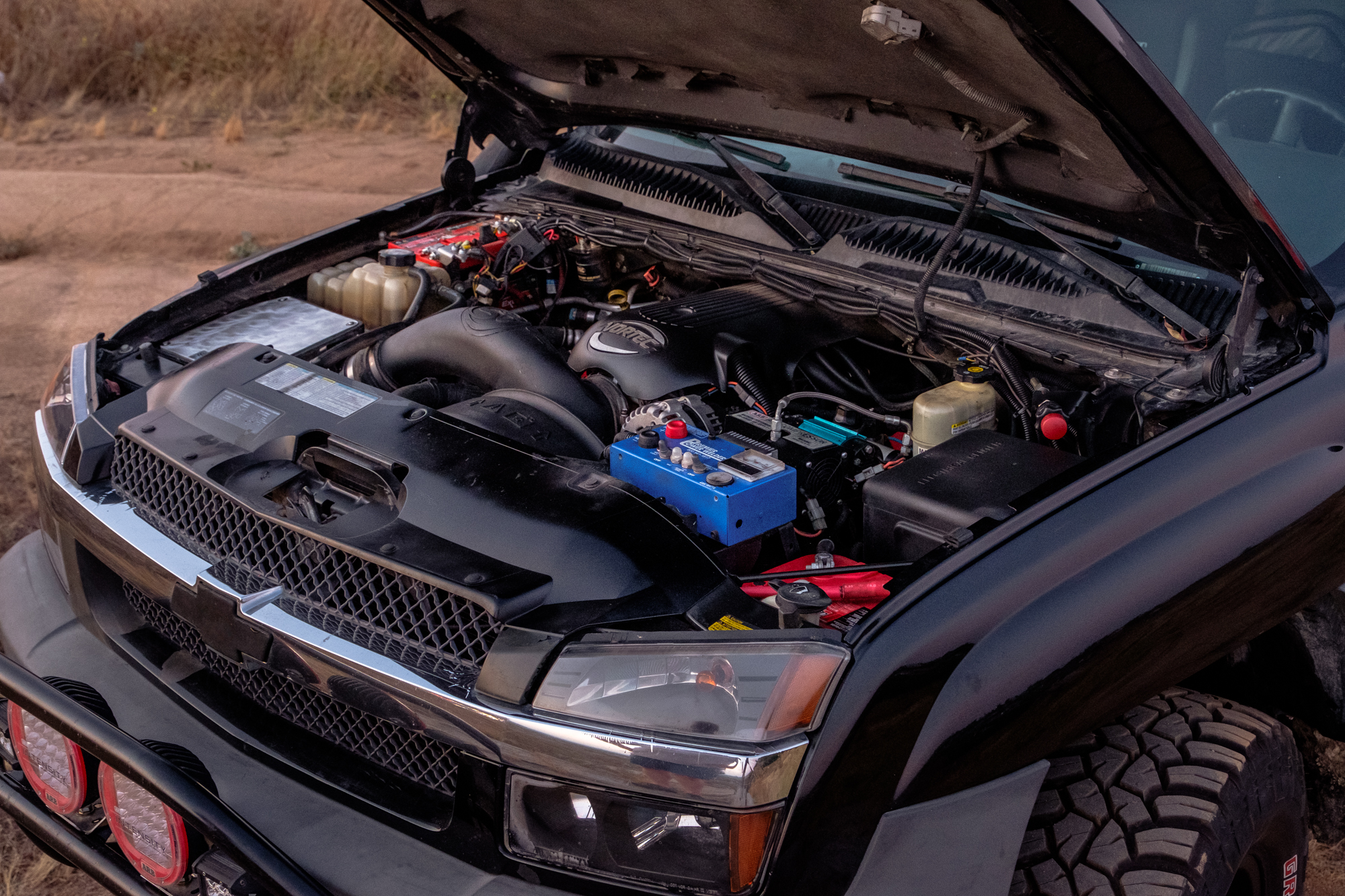

The Avalanche you see here is almost nothing like the factory model. Where the stock LS put out 285 horsepower and 310 pound-feet of torque, Bill Creech’s truck now makes 325 horsepower and 350 pound-feet of torque and delivers that torque at 2200RPM instead of the original 4600RPM. The aftermarket 4L60E transmission is chock full of severe-duty components, paired to an upgraded torque converter, and cooled by a 30,000-pound trans-cooler. It stops its mass with an oversized Z36 severe-duty brake kit from Power Stop and rolls on 35-12.50/17 General Grabber X3s. It has a welder for emergencies, tools and spares for every eventuality, and a list of upgrades so long it might be easier to tell you what’s still stock. In other words, we have a lot to cover, so let’s get to it.

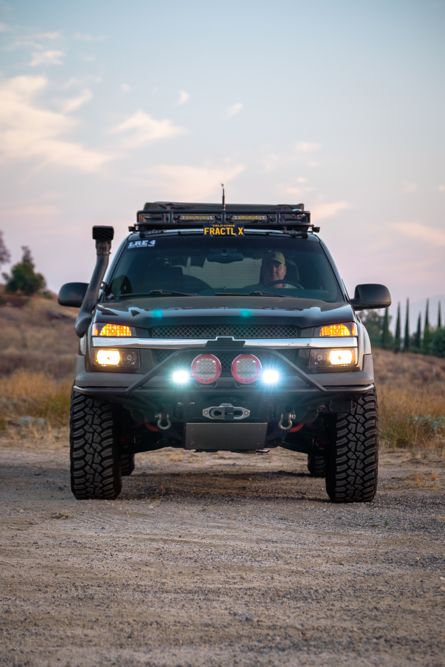

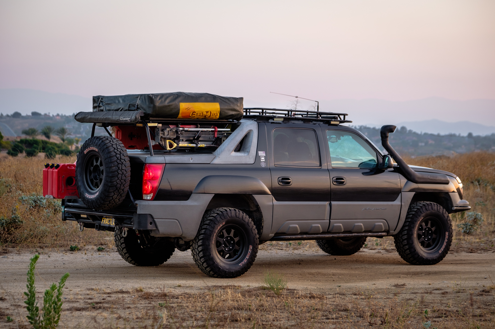

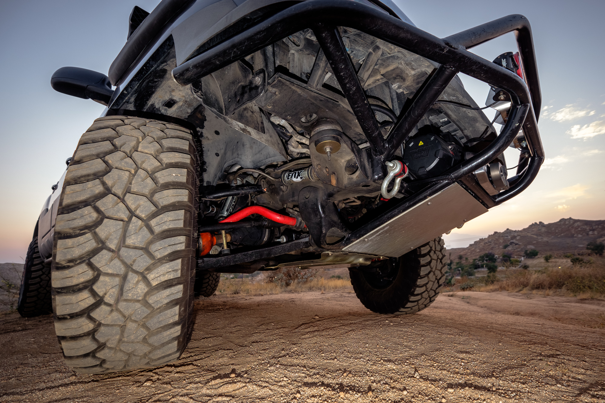

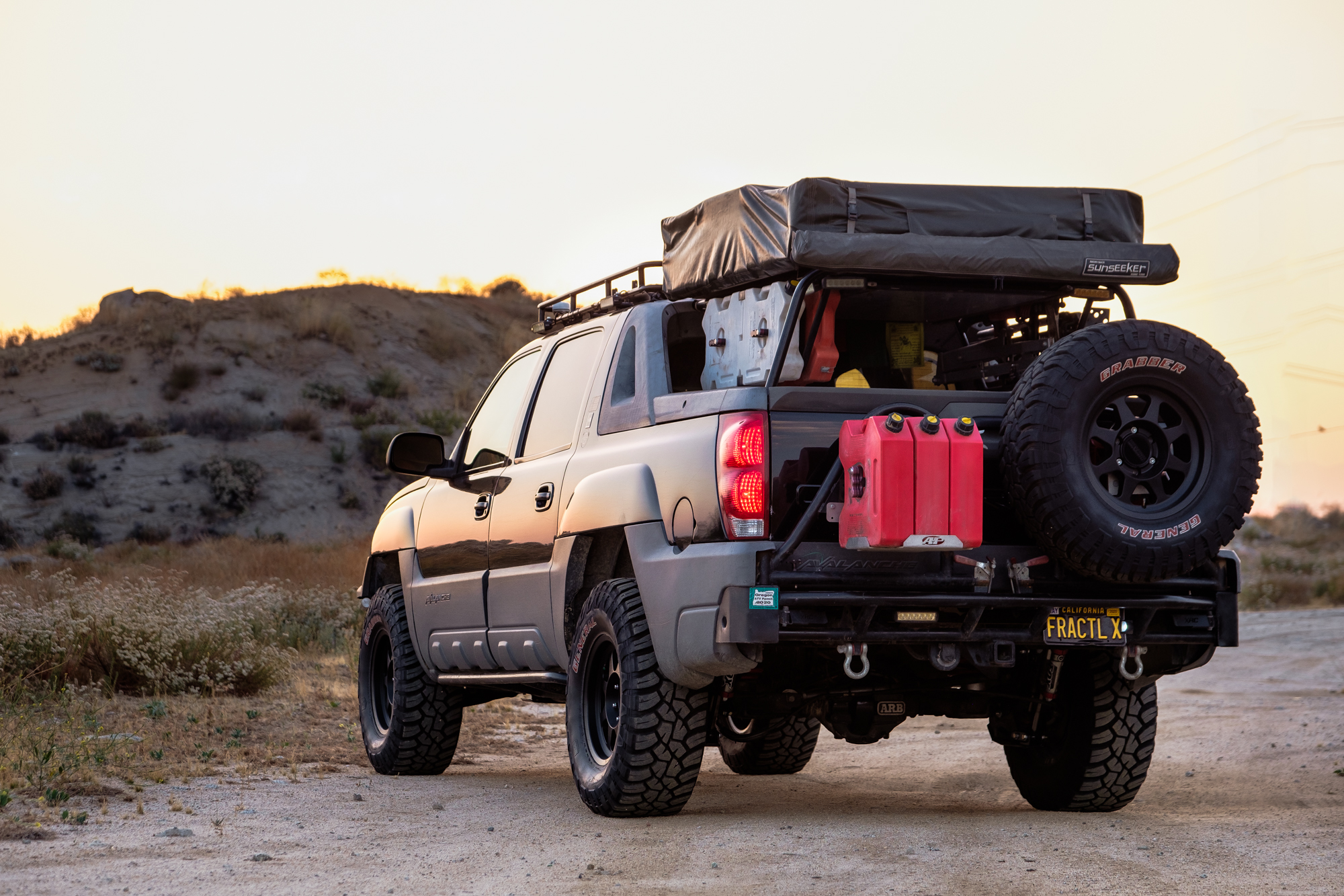

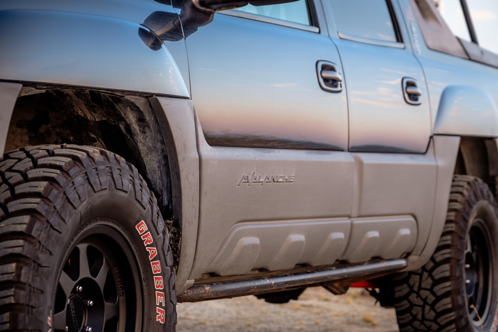

While the Avalanche’s plastic cladding may be sturdier than paint, it needed some real armor if it was going to see any good trails, so Bill gave Brent Boggs of BB Fabworx in Rancho Cucamonga a call. They started the process with a full set of skid plates underneath, which tied into an aluminum bash-plate and tube bumper in the front. This sports ARB Intensity LED lights with smaller LED pod lights to replace the factory fog lamps. Rock sliders were run the full length of the doors and tucked up close to provide maximum clearance and a clean look. To raise the rear departure angle and ground clearance, Bill then had a custom rear bumper made with dual swing-outs which pulled the spare tire out from below the bed and onto the rear of the truck. While they were at it, they decided to reinforce the frame to accommodate heavier payloads and stress on corrugated roads.

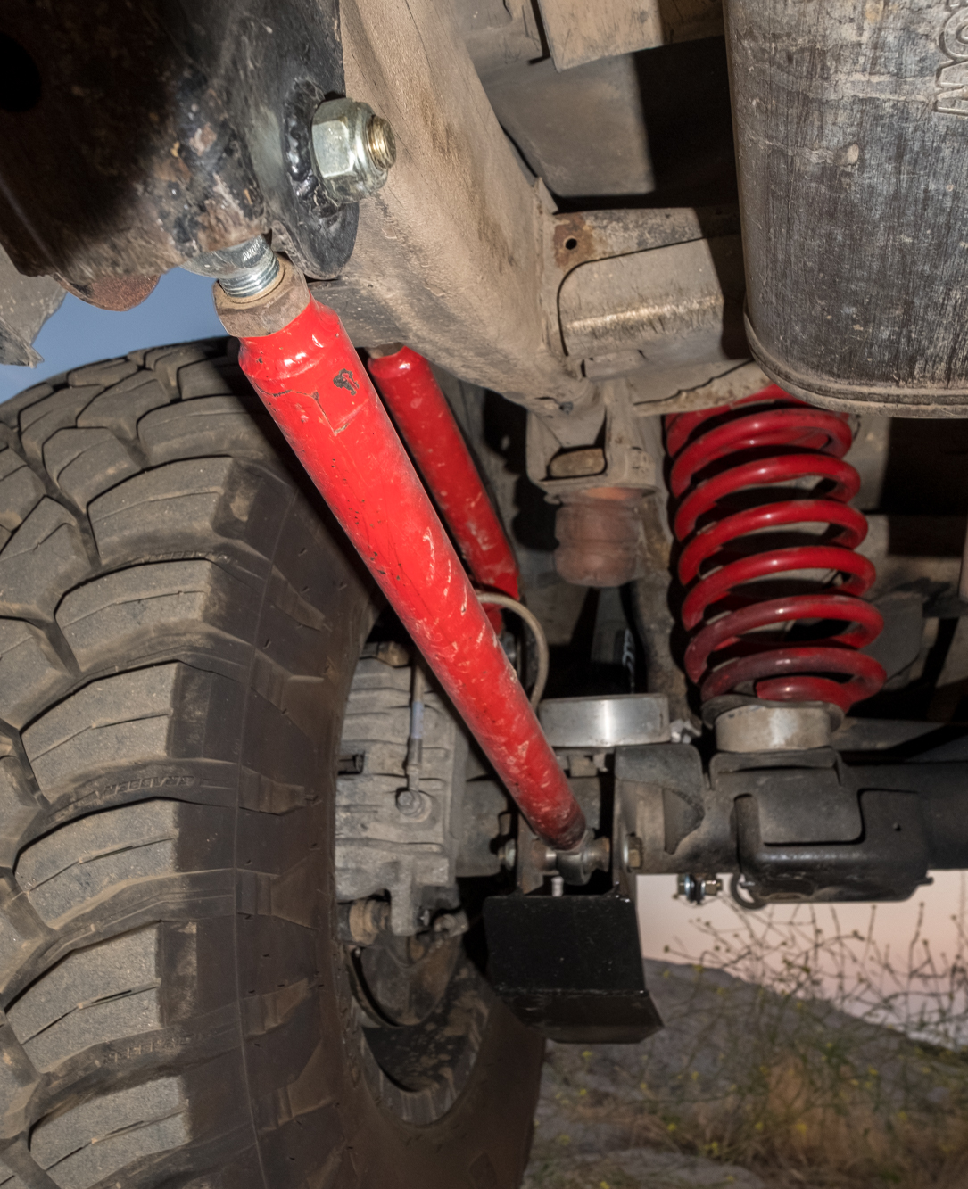

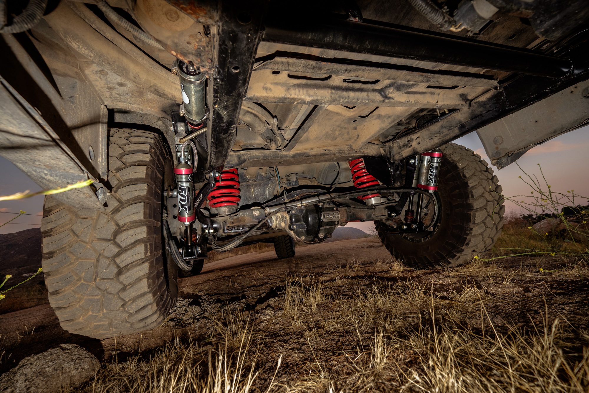

When Bill first started this project, there wasn’t an abundance of high-quality suspension options out there for the Avalanche. Lower end systems existed, but nothing you would want to rely on for long-distance travel. Fortunately, Eibach has since developed a quality kit for Avalanche owners based on testing done with Bill’s suspension setup, so future owners won’t have to go to the extent of custom work he did.

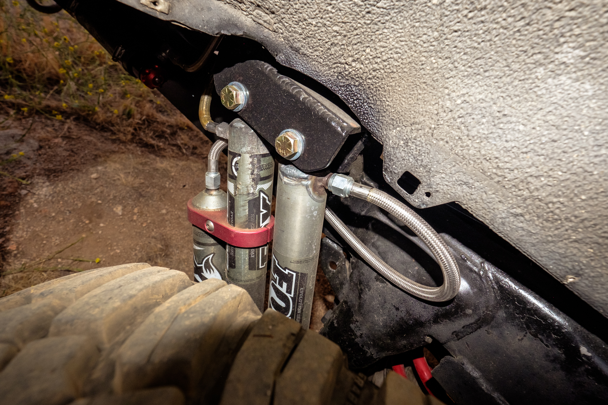

The 3-inch custom lift photographed here uses CST lift keys with highly modified Fox 2.0 shocks in the front and dual 2.0 shocks in the rear for the extra weight capacity. Each has adjustable external reservoirs with twin valving and ⅞-inch shafts for heat dissipation and adequate damping of the loaded truck. The rear end features Eibach coil springs designed for a Hummer, a custom rear track bar, custom trailing arms, and limiting straps to help prevent the system from over-articulating. The front end of the Avalanche is no less impressive, with Cognito motorsports upper control arms, an Eibach anti-sway bar, Super Steer idler arm, Cognito steering braces, Rare Parts 1.5-inch tie rods and pitman arm, and Moog Problem Solver lower control arms. A Red Head commercial 1-ton steering gear helps turn the larger tires, and an Eibach steering stabilizer keeps things controllable at speed.
All of this suspension work not only makes the Avalanche ride like a dream but handles its weight more safely on the road. The cherry on top was that it gave the truck enough clearance for 35-inch General Grabber X3s wrapped around a set of 17-inch Method 701s.

It packs 4.88 G2 gears for turning the larger tires and restoring fuel economy, and new G2 axles and bearings to support the additional mass of the truck. The GM 10 bolt steel trussed rear end is shielded by an ARB differential cover, and as you’d expect with that, sports an ARB air locker inside for tackling more challenging obstacles. In addition to the 4.88 gears, the front end also has some stronger RCV Performance aftermarket axles to match the heavy-duty steering components.

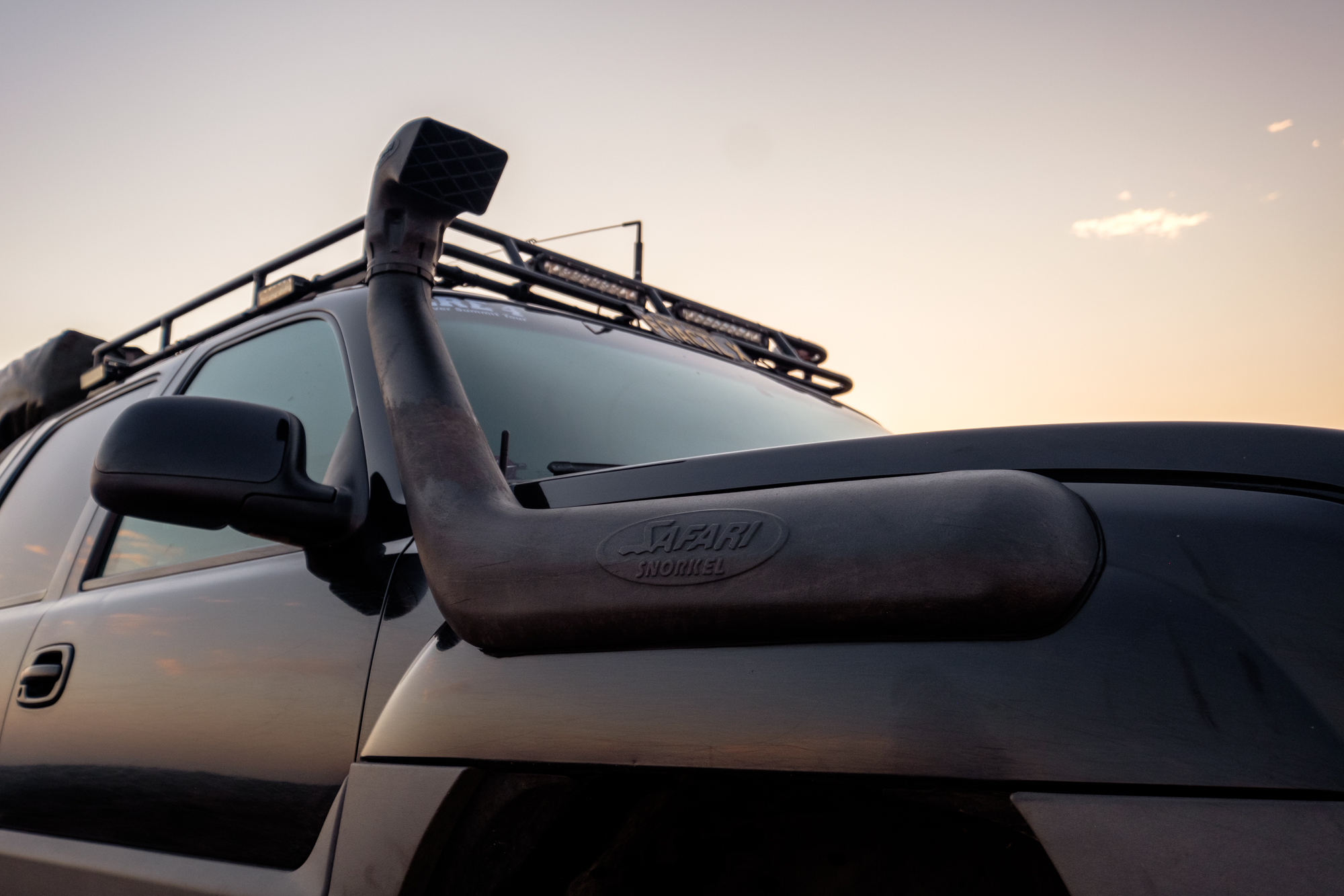

Because I know people are going to be curious, let’s talk about that raised intake. To fit a snorkel to the Avy, Bill searched through model after model of Safari Snorkel until he found one that matched almost exactly to his needs. It turned out to be the snorkel intended for the 100-Series Land Cruiser, and he plumbed it through to the motor with an S&B Cold Air Intake tube and custom sealed airbox. On the opposite end of the combustion equation, he rerouted the exhaust up between the frame rails to ensure it wouldn’t be damaged on the rocks or become flooded in deep water.

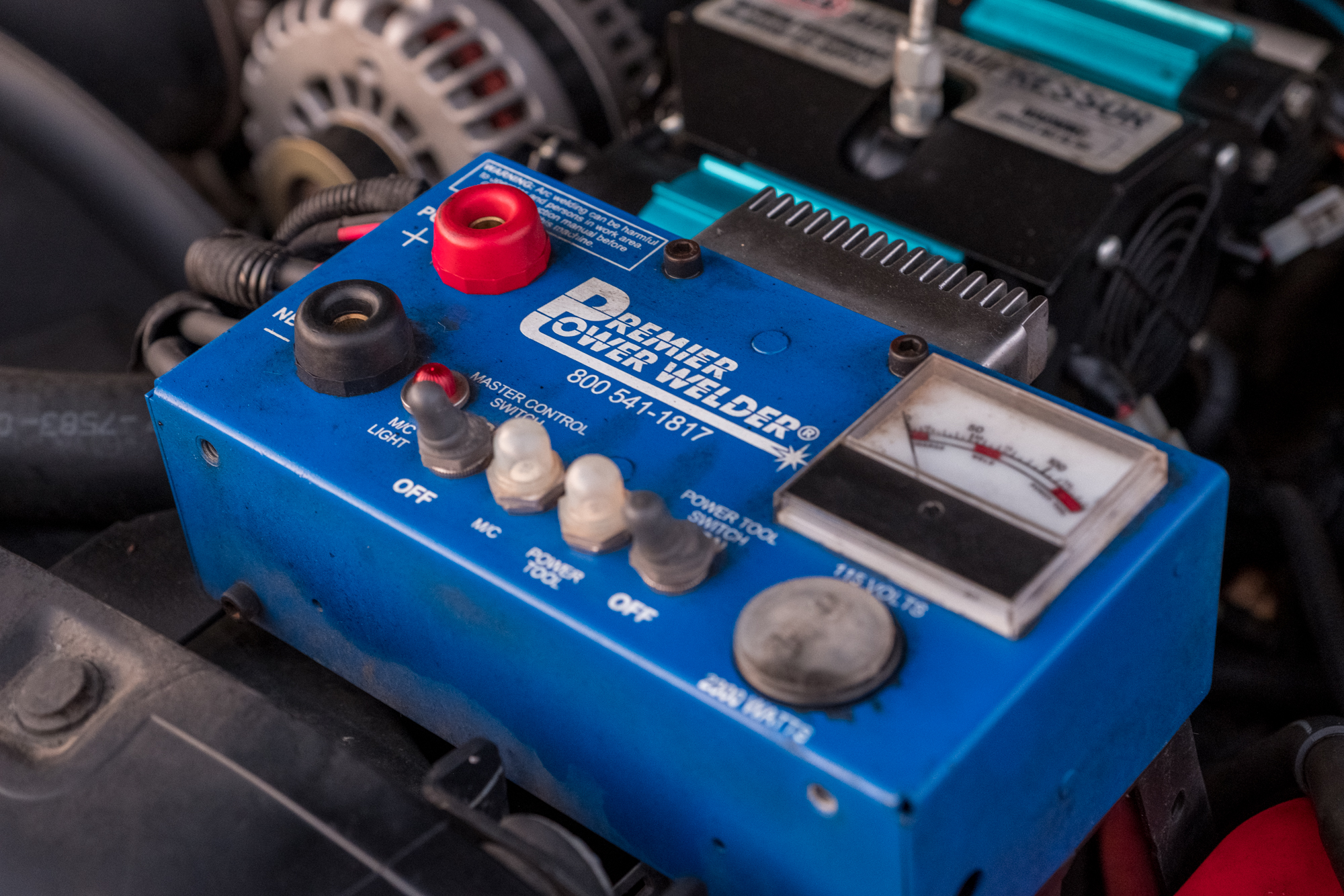

You know things are getting serious when you install a Premier power welder under your hood, but when you break suspension mounts a hundred miles from the nearest help, it can all of a sudden seem quite practical.

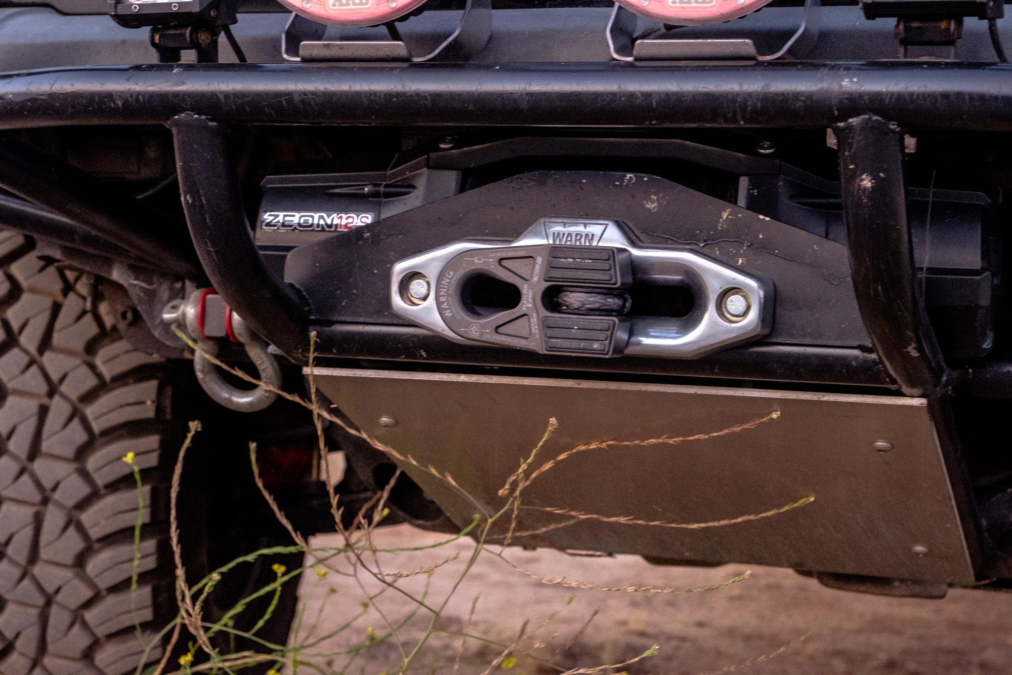

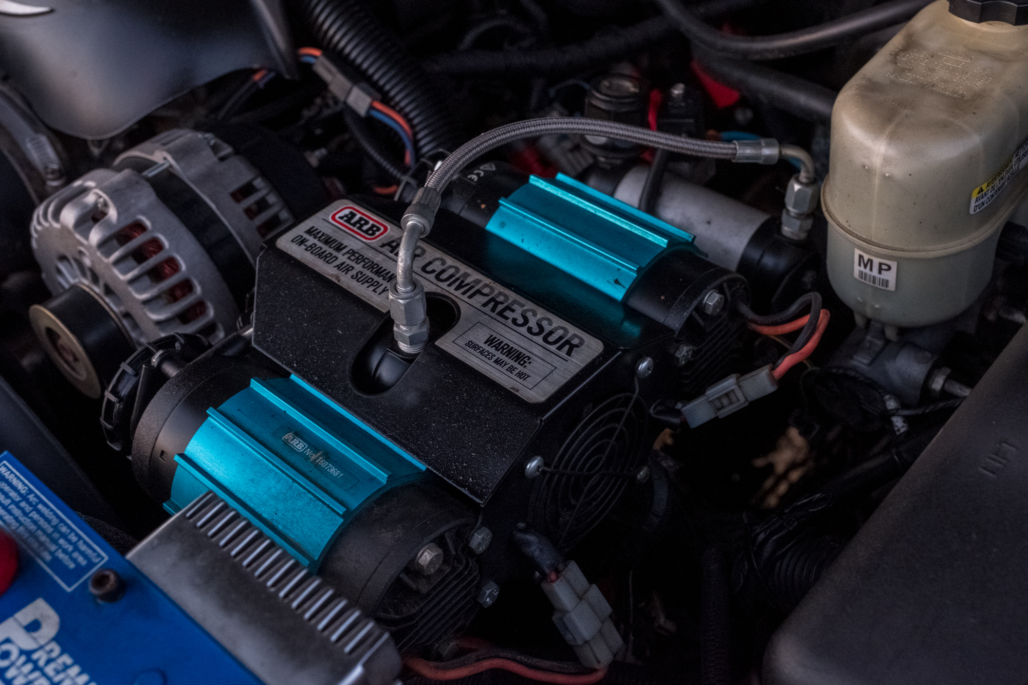

Other forms of recovery are more common than welding failed components, of course. For those situations, the Avalanche houses a Warn Zeon 12-S winch with Spydura synthetic rope and a wireless remote kit. This is paired with a Factor 55 Flat Link Pro and a full suite of ARB recovery gear. Two pairs of Maxtrax recovery boards are kept on board for soft-surface recoveries, and an Extreme Outback tire repair kit and ARB Dual Compressor will keep things rolling in case of a flat. Powering all of those electronic components is a dual battery system with an Optima Red Top and Odyssey 34/78 auxiliary battery. Both are charged by a 225A Powermaster alternator.

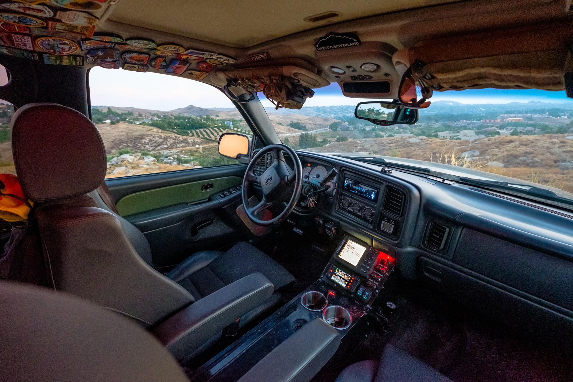

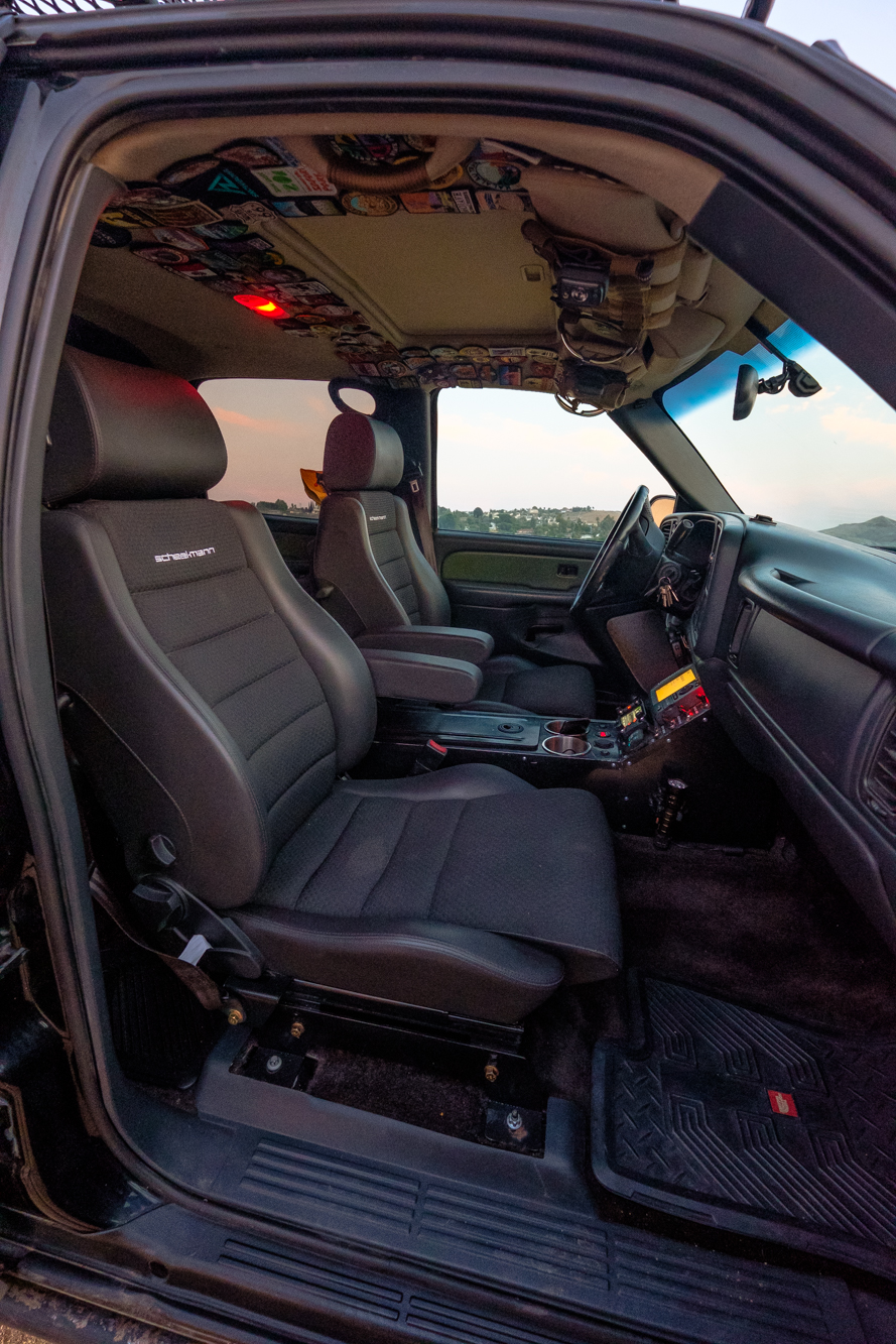

So now we finally get to all the overland goodies. After all, if you’re going to be building a truck for travel, you want it to be comfortable, right? For Bill, that started with back and body support in a set of Scheel-Mann Vario F Seats with top and bottom heaters. He paired these to Corbeau seat belts, and a custom fabbed center control console by BB Fabworx to clear the armrest of the Scheel-Manns. In that console, he integrated everything for communications and navigation, including a Yaesu FTM400-XDR, Garmin InReach, a Lowrance GPS and mount for his iPhone.

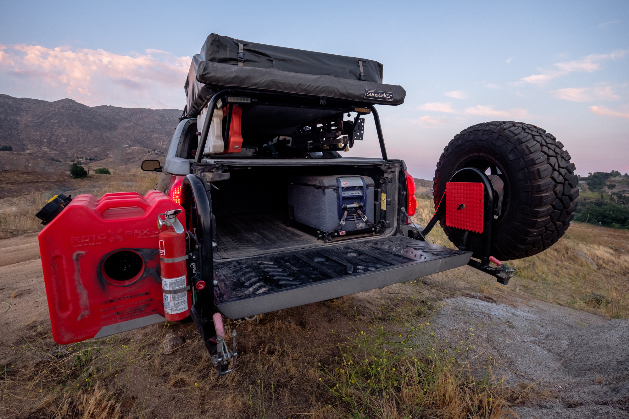

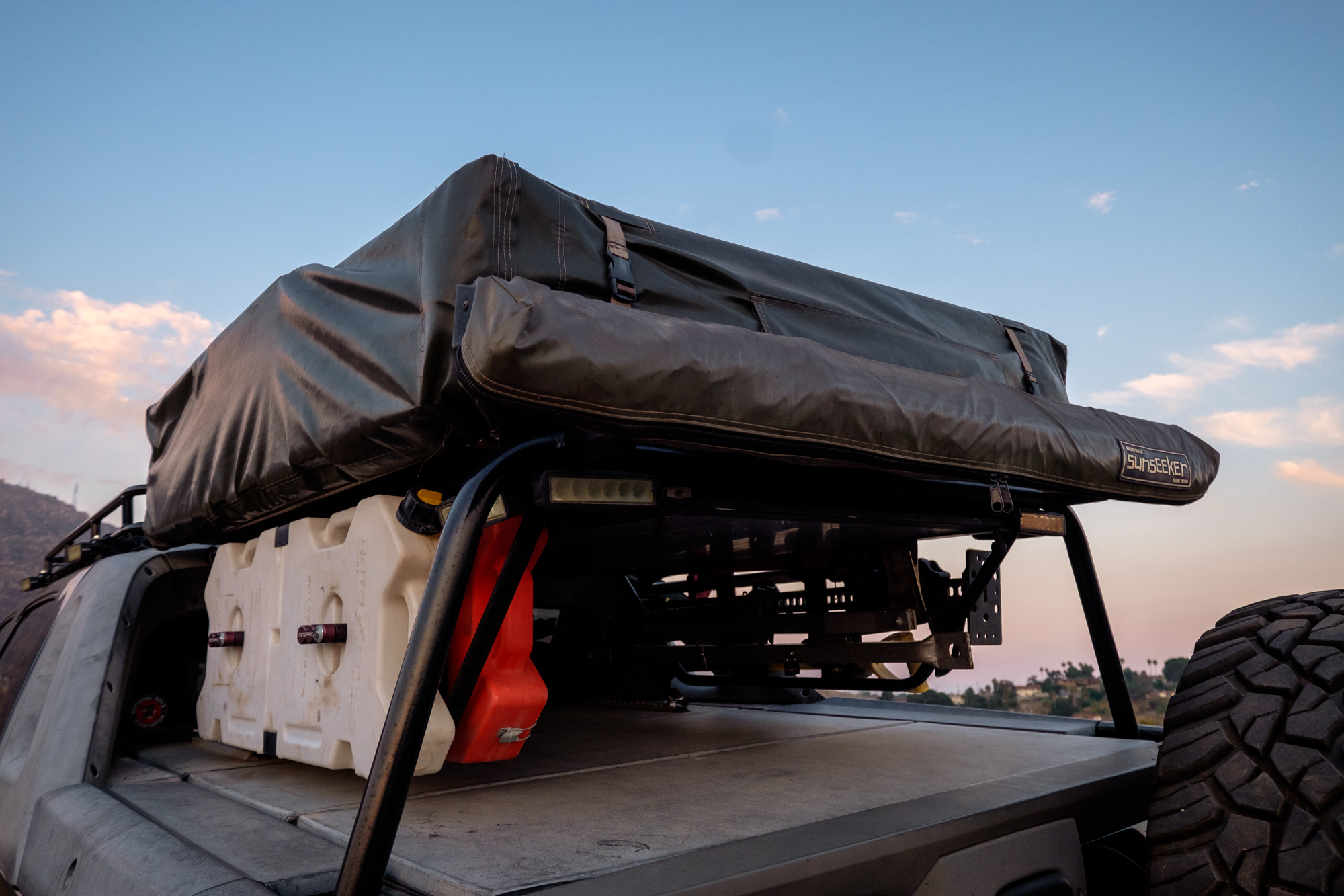

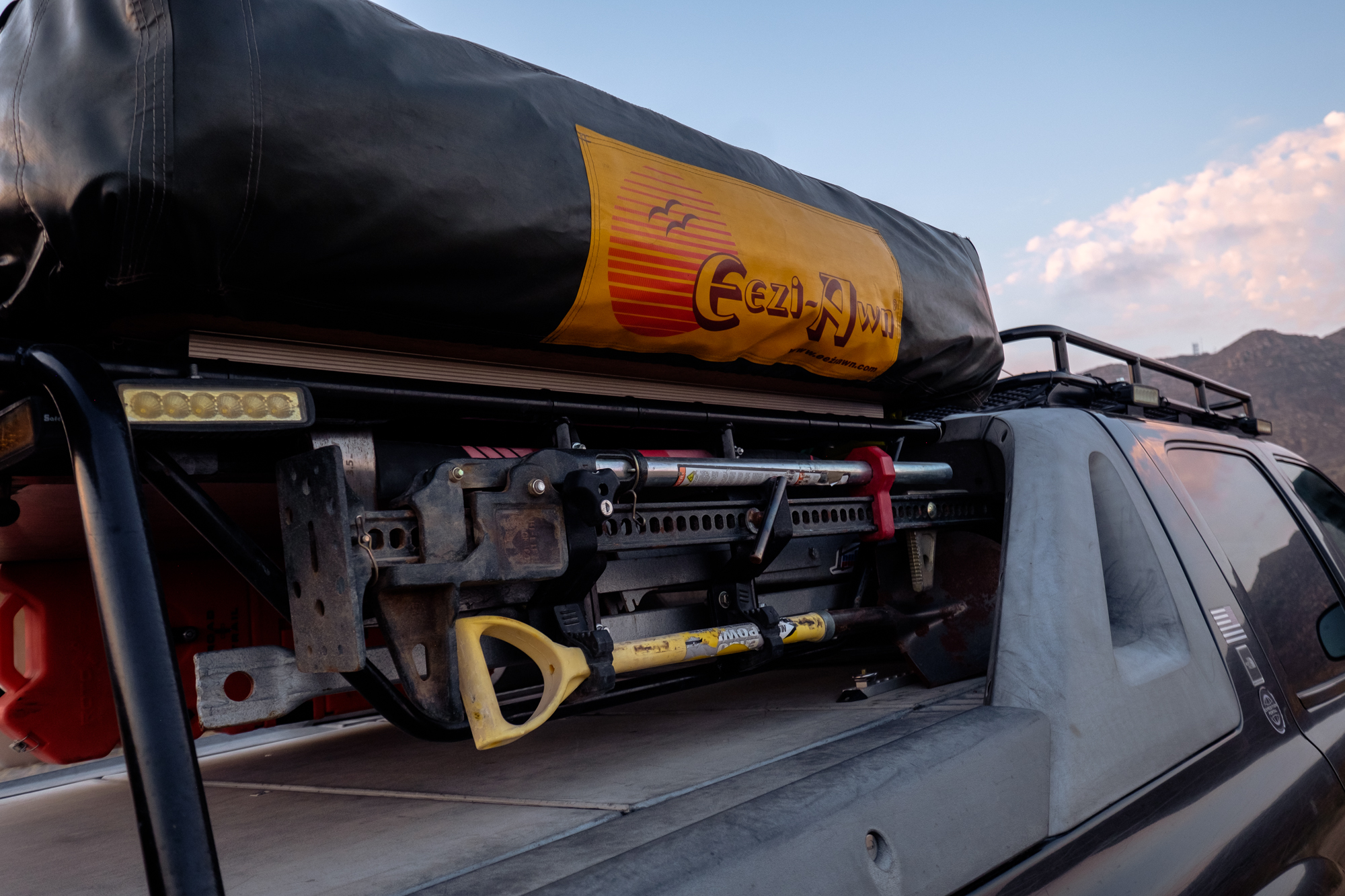

The bed of the Avalanche is even more impressive, though. It carries a custom welded overhead rack with an Eezi-Awn Xklusiv 1400 rooftop tent that has survived storms that ripped neighboring tents to shreds. Bolted to the back is a Rhino-Rack Sunseeker Dome awning that provides the perfect amount of shade over the tailgate on hot days, and a Front Runner Outfitters camp table tucks neatly under the rack. A Hi-Lift Extreme, 11,000-pound PullPal, and Rotopax are mounted down the exterior rails, and it’s worth noting that between the hard-mounted fuel tank and Rotopax this truck carries a total capacity of 46 gallons. Not bad at all.
The overhead bed system then ties into the roof rack, which was custom-built based on the feedback from Overland Journal’s roof rack test, combining the best aspects of the ARB and Gobi racks. This rack has a cutout for the sunroof, as well as Microtune LED lights for dune and off-road driving, and ambient campsite lighting on all sides and rear.
Inside the bed, an ARB 63L fridge/freezer is mounted on a slide for easy access next to a LifeSaver jerry can 20000UF water filtration system. This filtration system can be used to fill the available 9 gallons of onboard water. The bed also houses eight Front Runner Outfitters Wolf packs filled with tools, clothing, personal belongings, a Coleman dual-fuel stove, kitchen kit, etc. Larger spares and welding equipment are carried in a Zarges case.
