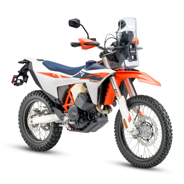

KTM has introduced the 2027 KTM 690 Rally, a single-cylinder adventure motorcycle developed for long-distance travel and technical off-road riding. Drawing visual and functional inspiration from the company’s rally-raid competition machines, the 690 Rally combines substantial fuel capacity, adjustable suspension, off-road electronics, and narrow bodywork intended to improve rider control. However, questions remain about how well this rally-inspired platform will accommodate the practical demands of extended adventure travel.

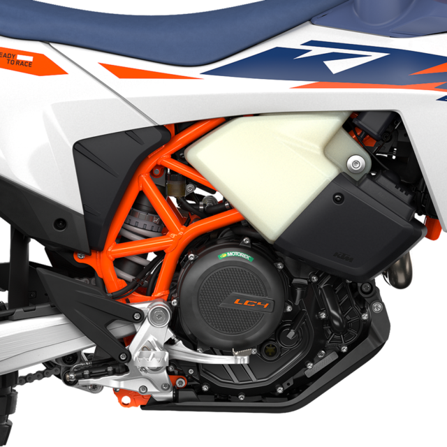

At its center is the latest generation of KTM’s liquid-cooled LC4 single-cylinder engine. The 692.7cc four-stroke produces a claimed 79 PS, approximately 78 horsepower, and 73 newton-meters of torque. Power is delivered through a 6-speed transmission, while a Braktec hydraulic clutch is fitted as standard. KTM also offers Quickshifter+ as an option, allowing clutchless upshifts and downshifts.
The engine has been configured to support demanding off-road use while remaining suitable for longer journeys. KTM specifies an oil-change interval of 15,000 kilometers, or about 9,300 miles, which should reduce servicing needs on extended trips. The company has not published a claimed riding range, but the motorcycle carries 5.28 gallons, or 20 liters, of fuel.

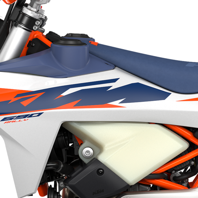

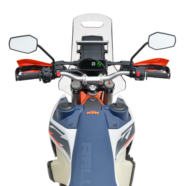

Rather than relying on a single enlarged tank, the 690 Rally supplements its rear tank with two front-mounted tanks. These contribute 1.84 gallons, or 7 liters, to the motorcycle’s total capacity. A dedicated fuel-management system lets the rider switch between the front and rear tanks with a handlebar-mounted control. The low-fuel warning light monitors whichever tank is selected, giving the rider greater control over fuel distribution and reserves.

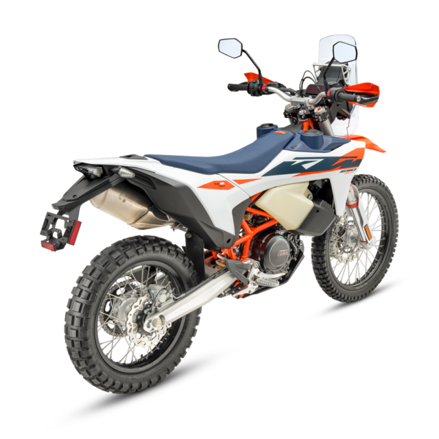

However, the fuel arrangement may pose challenges when the motorcycle is set up for long-distance travel. The rear filler cap sits on the tail section, where a tail bag or rackless luggage system could block access. Riders may therefore need to loosen or remove their luggage whenever they refuel the rear tank.
The structural plastic rear fuel tank also serves as the motorcycle’s subframe. This helps reduce weight, but travelers carrying substantial luggage over rough terrain may want to consider how the tank, mounting points, and associated hardware will cope with repeated loads. Reinforced luggage supports or pannier racks may prove necessary, although these would add weight and increase the motorcycle’s overall width.
Fuel distribution will also require some attention. Heavy luggage placed toward the rear, combined with fuel being consumed from either the front or rear tanks, could noticeably alter the motorcycle’s balance. Riders may need to manage tank selection carefully to maintain predictable handling, particularly on loose or technical terrain.
The high-mounted exhaust presents another consideration for soft luggage. Rackless systems will require suitable spacing or heat shielding to prevent contact with the exhaust. Hard panniers could address that issue, but they would also compromise the narrow profile that gives a rally-style motorcycle much of its agility.

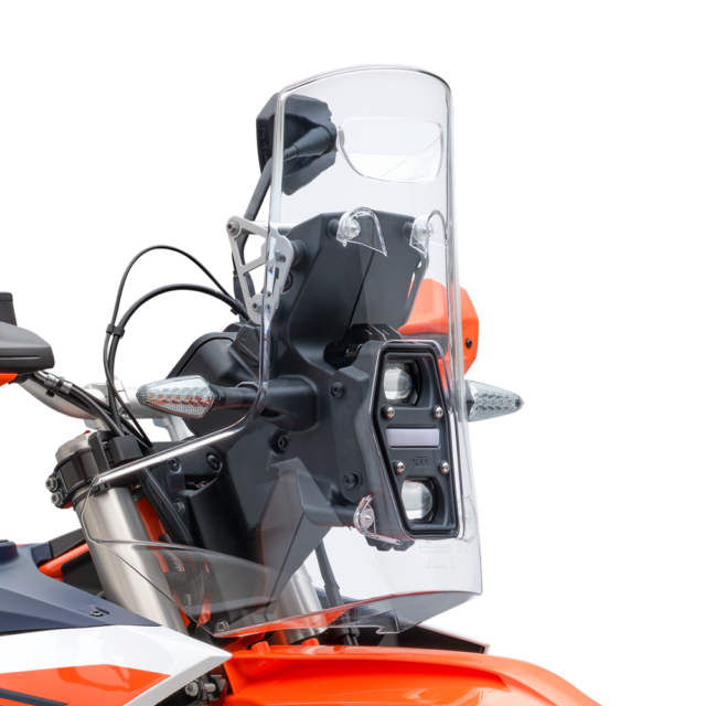

A purpose-built rally tower and windshield provide wind protection during faster road sections and long days in the saddle. The tower incorporates LED lighting derived from the KTM 450 Rally Replica, while a 4.2-inch TFT display presents vehicle information, riding settings, and navigation. Slim bodywork leaves room for movement as the rider transitions between seated and standing positions. Depending on the rider’s height and intended use, the windshield and navigation arrangement may still require modification for extended touring.
