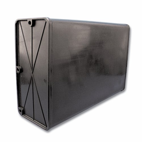

i found a tank i belive would be a good fit for this location:
the tank i think will work the best is this valterra ABS food grade tank. it measures 8" x 16" x 24" (or 36") and the capacity is 12 gallons and 15 gallons respectively.
and since these are ABS plastic i can "weld" on the connections anywhere on the tank to fit my needs and add my fill point whereever. the biggest benefit to this tank besides that of course is it is only 8" tall so that will fit easily under my spare tire carrier directly under the charcoal canister. and i will weld up two crossbars to mount the tank to and to protect from underneath.
oh here is the "weld" kit for the tank

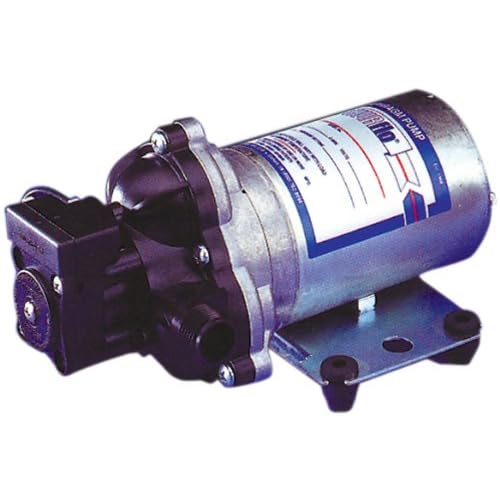

so the next part would be is the pump. i think i found a pump
SHURflo 2088-422-444 2.8 Classic Series Potable Water Pump
12 VDC, 2.8 GPM, 45 PSI
Can support up to 3 fixtures
4 Amps Open Flow
Can run dry wtihout damage
2 Year Limited Warranty

Also I used the Shurflo 3.0 and it's still going strong after 9 months of riding on the shock tower. The problem I had was using waterline that hasn't held up so well but I'm fixing all that and going to 3/8 fuel line hose.

i was able to get up and under the rear of the 4runner this weekend to plan out my course of action. i was thinking about going with a tank from west marine but they end up being very fat and it will drop down to low and i worry about it catching a rock.
for underneath the cargo area i will need to relocated the charcoal canister to make more room. i was thinking about flipping it over and turning it 180 degrees and bringing it forward a foot so it will be tucked up on the body directly overhead of the axle. with that positioning the hoses will still line up with a few modifications to the hoses and mount.
with that relocated, i can free up a large are next to the air tank for my fresh water tank. i plan to do the 15 gallon tank, it will be a snug squeeze but I'm sure it will work and with it being 8 inches tall that will be enough room for 2 cross members to go underneath to support the tank and still be out of view. i will have to cut off those tabs on the frame associated with the spare tire setup to clear more room. ill probably order the tank tonight and start on clearing up those tabs next weekend.

i receieved my 15 gallon water tank today so i test fitted it in the cargo area. fits perfect just as i measured. the pictures shows how low its hanging but this is just a mock up. i plan to relocate the charcoal canister then i will be able to move the tank up 7 inches so it will be completely tucked up under the bumper and frame rails. the plan to support the tank will be to weld in two crossmembers between the frame rails and to support the pump. i will probably have a hinge on one cross member to swing down in case i need to remove the tank and for easy install and to easily access fittings and the pump. to secure the tank to the crossmembers i will have a bolted strap that wraps around the tank to each crossmember.

It just looks like a tight fit in the pics, it's such a hard angle to show well. But yeah there is quite a bit of room on all sides, I'll also have a good "buffer" above the tank too. I'm thinking of doing some type of "padded" straps that will secure around The tank. Once I relocate The charcoal canister I will be able to better access in what position I will finally put the water tank.
The tanks is extremely stout too, I was skeptical looking at it online. But now having it in hand I'm impressed, it also has baffles internally for strength

I was always wondering about those tanks for additional fuel, so I am glad you are happy with the construction and well as the baffels. Do you think they would work for fuel storage?
