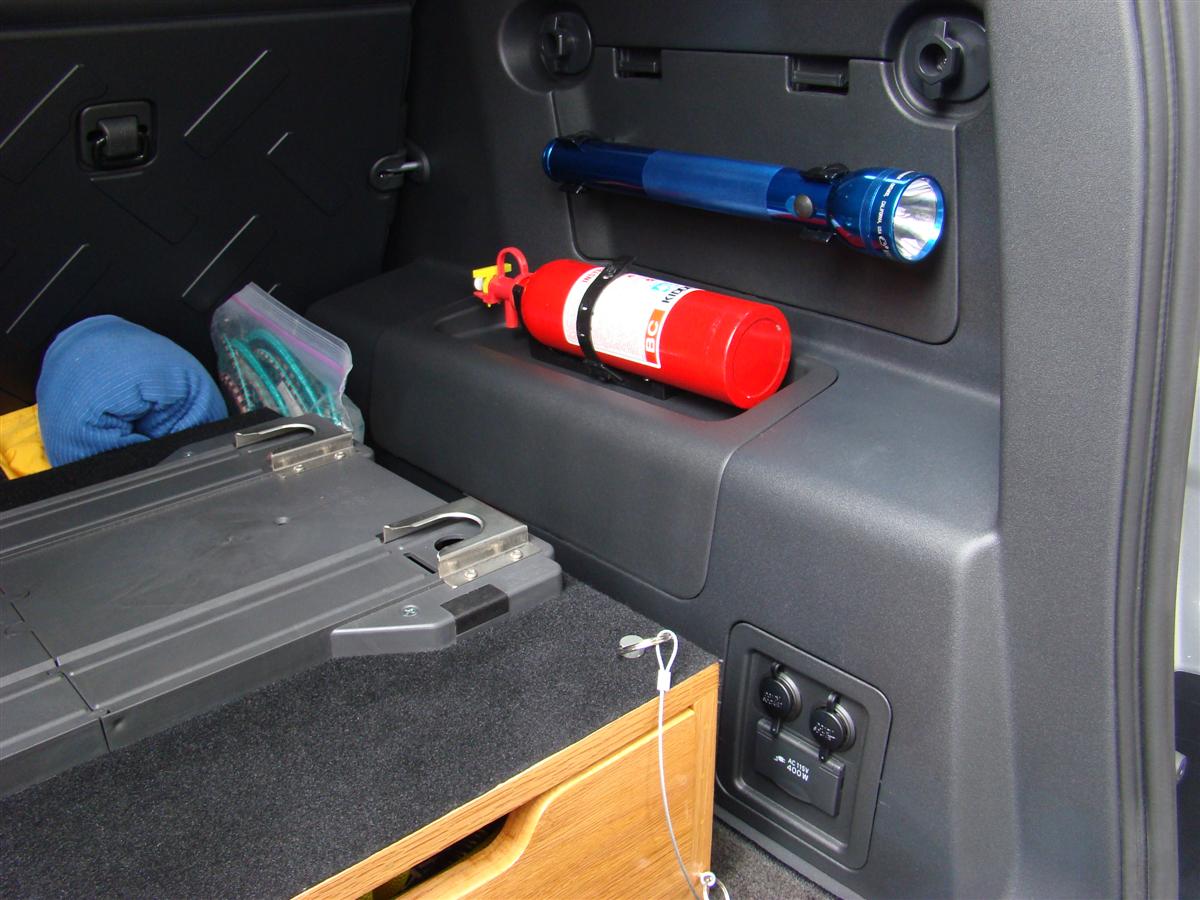

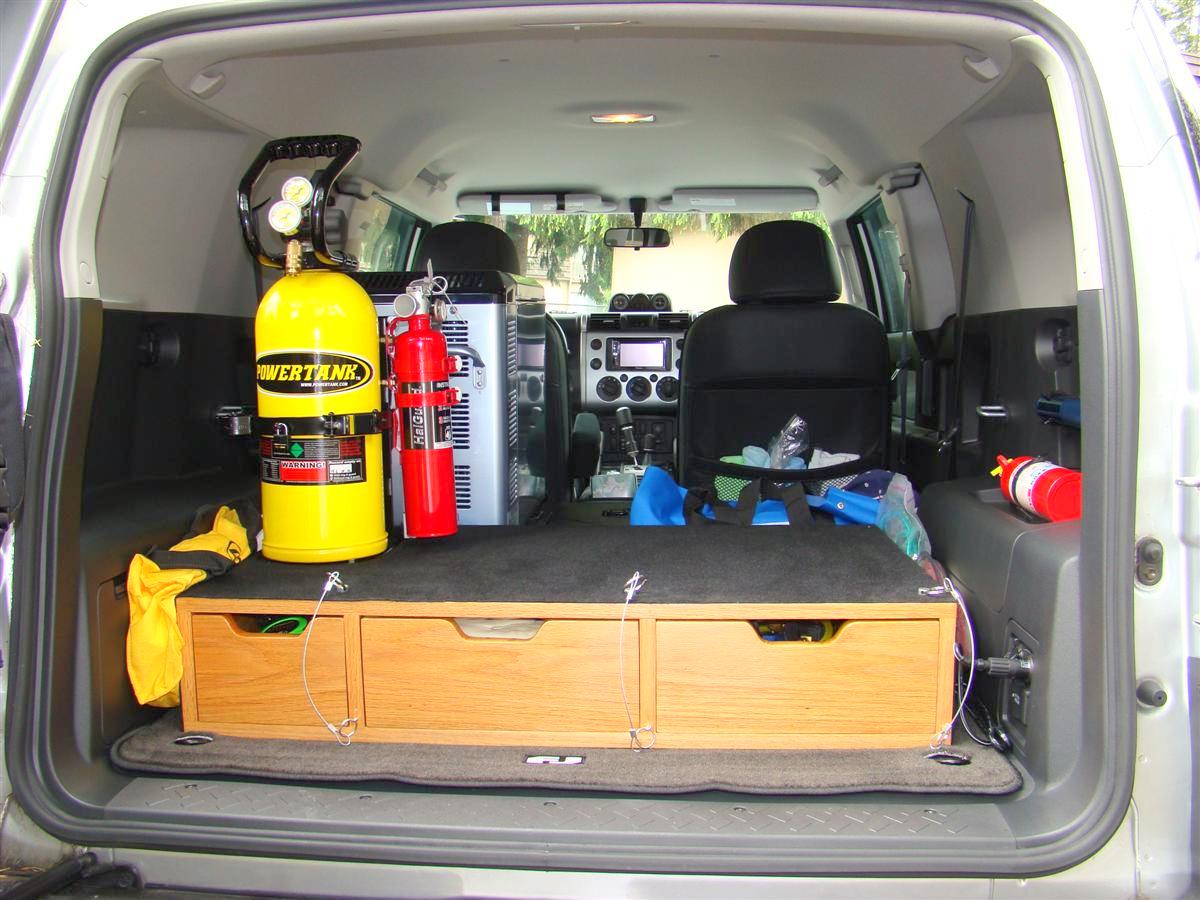

I run two bottles.
One is a cheap Kidee one for using outside of the rig such as a brush fire or something burning in camp.
The second one parked next to my Powertank is a HalGuard HG250R Red Clean Agent Fire Extinguisher
http://www.h3rperformance.com/products.htm
http://www.h3rperformance.com/hg250r.htm
It is to be used inside of the rig as it will not harm electronics or wiring.
HalGuard™ Premium Clean Agent and MaxOut™ Proven Dry Chemical Fire Extinguishers
Most automobile fires begin in the engine. Short circuits, leaking fluids and faulty fuel delivery systems are common causes. Fires can also start in exhaust system manifolds, catalytic converters and even brakes.
Regular automobile maintenance is the best defense, but even a properly maintained vehicle is vulnerable in an accident. When a fire does strike, swift action is key. A quick blast of HalGuard™ or MaxOut™ fire extinguisher can mean the difference between a minor annoyance and a major catastrophe - on the highway or at the racetrack.
H3R Performance offers a wide range of Halotron charged, portable HalGuard™ extinguishers. In addition to automotive use, HalGuard's clean properties make it ideal for protecting computers and other sensitive electronic equipment.
H3R Performance offers four MaxOut™ dry chemical extinguishers. Besides automotive use, they are effective fire protection for boating (models MX250R and MX250C), the home, garage, or office.

I have a standard red kidde mounted on the center hump behind the front seats, easily accesible, usuallu my medical jump bag is laying right on top of it so they are both at the ready

2 small halons, door mounted:
keep meaning to get a slightly larger chemical one to put in the back too.

Same exact one I carry by my Powertank, but in two different colors.
I ordered mine through Jegg's.
