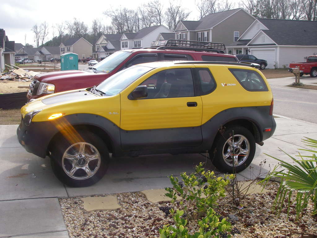

I flew to Columbus, Oh from Charleston, SC to buy my VX in December of 08. She was bone stock,114K miles, obviously garaged. She had typical midwest cancer, rusted out exhaust, corroded rims...
Within 3 months of having her, I added OME 919s, 32" ATs, cranked torsion bar, Rancho 9000s shocks, all 120K maintenance done, digital rear view mirror, stereo, HID lights, flowmaster exhaust, NGK plugs, Injen intake, torque cool fan clutch, functional hood scoop, rocky road sliders and custom skid plates.
I made the voyage to Moab that spring.
It was awesome. I finally got see the iconic Ldub machine that I had seen pictures of a thousand times.
Since then, I have done a lot more. I was bit by the bug, badly.
I have since added a front locker, 34" Kevlar tires, gutted the rear,mounted CO2 bottle, upgraded stereo, undercarriage rock lights, two bumpers, Superwinch manual hubs, a new tranny, optima red top with custom mounting brackets, frame restoration (in progress), rear door spare tire mount.

I finally got around to finishing preservation, ended up doing kevlar LineX on the entire truck! Took it apart and took it to them in pieces, best upgrade ever, no more washing, waxing or worrying about rock chips and pin stripes.
[/IMG]
[/IMG]
[/IMG]
