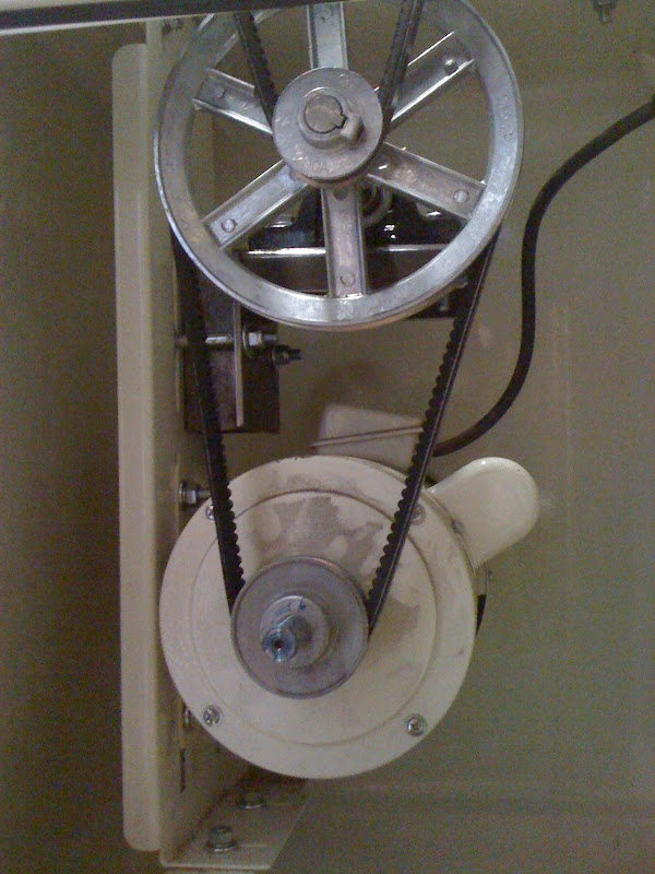

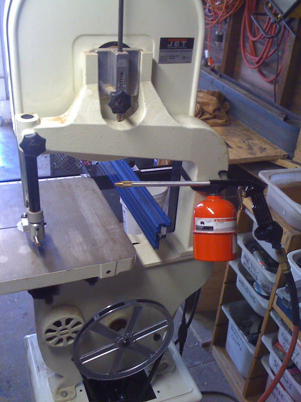

Okay, it took a couple trips to the auto parts store to get the right belt size but it works! Seems like a very good speed, not sure if my calculations are accurate or not, there is a lot of confusing info about blade speed on the web, and a lot of statements seem to have the wrong units.
Anyhoo, here are some pics:
The upper pulley is 10". It needs a safety cover. I had the atomizer laying around, I filled it with the Kool Mist mixture. Seems effective, if a little messy. Added a regulator to the atomizer so it wouldn't be blasting coolant everywhere.
Looking down, the jack shaft is obscured.
Close-up of the jack shaft and bearings, looking down into the motor cabinet.
Inside the motor cabinet. 2.5" pulley on the motor, 7" pulley then 2" pulley on the jack shaft.
