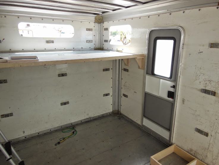

Enter a 1994 E-350 17’ UHaul. 7.3 IDI, N/A, E40D auto trans, 185,000 miles. 60,000 as moving truck, 60,000 as a company truck for Merrill Lynch, and 60,000 as a transporter for custom-built dune buggies. Dune buggy company knew their way around engines, and took pretty good care of this thing…
With the goal of under-the-radar in mind, I kept the street side clear of windows and doors, and have left the roll up door on (thus far). So it just looks like a parked moving truck when driving by. I bought some surplus RV windows and a door and put em on the curb side, and installed some fold-out steps underneath. Put two RV-type roof vents through the aluminum roof skin. Here’s what else I’ve done…

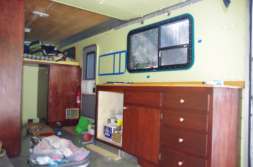

• Custom cabinets: kitchen counter, closets, bed extension from cab-over (sits on closets, extends from cab-over 30” to fit a queen bed), base for a futon, and bathroom
• Installed two-burner cooktop + 10# propane tank
• Installed Engel 12V fridge/freezer
• Installed 40 gallon water tank (mounted under truck) + pump, plumbed to kitchen sink and exterior shower.
• 2x 6-volt Costco golf cart batteries, charged by 100 watt solar and (rarely) PD4045 converter/charger.
• LED strip lighting on dimmers installed on wooden “L” brackets down length of box cast indirect lighting on ceiling.

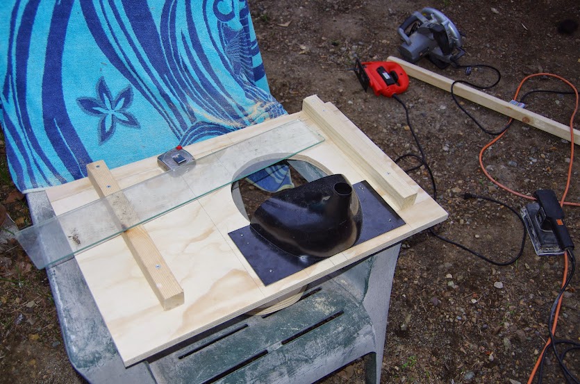

• Built a compost toilet with urine diverter; no blackwater tank required.
• Put rigid foam insulation between roof supports and used ¼” plywood for ceiling – no other part of vehicle insulated (yet)
• Lend-a-hand door handle, occupancy-sensor controlled LED porch light.
