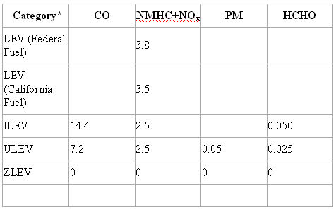

US Diesel Fuel Grades
Historically, the quality of automotive fuels in the USA was governed by ASTM standards. Diesel fuels are covered by the ASTM D 975-04a specification, which describes seven grades of diesel:
Table 1
Diesel Fuel Grades
Heavier fuel oils Grade 5 and 6 (residual), which are used primarily for heating purposes, are described by ASTM D 396.
The Sxxx designation was first adopted in the D 975-04 edition of the standard to distinguish grades by sulfur content. The S5000 grades correspond to the “regular” sulfur grades, the previous No. 1-D and No. 2-D. S500 grades correspond to the previous “Low Sulfur” grades (D 975-03). S15 grades are commonly referred to as “Ultra-Low Sulfur” grades or ULSD.
Further ASTM specifications exist for marine diesel fuels. While some marine diesel engines use No. 2 distillate, additional ASTM specifications identify four kinds of marine distillate fuels: DMX, DMA, DMB, and DMC (see also ISO marine fuel specifications):
• DMX is a special light distillate intended mainly for use in emergency engines.
&#8226; DMA (also called marine gas oil, MGO) is a general purpose marine distillate that must be free from traces of residual fuel. DMX and DMA fuels are primarily used in Category 1 marine engines (< 5 liters per cylinder).
&#8226; DMB (marine diesel oil, MDO) is allowed to have traces of residual fuel, which can be high in sulfur. This contamination with residual fuel usually occurs in the distribution process, when using the same supply means (e.g., pipelines, supply vessels) that are used for residual fuel. DMB is produced when fuels such as DMA are brought on board the vessel in this manner. DMB is typically used for Category 2 (5-30 liters per cylinder) and Category 3 (&#8805; 30 liters per cylinder) engines.
&#8226; DMC is a grade that may contain residual fuel, and is often a residual fuel blend. It is similar to No. 4-D, and can be used in Category 2 and Category 3 marine diesel engines.
&#8226; Residual (non-distillate) fuels are designated by the prefix RM (e.g., RMA, RMB, etc.). These fuels are also identified by their nominal viscosity (e.g., RMA10, RMG35, etc.).
With the growing importance of alternative diesel fuels, specifications are also being developed for biodiesel fuels and their blends.

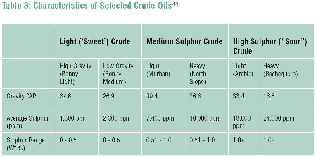

Sulfur Content
Since the 1990's, fuel quality has been increasingly more regulated by the US EPA under the authority of the Clean Air Act. In the context of the increasingly more stringent diesel emission standards, the most important fuel property regulated by the EPA became the sulfur content. Historically, the sulfur content in diesel fuels for highway and nonroad vehicles was limited to 0.5% (wt.) by ASTM specifications. The milestones in US environmental regulations limiting sulfur levels in diesel fuels can be summarized as follows:
Highway Diesel Fuel
&#8226; 500 ppm: Sulfur limit of 500 ppm = 0.05% (wt.) became effective in October 1993. This fuel, commonly referred to as the low sulfur diesel fuel, was introduced to facilitate sulfate particulate emission reductions, which were necessary for meeting the 1994 emission standards for heavy-duty highway engines.
&#8226; 15 ppm: Diesel fuel of maximum sulfur level of 15 ppm will be available for highway use beginning in June 2006. This fuel, referred to as the ultra low sulfur diesel (ULSD), was legislated by the EPA to enable catalyst-based emission control devices, such as diesel particulate filters and NOx adsorbers, which will be necessary for meeting the 2007-2010 emission standards for heavy-duty engines, as well as the Tier 2 light-duty standards.

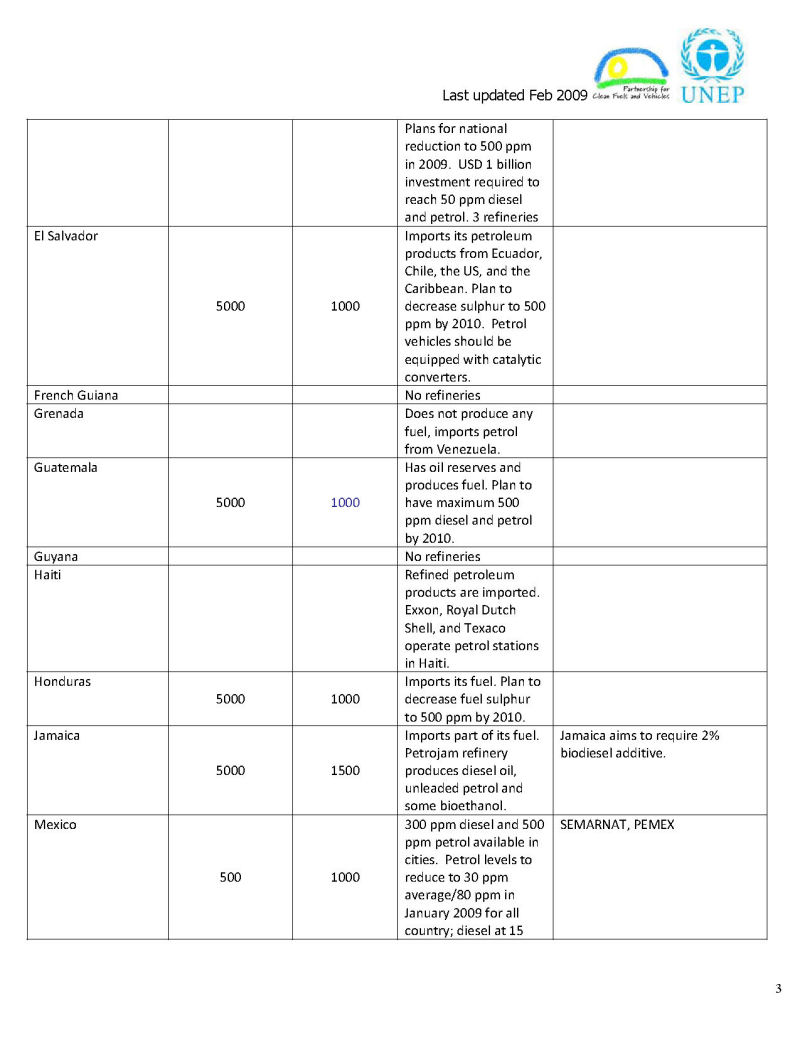

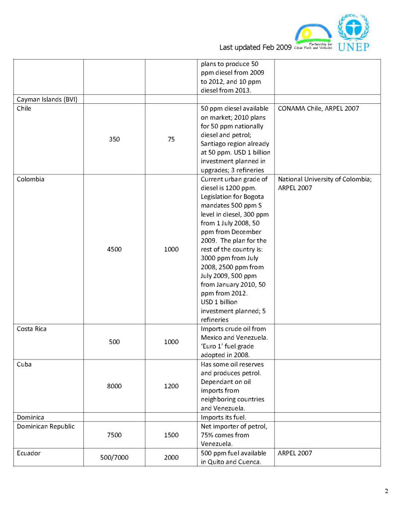

Mexico Diesel
Motor vehicle fuels in Mexico are distributed exclusively by the national oil company Petrleos Mexicanos (PEMEX). Regulation NOM-086-SEMARNAT-SENER-SCFI-2005 defines two grades of diesel fuel:
&#8226; Automotive diesel (PEMEX) for use in on-road vehicles, and
&#8226; Marine and agricultural diesel.
The low sulfur automotive diesel grade (first introduced as Diesel Sin) replaced the earlier standard diesel of 5000 ppm (0.5%) sulfur.
The regulation sets automotive diesel fuel sulfur levels at 500 ppm with a scheduled reduction to 15 ppm. The following is the phase-in schedule for ultra-low sulfur (15 ppm) on-road diesel:
&#8226; February 2007&#8212;Northern frontier region that borders the USA,
&#8226; February 2009&#8212;Metropolitan regions of Guadalajara, Monterrey and the Valle de Mxico,
&#8226; September 2009&#8212;Nationwide.
Diesel fuel for marine and agricultural applications is colored and has an upper sulfur limit of 5000 ppm.
Source: http://www.dieselnet.com/standards/mx/fuel.php

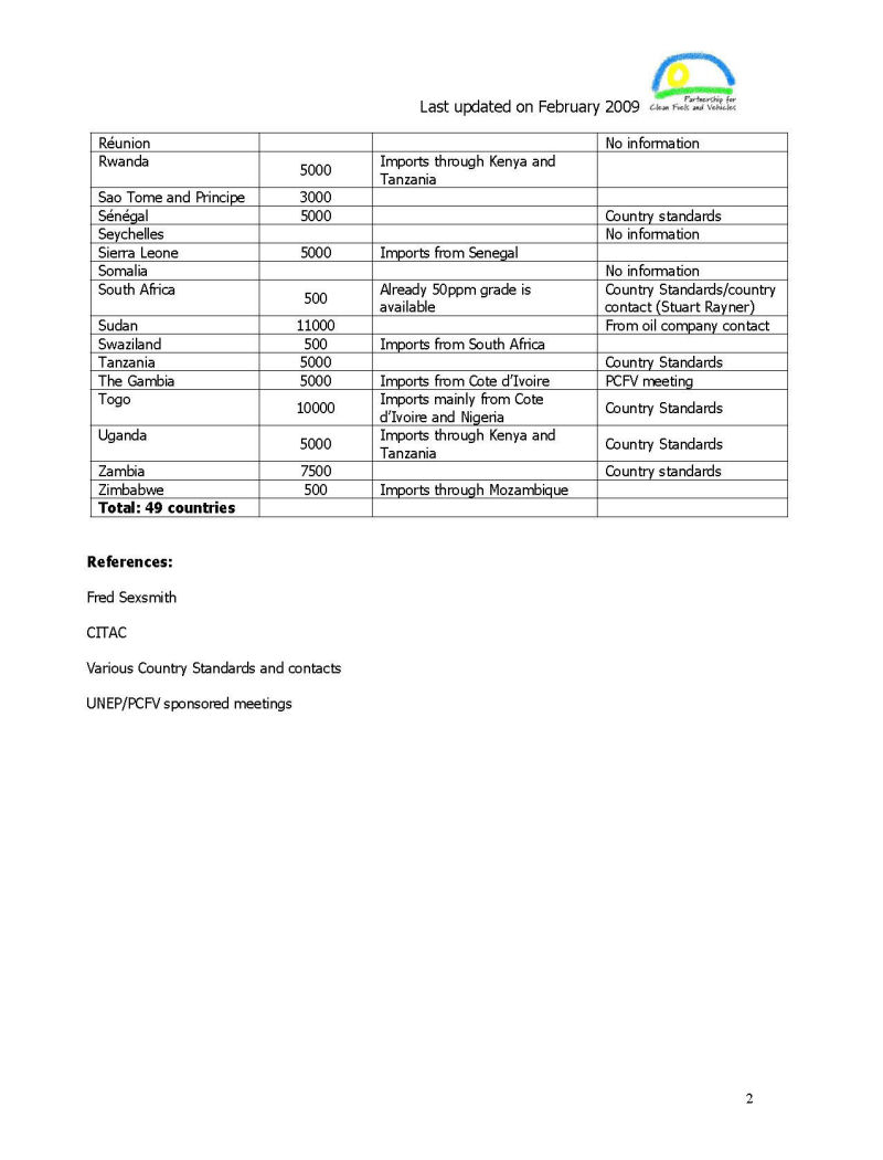

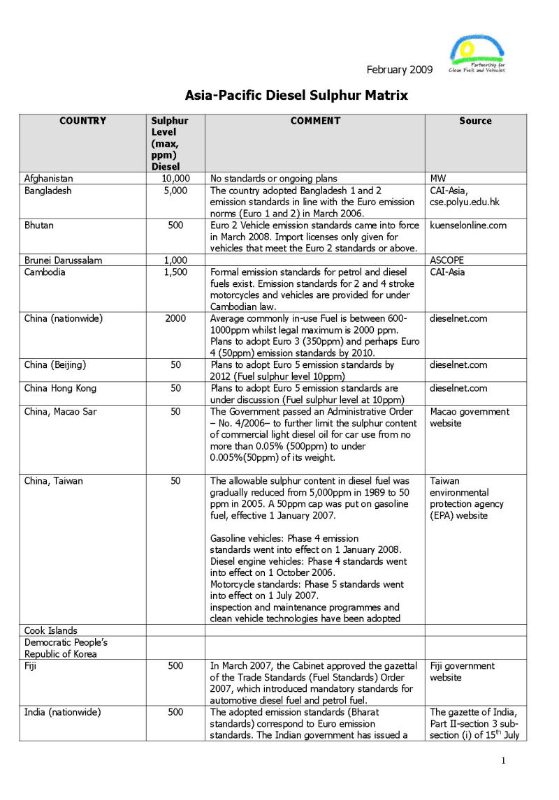

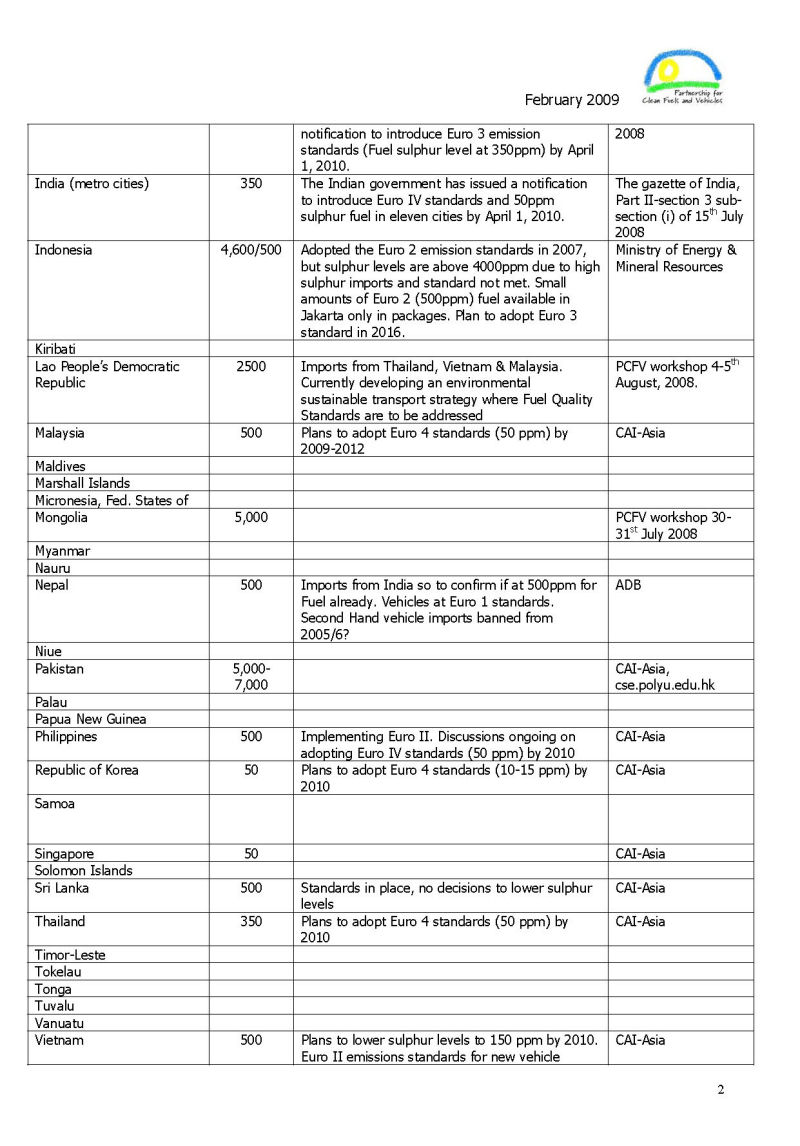

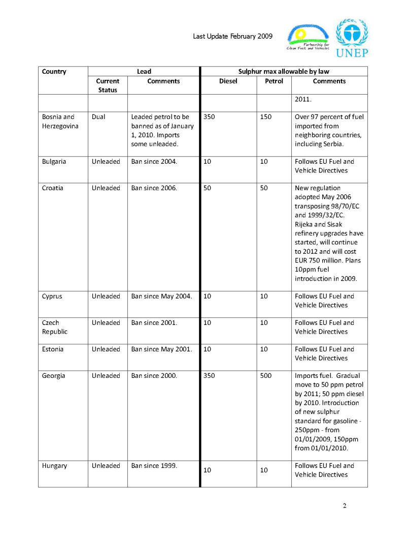

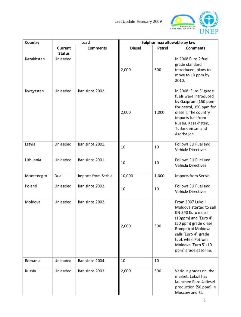

India Diesel Fuel
India has been adopting European regulations for both fuels and vehicle emissions. The Euro requirements are first introduced in Delhi and other major cities, following nationwide implementation. The evolution of diesel fuel quality is summarized in Table 1.
Table 1
Diesel Fuel Quality in India
More details on the implementation schedule of European specifications is given in the article on vehicle emission standards.
Source: http://www.dieselnet.com/standards/in/fuel.php

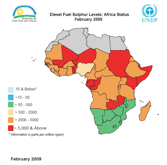

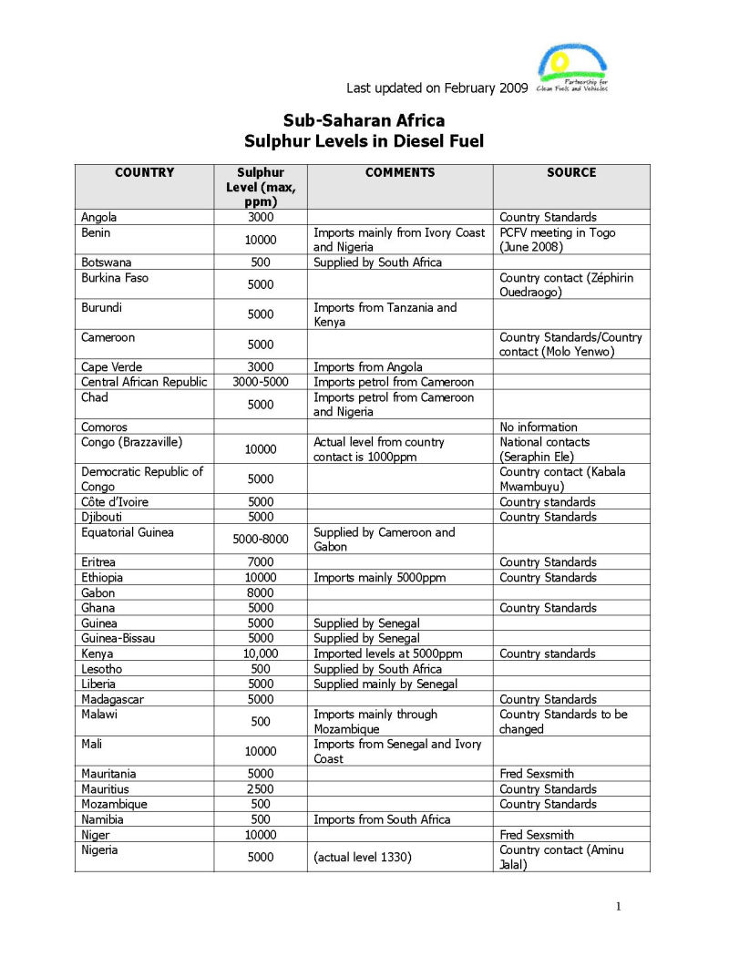

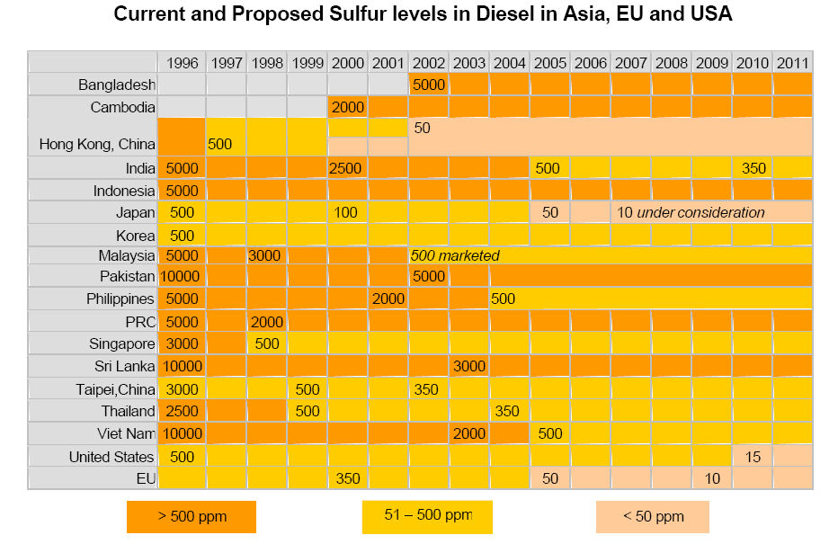

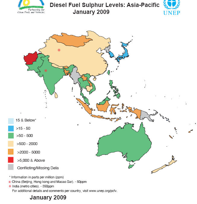

dhackney

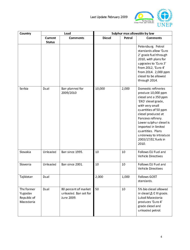

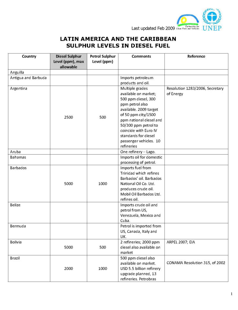

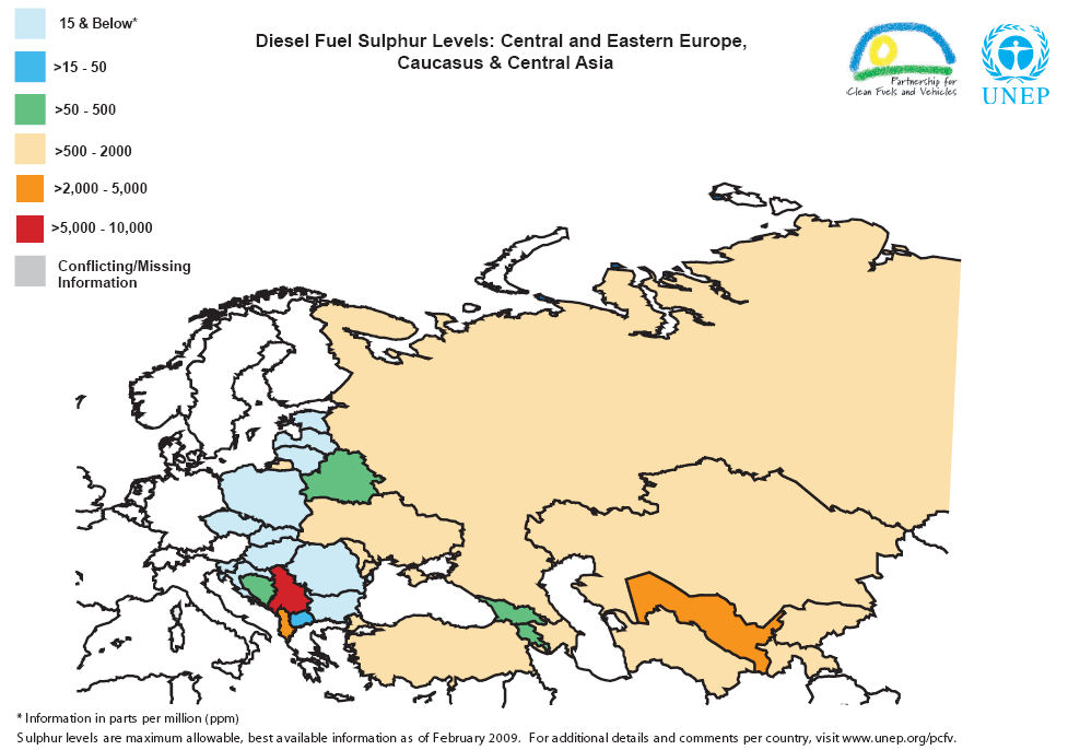

The availability of diesel fuel also varies within countries and by where they are at in their implementation of tighter pollution standards.
dhackney

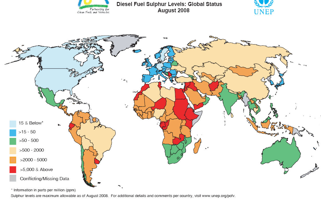

Diesel fuel sulphur levels are driven by pollution standards.
The two major sets of pollution standards are USA/Canada and EU. In general, countries outside the USA/Canada/Mexico are either adopting or patterning their standards after the EU.

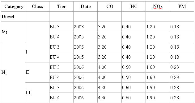

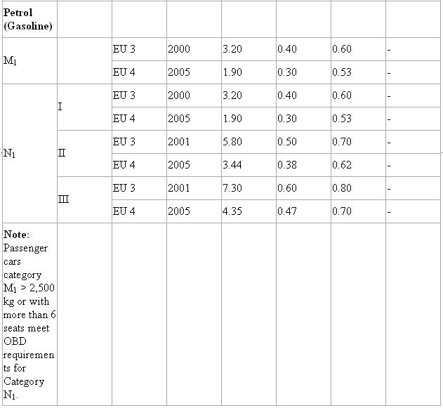

Emission standards for passenger cars and light commercial vehicles (vehicle categories M1 and N1, respectively) are summarized in the following tables. Since the Euro 2 stage, EU regulations introduce different emission limits for diesel and gasoline vehicles. Diesels have more stringent CO standards but are allowed higher NOx. Gasoline vehicles are exempted from PM standards through the Euro 4 stage. Euro 5/6 regulations introduce PM mass emission standards, numerically equal to those for diesels, for gasoline cars with DI engines.
All dates listed in the tables refer to new type approvals. The EC Directives also specify a second date—one year later (unless indicated otherwise)—which applies to first registration (entry into service) of existing, previously type-approved vehicle models.

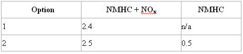

Table 1
EU Emission Standards for Passenger Cars (Category M1*), g/km
* At the Euro 1..4 stages, passenger vehicles > 2,500 kg were type approved as Category N1 vehicles
† Values in brackets are conformity of production (COP) limits
a - until 1999.09.30 (after that date DI engines must meet the IDI limits)
b - 2011.01 for all models
c - and NMHC = 0.068 g/km
d - applicable only to vehicles using DI engines
e - proposed to be changed to 0.003 g/km using the PMP measurement procedure

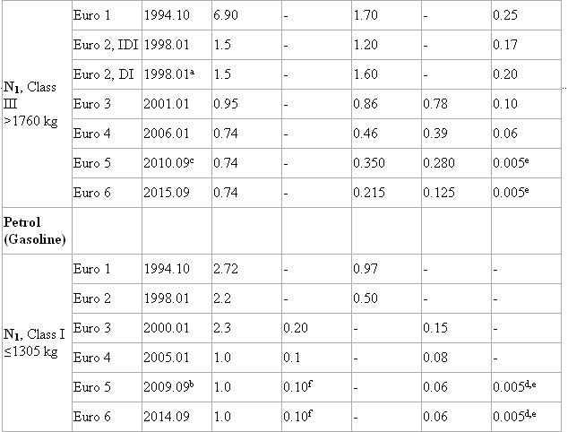

Table 2
EU Emission Standards for Light Commercial Vehicles, g/km
† For Euro 1/2 the Category N1 reference mass classes were Class I ≤ 1250 kg, Class II 1250-1700 kg, Class III > 1700 kg.
c - 2012.01 for all models
f - and NMHC = 0.068 g/km
g - and NMHC = 0.090 g/km
h - and NMHC = 0.108 g/km

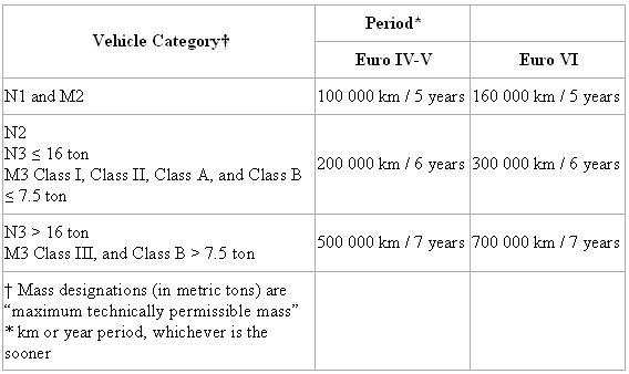

Durability.
Useful vehicle life for the purpose of emission regulations is:
• Euro 3 stage—80,000 km or 5 years (whichever occurs first); in lieu of an actual deterioration run, manufacturers may use the following deterioration factors: 1.2 for CO, HC, NOx (gasoline) or 1.1 for CO, NOx, HC+NOx and 1.2 for PM (diesel).
• Euro 4 stage—100,000 km or 5 years, whichever occurs first.
• Euro 5/6 stage—in-service conformity: 100,000 km or 5 years; durability testing of pollution control devices for type approval: 160,000 km or 5 years (whichever occurs first).

Emission Durability.
Effective October 2005 for new type approvals and October 2006 for all type approvals, manufacturers should demonstrate that engines comply with the emission limit values for useful life periods which depend on the vehicle category, as shown in the following table.
Table 3
Emission Durability Periods
Effective October 2005 for new type approvals and October 2006 for all type approvals, type approvals also require confirmation of the correct operation of the emission control devices during the normal life of the vehicle under normal conditions of use (“conformity of in-service vehicles properly maintained and used”).

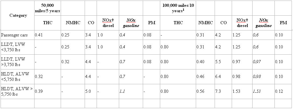

FTP Emission Standards
The Tier 1 emission standards are summarized in Table 1. Car and light truck emissions are measured over the Federal Test Procedure (FTP 75) test and expressed in g/mile.
Table 1
EPA Tier 1 Emission Standards for Passenger Cars and Light-Duty Trucks, FTP 75, g/mi
1 - Useful life 120,000 miles/11 years for all HLDT standards and for THC standards for LDT
† - More relaxed NOx limits for diesels applicable to vehicles through 2003 model year

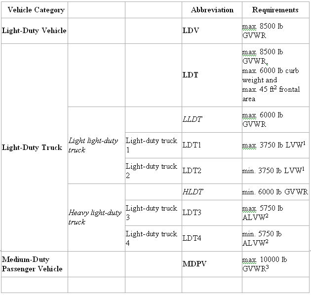

US Light Duty Tier 2
Introduction
The Tier 2 regulation introduced more stringent numerical emission limits relative to the previous Tier 1 requirements, and a number of additional changes that made the standards more stringent for larger vehicles. Under the Tier 2 regulation, the same emission standards apply to all vehicle weight categories, i.e., cars, minivans, light-duty trucks, and SUVs have the same emission limit.
In Tier 2, the applicability of light-duty emission standards has been extended to cover some of the heavier vehicle categories. The Tier 1 standards applied to vehicles up to 8500 lbs GVWR. The Tier 2 standards apply to all vehicles that were covered by Tier 1 and, additionally, to “medium-duty passenger vehicles” (MDPV). The MDPV is a new class of vehicles that are rated between 8,500 and 10,000 lbs GVWR and are used for personal transportation. This category includes primarily larger SUVs and passenger vans. Table 1 outlines and defines the vehicle categories used in the EPA Tier 2 standards. Engines in commercial vehicles above 8500 lbs GVWR, such as cargo vans or light trucks, continue to certify to heavy-duty engine emission standards.
Table 1
Vehicle Categories Used in EPA Tier 2 Standards
1 - LVW (loaded vehicle weight) = curb weight + 300 lb
2 - ALVW (adjusted loaded vehicle weight) = average of GVWR and curb weight
3 - Manufacturers may alternatively certify engines for diesel fueled MDPVs through the heavy-duty diesel engine regulations
The same emission limits apply to all vehicles regardless of the fuel they use. That is, vehicles fueled by gasoline, diesel, or alternative fuels all must meet the same standards. Since light-duty emission standards are expressed in grams of pollutants per mile, vehicles with large engines (such light trucks or SUVs) have to use more advanced emission control technologies than vehicles with smaller engines in order to meet the standards.

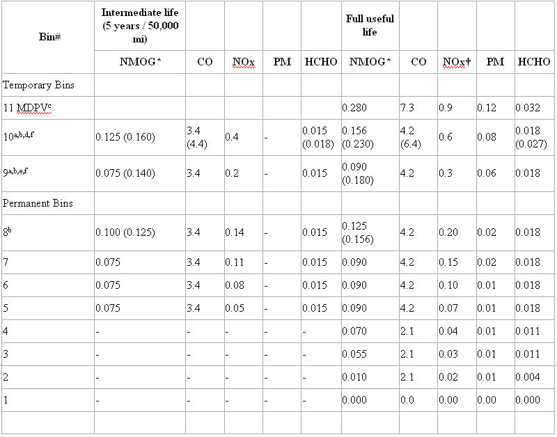

Tier 2 Certification Bins
The Tier 2 emission standards are structured into 8 permanent and 3 temporary certification levels of different stringency, called “certification bins”, and an average fleet standard for NOx emissions. Vehicle manufacturers have a choice to certify particular vehicles to any of the available bins. When fully implemented in 2009, the average NOx emissions of the entire light-duty vehicle fleet sold by each manufacturer has to meet the average NOx standard of 0.07 g/mi. The temporary certification bins (bin 9, 10, and an MDPV bin 11) with more relaxed emission limits are available in the phase-in period and expire after the 2008 model year.
Tier 2 vehicles are those meeting the requirements of one of the available bins and that are used to meet the requirement that a percentage of the fleet have average NOx emissions of 0.07 g/mile. During the phase-in period, the rest of the fleet not used to comply with the 0.07 g/mile NOx average are referred to as interim non-Tier 2 vehicles. They must still meet the requirements of one of the available bins but have more relaxed fleet average requirements.
The emission standards for all pollutants (certification bins) when tested on the Federal Test Procedure (FTP) are shown in Table 2. Where intermediate useful life exhaust emission standards are applicable, such standards are applicable for five years or 50,000 miles, whichever occurs first. The vehicle “full useful life” period for LDVs and light LDTs has been extended to 120,000 miles or ten years whichever occurs first. For heavy LDTs and MDPVs, it is 11 years or 120,000 miles whichever occurs first. Manufacturers may elect to optionally certify to the Tier 2 exhaust emission standards for 150,000 miles to gain NOx credits or to opt out of intermediate life standards. In such cases, useful life is 15 years or 150,000 miles, whichever occurs first. For interim non-Tier 2 LDV/LLDTs, the useful life is 10 years or 100,000 miles, whichever occurs first.
Table 2
Tier 2 Emission Standards, FTP 75, g/mi
* for diesel fueled vehicle, NMOG (non-methane organic gases) means NMHC (non-methane hydrocarbons)
† average manufacturer fleet NOx standard is 0.07 g/mi for Tier 2 vehicles
a - Bin deleted at end of 2006 model year (2008 for HLDTs)
b - The higher temporary NMOG, CO and HCHO values apply only to HLDTs and MDPVs and expire after 2008
c - An additional temporary bin restricted to MDPVs, expires after model year 2008
d - Optional temporary NMOG standard of 0.195 g/mi (50,000) and 0.280 g/mi (full useful life) applies for qualifying LDT4s and MDPVs only
e - Optional temporary NMOG standard of 0.100 g/mi (50,000) and 0.130 g/mi (full useful life) applies for qualifying LDT2s only
f - 50,000 mile standard optional for diesels certified to bins 9 or 10
It may be noted that bin 5 has a NOx limit of 0.07 g/mi, which is equal to the fleet average NOx standard. Therefore, NOx emissions from vehicles certified to bins higher than bin 5 must be offset by selling a sufficient number of vehicles certified to bins lower than bin 5.
The EPA bins cover California LEV II emission categories, to make certification to the federal and California standards easier for vehicle manufacturers.

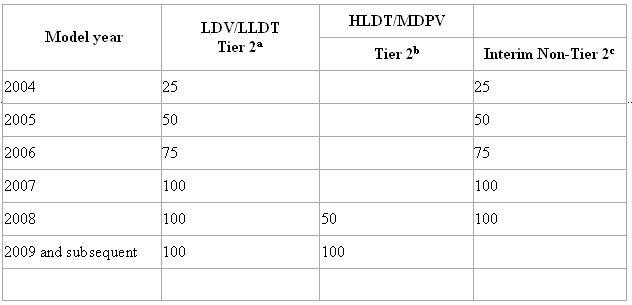

Tier 2 Emission Standards Phase-In
The Tier 2 standards are phased-in between 2004 and 2009, as shown in Table 3. For new passenger cars (LDVs) and LLDTs, Tier 2 standards phase-in begins in 2004, with full implementation in the 2007 model year. For HLDTs and MDPVs, the Tier 2 standards are phased in beginning in 2008, with full compliance in 2009.
Up through and including model year 2008, manufacturers must calculate separate fleet average NOx emissions for the portion of their fleet of LDV/LLDT and HLDT/MDPV Tier 2 vehicles being phased-in. Both must comply with the 0.07 g/mile standard (equivalent to bin 5) for the required phase-in percentage for that year.
During the phase-in period, vehicles not used to meet the Tier 2 FTP phase-in requirements must still comply with the full useful life and intermediate useful life FTP exhaust emission standards for one of the available bins listed in Table 2 (i.e., at least bin 10 for LDV/LDTs and bin 11 for MDPVs).
During the period 2004-2007, all passenger cars (LDVs) and LLDTs not certified to the primary Tier 2 standards (i.e., the 0.07 g/mile fleet average NOx) must meet an interim average standard of 0.30 g/mi NOx, equivalent to bin 9 and the NLEV standards for LDVs.
During the period 2004-2008, HLDTs and MDPVs not certified to the final Tier 2 must meet an interim average standard of 0.20 g/mi NOx (equivalent to bin 8) following the schedule in Table 2. Those vehicles not covered by the phase-in requirements are still subject to the emission standards listed in Table 1 (i.e., bin 10, 0.6 g/mi NOx, for HLDTs and bin 11, 0.9 g/mi NOx, for MDPVs).
Through model year 2007, a manufacturer may opt to certify diesel engines for MDPVs through the heavy-duty diesel engine requirements instead of the entire vehicle through the light-duty regulations. These vehicles cannot be used for compliance with phase-in requirements for interim non-Tier 2 MDPVs.
Table 3
Phase-In Percentages for Tier 2 Requirements
a - Percentage of LDV/LLDTs that must meet Tier 2 requirements
b - Percentage of HLDT/MDPVs that must meet Tier 2 requirements
c - Percentage of non-Tier 2 HLDT/MDPVs that must meet interim non-Tier 2 fleet average NOx requirements

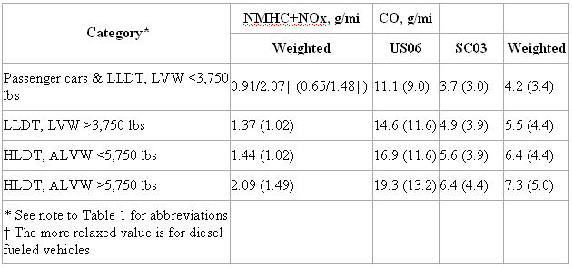

Supplemental Exhaust Emission Standards
In addition to meeting the FTP cycle requirements of Table 2, certification of a vehicles requires that it also meet supplemental exhaust emission standards (US06 and SC03 driving cycles). These must be met by LDV and LDTs but not MDPVs, alternative fueled LDV/LDTs, or flexible fueled LDV/LDTs when operated on a fuel other than gasoline or diesel. With some exceptions, manufacturers must comply with 4000 mile and full useful life SFTP (supplemental federal test procedure) standards. The 4000 mile SFTP standards for NMHC+NOx and CO are outlined in Table 4 and are based on vehicle weight classification only.
Table 4
4000 mile SFTP standards for Tier 2 LDVs and LDTs, g/mi
Full useful life

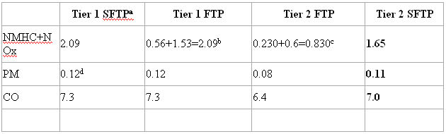

Tier 2 SFTP standards for NMHC+NOx, PM and CO are based on both vehicle weight classification and the certification bin applicable to that vehicle. They are equal to the Tier 1 SFTP standards minus 35% of the difference between the Tier 1 and Tier 2 FTP standards:
SFTP Standard = Tier 1 SFTP - [0.35 × (Tier 1 FTP - Tier 2 FTP)]
For example, an LDT4 certified to bin 10 would have the Tier 2 SFTP standards as shown in Table 5.
Table 5
Example SFTP Standards (LDT4, Bin 10), g/mi
a - Available from 40 CFR 86.1811-04
b - Sum of NOx and NMHC standards
c - Sum of NOx and NMOG standards
d - Tier 1 FTP standard

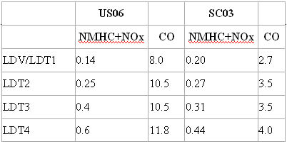

Full useful life SFTP compliance is determined by weighting the emission test results as follows:
0.35(FTP) + 0.28(US06) + 0.37(SC03)
and comparing the result with the calculated SFTP standard.
With the exception of HLDTs and bin 10 LDV/LLDTs, interim non-Tier 2 vehicles must meet Tier 2 SFTP requirements. Interim non-Tier 2 HLDTs need only meet 2002 SFTP requirements and interim non-Tier 2 bin 10 LDV/LLDTs can meet Tier 1 SFTP requirements. SFTP standards for PM are not applicable to interim non-Tier 2 LDV/Ts.

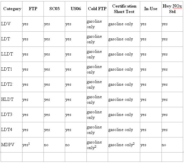

Table 6 summarizes the different vehicle categories and their testing requirements.
Table 6
Vehicle Categories And Applicable Tests
1 - Manufacturers may alternatively certify engines for diesel fueled MDPVs through the heavy-duty diesel engine regulations
2 - Does not apply to interim Tier 2 vehicles

US California Standards
Introduction
California emission standards have been traditionally more stringent than the EPA requirements, but their evolution and structure is similar to that of the federal legislation:
• Tier 1/LEV California emission standards extended through the year 2003.
• LEV II California regulations became effective in 2004.
A number of other states have adopted emission standards equivalent to the California LEV II legislation, including New York, Massachusetts, Maine and Vermont (adoption of California standards has been also considered by Connecticut, Rhode Island, Pennsylvania, New Jersey, Oregon, and Washington).
Low Emission Vehicle (LEV) Standards

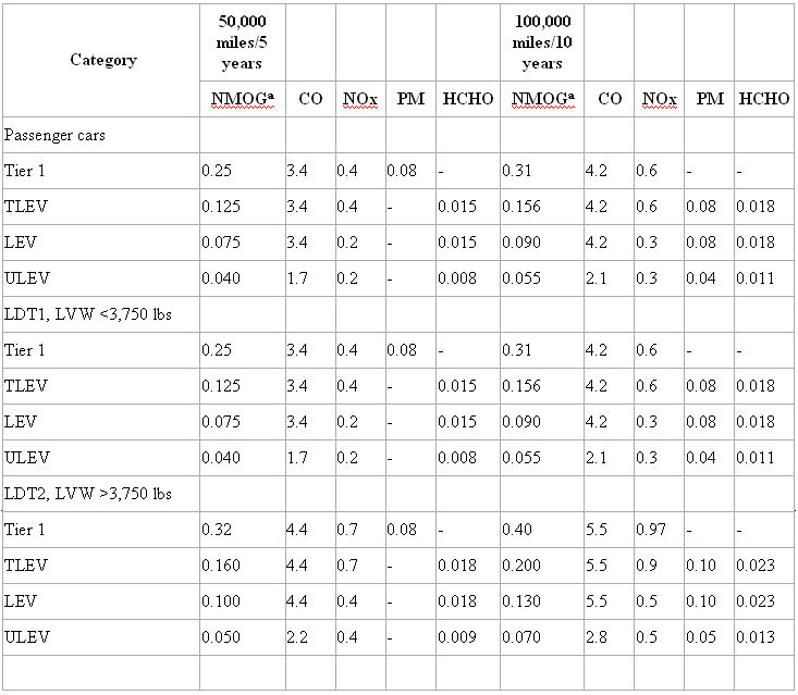

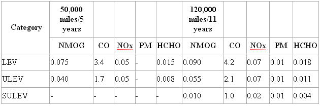

These California emission standards, which applied through model year 2003, were expressed using the following emission categories:
• Tier 1
• Transitional Low Emission Vehicles (TLEV)
• Low Emission Vehicles (LEV)
• Ultra Low Emission Vehicles (ULEV)
• Super Ultra Low Emission Vehicles (SULEV)
• Zero Emission Vehicles (ZEV)
Car manufacturers were required to produce a percentage of vehicles certified to increasingly more stringent emission categories, according to schedules based on vehicle fleet emission averages for each manufacturer. After 2003, Tier 1 and TLEV standards were eliminated as available emission categories.
The same standards for gaseous pollutants applied to diesel- and gasoline-fueled vehicles. PM standards applied to diesel vehicles only. Emissions were measured over the FTP 75 test and are expressed in g/mile. The additional SFTP procedures were phased-in in California between 2001 and 2005.

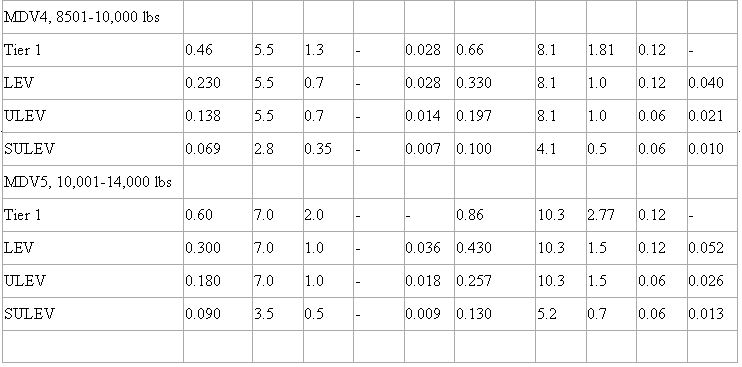

Table 1
California Emission Standards for Light-Duty Vehicles, FTP 75, g/mi
a - NMHC for all Tier 1 standards
Abbreviations:
LVW - loaded vehicle weight (curb weight + 300 lbs)
LDT - light-duty truck
NMOG - non-methane organic gases
HCHO - formaldehyde

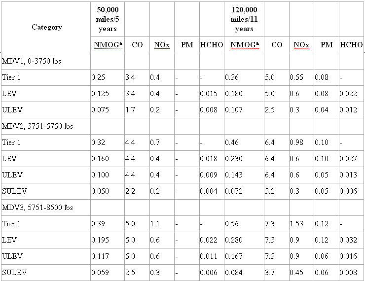

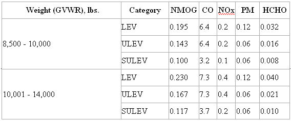

Emission standards for medium-duty vehicles are summarized in Table 2.
Table 2
California Emission Standards for Medium-Duty Vehicles, FTP 75, g/mi
Abbreviations:
MDV - medium-duty vehicle (the maximum GVWR from 8,500 to 14,000 lbs). The MDV category is divided into five classes, MDV1 .. MDV5, based on vehicle test weight. The definition of “test weight” in California is identical to the Federal ALVW.
HCHO - formaldehyde
Low Emission Vehicle II (LEV II) Standards
On November 5, 1998 the California ARB adopted the LEV II emission standards which extend from the year 2004 until 2010.
Under the LEV II regulation, the light-duty truck and medium-duty vehicle categories of below 8500 lbs gross weight are reclassified and have to meet passenger car requirements, as shown in Table 3. As a result, most pick-up trucks and sport utility vehicles (old MDV4 and MDV5) are required to meet the passenger car emission standards. The reclassification was phased-in by the year 2007.
Under the LEV II standard, NOx and PM standards for all emission categories are significantly tightened. The same standards apply to both gasoline and diesel vehicles (under revisions adopted on November 15, 2001 gasoline vehicles are no longer exempted from the PM standard). Light-duty LEVs and ULEVs certify to a 0.05 g/mi NOx standard, phased-in starting with the 2004 model year. A full useful life PM standard of 0.010 g/mi is introduced for light-duty diesel vehicles and trucks less than 8500 lbs GVWR certifying to LEV, ULEV, and SULEV standards. The TLEV emission category has been eliminated. It is, therefore, believed that the LEV II emission standards can only be met by vehicles fitted with advanced emission control technologies, such as particulate filters and NOx reduction catalysts.
Table 3
California LEV II Emission Standards, Passenger Cars and LDVs < 8500 lbs, g/mi
Table 4
California LEV II Emission Standards, Medium Duty Vehicles, Durability 120,000 miles, g/mi
The LEV II standards also include an extension and tightening of the fleet average standards requiring automakers to reduce fleet emission levels each year through 2010, as well as tightening of evaporative emission standards.
Source: http://www.dieselnet.com/standards/us/ld_ca.php
dhackney

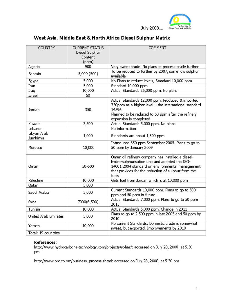

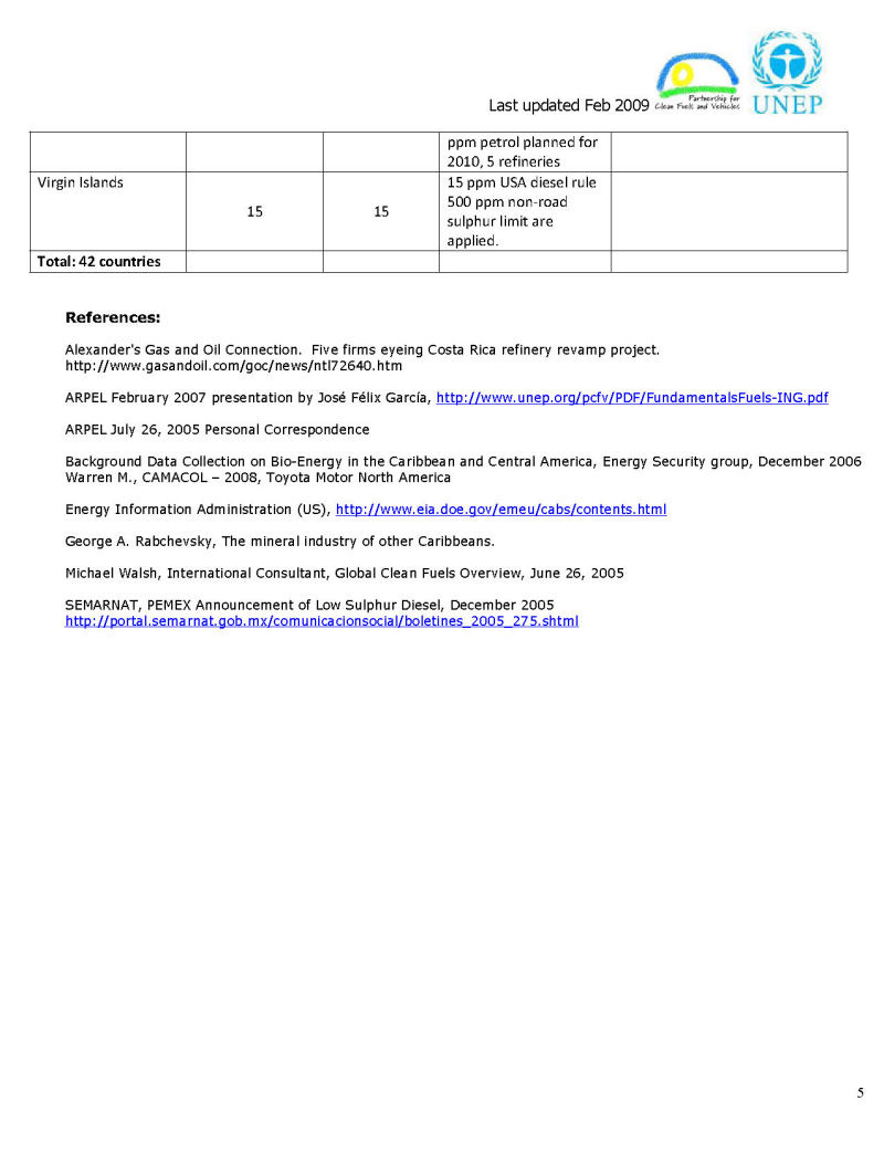

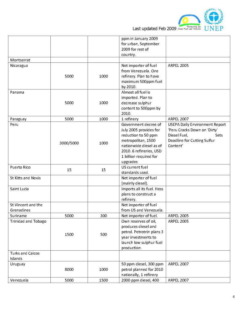

Crude oil, the source of diesel fuel, varys widely in the amount of sulfer it contains.
Oil sourced from Venezuala is among the world's highest in sulphur content. Higher sulphur crude oil is more expensive to refine into today's low sulphur content fuels.
Source: UNEP
