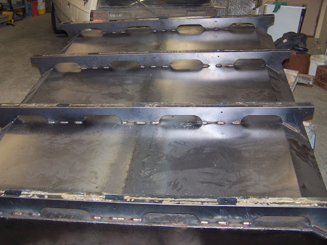

Squaring up before welding floor
Welding the floor

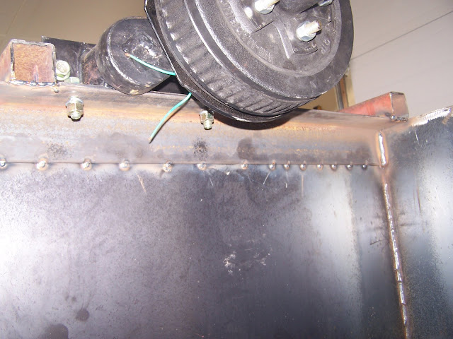

Torque flex axel with electric breaks

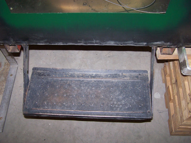

picture of the rear step - hope I don't lose it on the first pebble I drive over, it might be hanging a little low.
3 inch angle iron used to support the wheel assembly

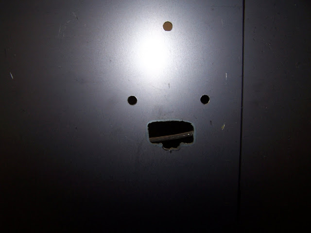

holes for tailights

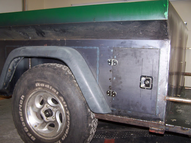

fenders & doors on

step to get in - hopefully it gets past the first rock in the road.
