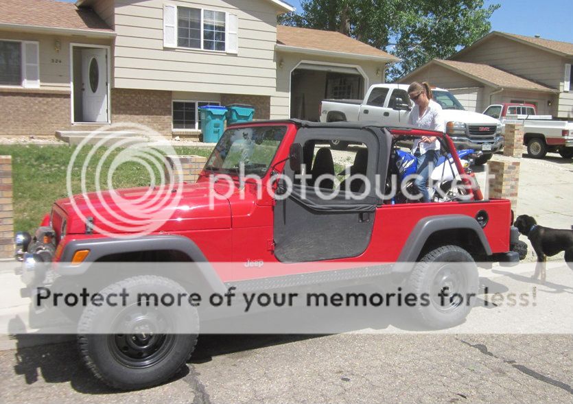

I ran the same tires on my TJ last winter, and they did awesome in the snow, even breaking open deep snow this spring. I'm heading away from my 285's and switching to 235/85's next spring. I really like the tall/skinny!
I'll see if I can find some pics of the XJ... They're on my old laptop, but here's a few of those tires on my TJ.
