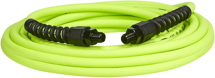

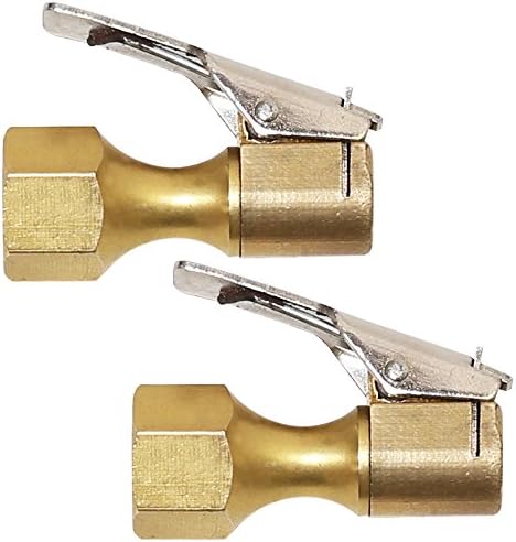

For the 400P I ditched the coiled air hose and chuck that came with the kit and replaced them with a 1/4" x 25' Flexzilla hose and an open flow chuck. Much better.
https://www.amazon.com/gp/product/B008BT2SIY/ref=ppx_yo_dt_b_search_asin_title?ie=UTF8&psc=1
https://www.amazon.com/gp/product/B017S44ARO/ref=ppx_yo_dt_b_search_asin_title?ie=UTF8&psc=1
