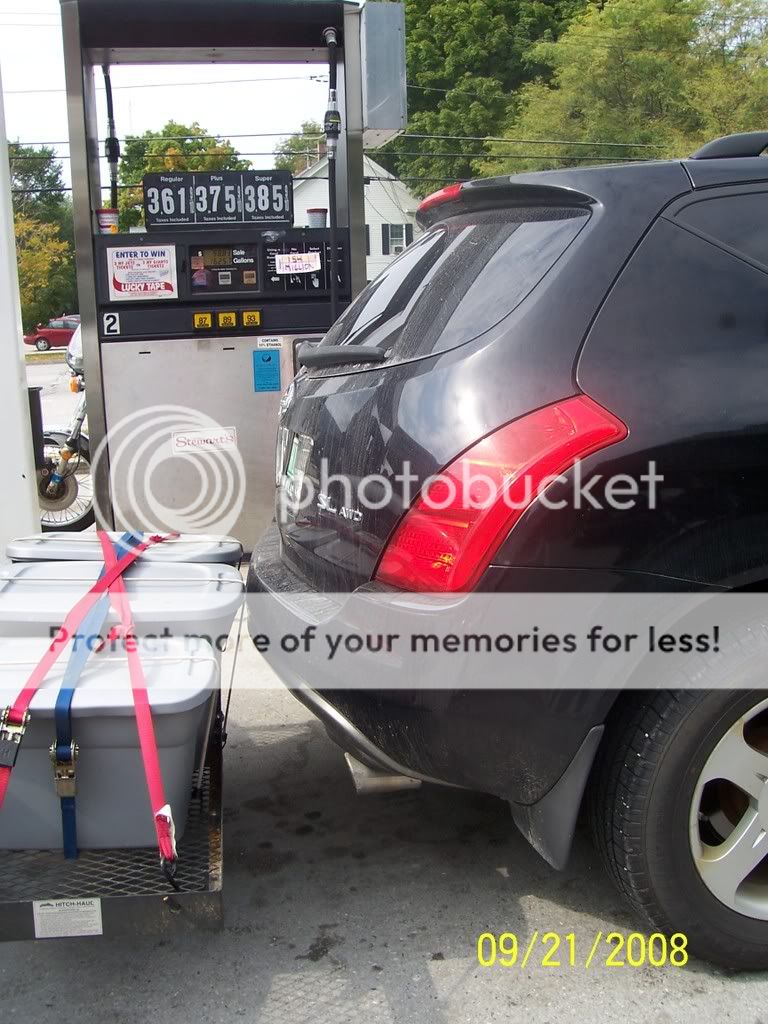

Here's how I carry firewood when I go out camping with my camper.
2" drawtite front receiver, Hitch-Haul 500 lb carrier with the 6" Z Bar to lift the rack up a few inches above the receiver.
The bins are my extra tools and the hoses for the camper.
Just need to remember they are there, I had a funny thing happen once at a gas station with the same carrier....
1/2 inch of space between the lids and the bumper of the BMW when I stopped, totally forgot about it being there. But the look on the guy from VT who owned the BMW when I pulled up was priceless.
