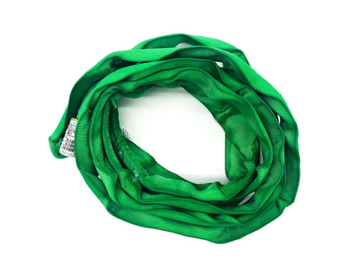

There are a variety of short recovery straps designed for connecting to non-traditional or awkward anchor points. I've used one to attach a kinetic recovery rope to a commercial truck's frame. With a car, I might loop one or two through a wheel(s) or lower control arm(s) to slowly pull it a few feet back onto a snow packed road. It could also be used as a leader under a car to an anchor point, which would protect the car's undercarriage & the winch line. The same strap can be used as a bridle to distribute a load between two anchor points. It's hard to say what will be best considering all of the variables, and the versatility of these straps makes them very useful.
This Factor 55 video will give you an idea of what I'm talking about. I can't recall the brand I have, but I like the round construction of the one I use since it works better as a choker.
A recovery endless loop is a similar option.
