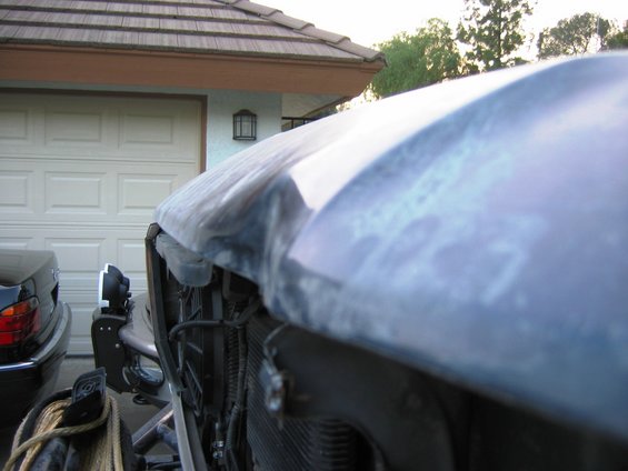

ive bent couple of these style of hooks before. first time it failed i had a shackle attached to it and that sucker flew like a rocket and tacoed the trucks tailgate that was tugging on me. Second time was just the strap itself and that left a nice dent in the same trucks tailgate (lucky no one got hurt). i dont really recommend them unless it was a light pull. but bolting them together like in the picture is just asking for trouble.
A little off topic but heres an ideal of how must tension can be in a tow strap by itself. the strap broke off the truck that was tugging me and hit my 85 Bronco in the hood/grill. i already removed the grill since it just shattered but u can see the dent left in the hood. imagine there was a hook on the end... :Wow1:
