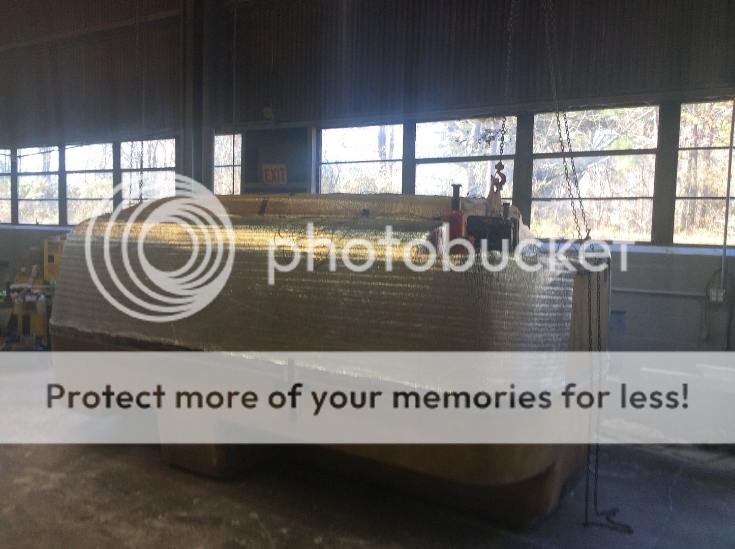

On to the tub construction. The body is built in 4 main pieces, an inner and outer tub, both top and bottom. Here's the mould for the bottom interior. Apparently these are built by a company in Florida and are pretty expensive, so if you have any special request in mind that involves changing the mould itself, forget it.
Here's the top exterior. They do the gelcoat first of course, then spray chopped fiberglass. Then reinforcing matts are installed in layers with chopped fiber between. The reinforcing is substantial in portions and the entire tub is incredibly rigid thanks in part to the number of curves built in to the design. Metal plates are installed for external attachments, like the spare tire and awning. Our guide told us that one of their customers flipped their trailer in an ice storm and it hit a bridge support, then skidded down the highway for a bit on its side, resulting in only cosmetic damage. He said the insurance adjuster was pissed because he had to do something other than just check 'totaled', which is the usual extent of his job. You can see some of the structural matting in the second and third photos.
The shells come out of the mould looking like this, then they do a final polish to get them shiny before they start putting things together. This is the bottom interior - the advantages of the fiberglass construction should start to become clear at this point. First, all the interior cabinetry, seating, etc. are structurally moulded into the shell. This is a big advantage over their competitors - you can read on the Airstream forums about people getting to their destination after going over some rough roads, only to find that their cabinetry disassembled itself along the way. Second is the lack of wood or other degradable material. If you have a leak, nothing is going to rot away, plus no nails or screws to pop loose over the years. Third, you can tell how easy these trailers would be to keep clean. Everything can be wiped down (or hosed out) and no corners for dirt to collect.

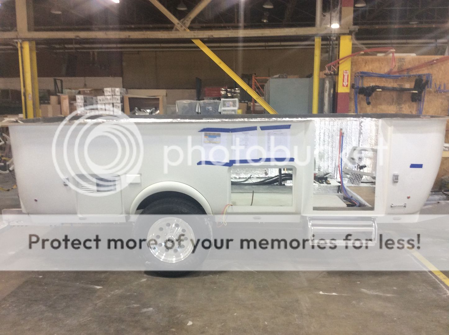

Because the assembly line was more or less shut down for the day, we didn't get to see them putting the tub together. You can see in the background of this shot, though, how the process works.
Basically, it's how you'd expect - they put the inside together, place it into bottom shell and then add the top. I wanted to walk down there to see, but we ended up heading in a different direction and I forgot to go back. The question I wanted to ask was how they deal with problems down the road, with everything sandwiched between the shells. They do a good job of providing access ports inside, but there are things like the holding tanks, which if damaged means they'd have to crack open the shell to replace them. I assume they do just that. There's also the question of water intrusion. There are weeps in the bottom but it seems like there are plenty of places for water to pool if it does get between the shells.
