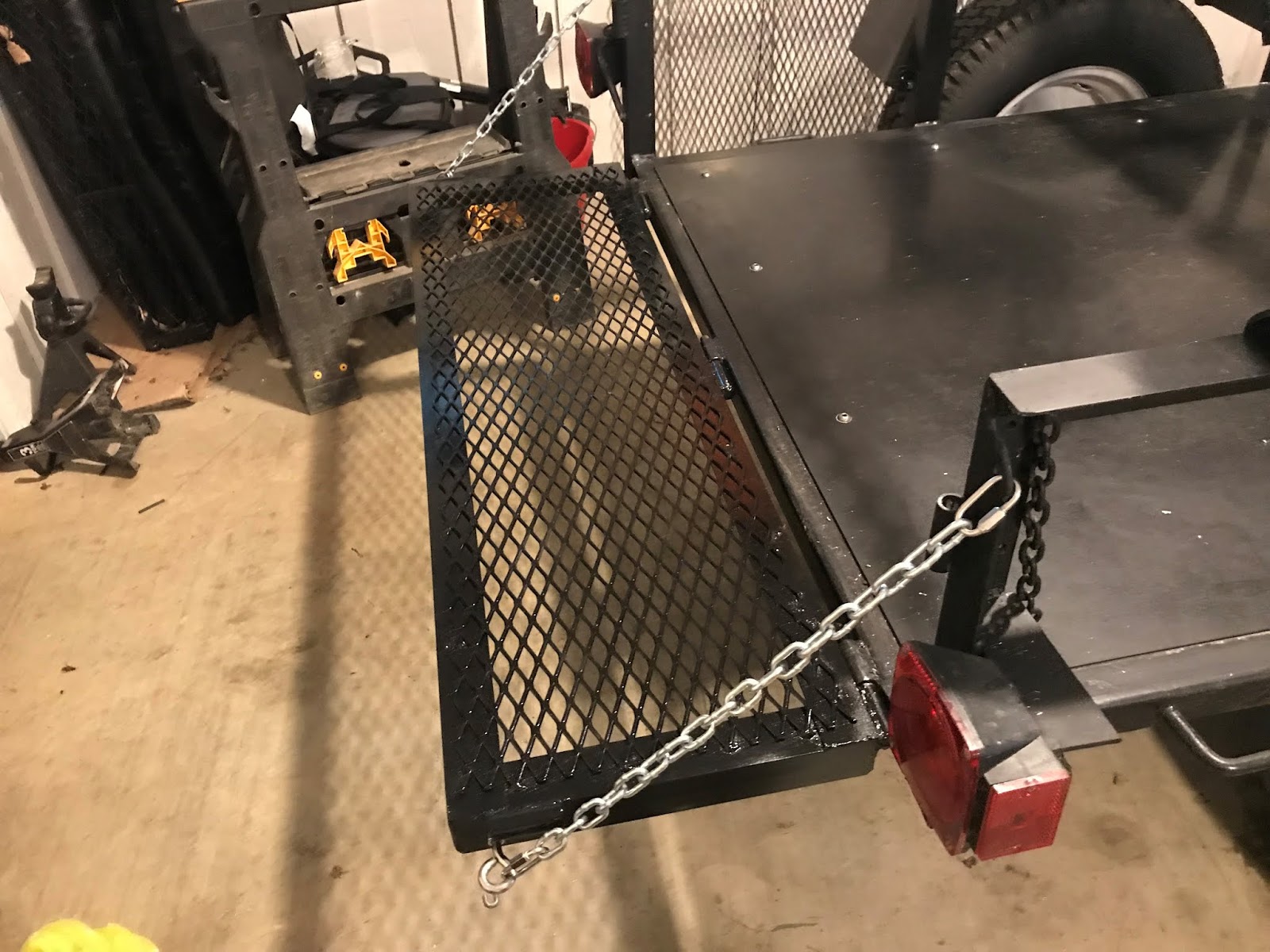

finally got around to mounting fenders and finishing the tailgate.

this is basically lawn mower/4 wheeler mode.
I'm not completely satisfied with the current fender location, but it was the best i could do with the materials I had and the orientation of the angle iron used as the side rail supports. it should be sufficient to register it and get a tag.
primary cargo on road trips will be 24 gal action packers, 50qt cooler, a dosko campmate, an EZ-up awning or 2, 6' folding table, camp chairs, weber Q gas grill, 5gal propane bottle, generator, gas can, and maybe a couple of box fans.
next phase will be to find a suitable spare wheel/tire, build a shorter tailgate the same height as the side rails, mount side panels to keep road grime out of the bed, and mount a rail system to hold a rooftop tent.

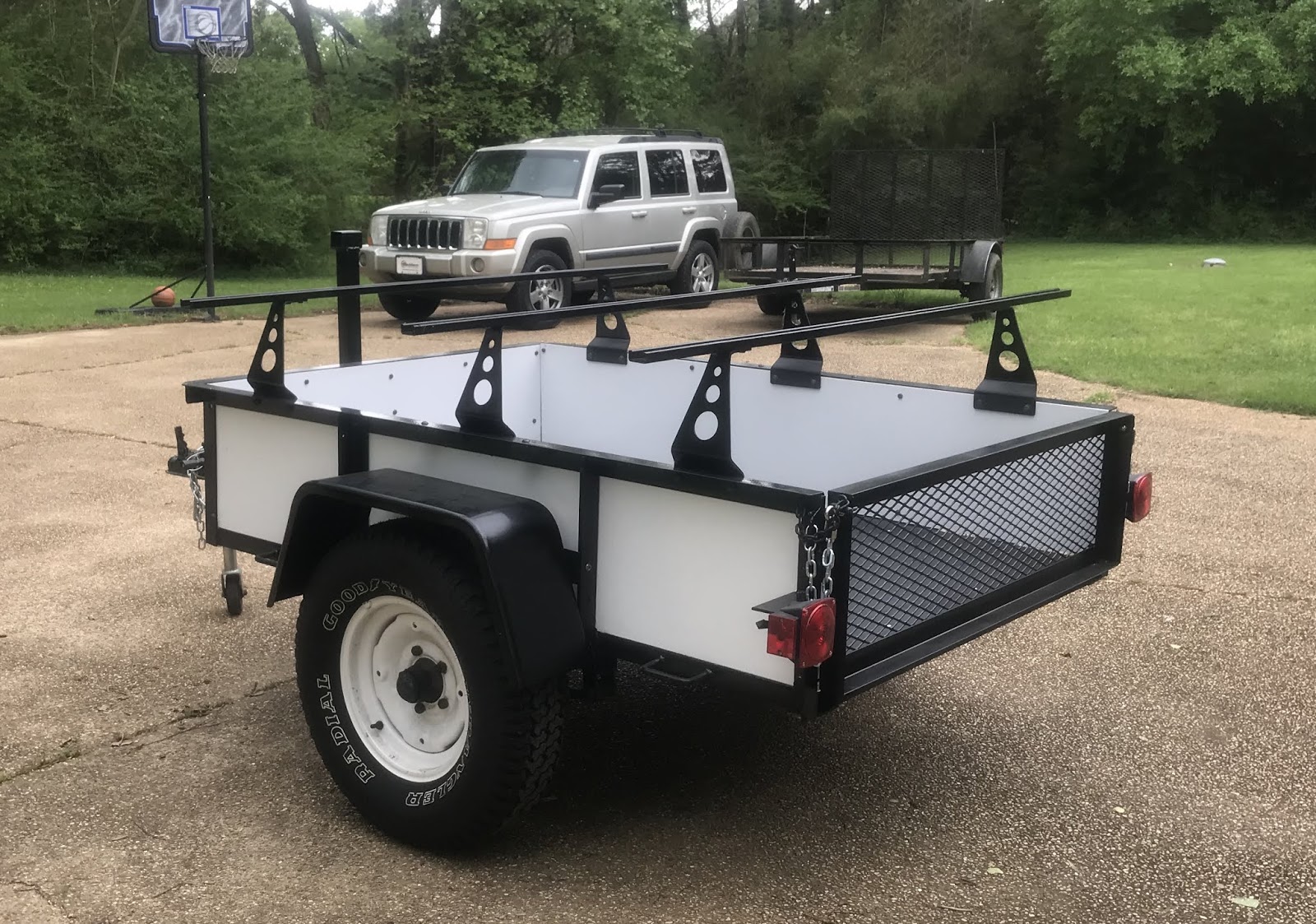

So, I built a shorter tailgate and repositioned the fenders.
Next step is to touch up the paint before I have a friend cut aluminum panels for the side and front walls to help keep gear in, and road grime out of the bed. After that, I will bolt on the no-weld rack towers that will hold crossbars for a RTT.
